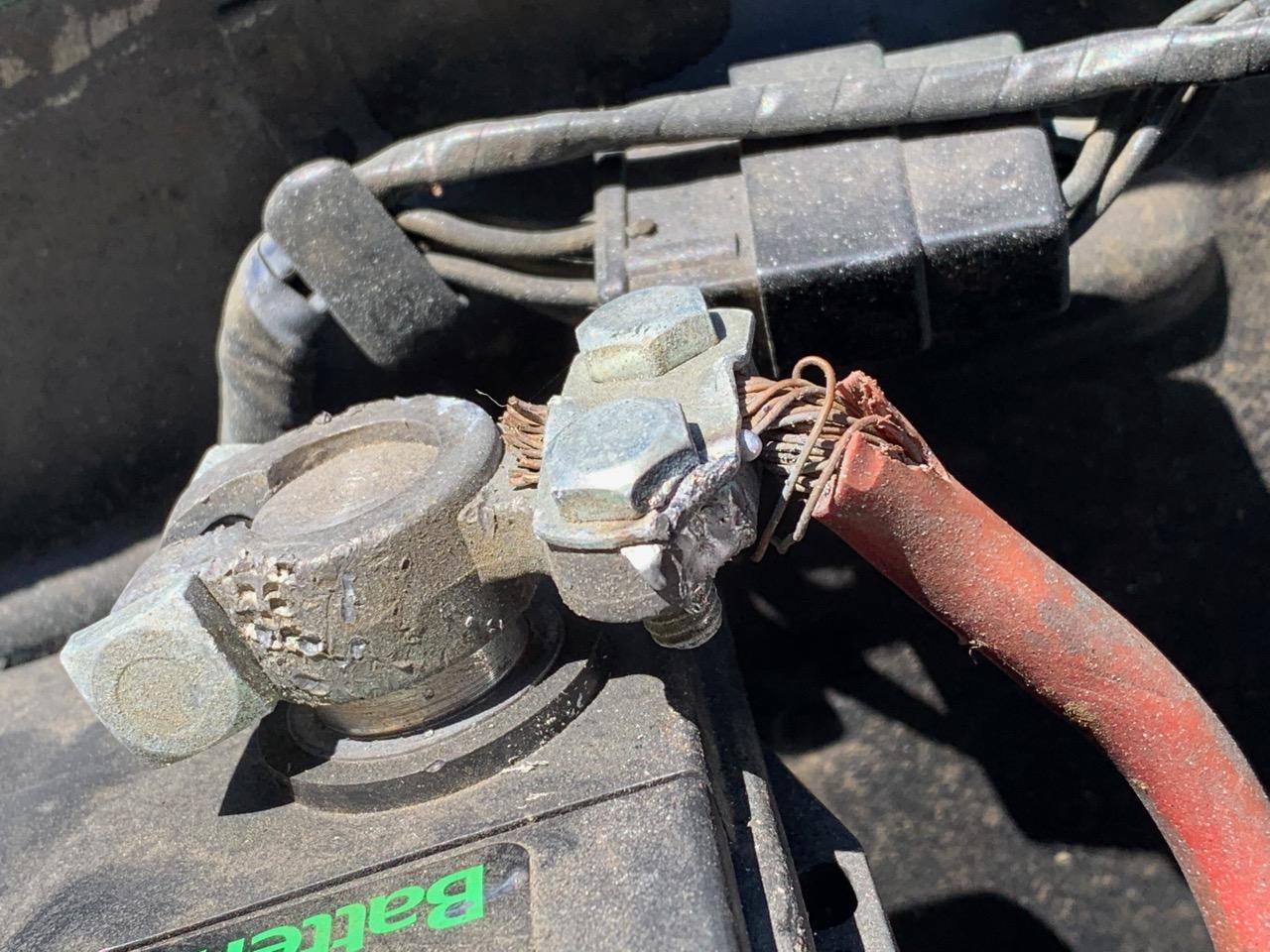

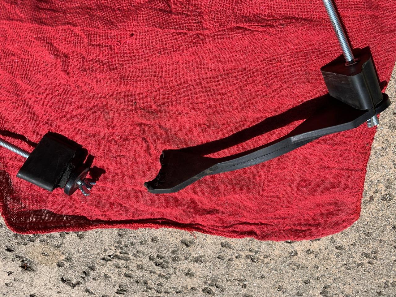

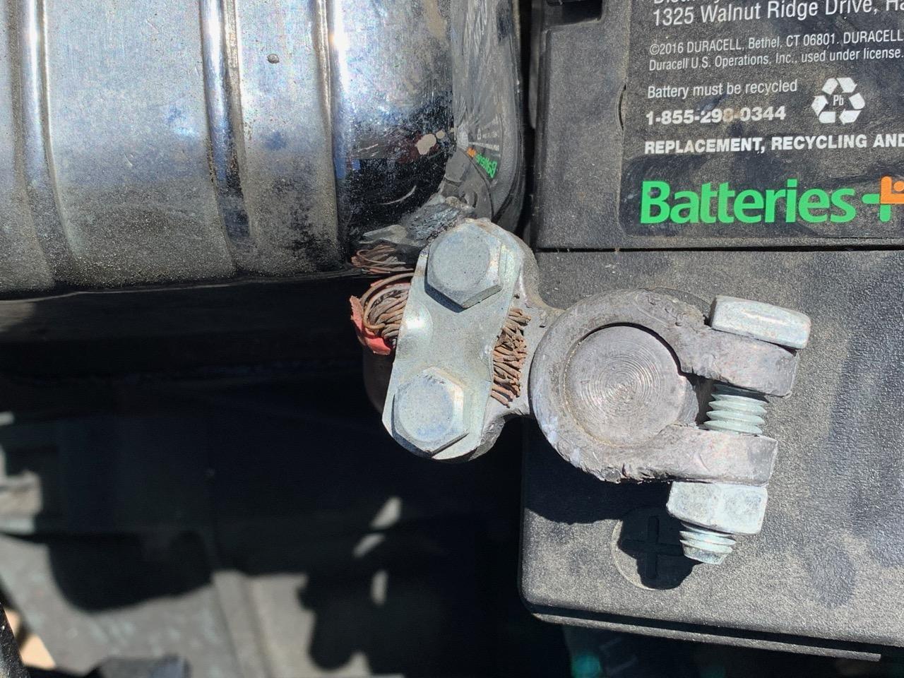

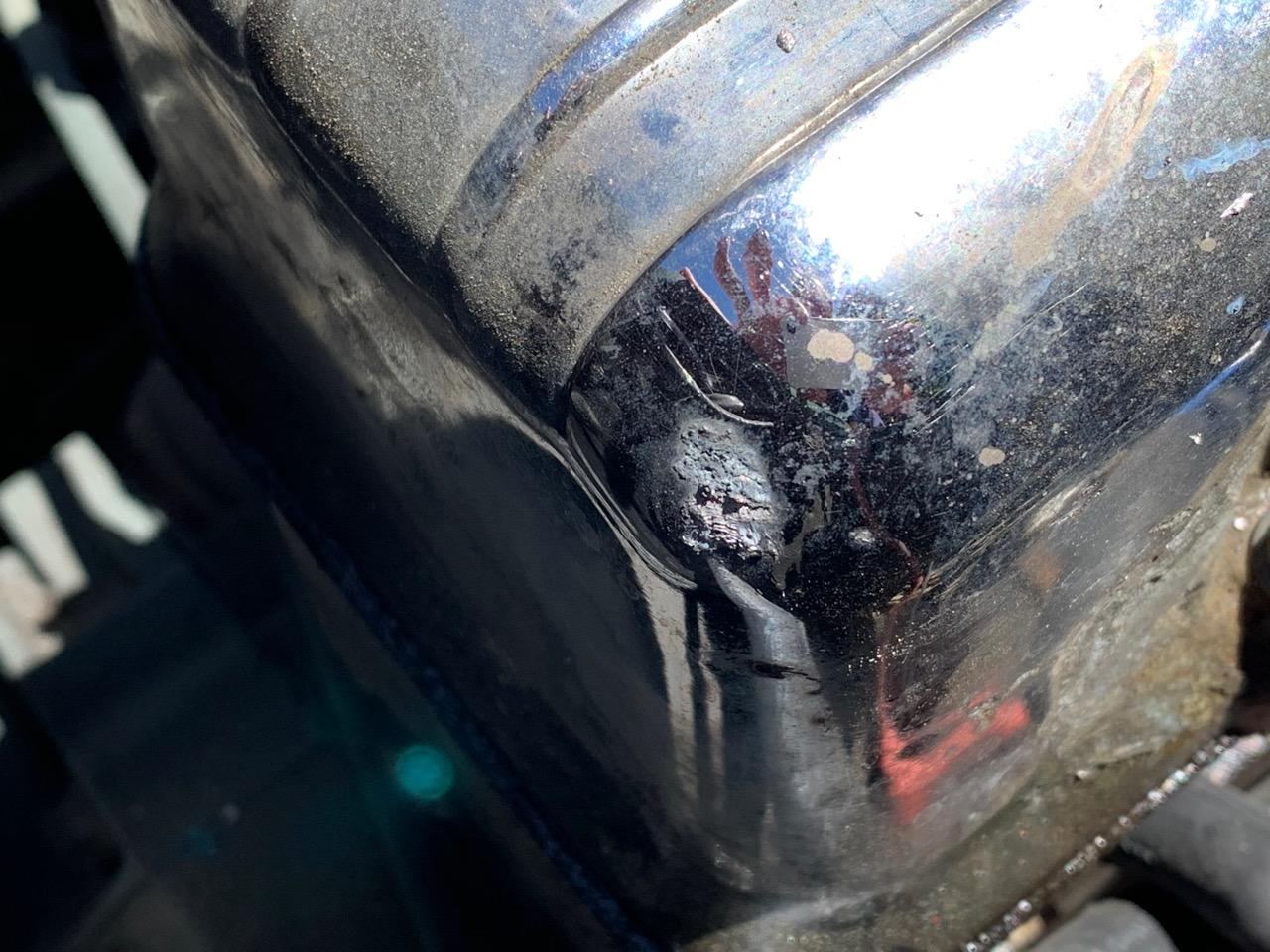

kenward1000 Posted May 17, 2020 Author Share #3 Posted May 17, 2020 https://zcarsource.com/battery-frame-hardware-kit-240z-260z-280z-70-78-new Was able to bust it loose. Check out the contact area on the valve cover and the battery terminal. Last image is the aftermarket battery hold-down that broke. Link to comment Share on other sites More sharing options...

Zed Head Posted May 17, 2020 Share #5 Posted May 17, 2020 (edited) Wow. I wonder if there's burnt oil on the inside of the valve cover. Must have got hot. That kit looks about like the top bracket I had on mine. Any chance that there's another hole in the firewall for the slotted tang to fit over? That would determine your upper limit. Maybe the tray is thicker than stock. I'm going to guess that that's the issue. The tray is probably sourced from a non-Nissan supplier. Find a thinner tray. Actually, if the bracket fits the correct hole in the firewall then your only major adjustment is the tray. The top position is fine-tuning within the length of the slot. If the battery sits on the tray and you can close the hood without interference, then the firewall hole seems like the fix. You might check the tray first, because the top bracket looks right. Edited May 17, 2020 by Zed Head Link to comment Share on other sites More sharing options...

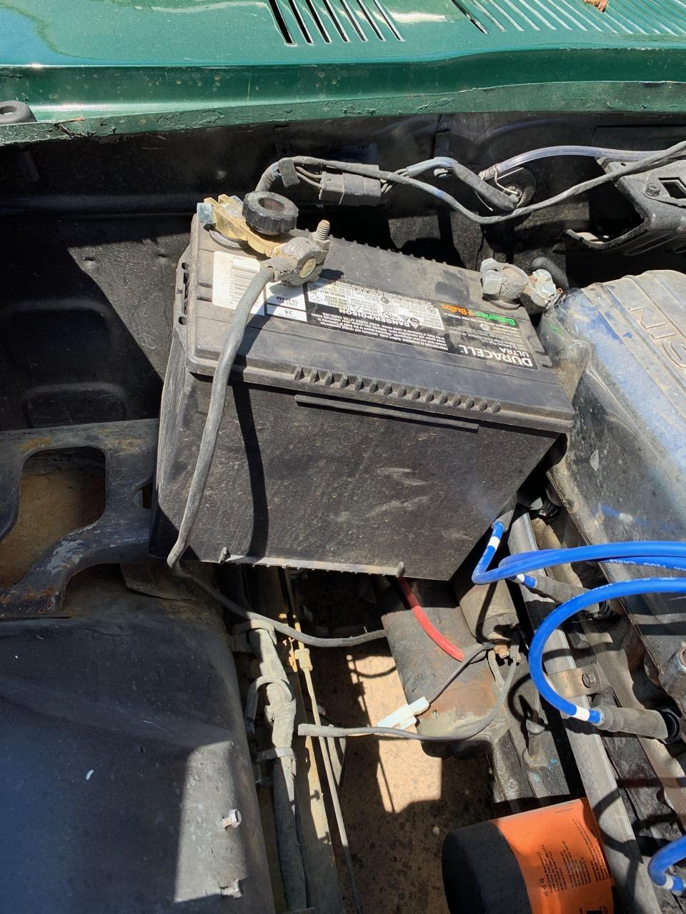

zKars Posted May 17, 2020 Share #8 Posted May 17, 2020 (edited) Group 24F is what I’ve always bought. https://www.batteryequivalents.com/bci-battery-group-size-chart.html The stock battery frame internal dimensions are 10-3/8 x 6-15/16. In my link above that suggests that a 24F is too wide at 10-3/4, and that 24H and T are better at 10-1/4. I’ve never had a problem with a 24F fitting a stock frame, probably a manufacturer specific shape thing, or the max width is at the base, not around the perimeter of the top. Can’t comment on the correct height, no Z’s in reach at the moment, sorry. Just spotted a good battery picture in one of the threads here. Kinda shows the stock frame and mounting tab at the firewall. Edited May 17, 2020 by zKars 2 Link to comment Share on other sites More sharing options...

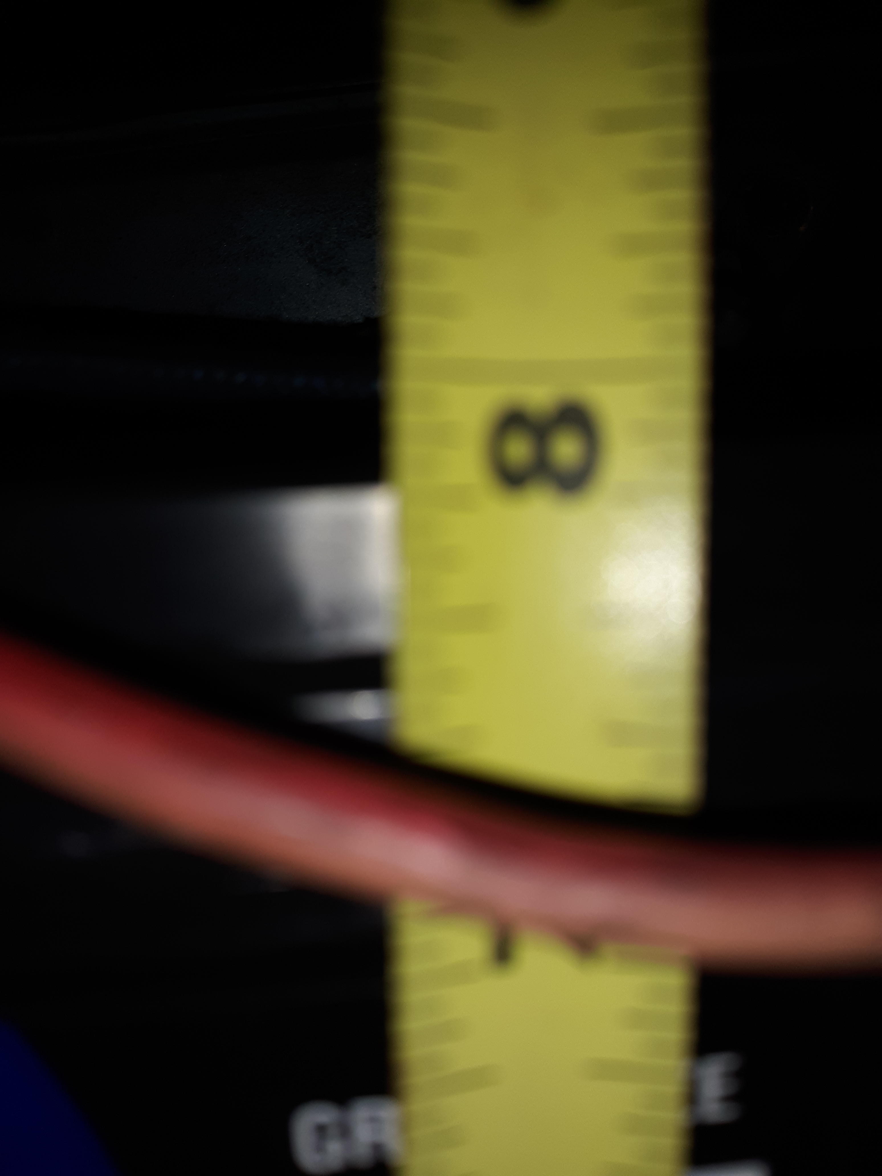

siteunseen Posted May 17, 2020 Share #10 Posted May 17, 2020 I've started buying Ever Start batteries from Walmart. $50 plus tax I think, less than $60 I know. Batteries have gone through the roof price wise at least my local Interstate store. This is sitting in the original bottom plastic pan? and measures less than 8". FYI only, it's no show car. Link to comment Share on other sites More sharing options...
kenward1000 Posted May 17, 2020 Author Share #11 Posted May 17, 2020 I've seen posts about the Walmart EverStart Maxx, however from the Walmart website: Brand EverStart Maxx Manufacturer Part Number MAXX-24 Assembled Product Weight 44.4 lbs Assembled Product Dimensions (L x W x H) 10.20 x 6.80 x 8.90 Inches So is the published spec wrong or are the current production batteries now taller than your battery? Guess I have to go to Walmart and measure one. Thanks for the picture! Link to comment Share on other sites More sharing options...
siteunseen Posted May 17, 2020 Share #12 Posted May 17, 2020 1 hour ago, kenward1000 said: I've seen posts about the Walmart EverStart Maxx, however from the Walmart website: Brand EverStart Maxx Manufacturer Part Number MAXX-24 Assembled Product Weight 44.4 lbs Assembled Product Dimensions (L x W x H) 10.20 x 6.80 x 8.90 Inches So is the published spec wrong or are the current production batteries now taller than your battery? Guess I have to go to Walmart and measure one. Thanks for the picture! Mine is the cheaper, less CCA "value". Not the "maxx". I guess that's why it's smaller? Link to comment Share on other sites More sharing options...
