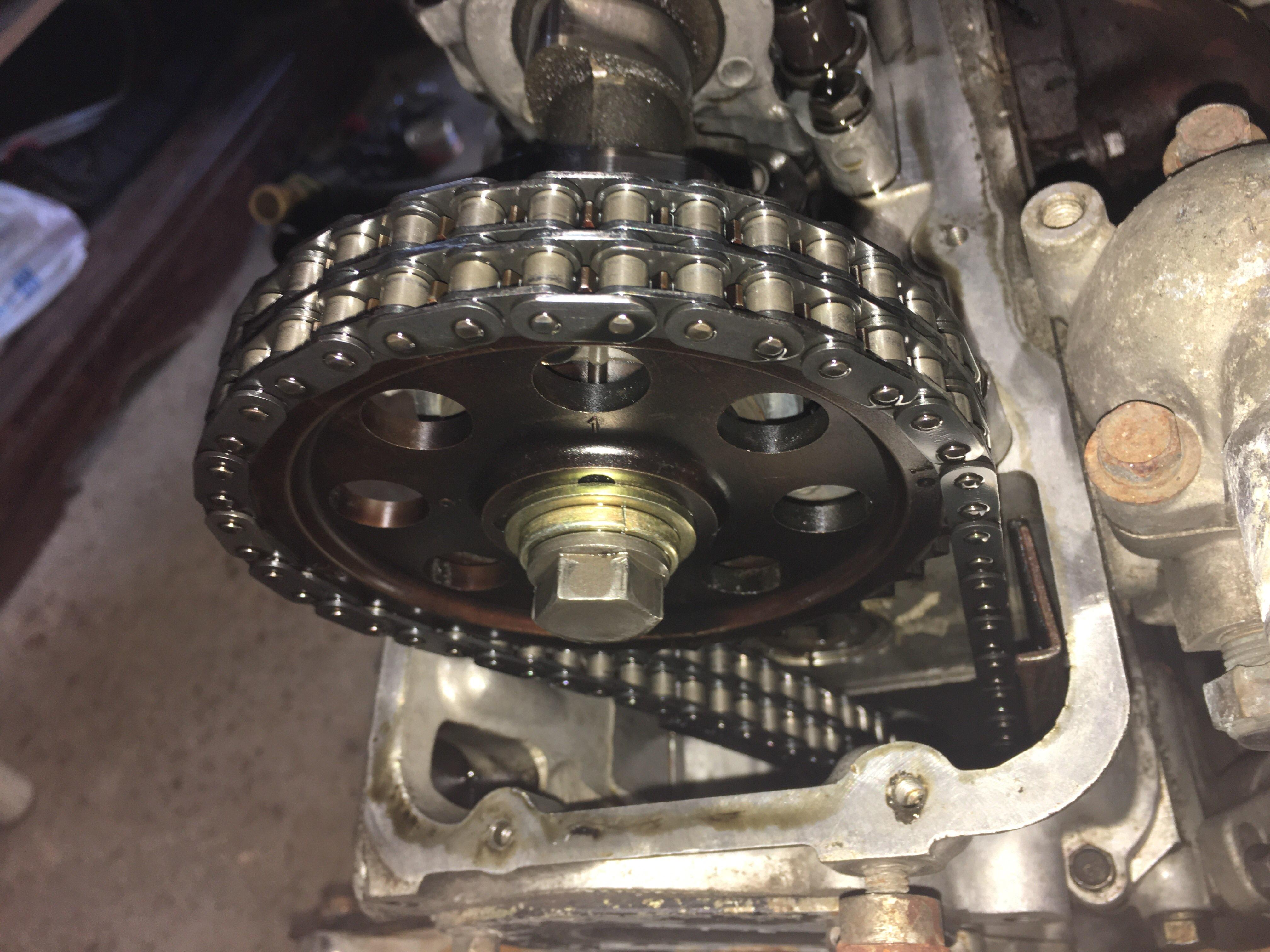

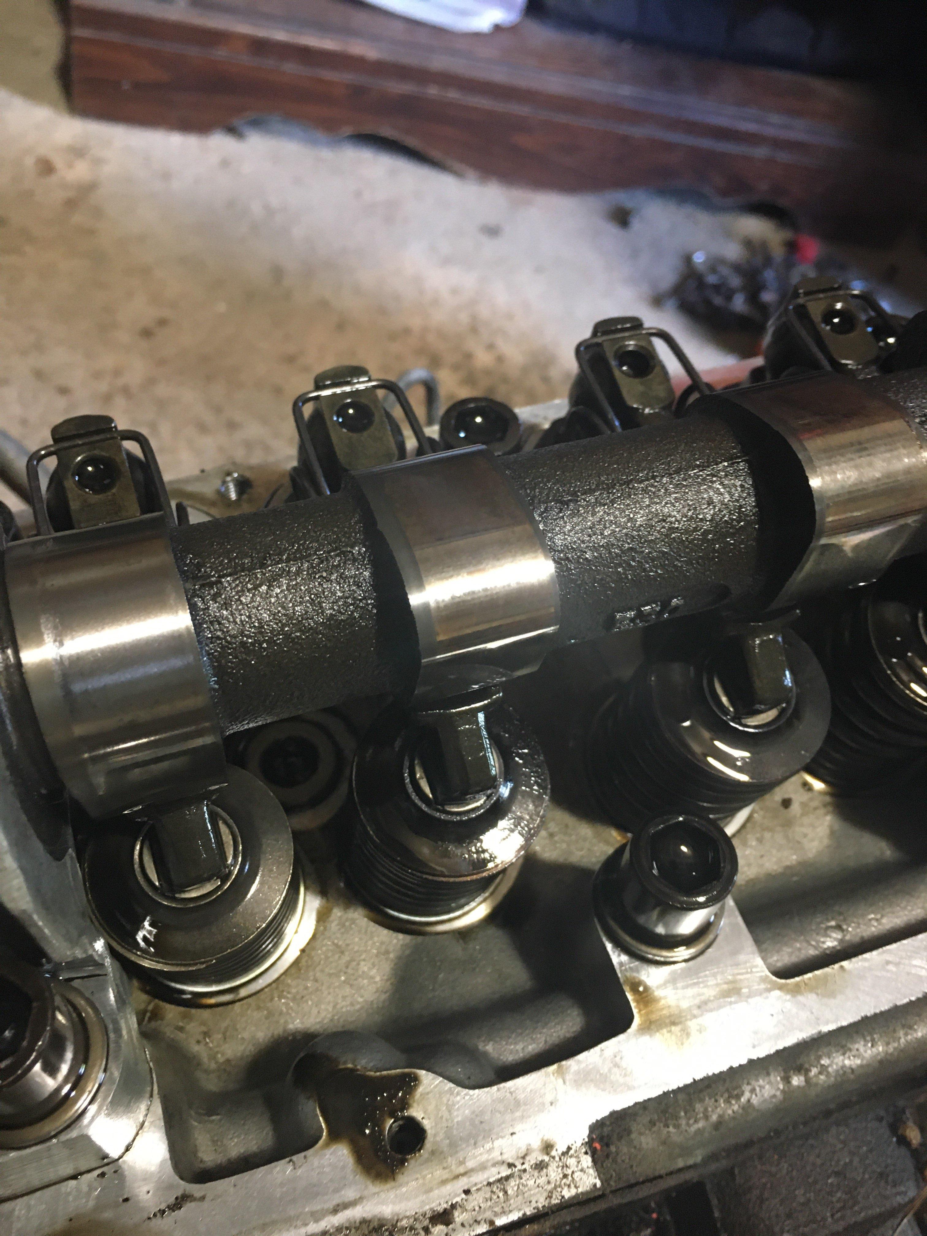

cgsheen1 Posted June 18, 2020 Share #14 Posted June 18, 2020 Let's see pictures of the L28ET with the valve cover off. Link to comment Share on other sites More sharing options...
Auston Posted June 18, 2020 Author Share #15 Posted June 18, 2020 It's beautiful. Here you go. @cgsheen1 Link to comment Share on other sites More sharing options...
cgsheen1 Posted June 18, 2020 Share #16 Posted June 18, 2020 (edited) Ya. Do NOT take the head off that block. Run the L28ET just as it is. (well, don't mess with the internals and head) What do you have for harness/ECU? Stock ECCS? Edited June 18, 2020 by cgsheen1 Link to comment Share on other sites More sharing options...
zeeboost Posted June 19, 2020 Share #17 Posted June 19, 2020 New timing chain kit too, don’t think I’ve seen a pullout that clean before...probably fresh from the machine shop. I would install the engine and run it as is in a heartbeat. Keep your other block as a backup / future n/a build. 1 Link to comment Share on other sites More sharing options...
