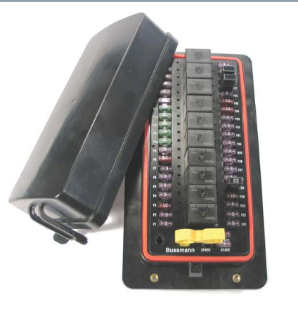

This looks like a great way to solve the space problem, but I would still need 3 more relay positions or find a way to drop 3 from the design.
Bussman Series 15400 RFRM Rear-fed Fuse & Relay Module at waytekwire.com
124mm (4.88") x 235mm (9.25")

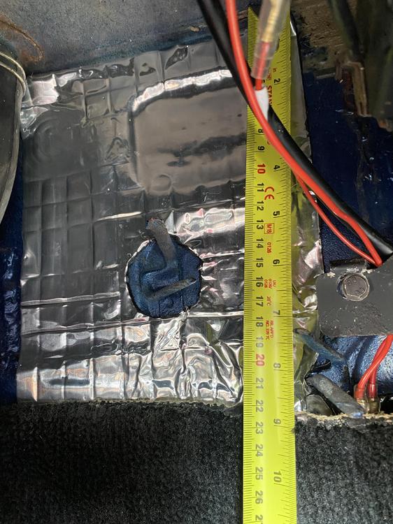

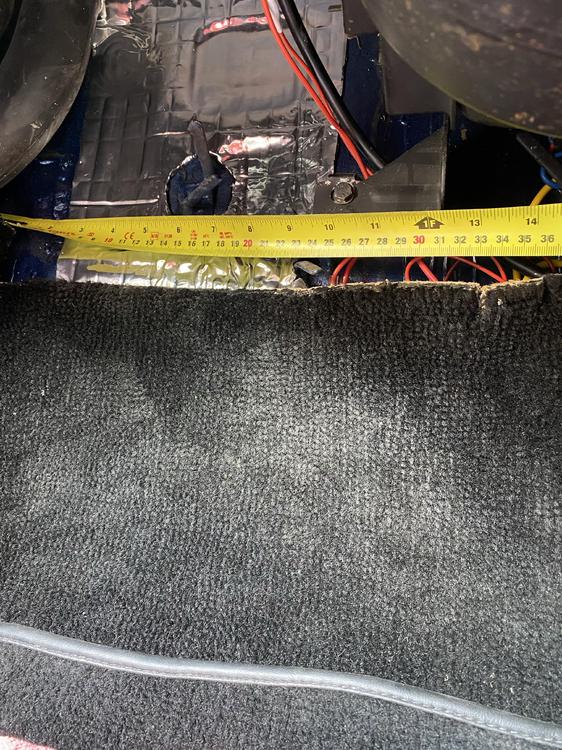

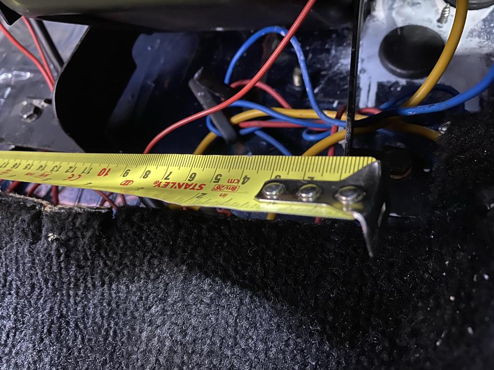

Try these measurements ...
5db9b004104d999ebe2006390b6e4050.jpg&key=dc1bb973a7821f548e4ceb63cfaa62b82139216fdba9e4b9883c1ea4bfeee24df6ef9db5e9b5df479eb365d19a367f06.jpg&key=d9f029b076aa91bd588effdfdbec51d3569cf86ad78b696a4cae78dc11cd9032b1298778dd0fb8ab4a3e5551a7e7a045.jpg&key=d935ae014d41e8e2e1d18f3236df709da68b7440f33d1ae8fc3d8df6a629b6e7
These is a 10-11cm wide space behind the blower motor but if you can go to the side of it there is plenty of clearance to the dash / glove compartment!
Bear in mind my car is RHD.
Wow, that's great.  Thank you for taking the time to post this.
I finally finished the wiring diagram for planned changes.  In the next few days I'll be bench testing some new control circuits, and if they work, I'll start modifying the harnesses.  These pics will help.

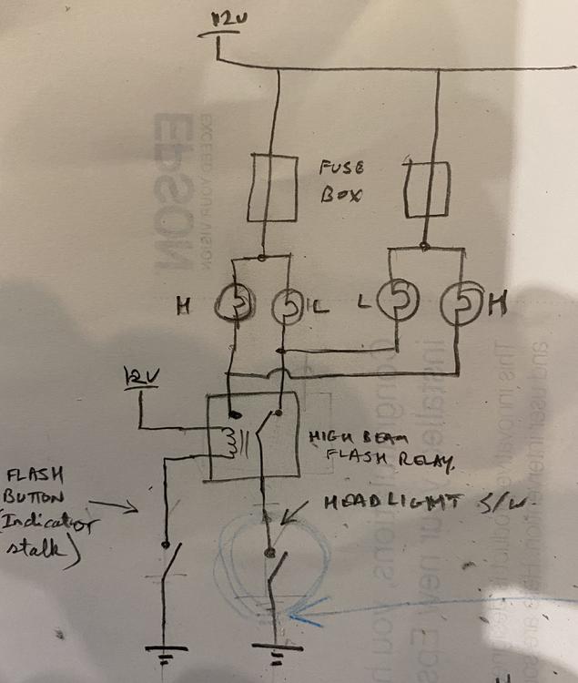

This is a simplified diagram of how my car is wired as far as I can tell ...

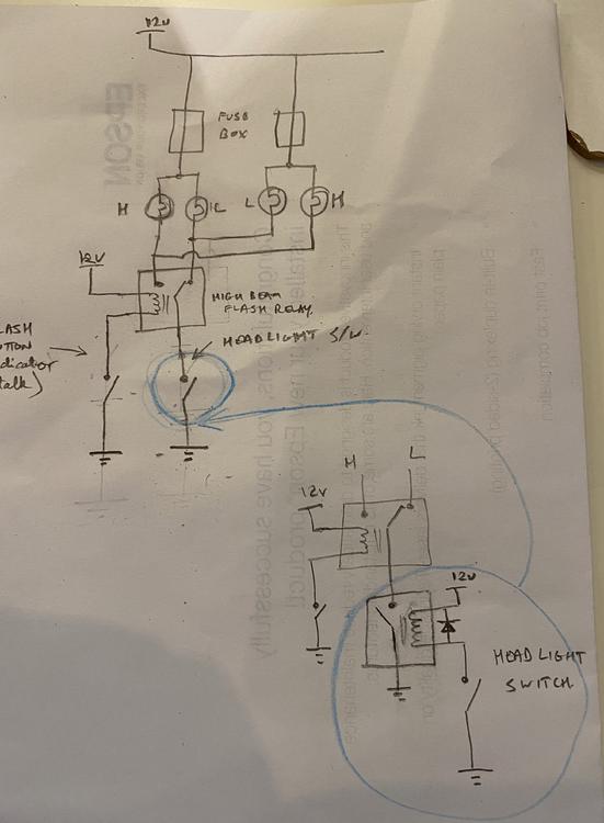

Now, by a stroke of luck, there are Japanese bullet connectors that go from the stalk to the car’s wiring. One is white with red stripe and the other is fully red. I can’t recall which but one is hot, the other is 0v. So here’s the fun bit, by adding a single relay, you are effectively relaying the headlights through the car’s wiring by adding the diagram below into the blue circle by the headlight switch.
264c1a95c1a937a6404ce95e43c597aa.plist&key=a19c6e55f7b9e70d8eebd04d1266a1b16179dcc02552ccf459a8dd689c67abb8
Now then no. 1 - I appreciate this contradicts my disdain for a single point of failure on both sides but frankly all you have done is replace the existing SPOF - being the stalk switch - by a more reliable relay. Heck you can carry one in your glove compartment as a spare and it costs pennies!
Now then no. 2 - the “rest of the car” side of the switch can be done the same way and entails just one more relay - but on my car I will have to cut the original loom or extract the terminals from the multi-plug and connect to them with a spade connector. Either way, it is a shed load better than a burnt out switch and keeps the wiring loom untouched.
Now then number 3 - I also hear you groan at using 40 year old wiring and connectors. Well, since I have LED headlamp bulbs the voltage drop across old wiring is frankly no longer an issue. The connectors from the wiring loom under the bonnet to the wiring through the wings to the lights need replacing or cleaning up anyway in my case.
Now then number 4 - let’s groan about the fuse box. One of my first jobs was to clean all connectors and fuse clips on the box and it has been flawless. With less current going through, it will be even less stressed. Oh and I’ve replaced the original headlight fuses with 5A ones now. Guess what, less current, less drop across the old wiring; win-win!

Ps. The diode in my circuit diagram above is optional, but if you consider that an inductor (I.e. the coil in your relay) will always try to keep the current flowing in the same direction, once disconnected, it switches it’s voltage at the terminals instantly and violently which can reach 100s to 1000s of volts depending on the coil size. This is low current, but the spike can cause issues with sensitive circuitry if you have other things in the car like an AFR gauge etc. It’s basically belts and braces precautions.
The US cars don't have the flash button, so I'm operating without a net, but your diagram does not look right to me.
In the US, the headlight fuses are not hot at all times as you have shown. The OFF-ON switch is between the battery and the fuse box. The fuses are only hot when the headlights are turned on. In addition to that, with what you have drawn, the ONLY way to get the high beams to light up is to push the flash button.
I think there's stuff wrong...
The newest thing I have here is the 72 manual still shows the FLASH relay, and the basic system is pretty much the same as the US with the exception that the flash relay is wired in parallel with the rest of the system and will turn on the high beams even when the headlights are not on.
Would it help if I were to sketch up the 72 system?
The US cars don't have the flash button, so I'm operating without a net, but your diagram does not look right to me. In the US, the headlight fuses are not hot at all times as you have shown. The OFF-ON switch is between the battery and the fuse box. The fuses are only hot when the headlights are turned on. In addition to that, with what you have drawn, the ONLY way to get the high beams to light up is to push the flash button.
Yes please, always up for learning. I did think the HB side was wrong when I went to bed eventually!
I do realise the ignition switch does turn off the power but I was also simplifying the diagram to demonstrate the new relay position. But I appreciate that does cause confusion.
Would love to see that sketch on the HB side though please.
So if you guys don’t have that button, how to you flash your lights? Or do you just go without?
Strangely a quick flash in the UK means “come on, after you and thank you”. Or if behind Someone it means “get off MY road”!!!!! I confused the heck out of the French when driving on the continent, as for them it means “don’t even think about it, I’m coming through or you utter moron”. For us, that is holding the flash button down for more than half a second.
In Mumbai in India, I realised that a flash means “I’m here, see me, I don’t care that there are cars in front of you or you have nowhere to go, get off the planet, I’m here now”! The horn serves much the same function during the day as many cars had their wing mirrors folded in to - get this - avoid having them knocked off while driving! [emoji1787]

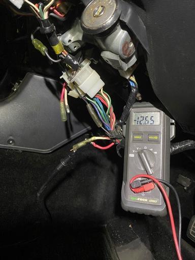

So you got me to doubt myself and I measured it this eve, you are absolutely right, the ignition switch has nothing to do with it! I eat my own words - my light wiring is hot all the time!!
