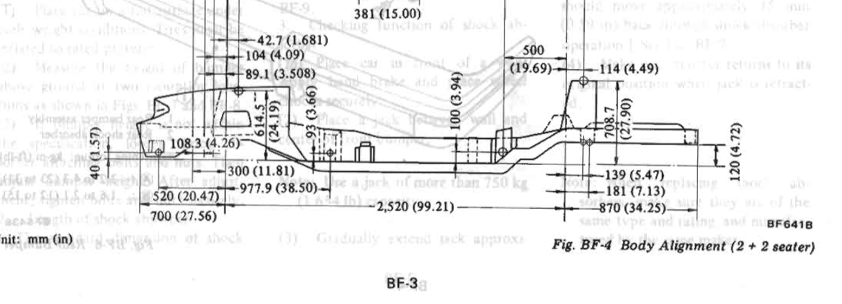

Sheesh! Let me try... The ZX is similar construction underneath to the first gen Z.
So you know those frame rails on the Z that run from the engine compartment to under the seats? The ones that rust out and get all pushed up and mangled by jack stands? Well the ZX has pretty much the same thing.
