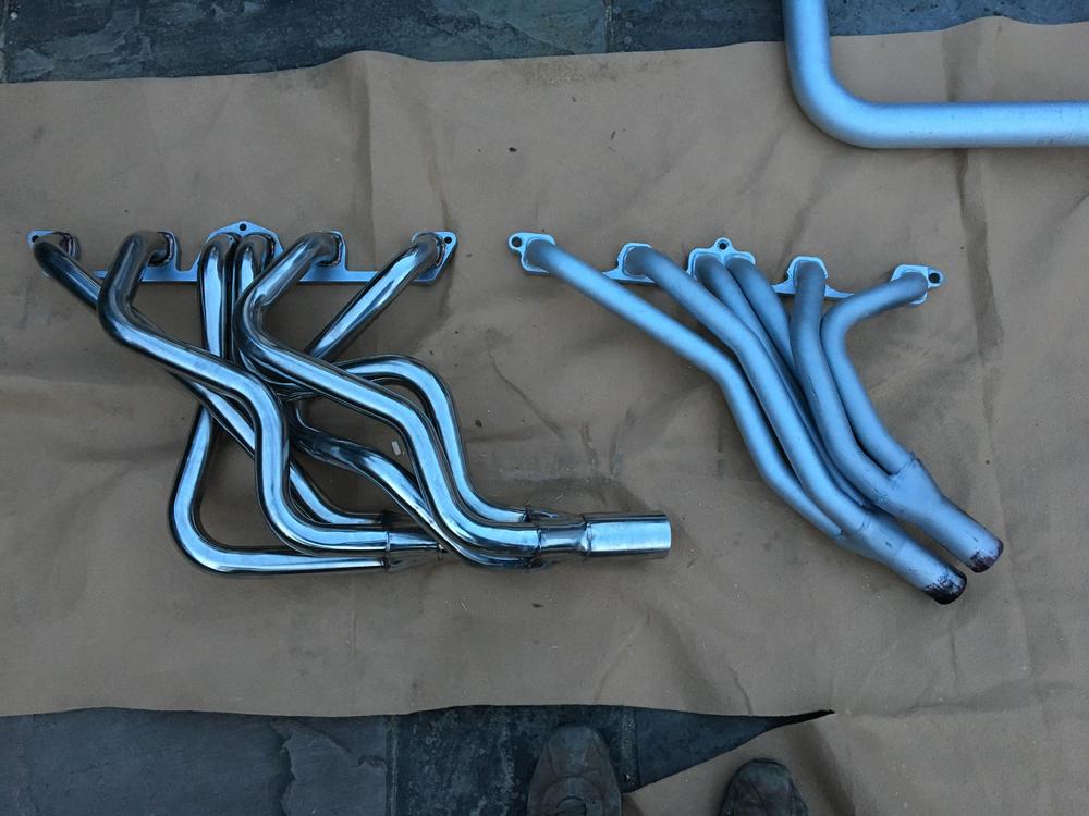

Also this is a photo I do like sharing: Race/Sport header meets MSA ...
I do like that race sport header ! That’s a ceramic coat on the race sport ?
No sir, that is the Race/Sport in her birthday suit. A thing of beauty. The MSA header in the same pic is ceramic coated (at a vast expense by my local place in the UK). The coating was mainly to reduce engine bay temps. I believe if you want to do that and have it work properly, you need the insides done too.
It would be a shame to cover up the natural SS, but the ceramic really does help with underhood temps
Oh I so agree! Sadly I’ve had to cover up the S/S with a diy aluminium heat shield going as I have a very hot engine bay and really don’t like the idea of fuel above hot manifold.
As it happens I now get condensation on the carb domes after a spirited drive and they feel “fridge cold” to the touch as opposed to the old hot feel. Also a lot less fuel vaporisation issues idling in traffic on hot days.
