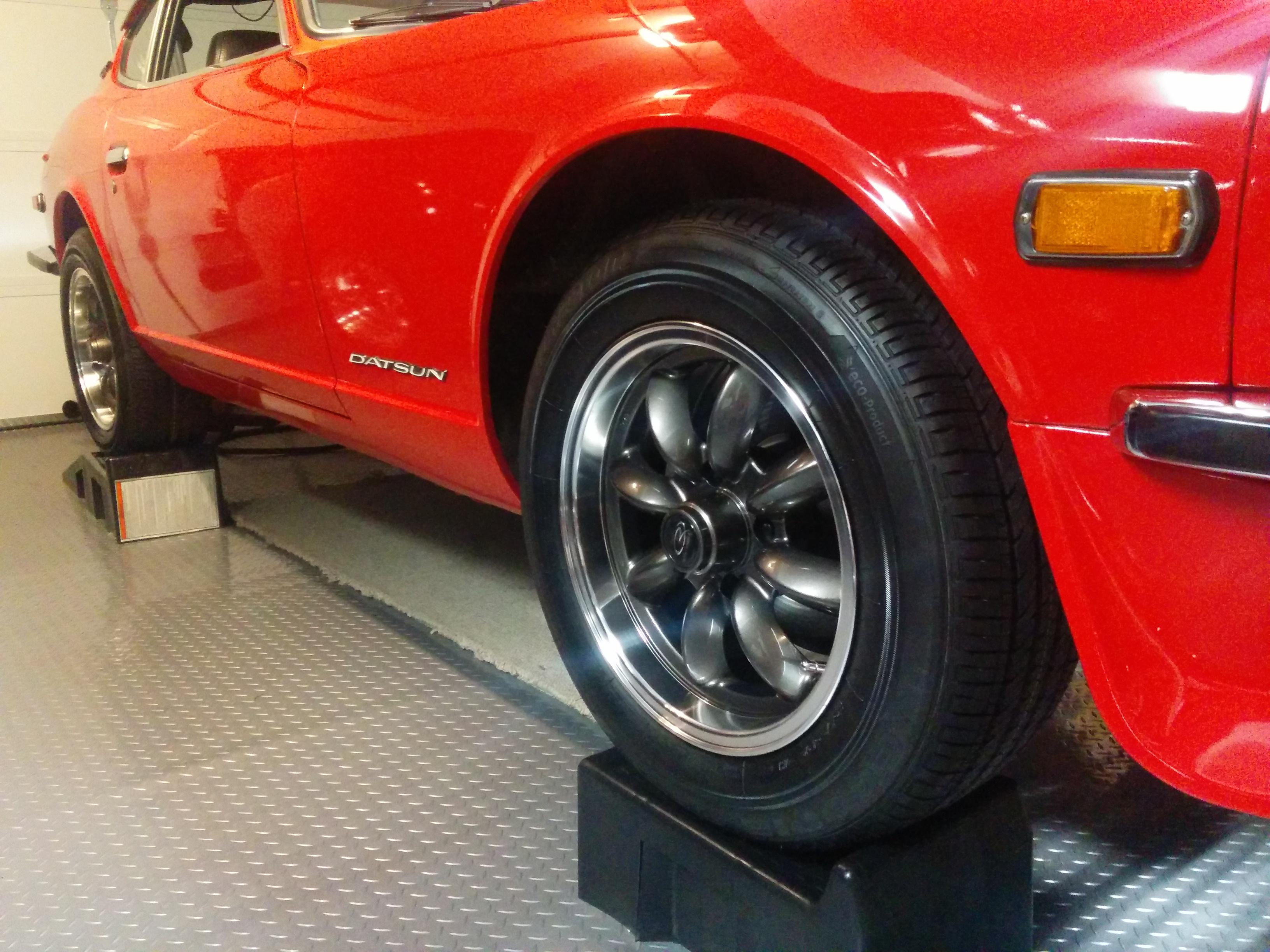

I have 15" Rewinds on my 240, 16" on my 280. 0 offset and bought them super cheap at Discount Tire Direct.  I had to use their credit card with the rebates and discounts they were around $150 each with Hankook tires and free shipping.  MSA has some really cool matte black Rewinds too.  If you can wait until Black Friday you'll save a lot of money.
I run the Rota RB's 15" 7" wide & +4 offset, no spacer with 205 60R15's which come out to pretty close to factory height so speedo also is fairly accurate.
16" Rewinds, zero offset on my car with 205/55 ZR16 tires.  Excellent fit within the wheel wells, no fender rub.  Also very close to the OE tire diameter for no significant speedo error.  Purchased at Discount Tire with tires, look for rebates or other promos.  Discount was willing to negotiate a bit because it was a full package, it pays to ask.
