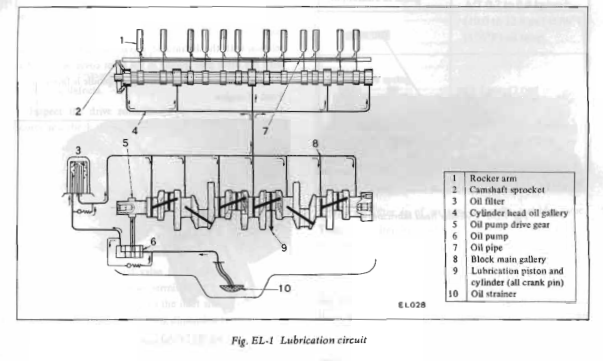

It might help to get in to the basics of the engine and its lubrication system.  There is no "pressure" that would force oil in to the combustion area.  High oil pressure might lead to high oil volume, flooding the top of the cylinder head, but there is plenty of room for the oil to flow back to the crankcase.  You could have excess oil flowing through the main bearings, splashing up n to the cylinder walls as it gets thrown off, but the oil scrapers would have to be seriously overwhelmed to have that oil get ni to the combustion area.
In short, oil pressure and smoke from the exhaust are not connected.  It's actually more likely to see low oil pressure and smoking on a worn engine, with worn valve seals, than on a low mileage engine with high pressure and good valve seals.
