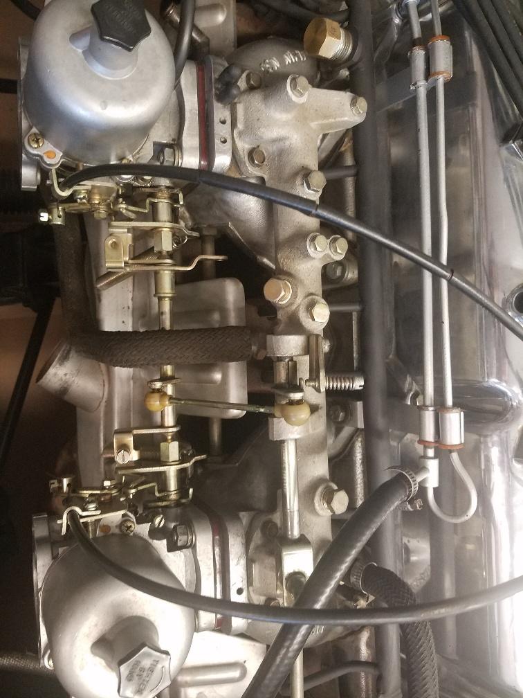

Picture worth a thousand words.  Not sure on the linkage. I'm fully advanced on the distributor (only position the car will start), same position when purchased. Thanks again.20190313_080547_resized.jpg

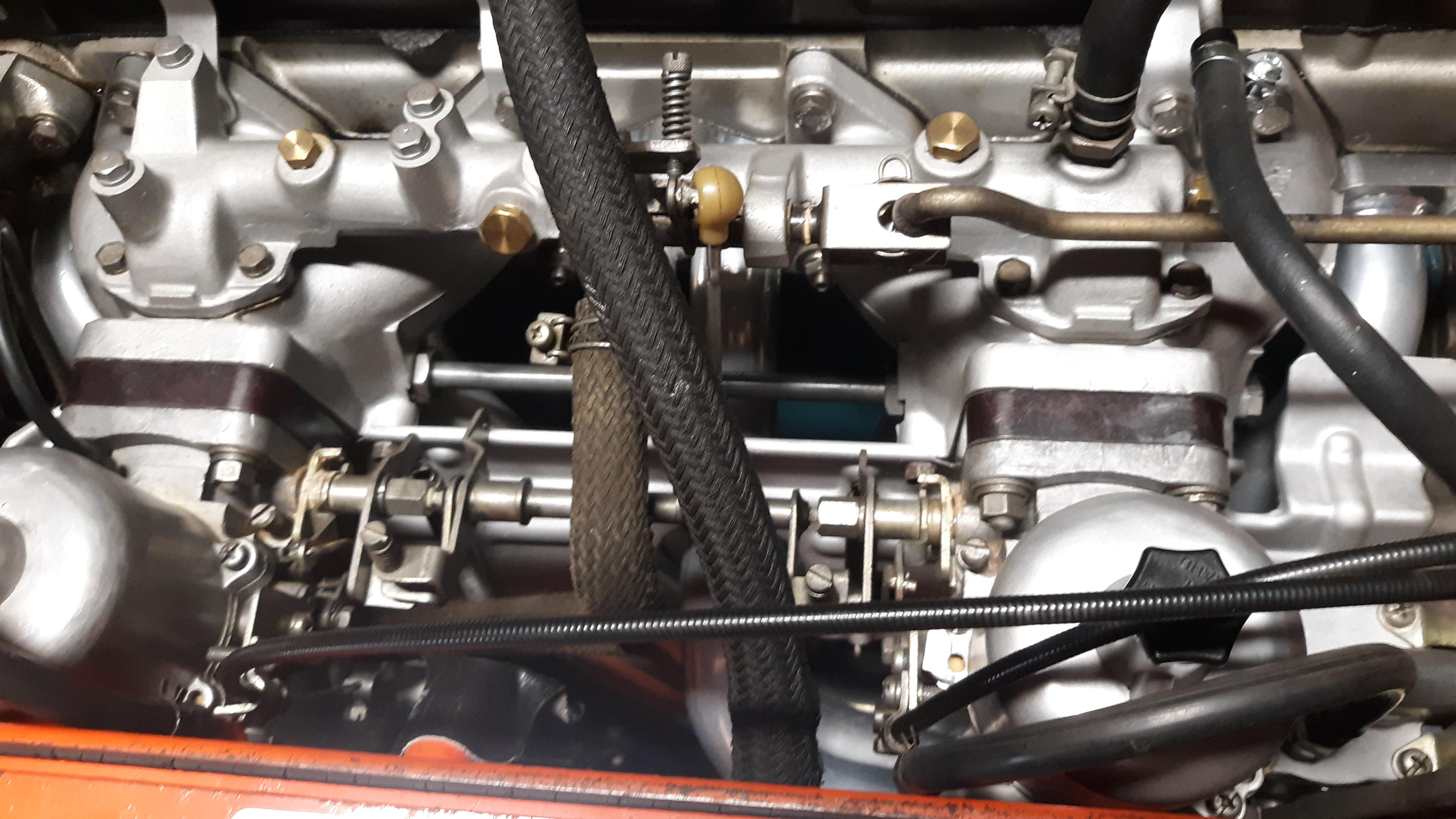

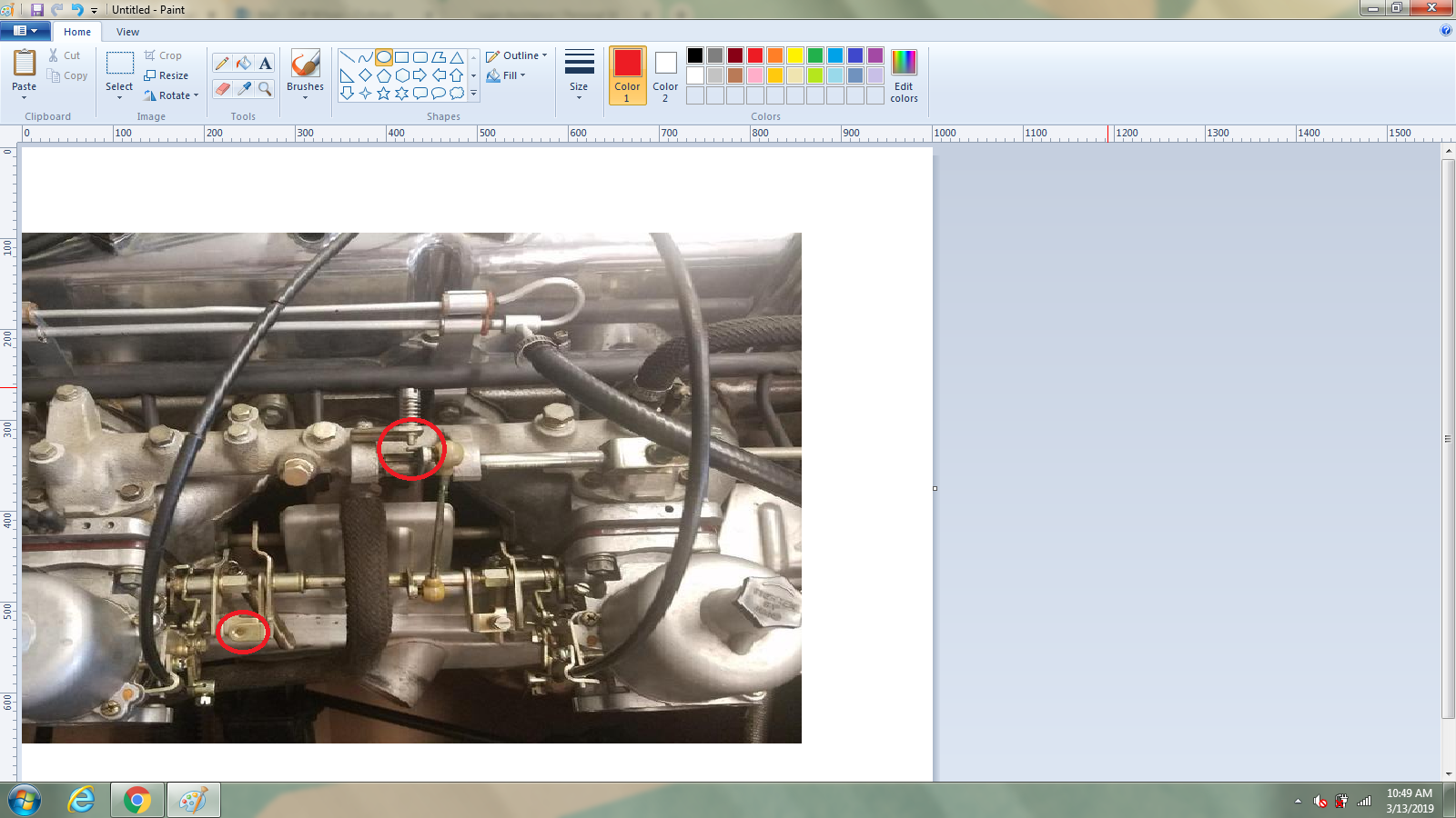

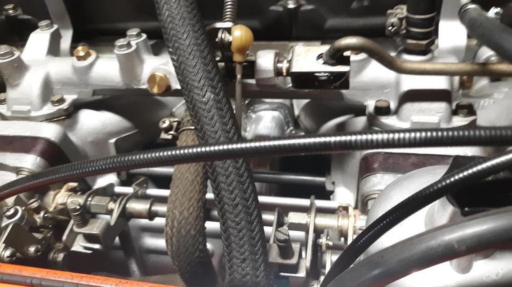

Hard to tell but heres mine. there's a screw missing on the front carb stop on your first pic.

There are zero threads to adjust the ball linkage, would need to bend to shorten the length. Purchased that linkage, not original to the engine. Had to reinstall the old throttle linkage rod off the split balance tube on the early single tube. The single tube linkage rod was too short would not reach the linkage rod coupler from the firewall.
It was my understanding on the balance linkage between carbs, only one balance adjustment screw (lower screw) was needed.
