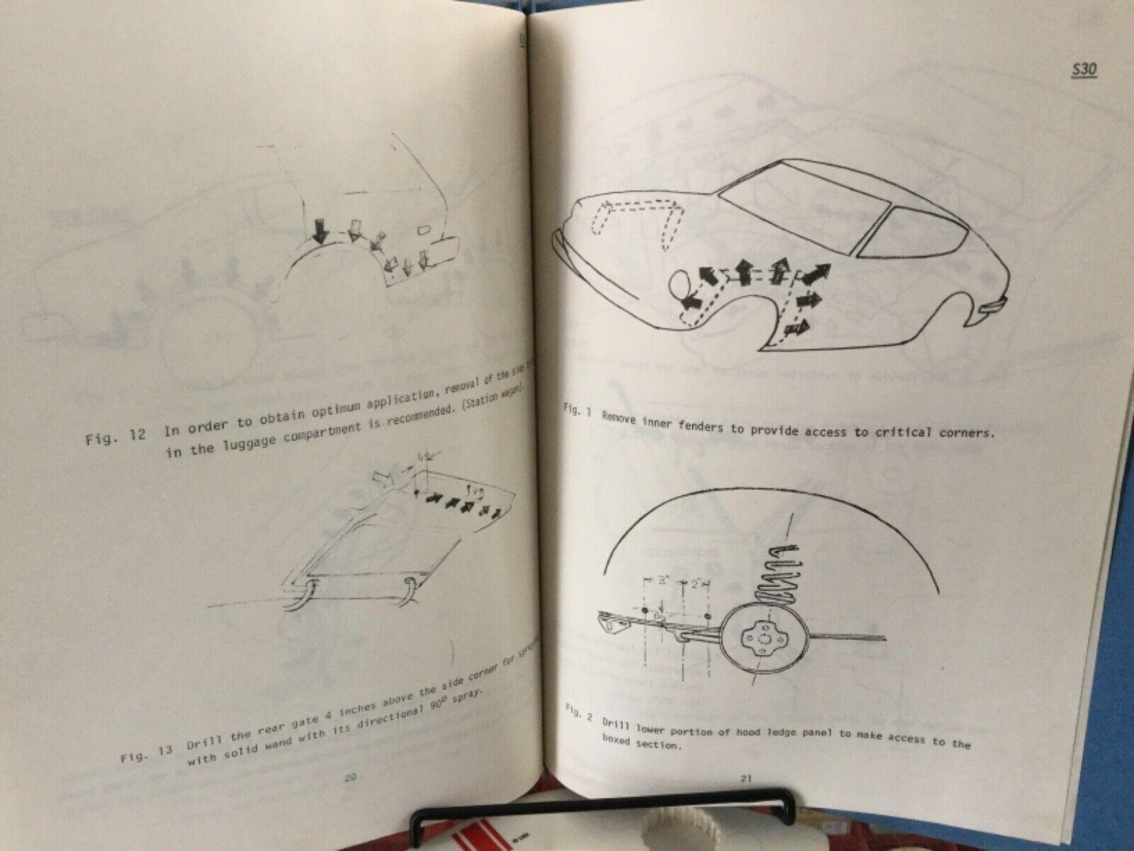

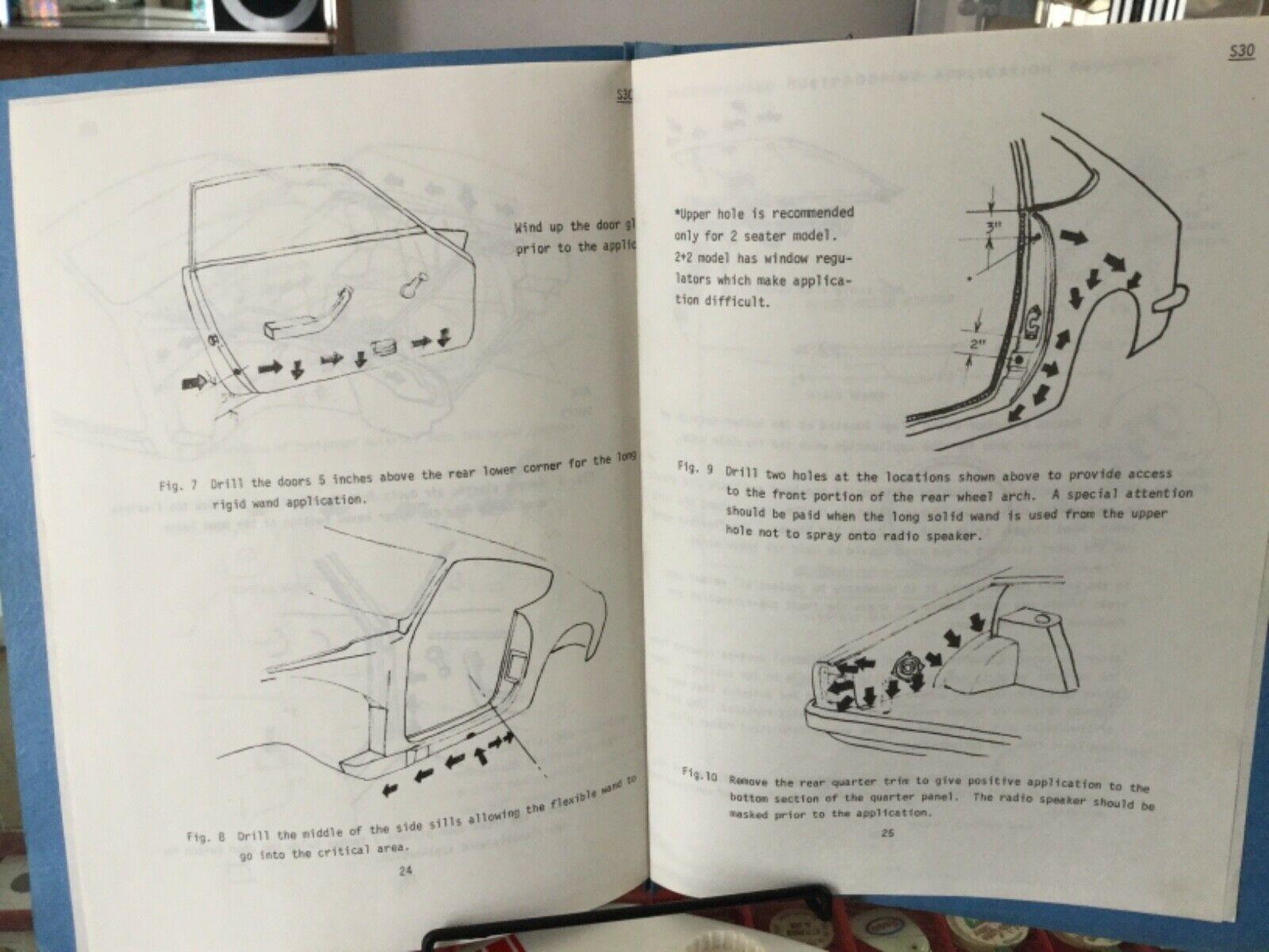

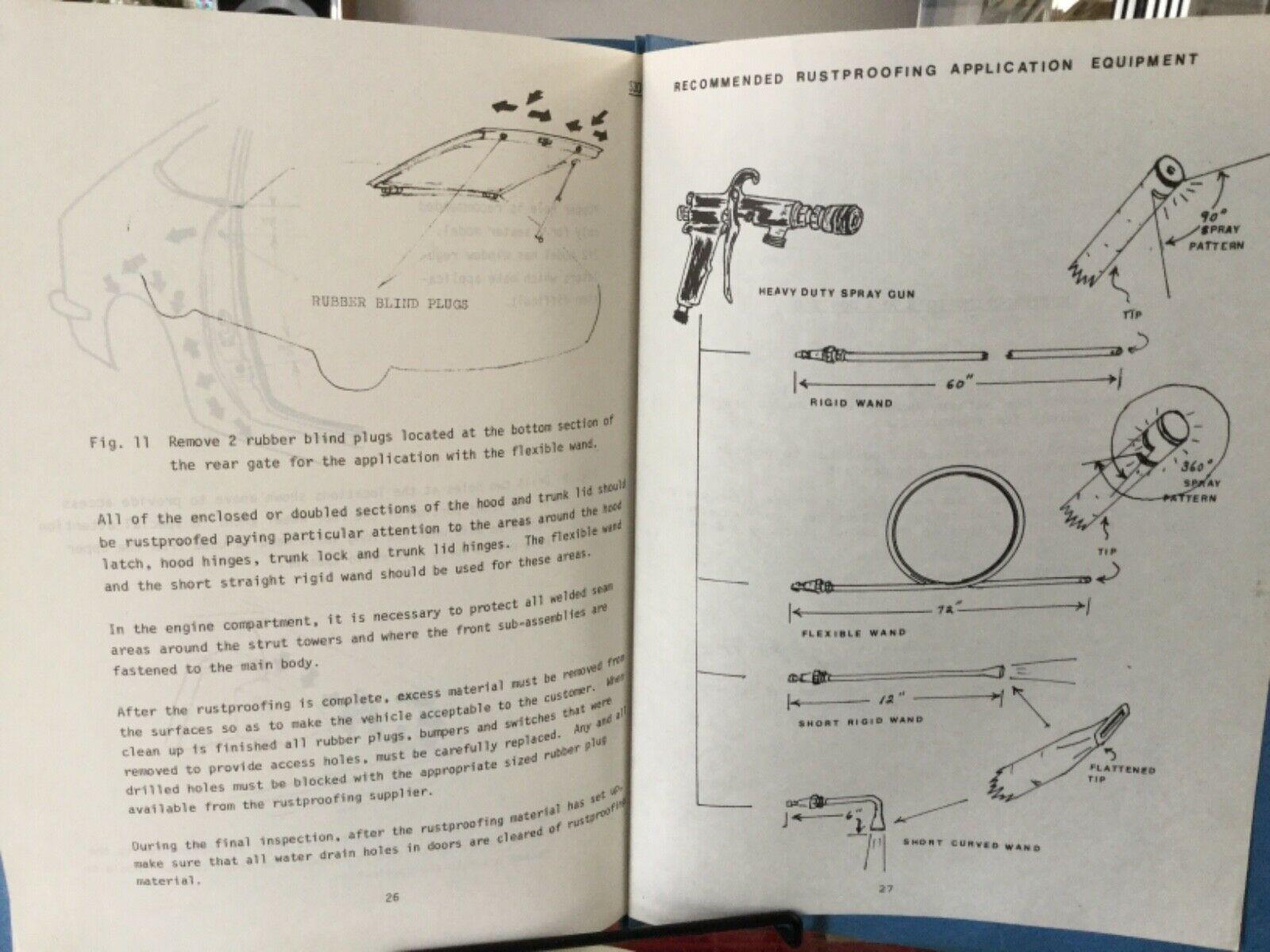

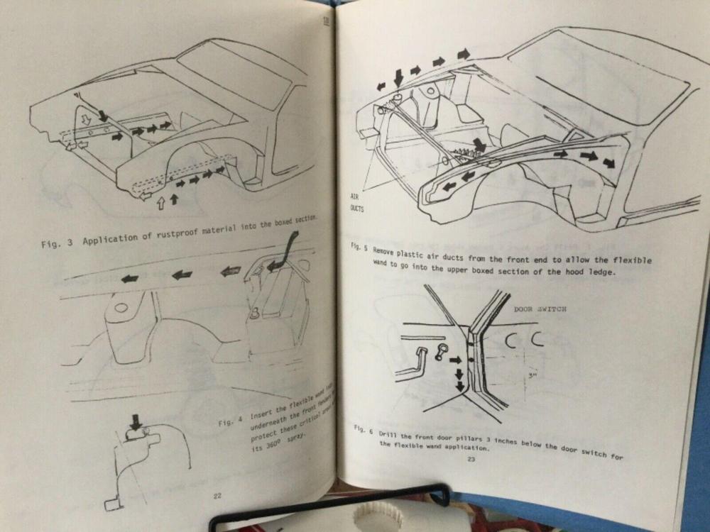

Blue , I really enjoyed seeing this manual ,
this is telling exactly the locations where the rust spots can be seen most of cars , including my Zs . I am now wondering did we have similar treatment at the Nissan dealers back in 70s in Japan ?

Whoever wrote this manual back in the day had a nice understanding of the Z's prospective corrosion spots.  There are some places missed, though:
  • lower boxed section at the rear of the front frame rails (behind the T/C rod bracket)
  • underfloor reinforcement rails
  • underside of hatch floor, where the floor meets the rear valence panel
  • inner cavity beneath the rear hatch sill plate
  • full perimeter of the hatch cavity (not just the trailing edge)
  • windshield posts
  • front cowl (esp. along all the seams)
