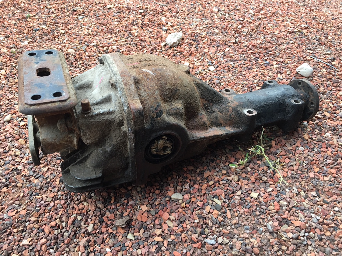

And yea I almost didnt believe it when I saw that zx diff for 500 on eBay I was thinking that's probably open diff longnose r200 because the legit longnose  is so rare I believe it was legit but would it even hold up to 300hp without being rebuilt?  Definitely gonna check out Whitehead like wheee! Mentioned
I would love to use the zx diff or whatever I can do to still use the longnose case so I don't need a new drive shaft .. again lol just dropped 500 to get this one made, all new drive shaft, not a mix of stock and new parts! Definitely gonna want better Axel's tho!
This option seems like a good one.  A reputable manufacturer.  It's a carrier swap so a little more involved than a bolt-in Whitehead diff.  It's new, not used, although Nissan diffs seem to last many many miles with no issues.

The 1988 300ZX turbo diff was an R200 3.70 CLSD unit. Hard to find but great for up to 400 hp before you needed to rebuild the half-clutch pack to a full clutch pack.
Add the RT style diff mount and she is good to go.

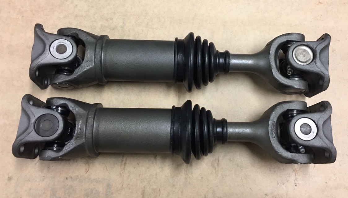

The factory half shafts will support the same amount of power no problem. But yes, CV’s are in the future!
