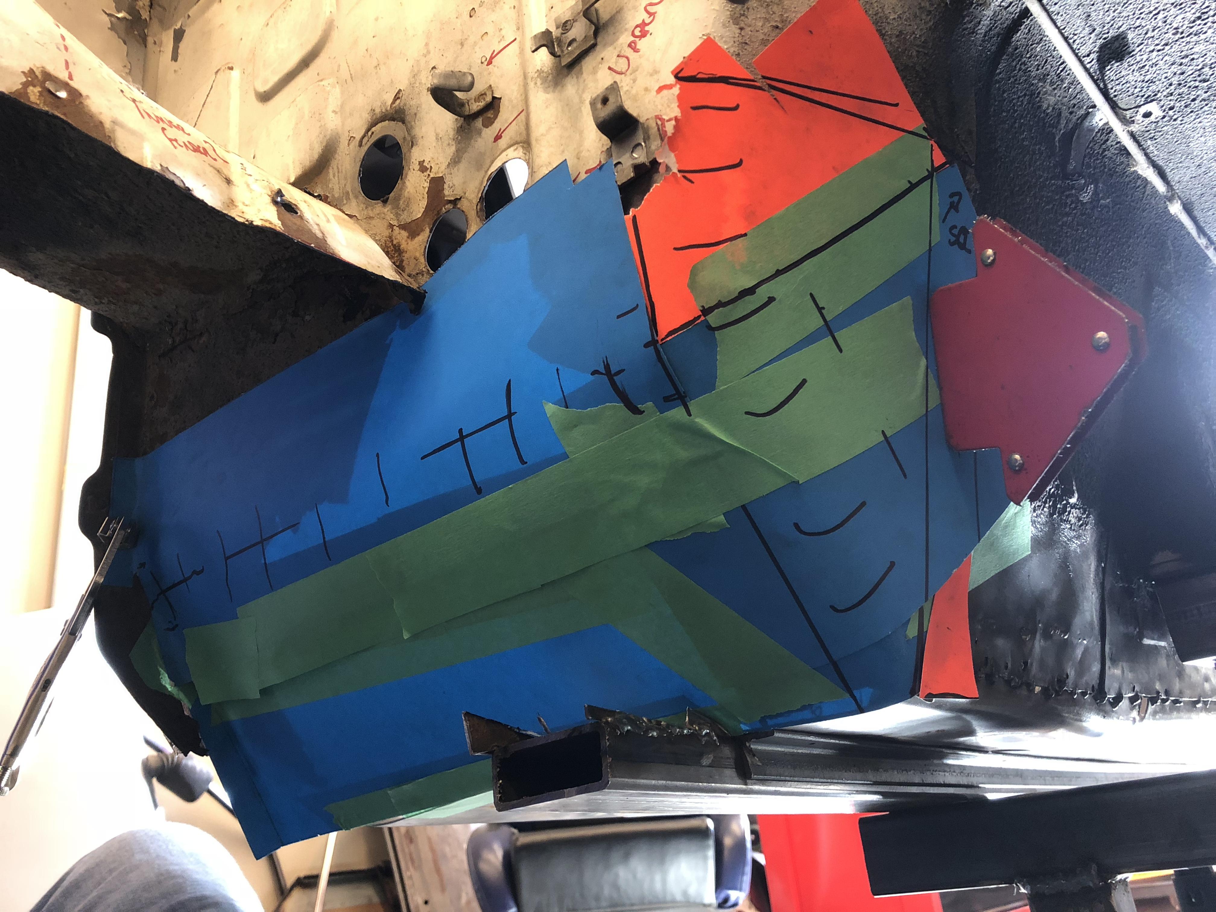

Rail cut out easily enough though ....
514EDE06-EA0B-4B8C-A61B-5193B1B8DEA6.jpeg‘
Check out all the rust that came out of this rail ....
+1 for the jig.  Glad I didn’t try to put that directly on to the rotisserie ....
The really scary part is that use to be metal and the frame is directly weaker for that lack of metal. Plenty of Z's out there with similar unseen weakness.
There are a couple of areas in those pictures that are especially hard to repair. The compound curves in the foot well and the compound curve area under the battery tray. Will be interesting to see how you approach those. You obviously have good metal skills.
Thanks Patcon.  Yeah I knew the rail was bad, but holy crap Batman - I was surprised HOW bad ?

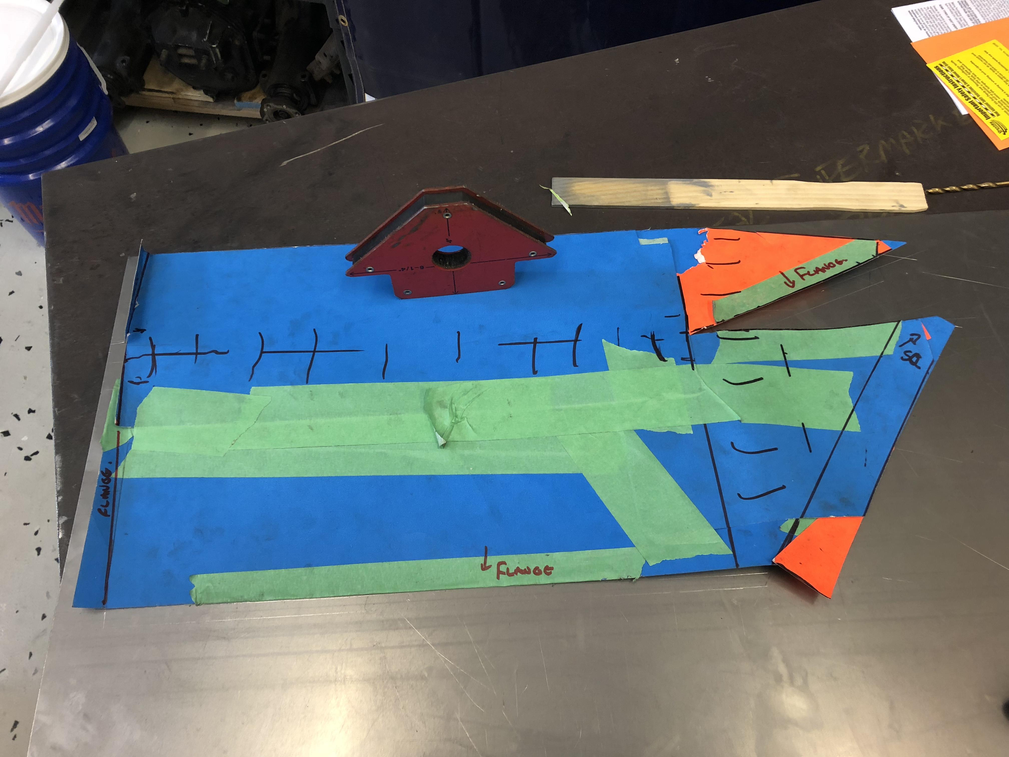

Didn’t have too much time today but got the passenger firewall patch fabbed up ....
Cardboard pattern ....
Traced onto some 20 ga ....

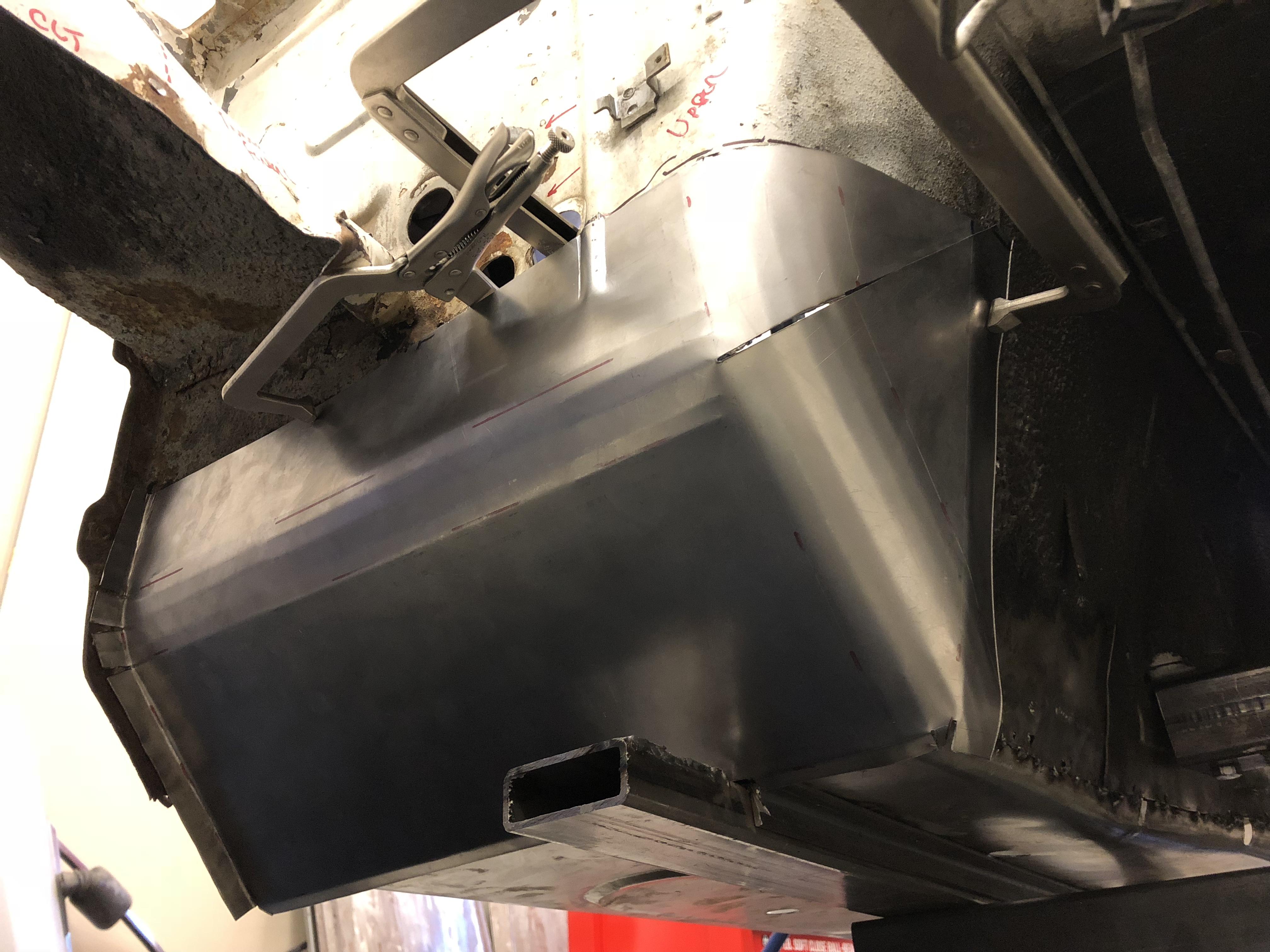

Rough bends on the brake ....
And clamped in place ...
Pfffft... how are you gunna run your coolant lines with clamps in those holes! amateur....! ROFL
Yeah, no kidding. There's no way the hoses will fit. A rookie mistake.
Give the guy a finger brake and a MIG and suddenly he thinks he can make stuff. He'll learn.   LOL
