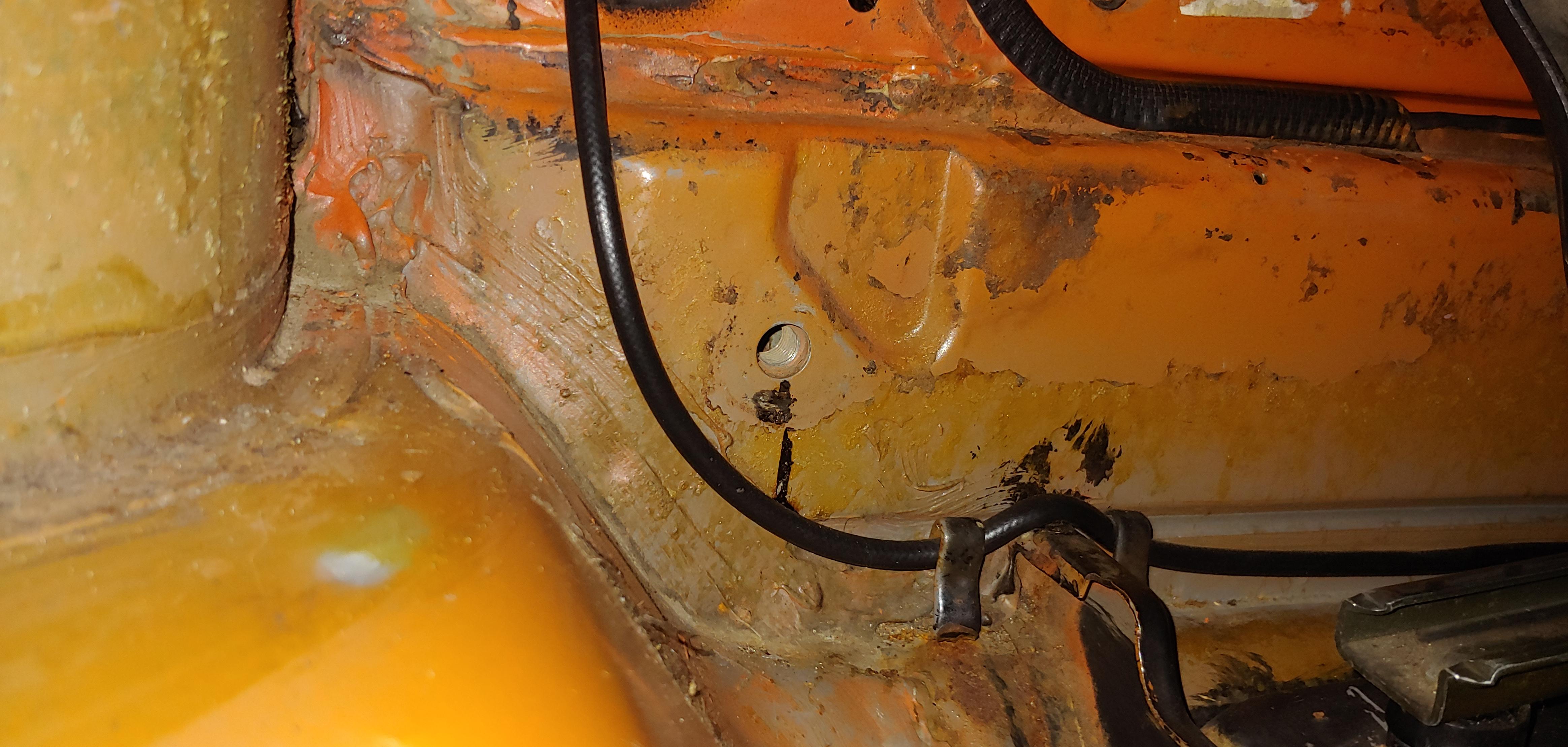

Good score, here's a bit of info. Your part 76411-N3600, is for a 260Z, 70-73 240Z would be 76411-E4600.  The 240Z inner has a different depression at the seat belt attachment bolt point. Here's what mine looks like in that area:
Awesome -thanks for the info.  Both my 240 shells have the same depression as yours so it makes sense that it is from a later car
