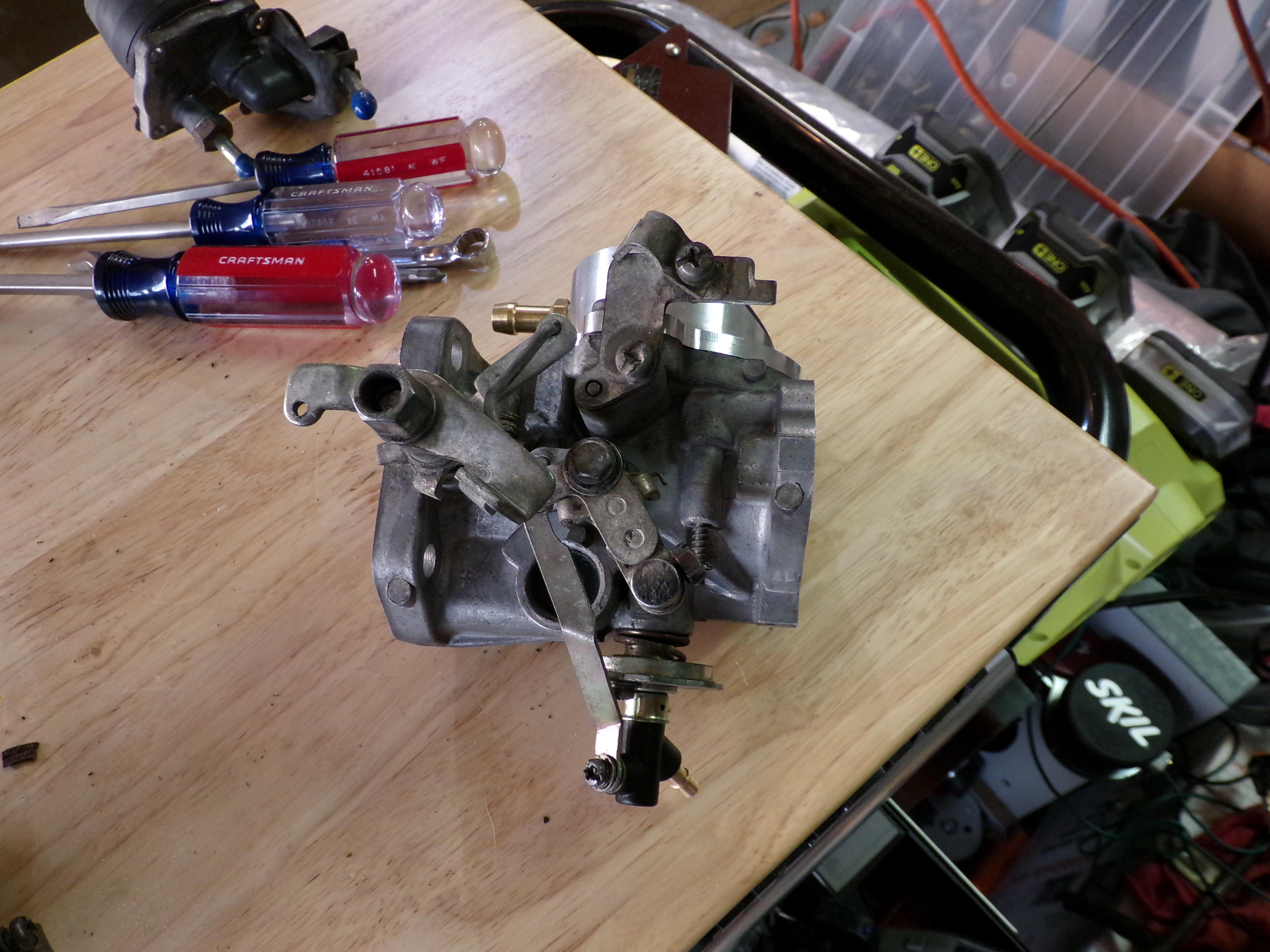

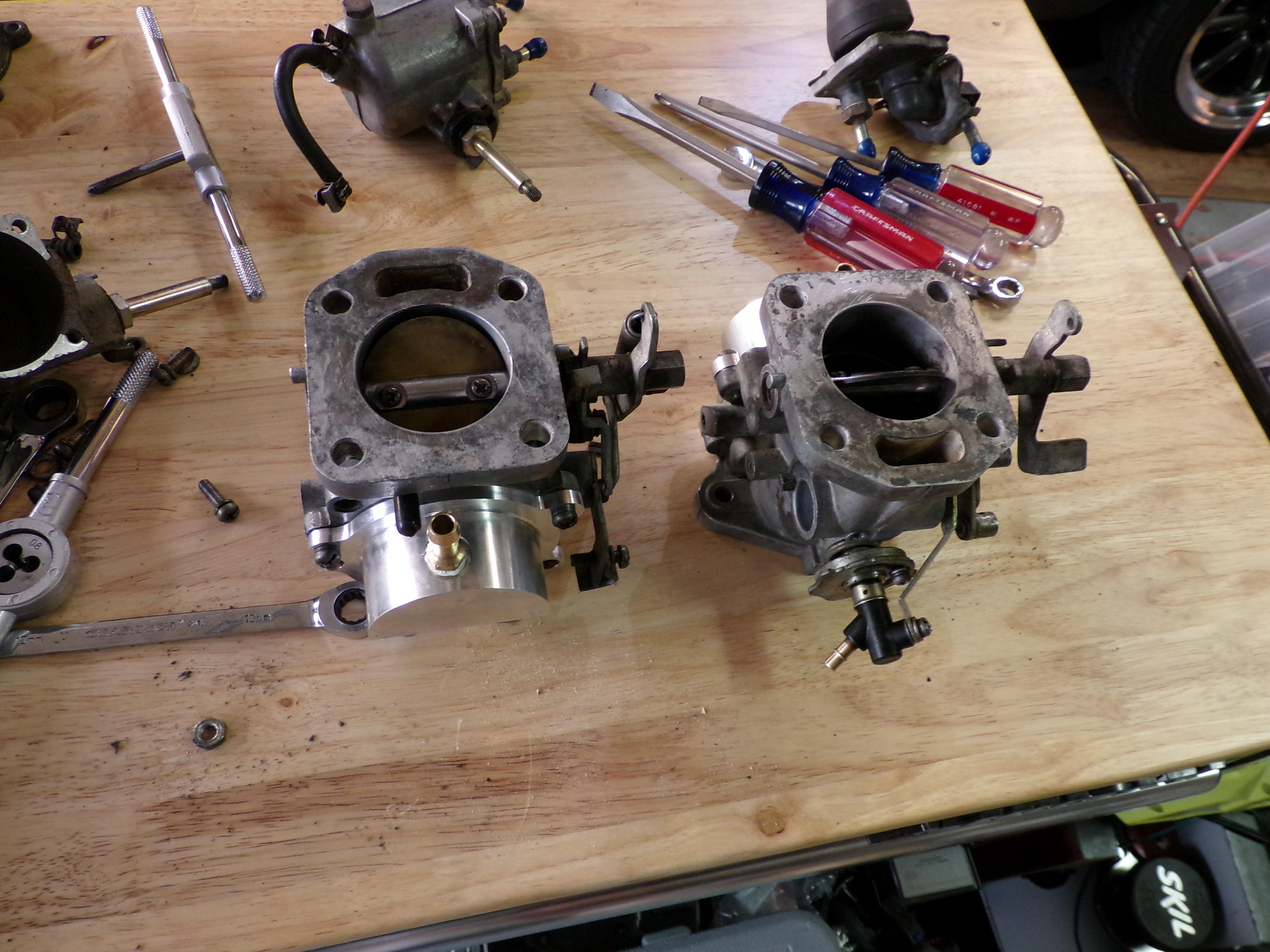

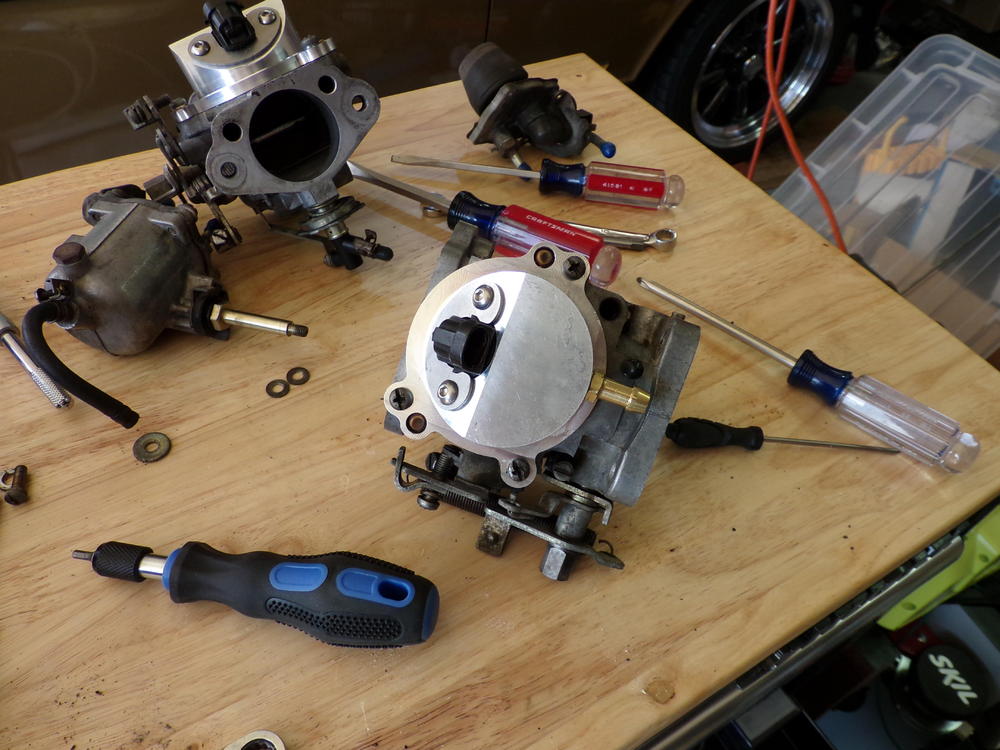

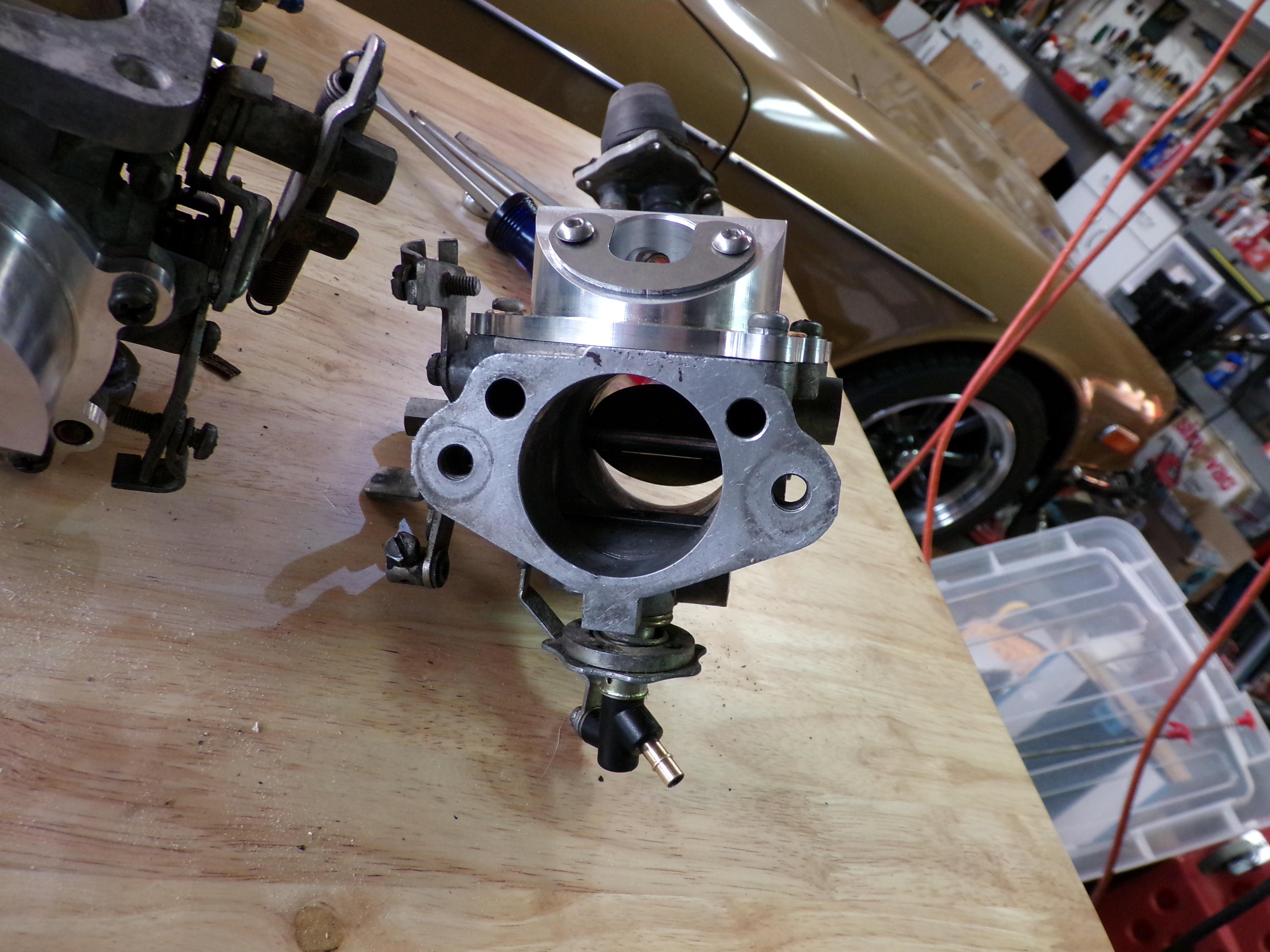

July 2, 20195 yr Author comment_578842 And I have finally started, albeit slowly. I removed the domes and fuel bowls from the carburetors and installed the fuel injector adapter plates. For more details, here's a link to my blog: https://fiddlingwithzcars.wordpress.com/fuel-injection-patton-machine/ Link to comment https://www.classiczcars.com/forums/topic/61372-patton-machine-fuel-injection/?&page=2#findComment-578842 Share on other sites More sharing options...

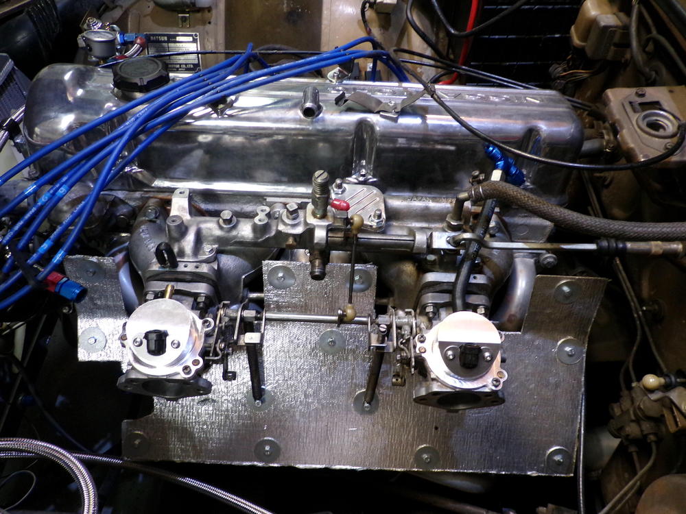

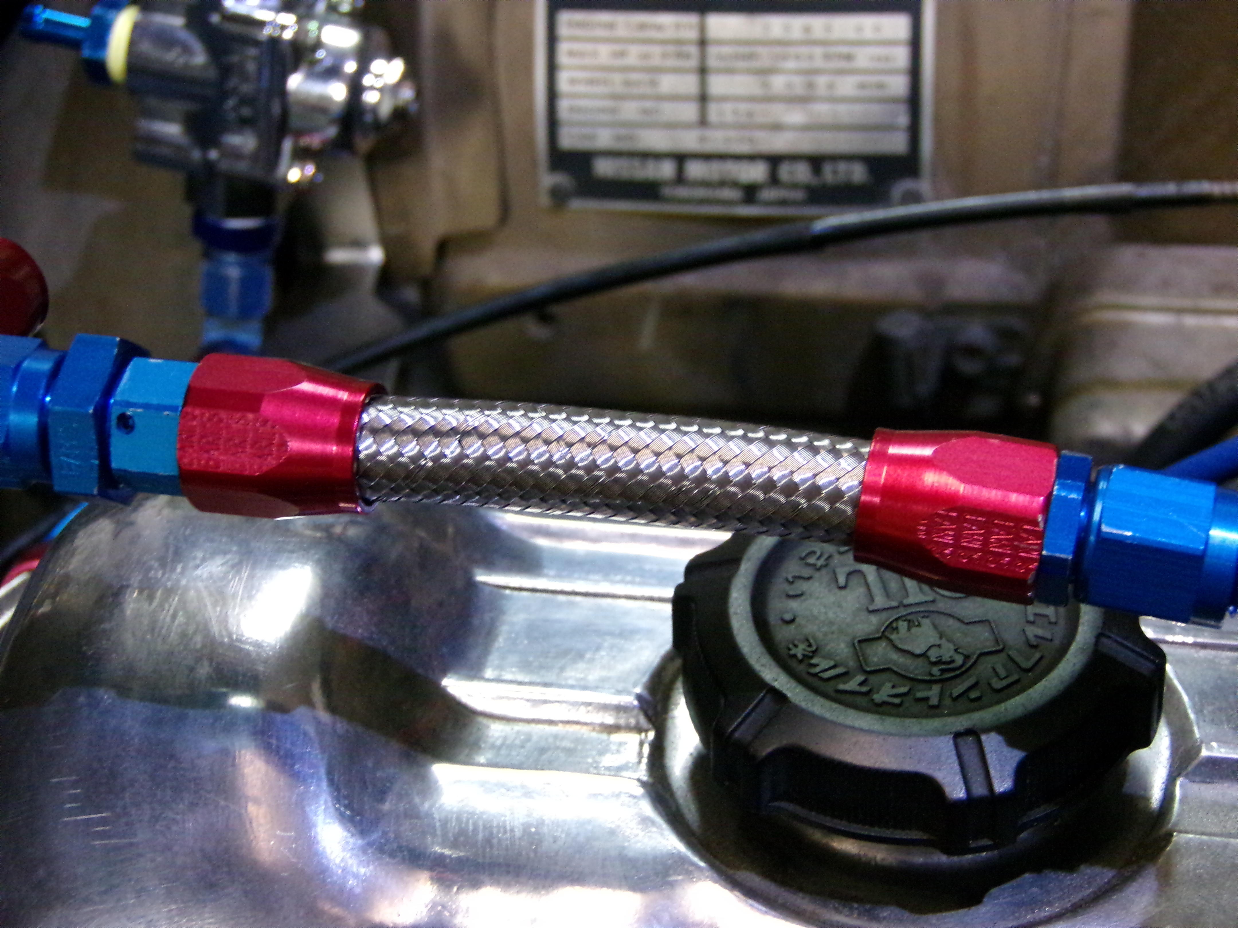

July 3, 20195 yr Author comment_578899 So today was more frustration than success. That's how these projects can go sometimes. I determined that I do NOT like how the fuel pump supplied with the kit would be situated in the stock mounting location. I put a 280Z fuel pump on order to remedy that. I also found that I have no natural talent for installing AN fittings on braided lines. At least I have the injectors mounted in the throttle bodies, and the throttle bodies are in the car. Read the details here: https://fiddlingwithzcars.wordpress.com/fuel-injection-patton-machine Link to comment https://www.classiczcars.com/forums/topic/61372-patton-machine-fuel-injection/?&page=2#findComment-578899 Share on other sites More sharing options...
July 3, 20195 yr comment_578903 Did you design and fab the heat shield, or did you purchase? Link to comment https://www.classiczcars.com/forums/topic/61372-patton-machine-fuel-injection/?&page=2#findComment-578903 Share on other sites More sharing options...
July 3, 20195 yr Author comment_578913 4 hours ago, jonathanrussell said: Did you design and fab the heat shield, or did you purchase? I designed and fabricated the heat shield. It is aluminum with "Thermo-Tec 13575 Adhesive Backed Aluminized Heat Barrier" (can be found on Amazon). After I installed headers, I found a lot of heat coming up between the carburetors with the stock heat shield. This heat shield dropped the temperature between the carburetors by about 100 degrees F. Link to comment https://www.classiczcars.com/forums/topic/61372-patton-machine-fuel-injection/?&page=2#findComment-578913 Share on other sites More sharing options...
July 4, 20195 yr Author comment_578973 Okay, the page has been updated with Day 3 activities. I figured out how to do AN fittings today. It's hard to believe that I'm the same person as the idiot who couldn't do it yesterday. I also hit a minor stumbling block in that the fuel pressure gauge has a 1/4" NPT fitting. I couldn't find an AN connector with a fuel pressure gauge port larger than 1/8" NPT (and I already have one of those), so I ended up ordering another fuel pressure gauge that has the same range as the one supplied by Rick but with the 1/8" NPT fitting. Edited July 4, 20195 yr by SteveJ Link to comment https://www.classiczcars.com/forums/topic/61372-patton-machine-fuel-injection/?&page=2#findComment-578973 Share on other sites More sharing options...
