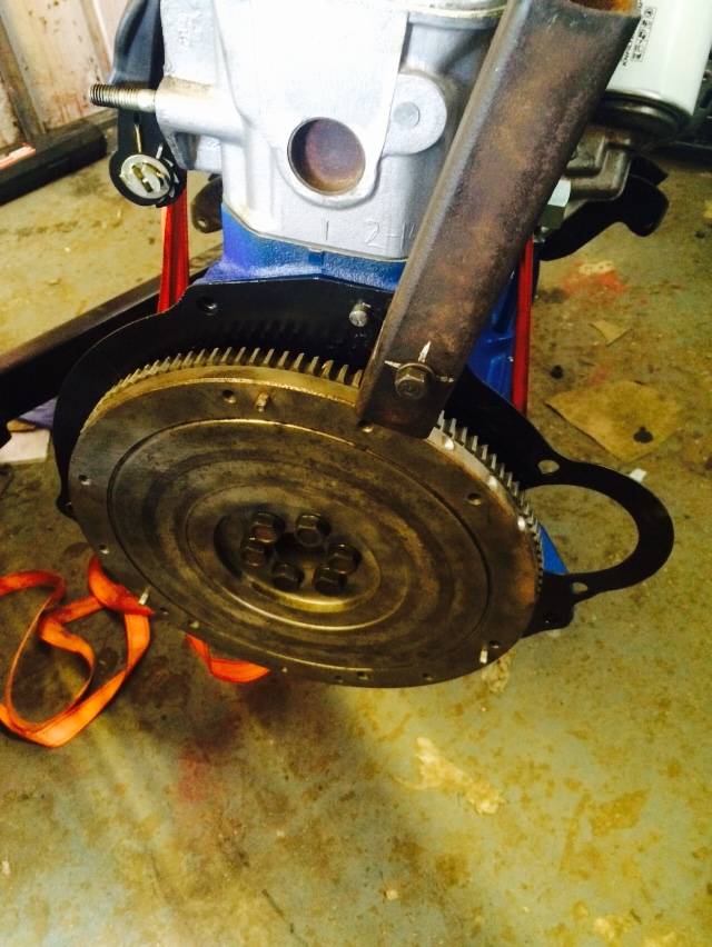

I use a length of box section bolted to the block to lock the flywheel:

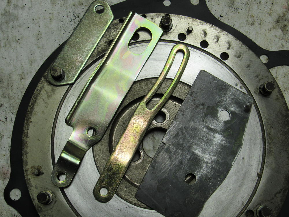

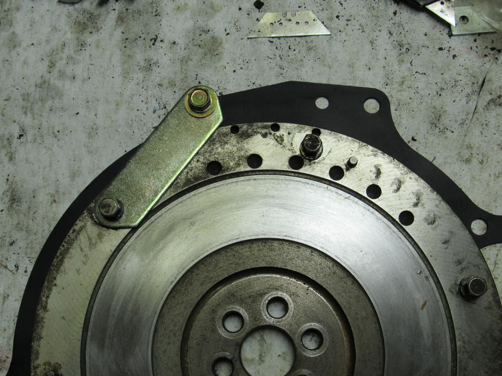

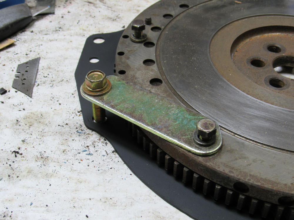

This method was posted by one of the members here years ago, I can't get access to the back of the L28 at the moment but I think you'll get the idea. Our cars come with many pieces that will do the job well, even a scrap of metal with 2 holes drilled in it will work,  You don't have to tighten the bolts hard and it best to use a spare bolt for the engine block hole just in case it bends  a bit.  Better a 25 cent bolt that a flywheel ring gear.
