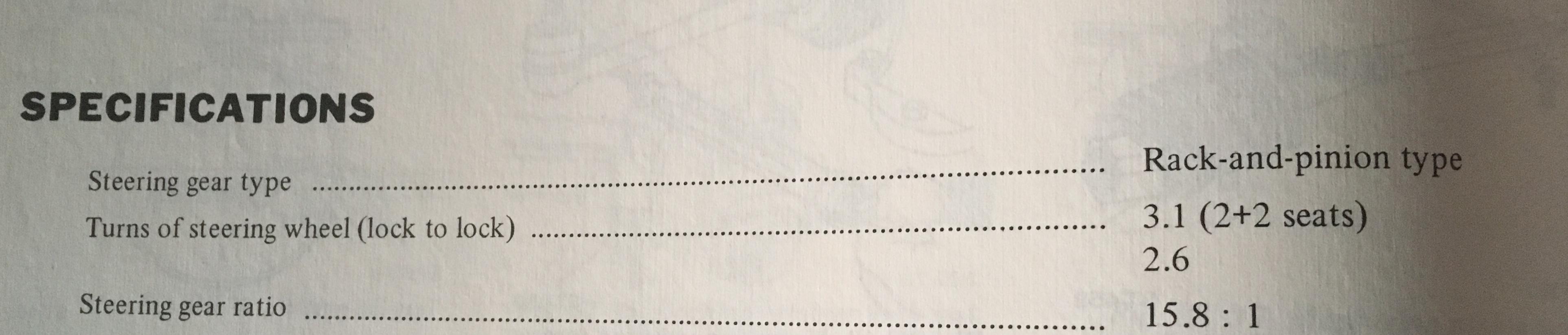

I only looked at the years in question on the rack specs and they are the same by FSM year.  But, maybe, as you found, you have a 15:1 (actually 15.8) instead of 18.

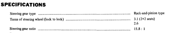

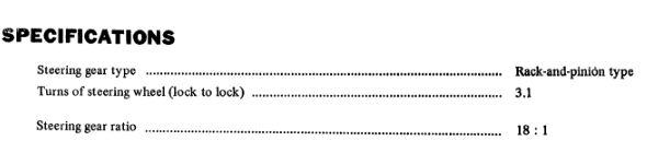

Here's 1976, and 1977.  Maybe you have a 76 rack.  I don't feel so wimpy anymore.  I assume the higher number is higher mechanical advantage?  Not sure.
Zed Head, My 77 manual says 18.0 ratio. Both .pdf and hard copy. Are you sure you were looking at the 77 manual?
I posted a picture of the 77 18:1 below the 76 15.8:1, in my post #13.   By "as you found", I meant what you found in the early FSM.  I was trying to say that maybe you have an earlier rack, 1976, with the 15.8:1 ratio.  1977 was a change year.
