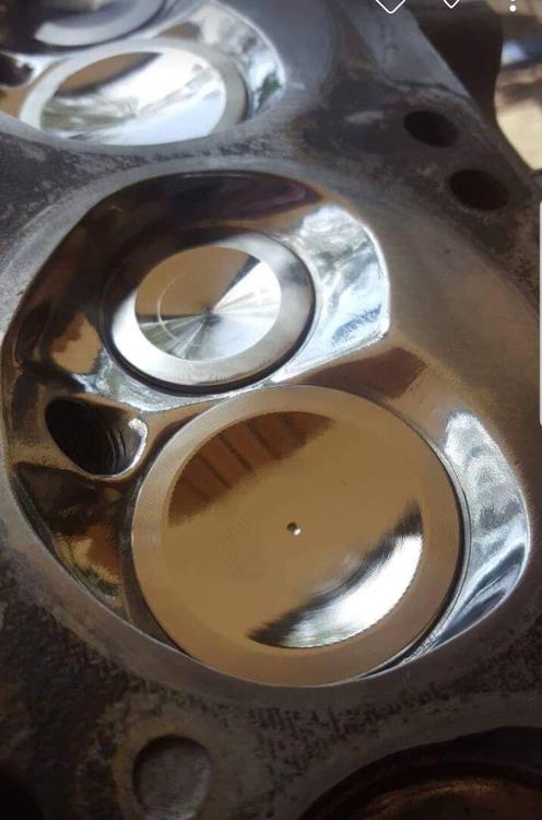

Here’s an E88 Efi Head with 46mm intake valves so it can be done. This head was/is on a 88mm bore L28. Don’t know if i really would need to go any bigger then 44mm. It’s not a race car i’m building but i don’t want to go to small either.08334783-0272-416E-96BD-AAA2C1BF006F.jpeg6F20D818-508C-49DE-A4D2-8905B3C7C823.jpeg
IMHO - 44 for your engine size . If it was a bigger liter motor , or you were planning on spinning it way up high rpm , then maybe bigger valves . Can you go too big - I doubt it , so no time then the present to cover all the bases .
Quite sure you can buy valves from Rebello - and he would give some free advice since your buying ?
