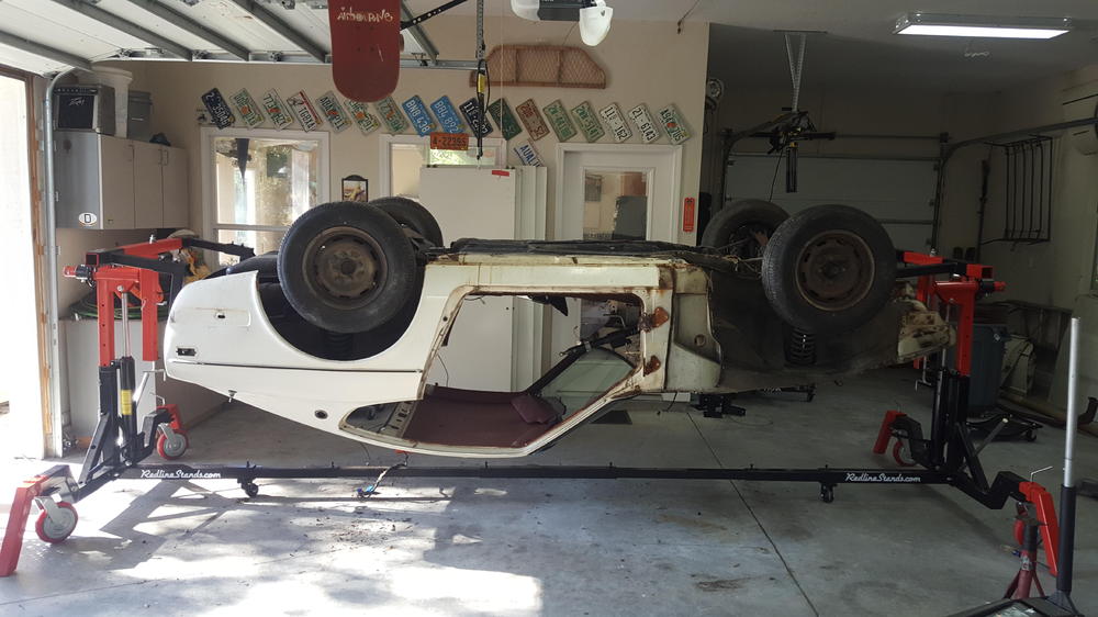

October 19, 20186 yr comment_559853 I'm about to replace rails and pans. car is on a rotisserie. My question is, when removing them, does the frame need to have bracing welded in to keep the shape of the car intact? Link to comment https://www.classiczcars.com/forums/topic/60467-replacing-floor-pan-and-rails-with-enginetranny-in-place/#findComment-559853 Share on other sites More sharing options...
October 19, 20186 yr comment_559854 A 280 has a stronger trans tunnel brace built in. A 240 might need bracing. I would also recommend you remove the running gear from the car while it’s on the rotisserie too... that’s a lot of weight. Link to comment https://www.classiczcars.com/forums/topic/60467-replacing-floor-pan-and-rails-with-enginetranny-in-place/#findComment-559854 Share on other sites More sharing options...
October 19, 20186 yr comment_559855 Just now, wheee! said: A 280 has a stronger trans tunnel brace built in. A 240 might need bracing. I would also recommend you remove the running gear from the car while it’s on the rotisserie too... that’s a lot of weight. Yes, I'm removing everything, doing a full restoration. I was on Youtube and it didnt seem people were putting any cross bracing in, but I figured someone here would have a clue. Car is empty except the suspension and wheels. Link to comment https://www.classiczcars.com/forums/topic/60467-replacing-floor-pan-and-rails-with-enginetranny-in-place/#findComment-559855 Share on other sites More sharing options...
October 19, 20186 yr comment_559856 Link to comment https://www.classiczcars.com/forums/topic/60467-replacing-floor-pan-and-rails-with-enginetranny-in-place/#findComment-559856 Share on other sites More sharing options...
October 19, 20186 yr comment_559857 As you have already heard, work on small sections at a time, don’t take out both floor pans at once etc etc. Link to comment https://www.classiczcars.com/forums/topic/60467-replacing-floor-pan-and-rails-with-enginetranny-in-place/#findComment-559857 Share on other sites More sharing options...
