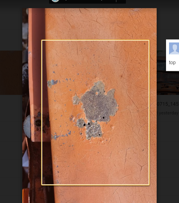

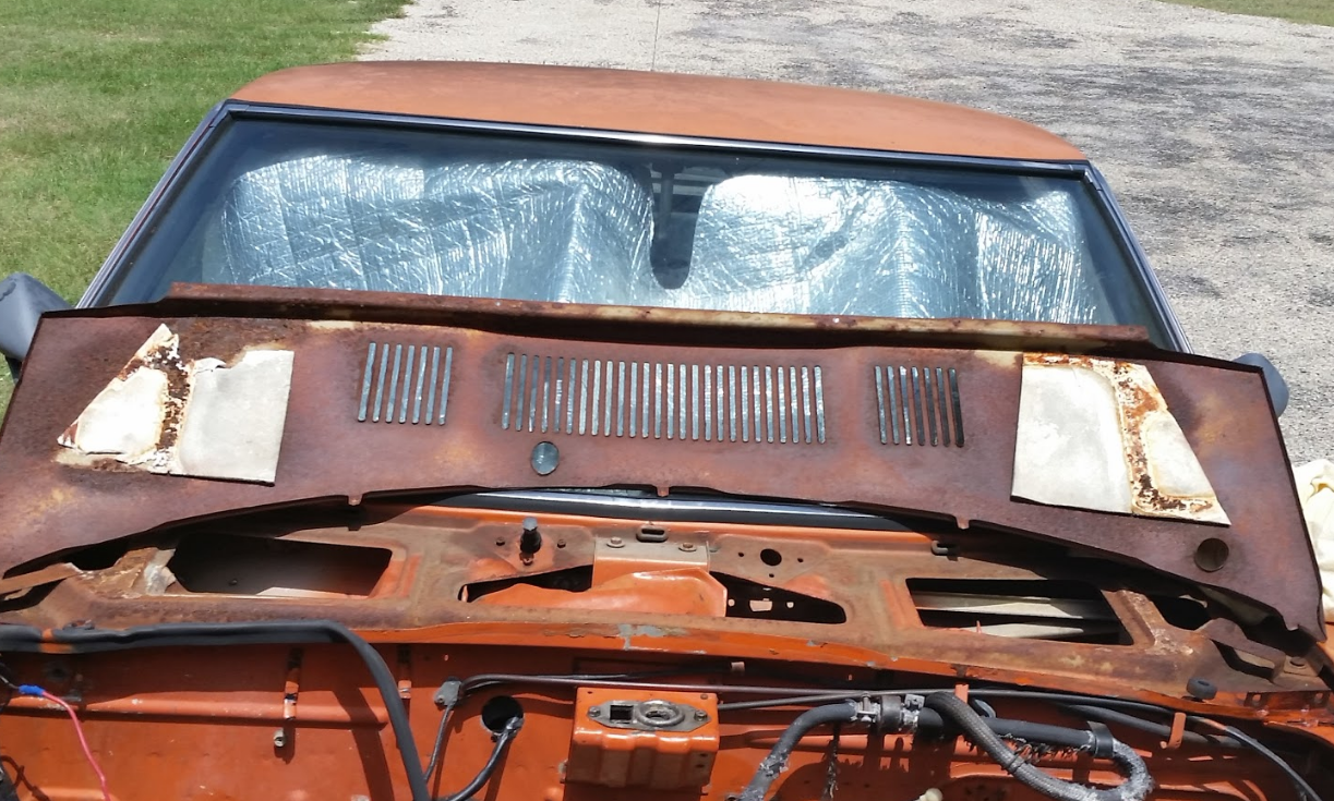

I just removed that panel below the windshield where the wipers come out.  I noticed some kind of foam on the  inside edges.  Does anyone know what that stuff was for  or what I should replace it with?
The photo is on my google drive here.  First time trying this shareable link on the forum.
https://drive.google.com/open?id=13KxGJFvrIMpDghKjs5d3Uya8ajS48ZJR
It's a thin foam. I believe it is to prevent rattles.
Also it is always better to upload the pictures to the site. Mike will preserve them for posterity. We have had more than one thread go bad when the hosting site links were broken
I used a closed cell craft foam from places like Mart and Hobby Lobby to replace mine.
My advice is: remove the foam, deal with the rust underneath, and DON'T replace it...  I seriously doubt you'll notice a difference (except the lack of a place for moisture to collect).
We've seen numerous cowls from clean - > cancerous rust from the underside up through the top.  IMO that was a lame stop-gap idea that served no real purpose other than ruining a lot of perfectly good cowls.  If you feel the need to dampen that particular part of the cowl I think you'd be better off using a truck bed "liner" type material that you can brush or roller apply.

It is a high density foam pads. Standard on some of the early car possibly others. I have seen them several cars.
72 body with 71 interior, Eibach, Illumina, R180 CLSD, 83 close ratio, 3.90 gears, Zstory, SUs, BRE Libre wheels and front spoiler.
I just installed some noise absorbant rubber material on the underside of our kitchen sink.  If noise or rattle is the concern would that be something good to use.  This sink was from Ikea.
I plan on reinstalling the factory pads if possible. that is after I have removed the rust, neutralized and epoxy primered the underneath side.
That foam ended up causing me rust.  It must have trapped water on the underside and eventually it rusted thru to the top layer.  Admittedly it took 40 years but still it caused it.
