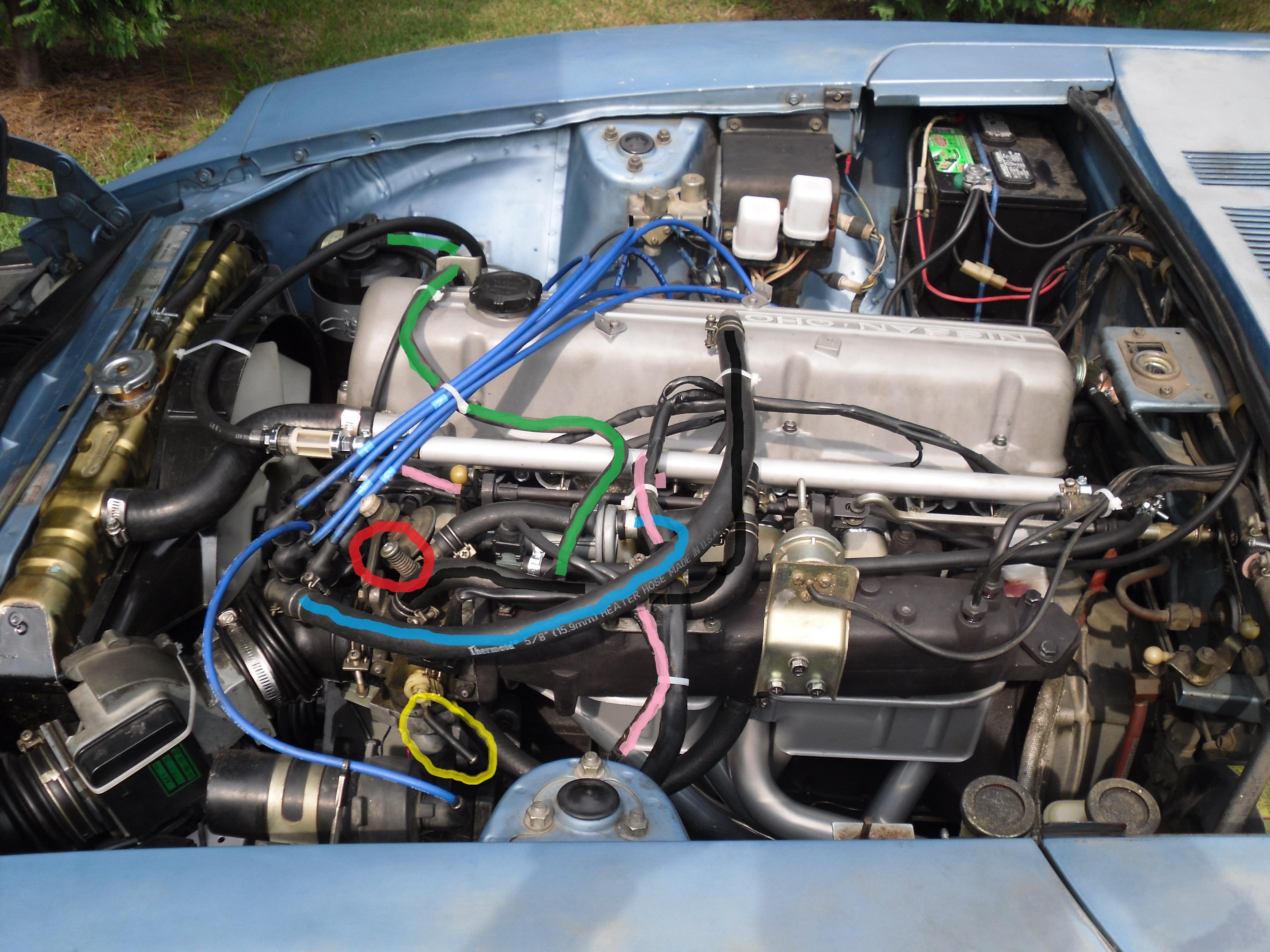

I kept the AAR.  EGR, BPT and the warming plate with the thermal switch were trashed.  I plugged the coolant lines to the warming plate and the hose on bottom of the throttle body that went to the BPT.  I'm pretty sure that's all I had to do.  You might be able to see in this picture?

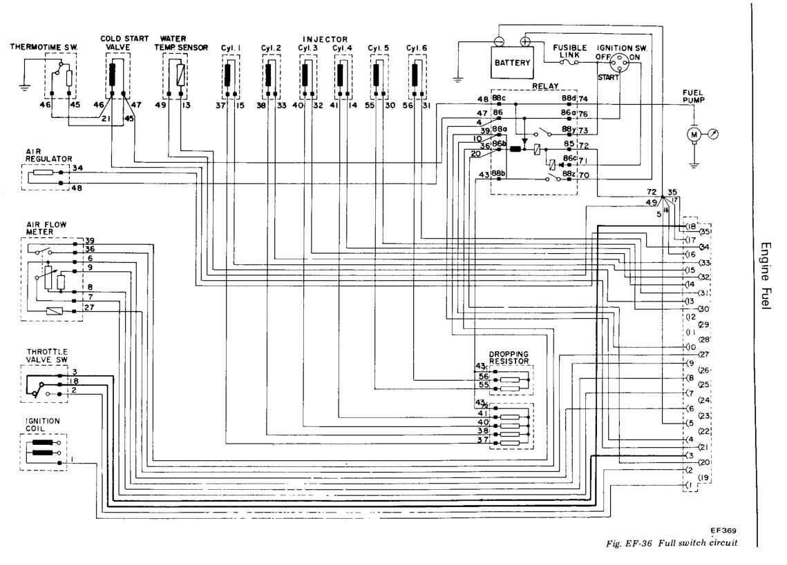

Fuel pump relay.  It gets power when the fuel pump gets power.   Learn, learn, learn....  Edit - but, apparently, the ECU grounds the circuit.  I'm still learning too.  Although, I have faint memories of some weirdness with the diagrams.  Can't remember the details.

Actually... Inside the ECU, the pin connected to the AAR is just hard shorted to ground. So they have the connection AVAILABLE to the ECU if they ever wanted to use the ECU to control the AAR, but they do not use it like that. It's just shorted to ground inside the ECU.
So other than the fact that the ECU has to be plugged into the connector, there's no real interaction between the AAR and the ECU. Anytime the engine is cranking or running, the AAR will be internally heating.

And as Blue mentioned above, the "normal - once warmed up" idle air comes through a passage built into the throttle body. It's the large headed spring loaded screw on the throttle body. You can see it in the very very bottom left of this pic:
