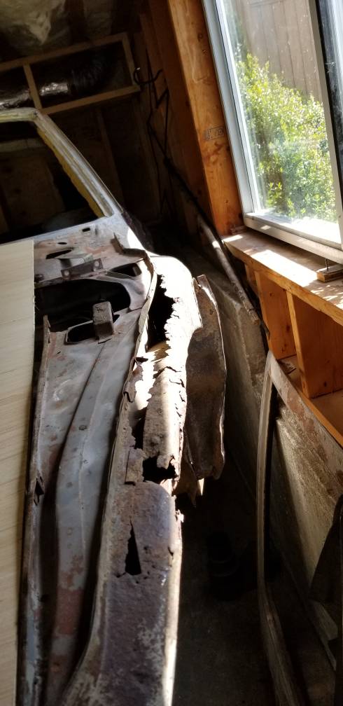

Got this car off my buddys cousin for the cost of fuel to grab it. It's got lots of goodies for it and a rebuilt 3.0 stroker but it's also got a lot of rust in all the wrong places. My experience with vehicles is generally wheeling and building trucks. I've done some sheet metal work and have all the tools necessary bit i have no idea where to start or if I should bother.... See attached pics of the worst and hardest repair. The rest is basic metal cut n fit. What are these top frames called. Can they be fixed? I've seen a couple cars with these cut off and tubed.... Help! 20180422_123811.jpg20180422_123806.jpg20180422_123759.jpg

Best way to go at that is just buy a whole front clip from the South West and replace from the firewall up. How is the rest of the car?
Thanks for those numbers! The rest of the car isn't bad. The floors are pretty much finished, there's some rust on the rear quarters but available patch panels for them and the rockers will take care of that. Other wise good to go. It's kinda wierd that they are that trashed. Way she goes I guess. I think ill look around for the panels, if not my buddy was just here and we had a look at hand building them with multiple pieces asking a bead roller. Will take fab time but will work. I just want her to be structurally sound. Being as its under the fender I don't even mind if it's boxed and not round.

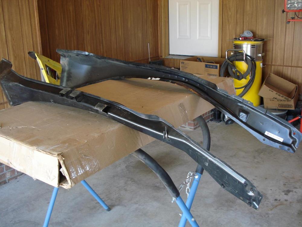

THe original air channels may be hard to find These days and probably quite expensive. but this is how my panelbeater repaired mine:
Before (cheap patched up ugliness):
and then:
Man those look amazing, exactly what I will try to do. Just need to figure out how to shape em! My only concern is structure... Im used a body on a frame, if i cut that thing up just as pictured will there be movement that could screw things up when finished? Would I be best to pull it off the rotisserie for a repair like that or should it be ok because there's still substantial steel helping fight any sag.

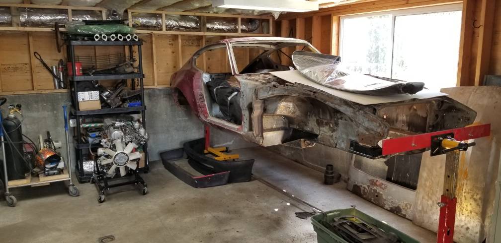

BTW - what is the lift that you have the car on in that last pic? Never seen something like that. Seems pretty convenient.

The lift is a rotisserie, probably home built. Makes it much easier to work on.

I would not make major repairs like that on the rotisserie. You need to set it down on blocks or jack stands. Then get a datum line to check the frame straightness. There is a diagram that gives all the frame dimensions in MM's

Yeah i would definitely take it of the rotiserie for that. as you can see in my picture, the car is standing on a chassis-jig (or whatever you call it) and put on a single-post lift.

Not sure who you're referring to. but in my last pic it's a single post lift from my bodyshop, and on top of it is the car complete with a full rolling chassis jig / Dolly. I got it off my rotisserie for serious bodywork. for reasons mentioned above.

That's a pair of engine stands I modified so they were vertical and sturdy! With a spreader bar in the middle at the bottom. Works great
