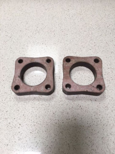

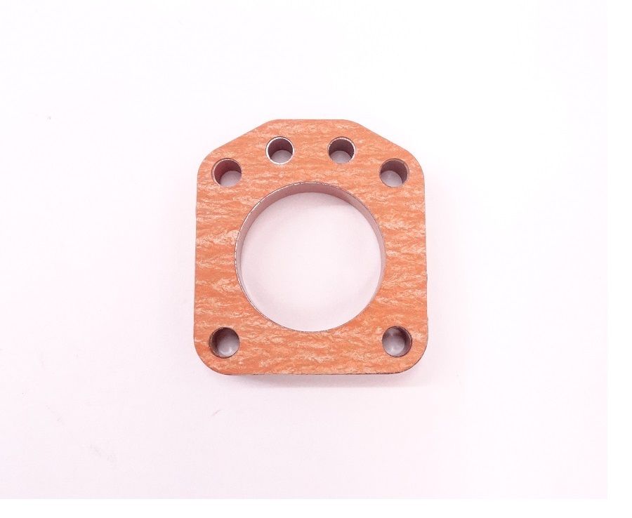

Yeah, look at your carbs rear side to see which you need.  I've always thought the pre '72 does not have the coolant passages?
That is correct.
8 hours ago, SteveJ said:
Coolant goes through the extra holes.
Make sure your manifold has the holes as well. And make sure the spacer goes on the right way. One hole is for water into the carb, the other for water leaving. If only I knew which was witch...
And now for something actually useful, (harhumfff...) I can help you with a pair of spacers. Llet me know if no one closer can help find you one.
