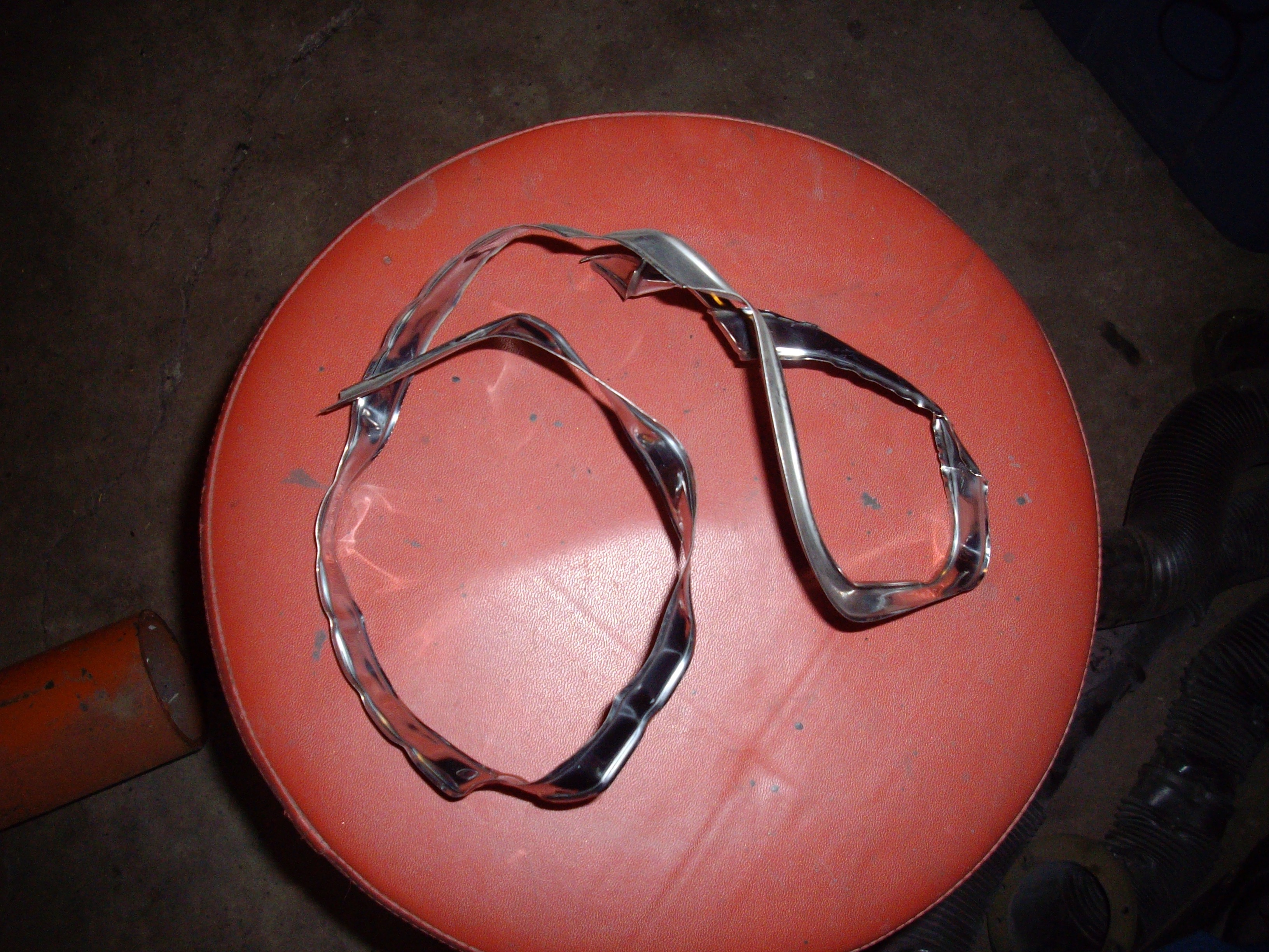

3 hours ago, 240dkw said:
I did the same thing with a piece of my front window trim. Could not straighten it.This is what it looked like after I stopped the buffer.
Those are nothing but a big razor blade spinning around!!!
I bought a new dual speed Eastwood buffer 1800/3600 rpm. The low speed allows you to buff plastic lenses. It also allows you to buff stuff like this at a lower speed. I should have turned it down sooner.
2 hours ago, psdenno said:
Yikes!!!  Looks like you set the buffer speed to 52,000 RPM.  :o
I've never used a buffer on trim pieces and am now afraid to do so in the future.
Dennis

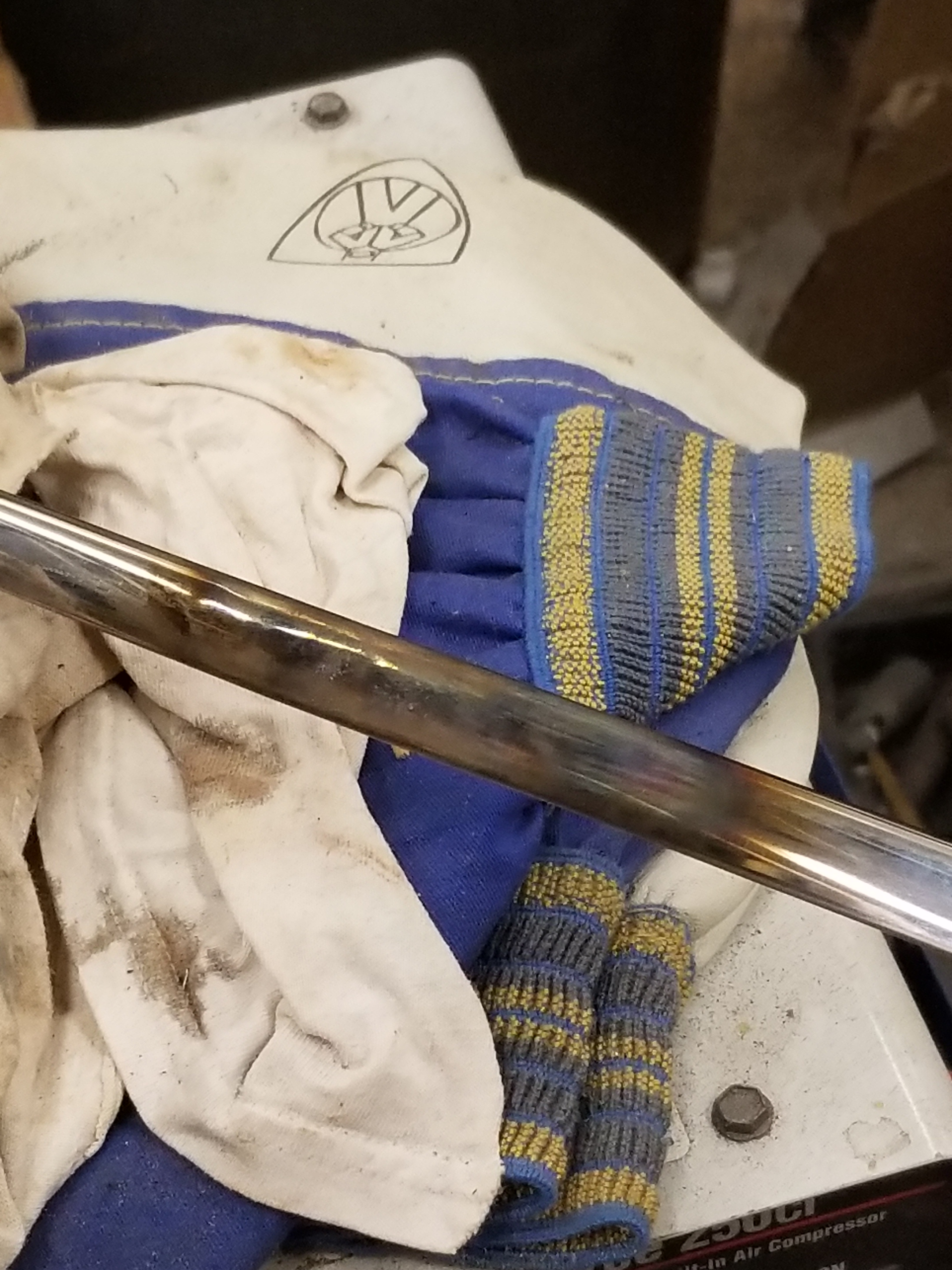

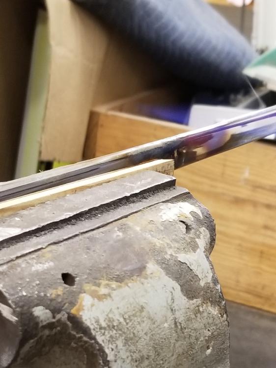

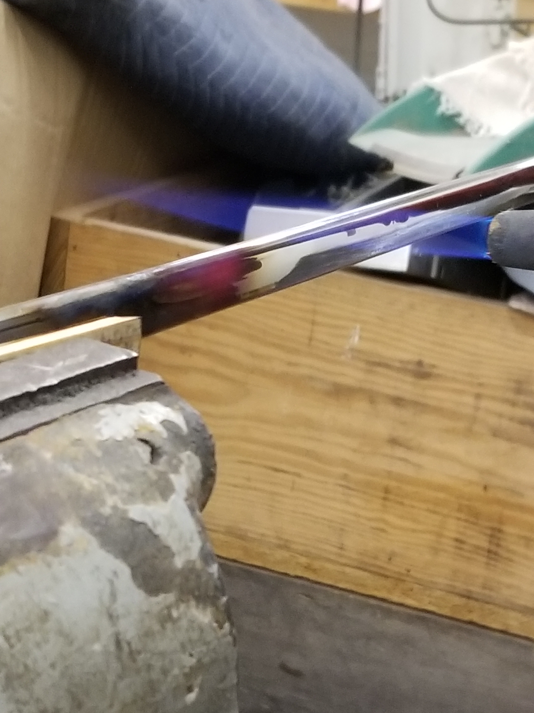

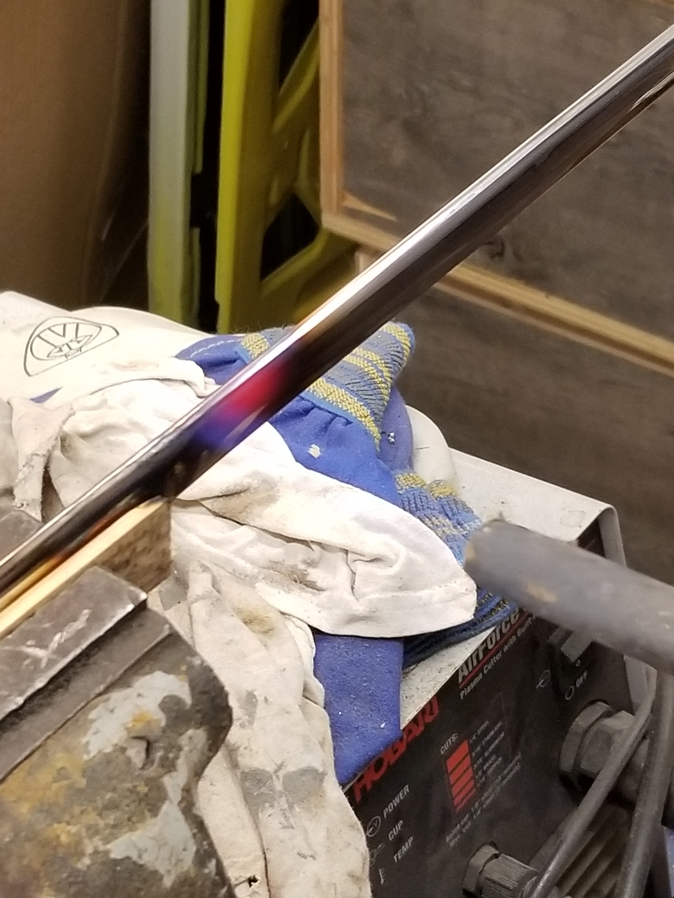

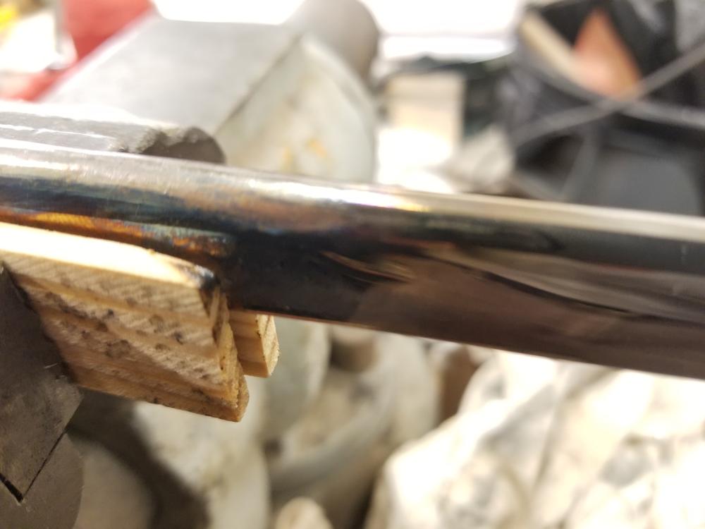

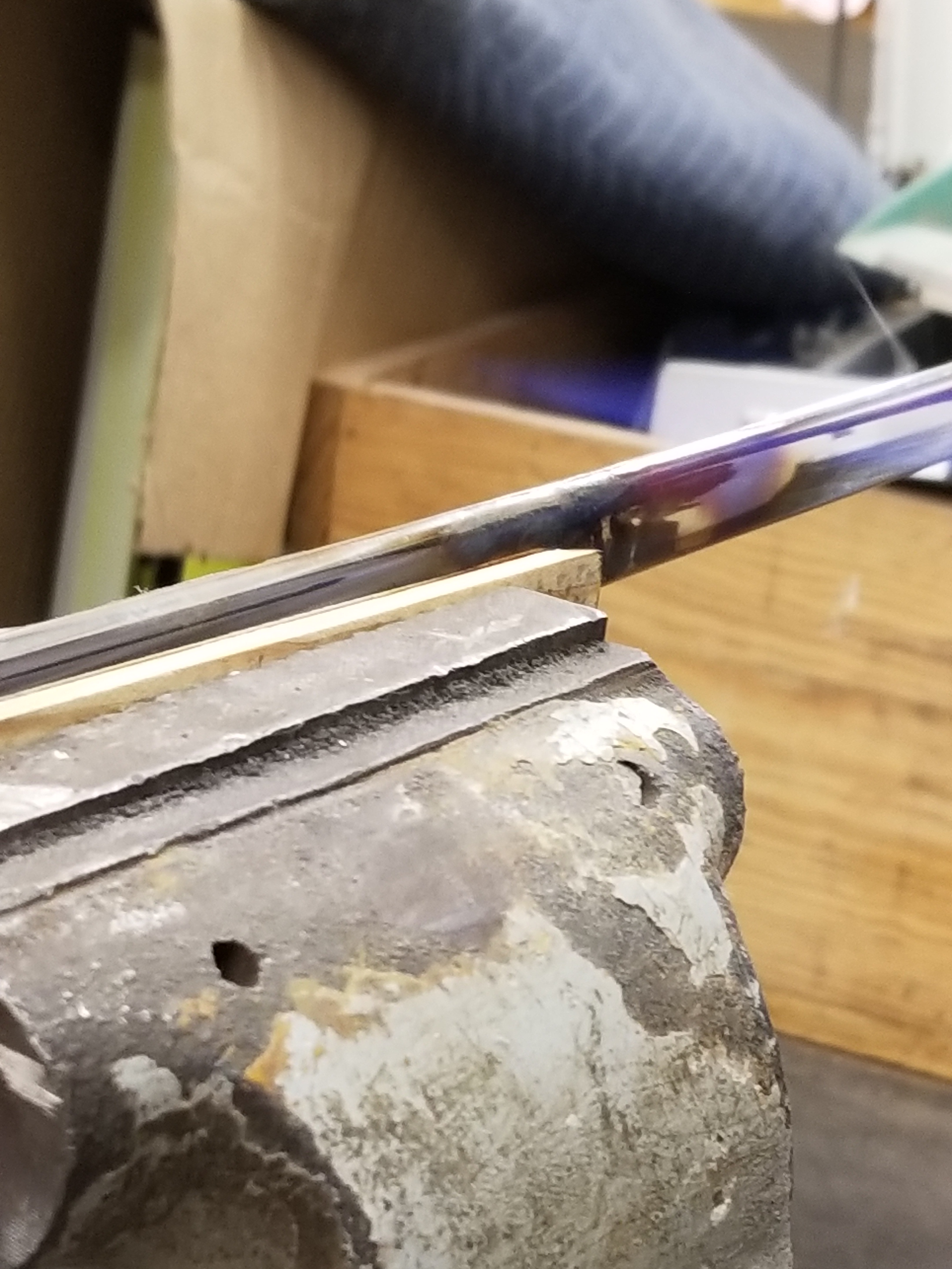

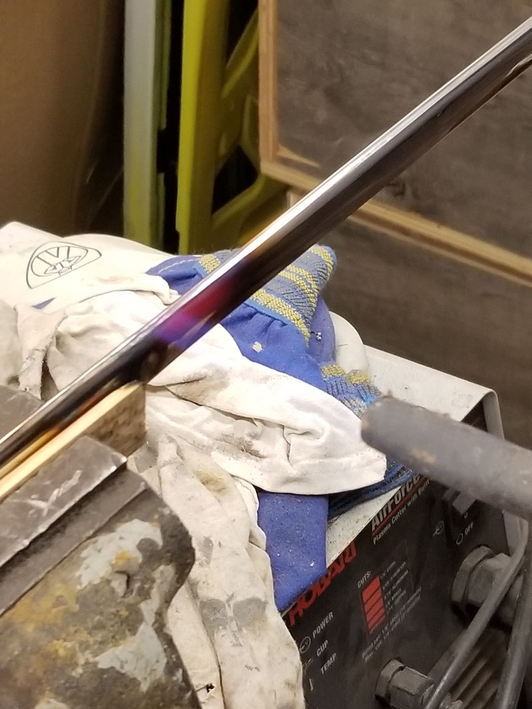

Anyway I stewed over this for a while and read a bunch of threads on other forums. One of the problems is that the trim is really thin! Unlike the trim on other classic cars which tends to have some thickness which makes repair easier. So at this point I have a 10 -15 degree bend in the trim about 6" from the end. It's bent in the flat direction not the easily corrected thin direction.
So I figure it's trash any way so how can I mess it up??? :P So we broke out the MAP gas. I had already tried shrinking the bulging area to straighten the piece to no avail. So I clamped the short end in the vise and heated it cherry red and stretched it down to straighten it
20171231_182755.jpg20171231_183648.jpg20171231_183650.jpg20171231_183653.jpg20171231_183655.jpg

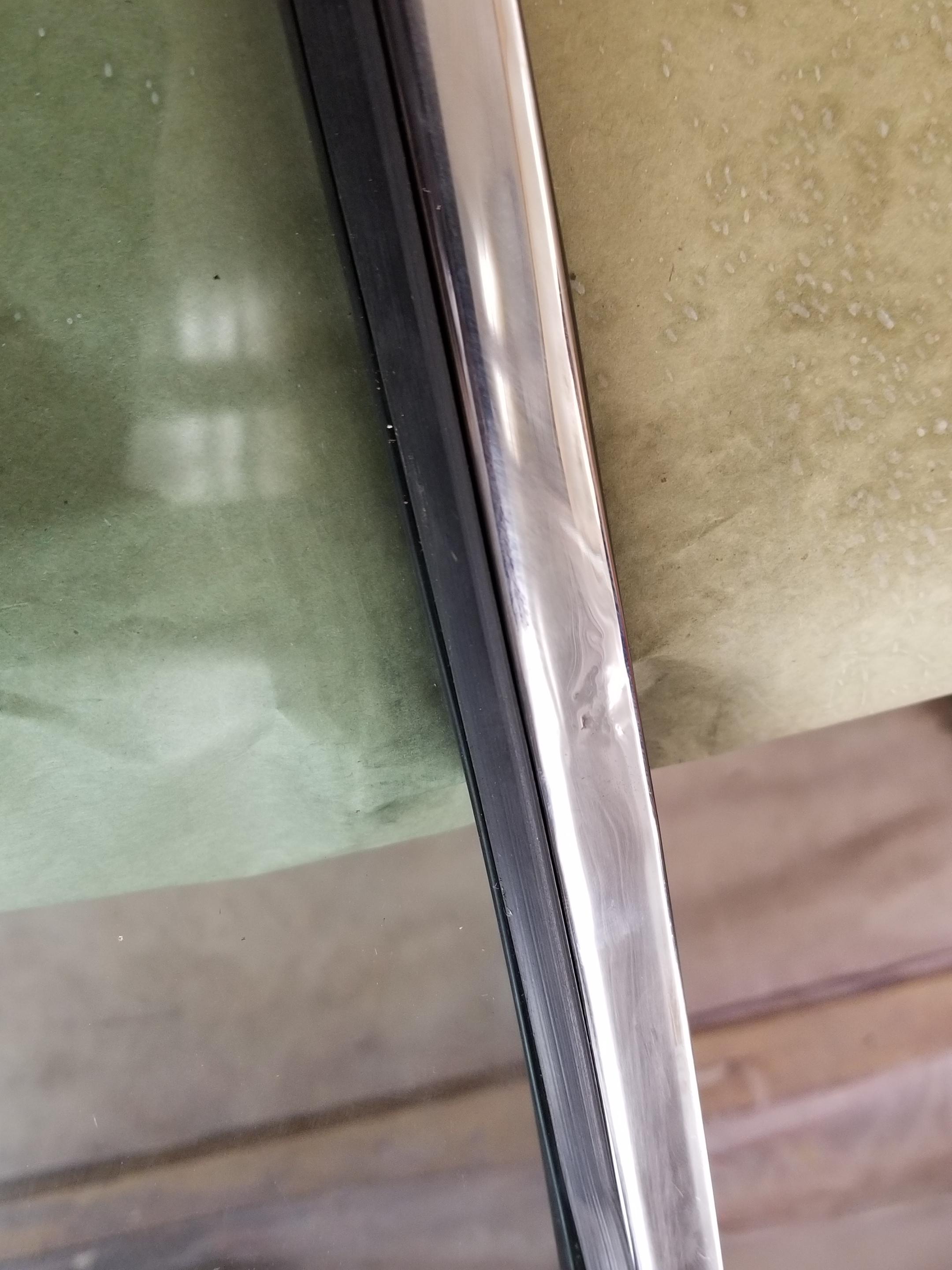

Took 4 or 5 tries and I ended up with this

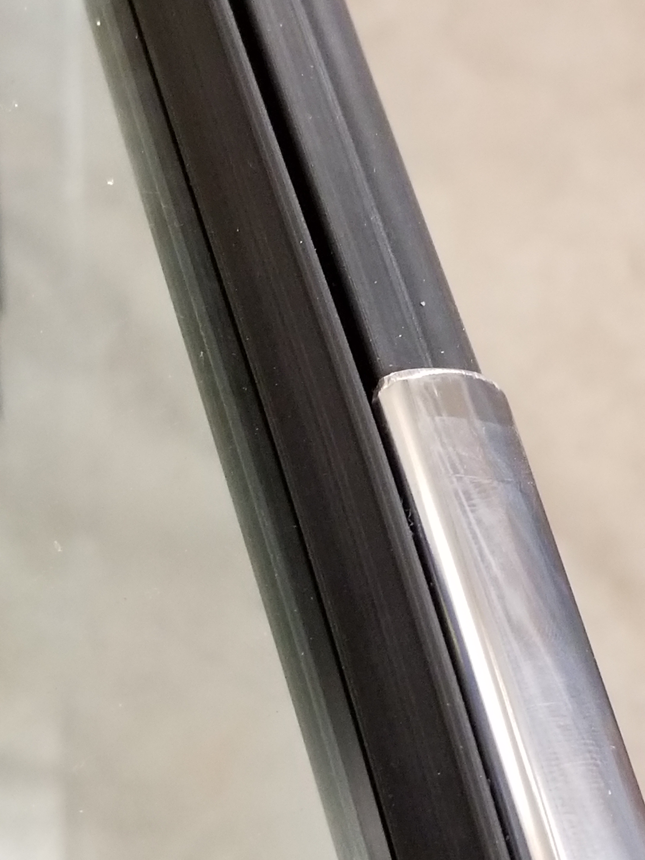

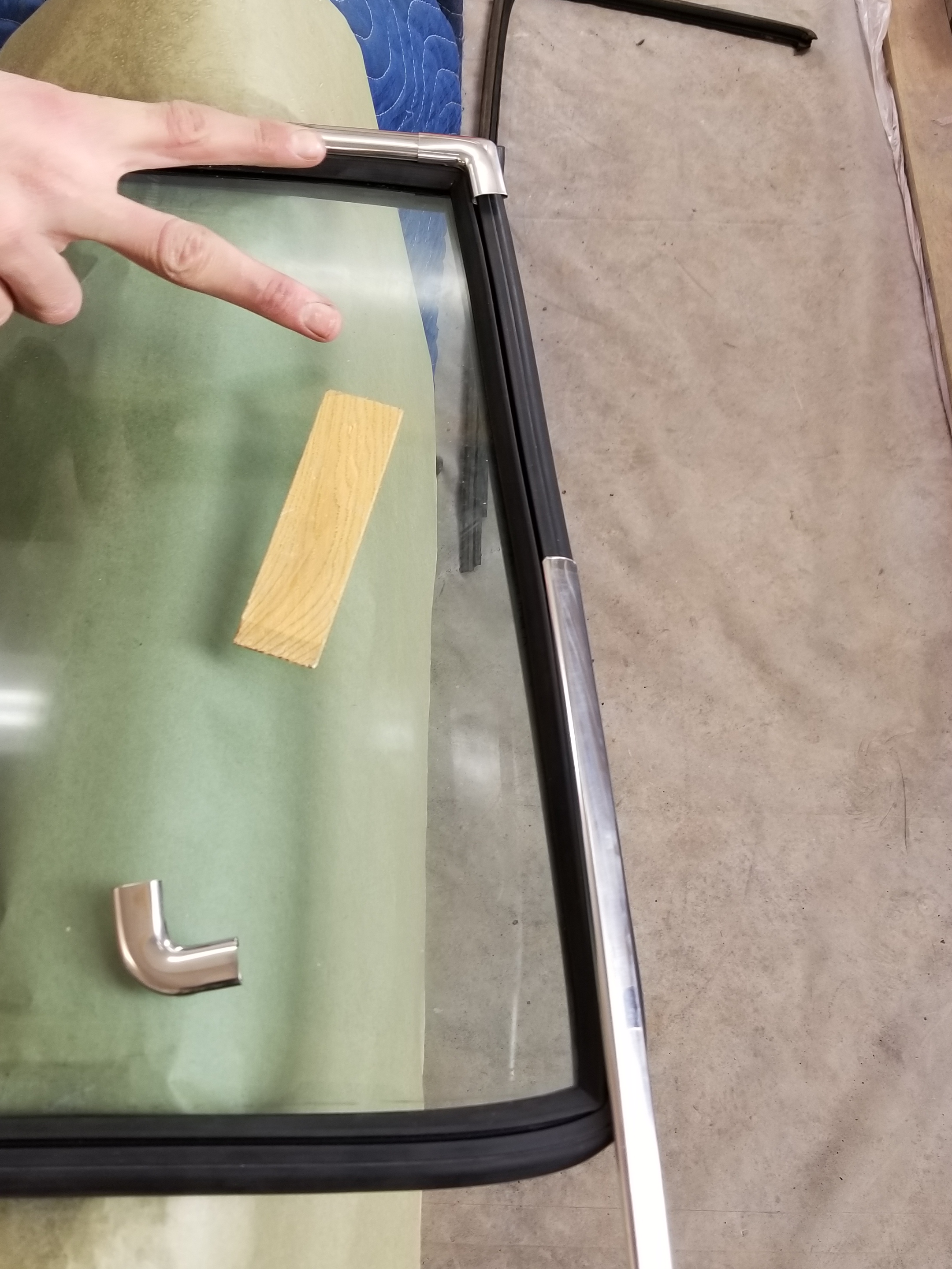

Now these pieces are stainless so they can be buffed out. The profile of the piece is sort of like a "J" with the hook of the J going in a groove in the weatherstrip. The leg of the J lays flat over the face of the rubber seal with a metal hem on the outside edge to finish it.
It is easiest to slide it in and the corner pieces act like sockets to connect all the corners
This is what the repaired piece looks like now. Serviceable but not pretty. Ok at 10 feet. I will keep my eyes open for some better trim. If I had the rights tools I probably could make it perfect. You just need a trim anvil, a lot of jewelers hammer and a lot of time
