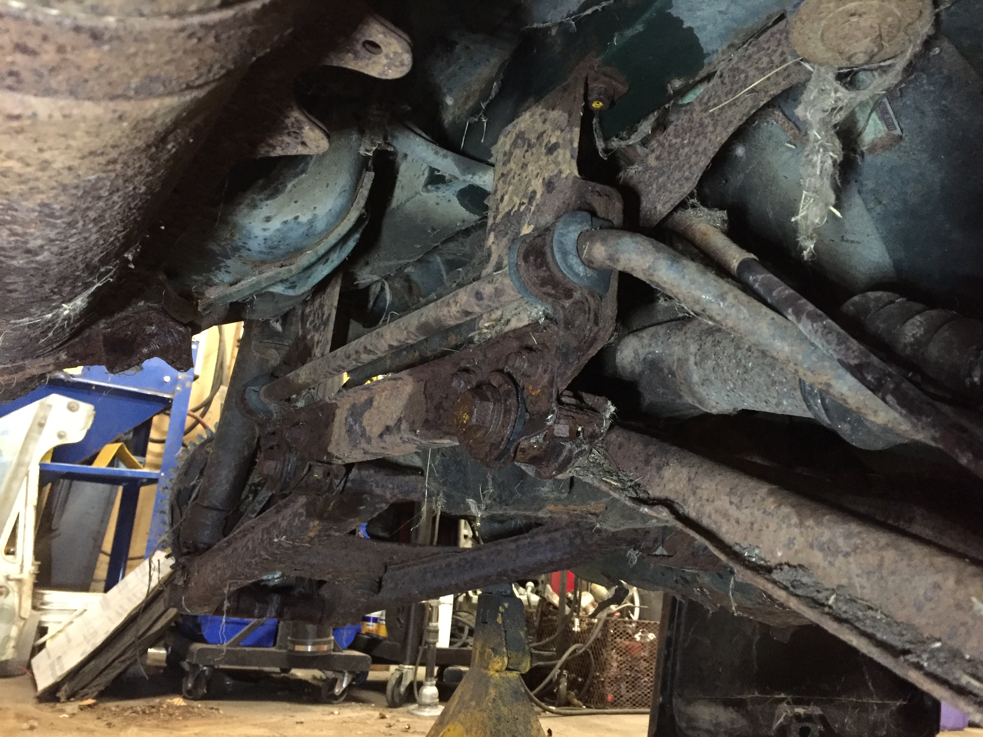

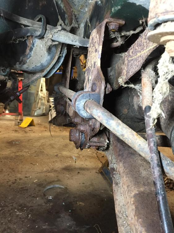

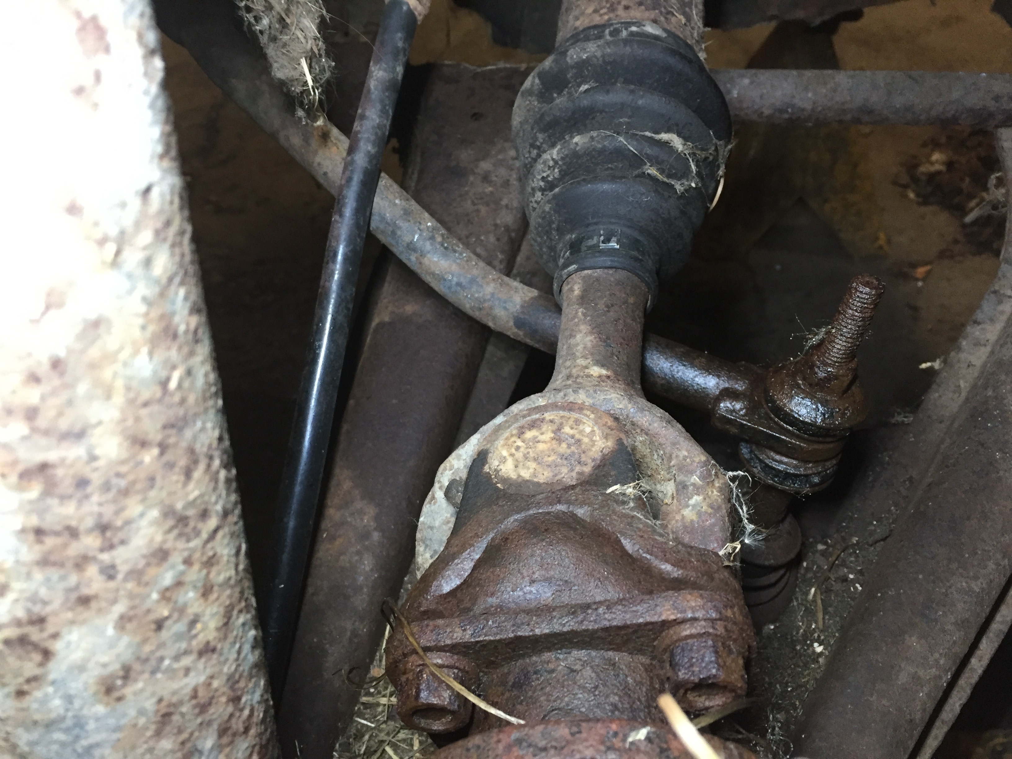

While we are on the topic of all things "early", I've noticed an interesting feature on the two early HLS30 UA's that I've had my hands on. The topic is a rear sway bar.
Correct me if I'm wrong, but I wasn't aware of a factory rear sway bars prior to the 260's. But on both 03798 and 02744 there is a rear sway bar. So what you say, after 40+ years, PO's will add all nature of performance crap, right? Well on 3798, the car had aftermarket front springs and a fatter than stock front sway bar, so I wasn't surprised to find a rear bar on it. Never gave it a second thought.
But when I peaked up the butt of 02744, and saw the EXACT same rear bar arrangement I started to wonder. What are the chances of this? Was Nissan Canada adding rear bars?
These bars are the style where the bar mounts to the transverse link uprights behind the diff, rather than the stock 260 and later bars that mount ahead of the diff on a frame box member.
As you can see, this style requires that you replace the uprights with the wider ones with wings that accept the bar bushing mounts.
So my sample of two isn't exactly statistically re-assuring. But what I notice is that all the components have exactly the same age related corrosion and patina. That is, if these bars were added by owners, they were added very soon after purchase.
Has anyone else seen this style of rear bar on Z with VIN's around the 1000-5000 mark, especially Canadian spec cars?
I just had a thought. When I get the rear suspension out today, I'm going to look at the nuts and bolts that mount those bushings. If they are factory, they will be quite recognizably metric and JIS standard. If they are SAE or metric but hardware store variety, then I have my answer. The style of the bushing cap can also be compared to the front sway bar caps to again compare to factory components.

That style of rear ARB/'Sway Bar' was nothing to do with Nissan.
But of course, Nissan did design and engineer rear ARBs for S30-series Zs right from the beginning of production. They just were not fitted to cars sold in the North American market.
