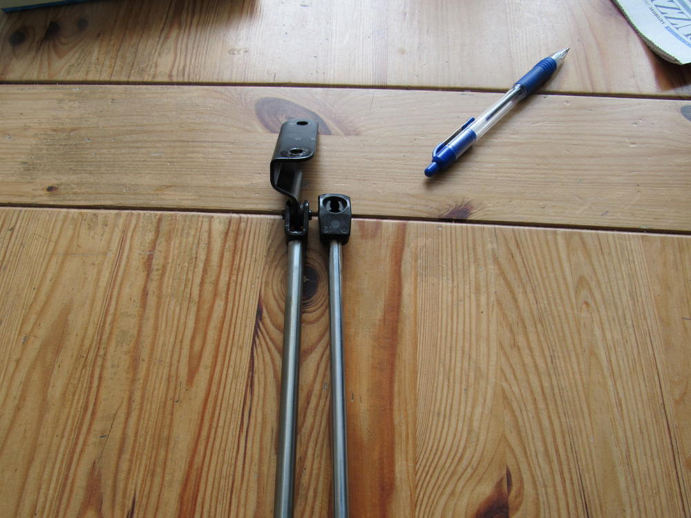

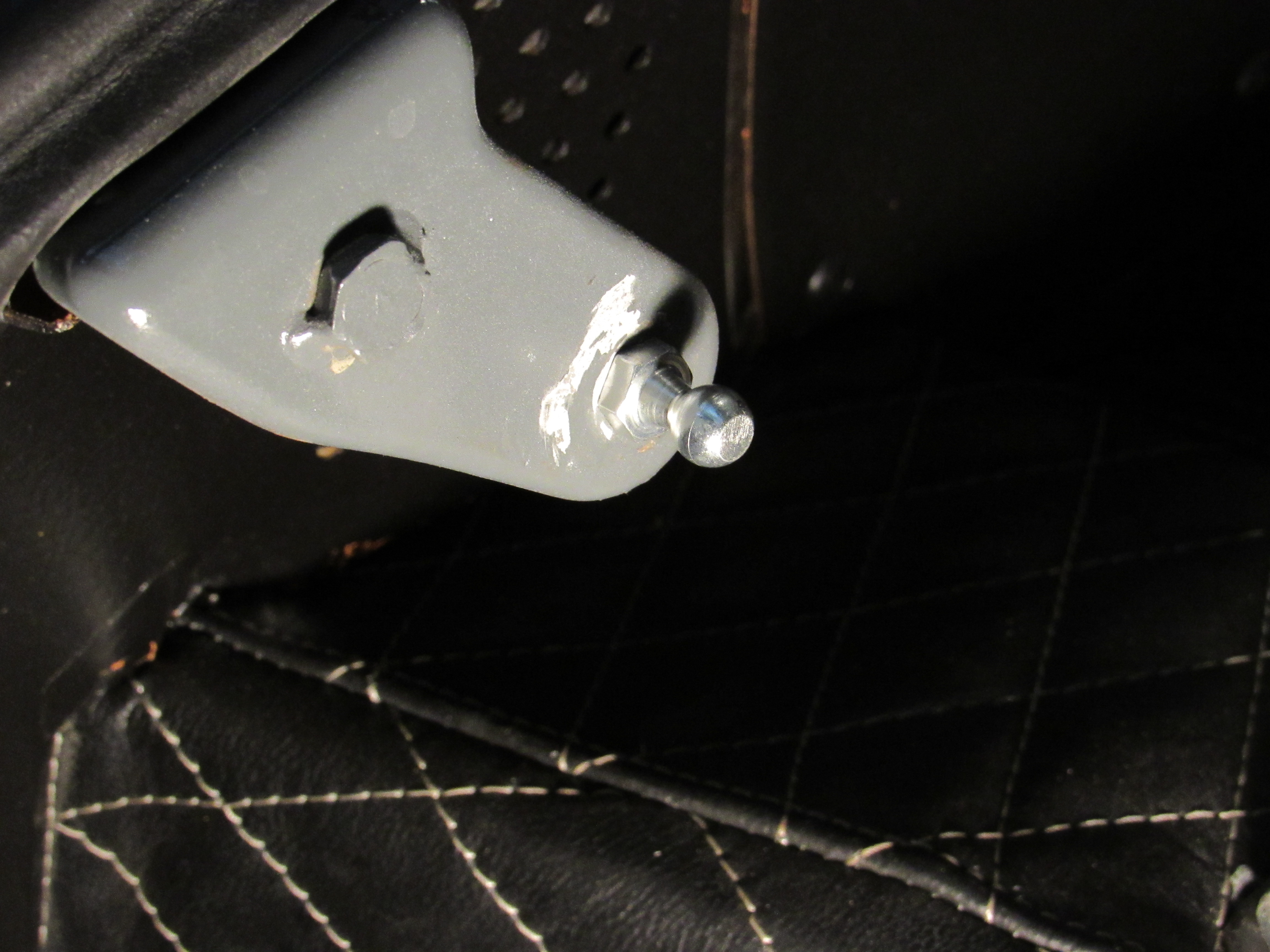

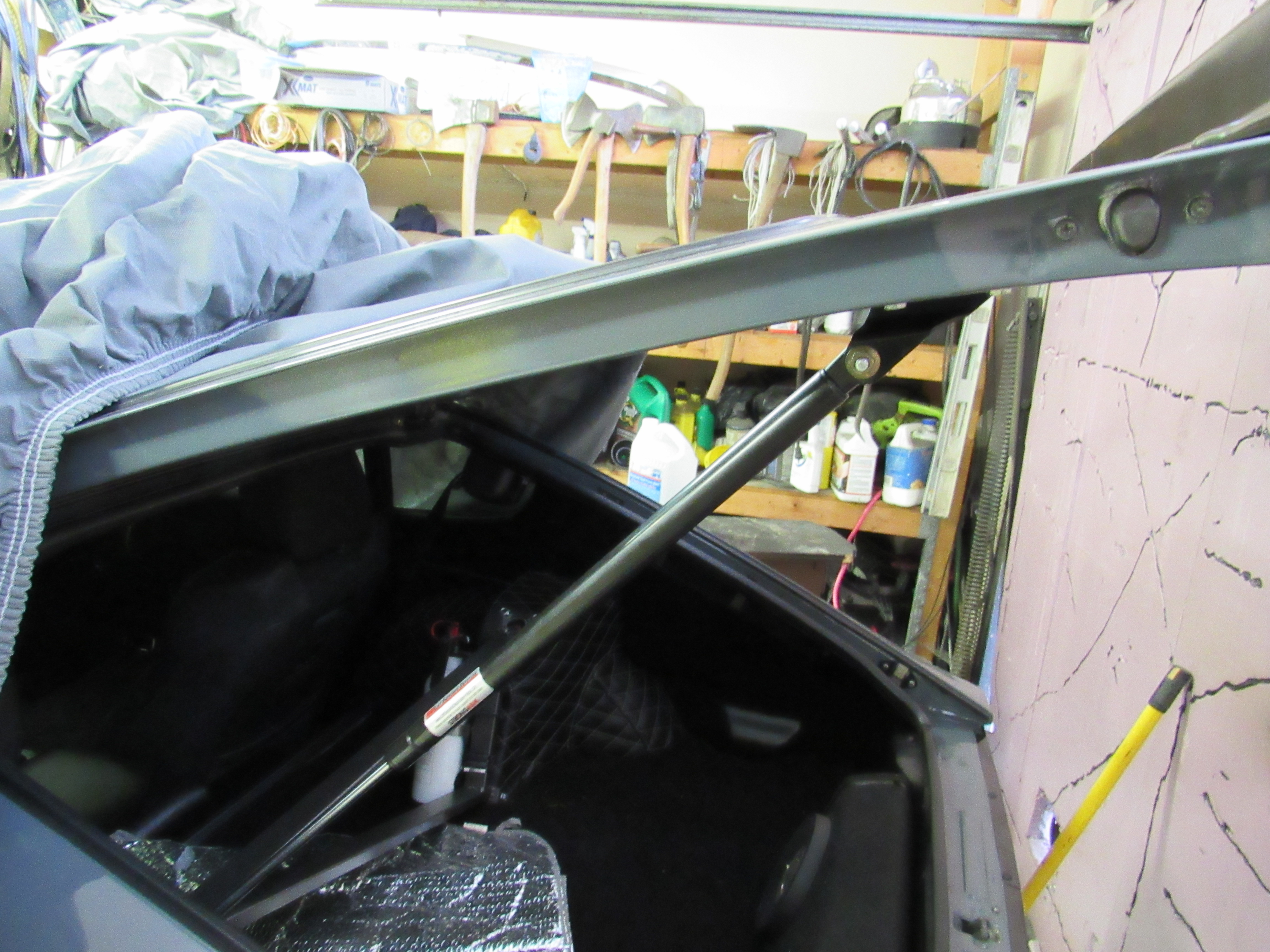

December 10, 20177 yr Author comment_537118 Now that there is a layer of snow on the ground I just got around to installing the new gas lift, this is the one I bought, https://www.liftsupportsdepot.com/strong-arm-4313-gas-charged-nissan-hatchback-lift-support-strut-10029w/ The whole job didn't take 20 min. Remove the stock lift, punch out the pin holding the upper rod to the mounting flange, attach the ball studs and snap in the new lift. It has nice action and has a great feature, when the lift is about 2" from being fully extended the motion slows right down so there is no sudden stop when fully open. Remember to mount it with the rod attached to the car and the black receiver end on the hatch, it keeps oil on the seal and the rod. Â Link to comment https://www.classiczcars.com/forums/topic/58785-hatch-strut-lift/#findComment-537118 Share on other sites More sharing options...

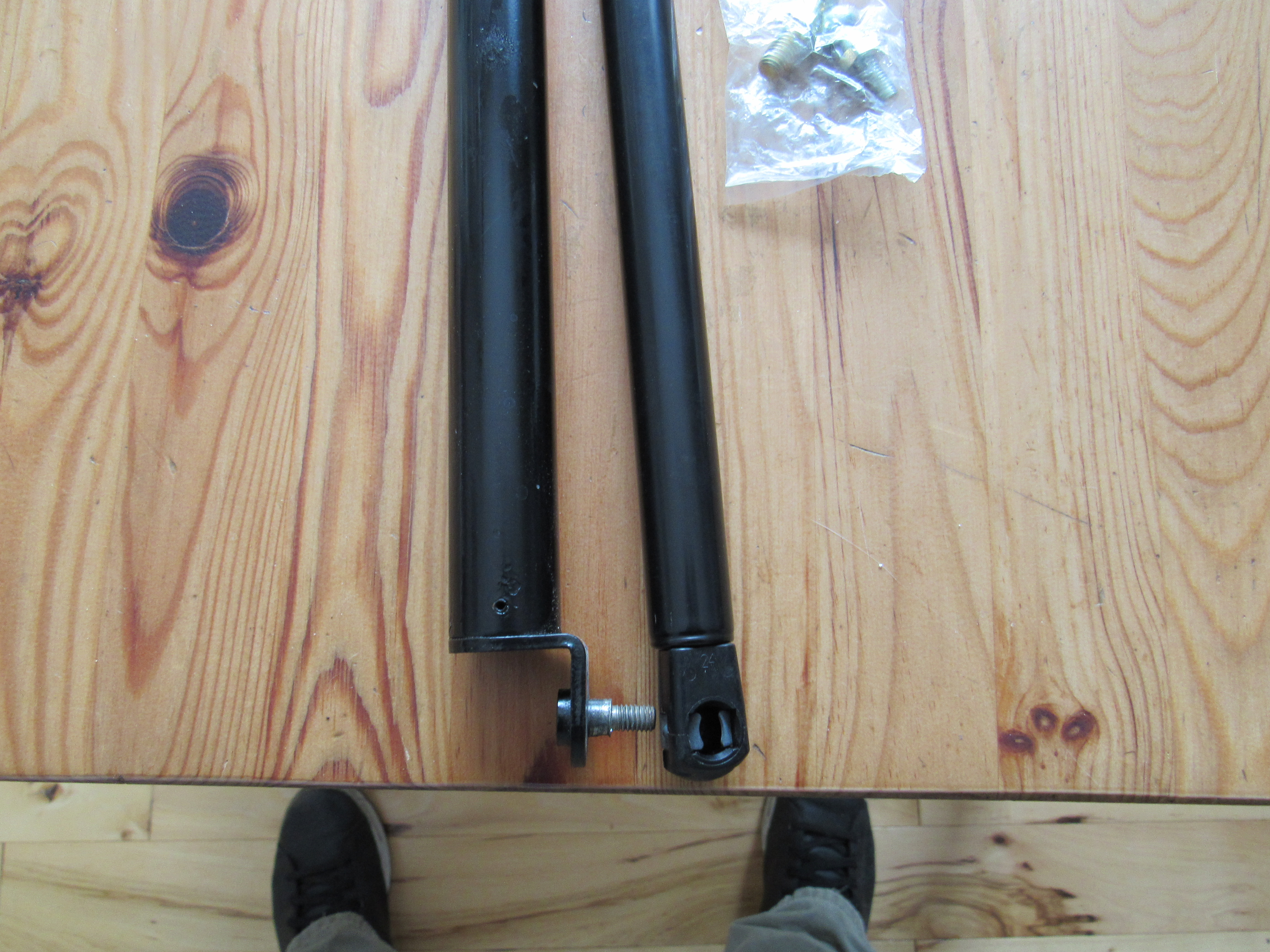

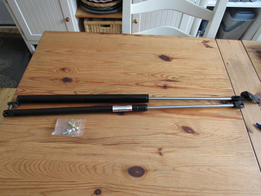

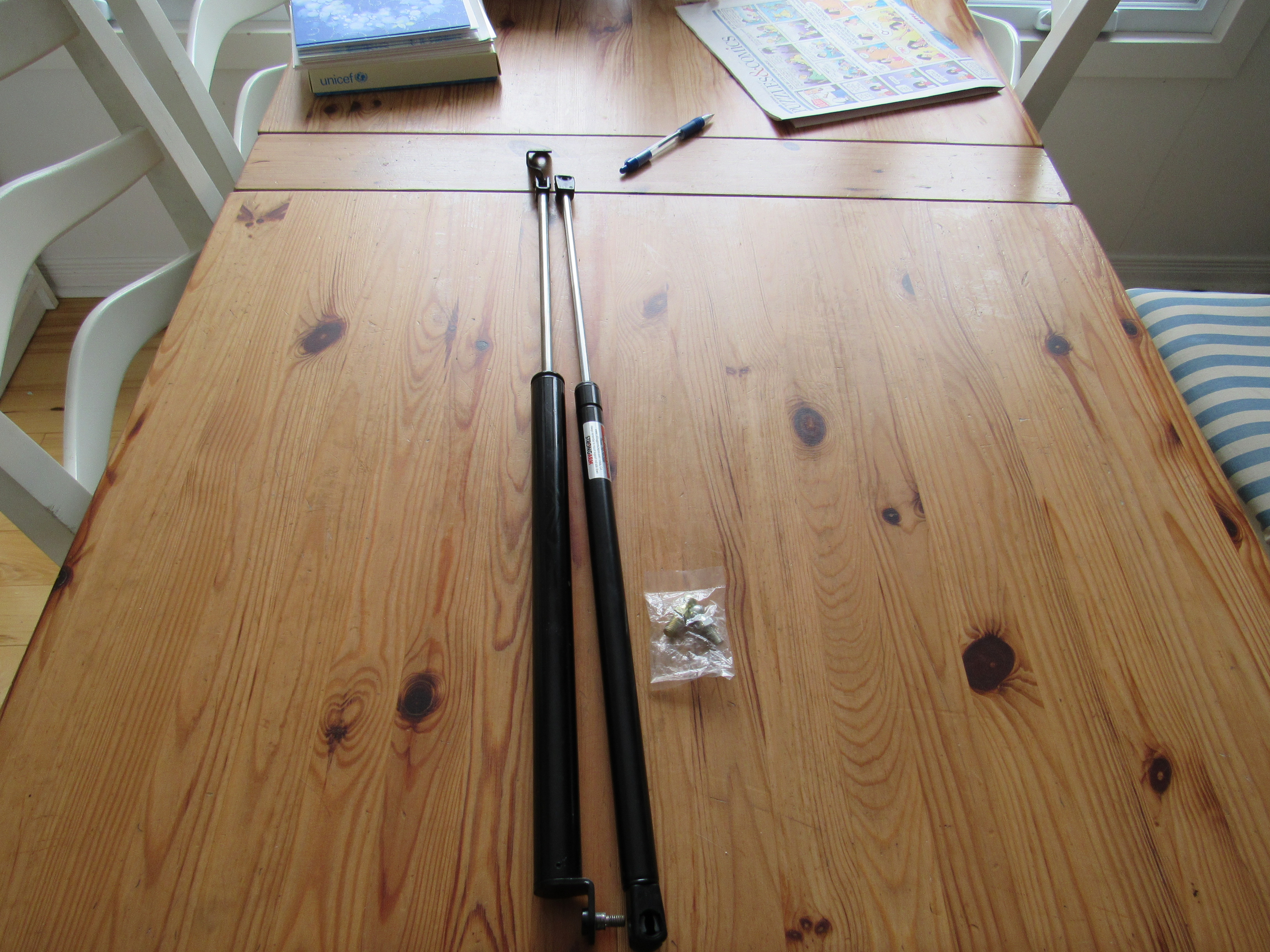

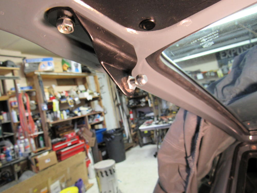

June 11, 20214 yr comment_623281 It looks like the same company has a new hatch strut for the 260-280z models. This might also work with a 240z, my 73 model appears to have a similar design (although just 1 strut). https://www.liftsupportsdepot.com/strong-arm-4777-gas-charged-hatchback-lift-support/ I ordered a set, I'll update when they get here. Link to comment https://www.classiczcars.com/forums/topic/58785-hatch-strut-lift/#findComment-623281 Share on other sites More sharing options...
