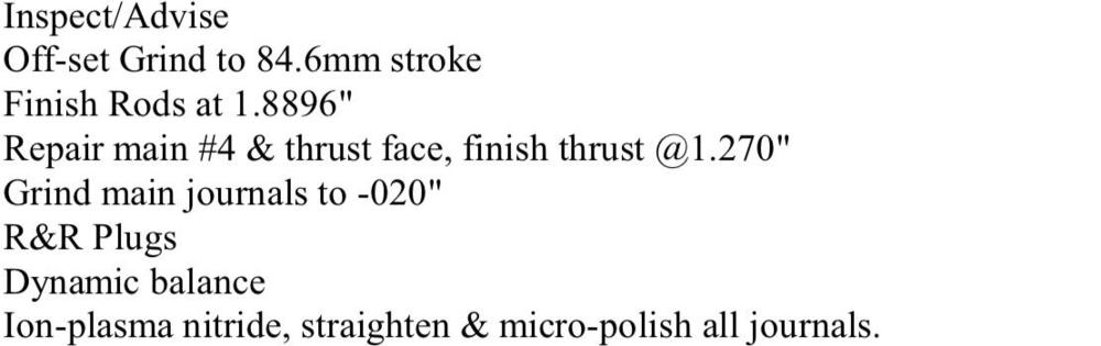

February 25, 20205 yr Author comment_593180 Stroker Diesel crank is back from marine crankshaft! Offset ground to 84.6mm Toyota rod ends 1.8896” Ground main journals to -020” Dynamic balance Ion plasma nitride, straighten and micro polished. Link to comment https://www.classiczcars.com/forums/topic/58568-duffys-171-series-1-240z-build/?&page=49#findComment-593180 Share on other sites More sharing options...

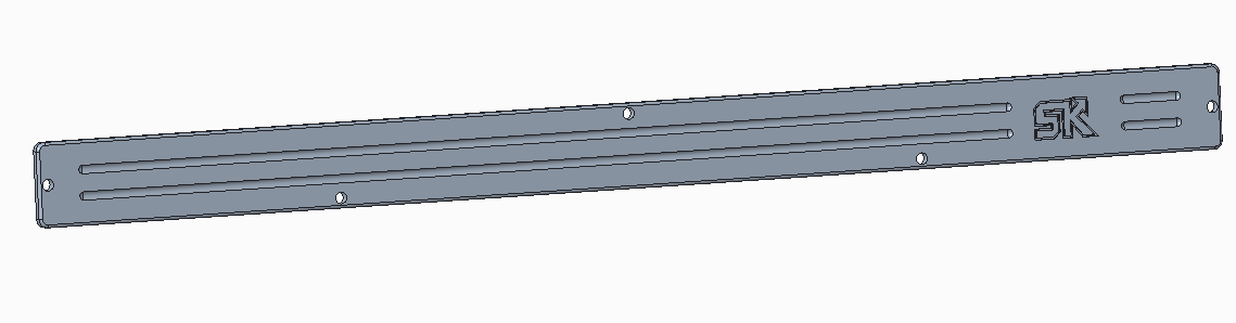

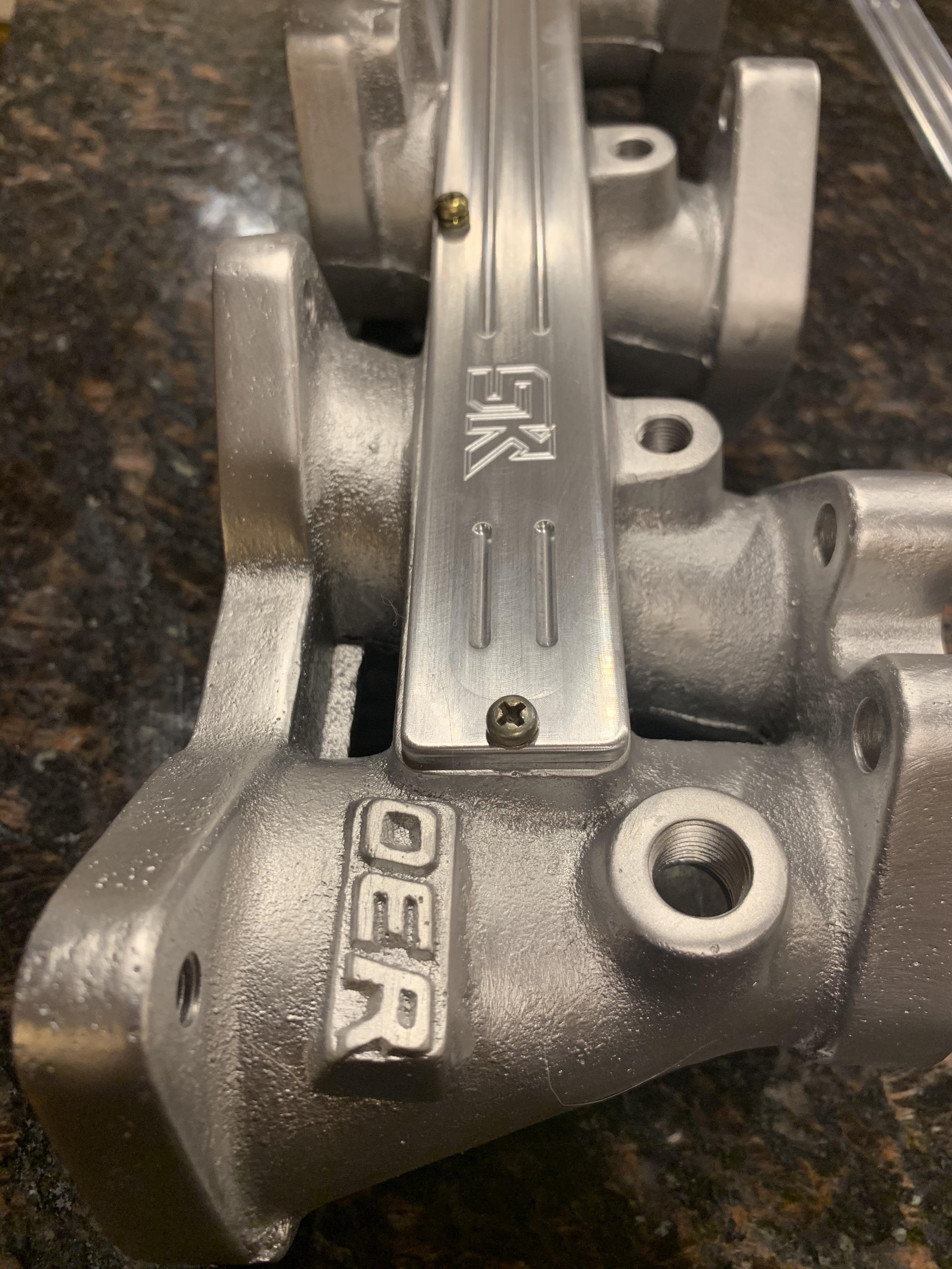

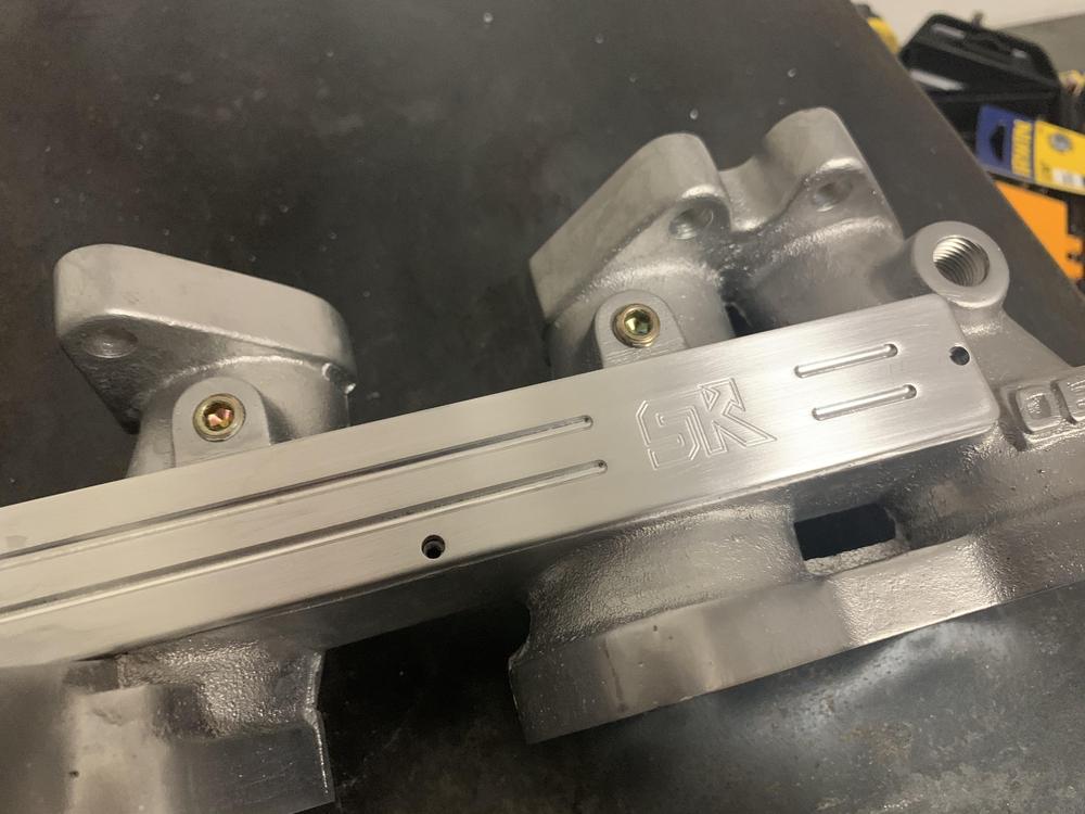

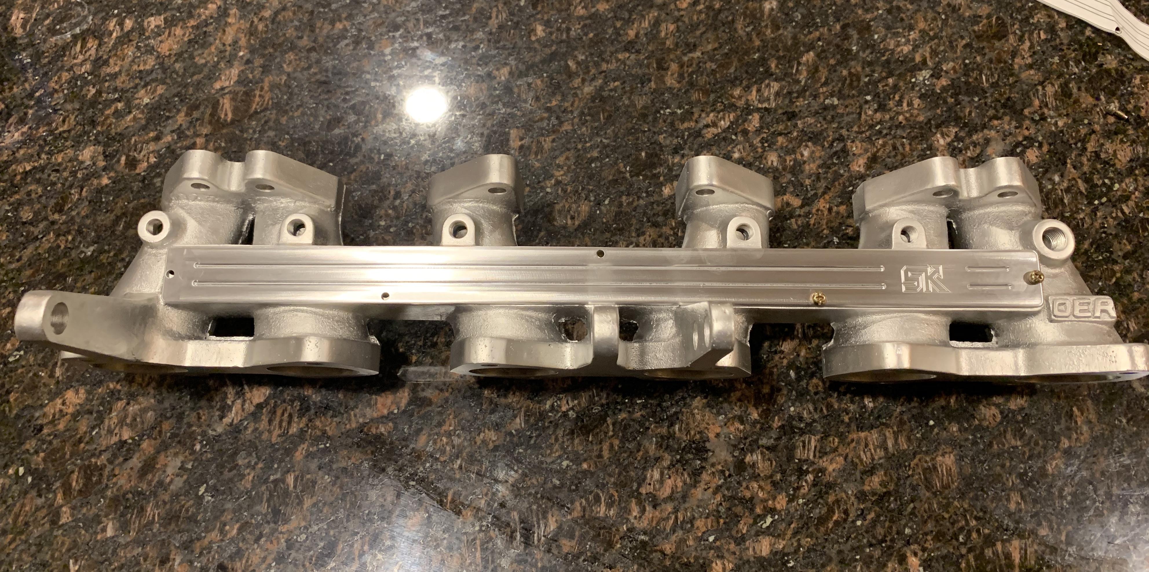

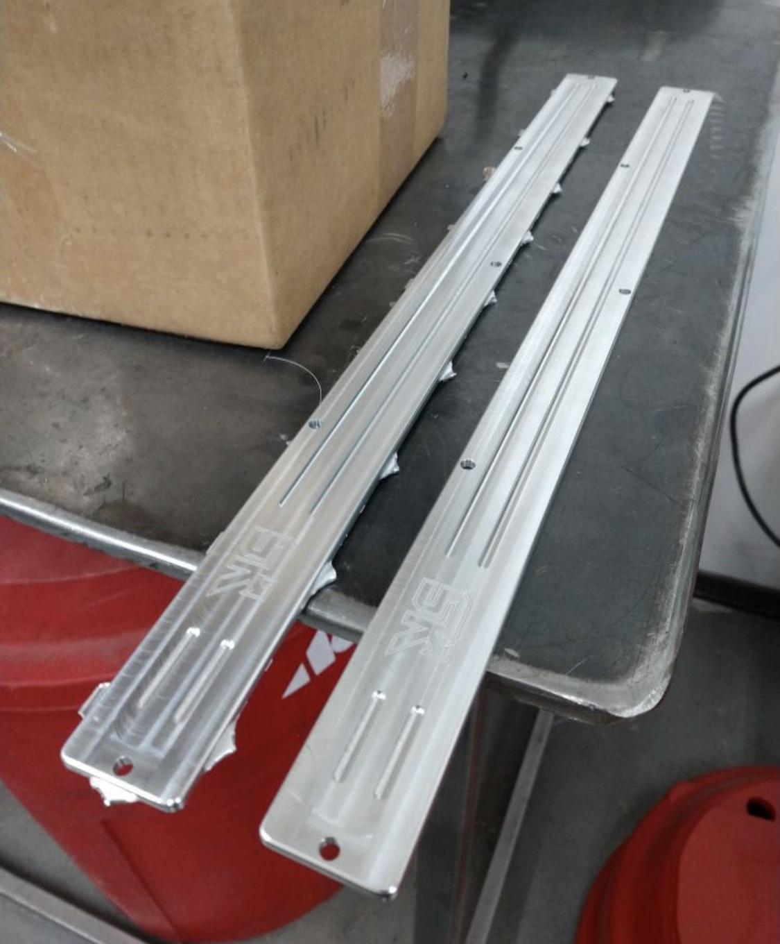

February 28, 20205 yr Author comment_593314 Iac balance bar is looking good. Next is having it cut. Link to comment https://www.classiczcars.com/forums/topic/58568-duffys-171-series-1-240z-build/?&page=49#findComment-593314 Share on other sites More sharing options...

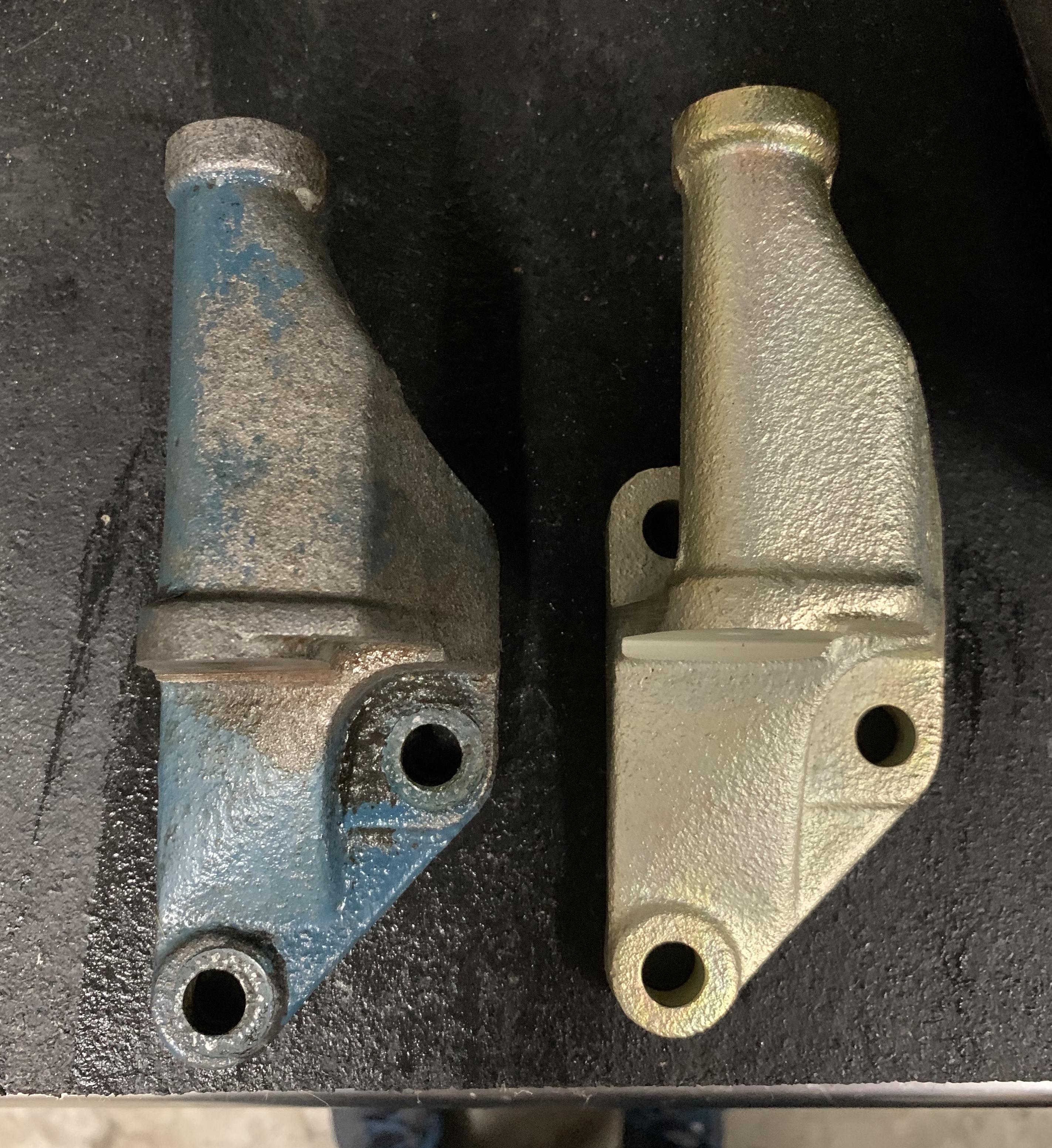

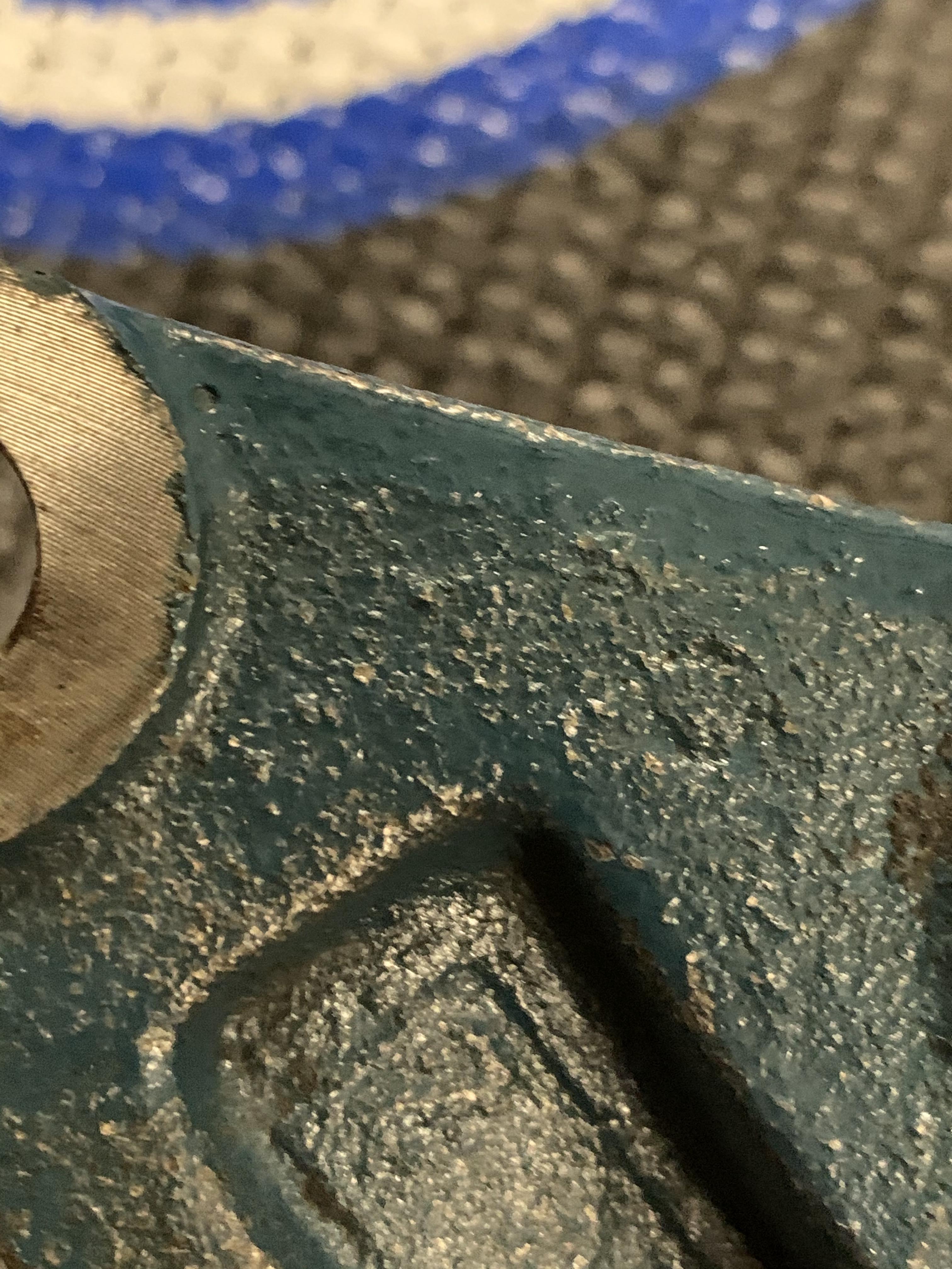

February 29, 20205 yr Author comment_593438 I’m not going to rattle can my new stroker block.  So I need a color code off something.  The alternator bracket seemed like the best choice for still have original paint and be something I can easily take off. I found another that was plated to replace it. This is the last grimy thing on my original motor.   I will have a ppg shop scan it next week. It’s darker blue then I would have guessed. Edited February 29, 20205 yr by duffymahoney Link to comment https://www.classiczcars.com/forums/topic/58568-duffys-171-series-1-240z-build/?&page=49#findComment-593438 Share on other sites More sharing options...

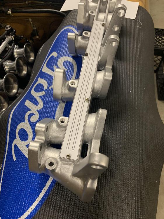

March 5, 20205 yr Author comment_593730 Balance bar cap is done Link to comment https://www.classiczcars.com/forums/topic/58568-duffys-171-series-1-240z-build/?&page=49#findComment-593730 Share on other sites More sharing options...

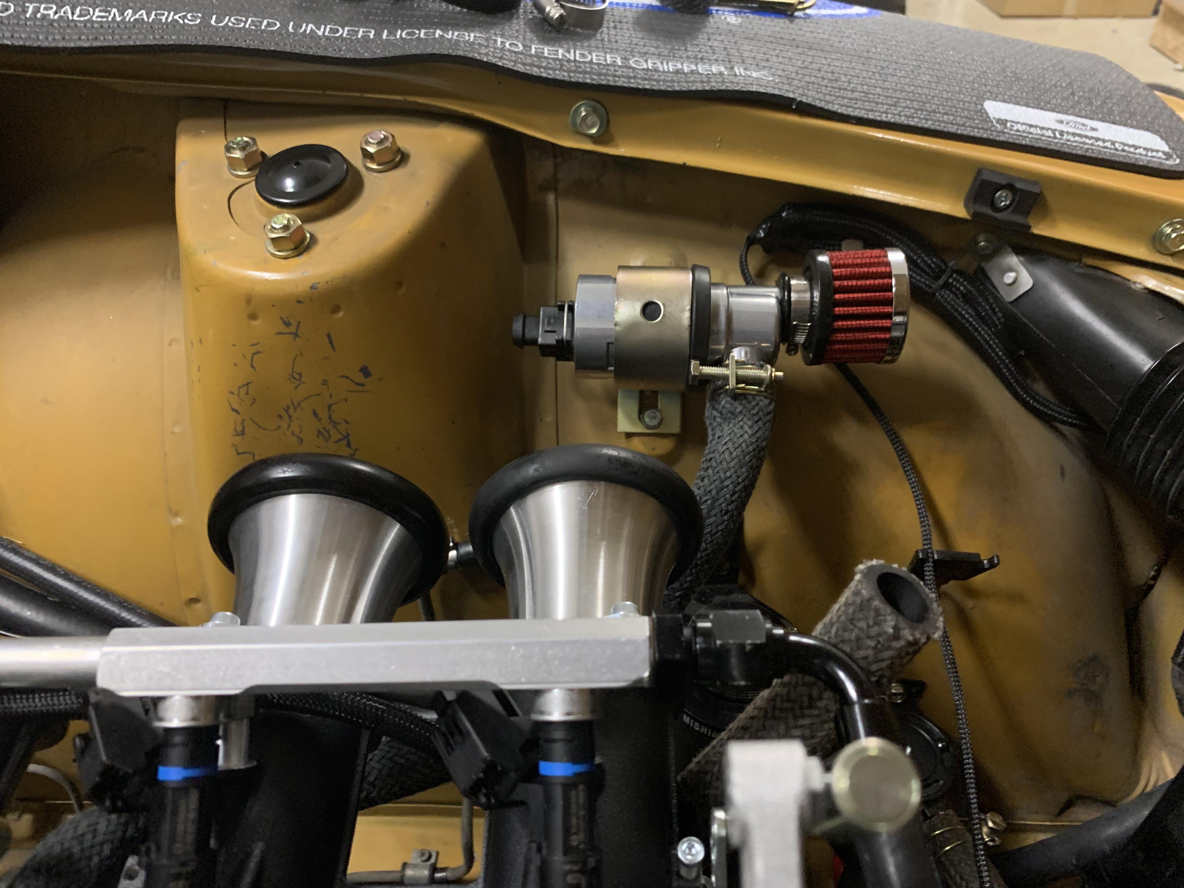

March 6, 20205 yr Author comment_593791 ITB with IAC and pcv here I come. Which mount looks better. Stock coil mount or the rubber one? Rubber one looks lower profile. Link to comment https://www.classiczcars.com/forums/topic/58568-duffys-171-series-1-240z-build/?&page=49#findComment-593791 Share on other sites More sharing options...
March 6, 20205 yr comment_593797 Rubber looks best to me. Link to comment https://www.classiczcars.com/forums/topic/58568-duffys-171-series-1-240z-build/?&page=49#findComment-593797 Share on other sites More sharing options...
March 6, 20205 yr comment_593814 First one, looks more appropriate and fitting in with the aesthetic of the car. Link to comment https://www.classiczcars.com/forums/topic/58568-duffys-171-series-1-240z-build/?&page=49#findComment-593814 Share on other sites More sharing options...

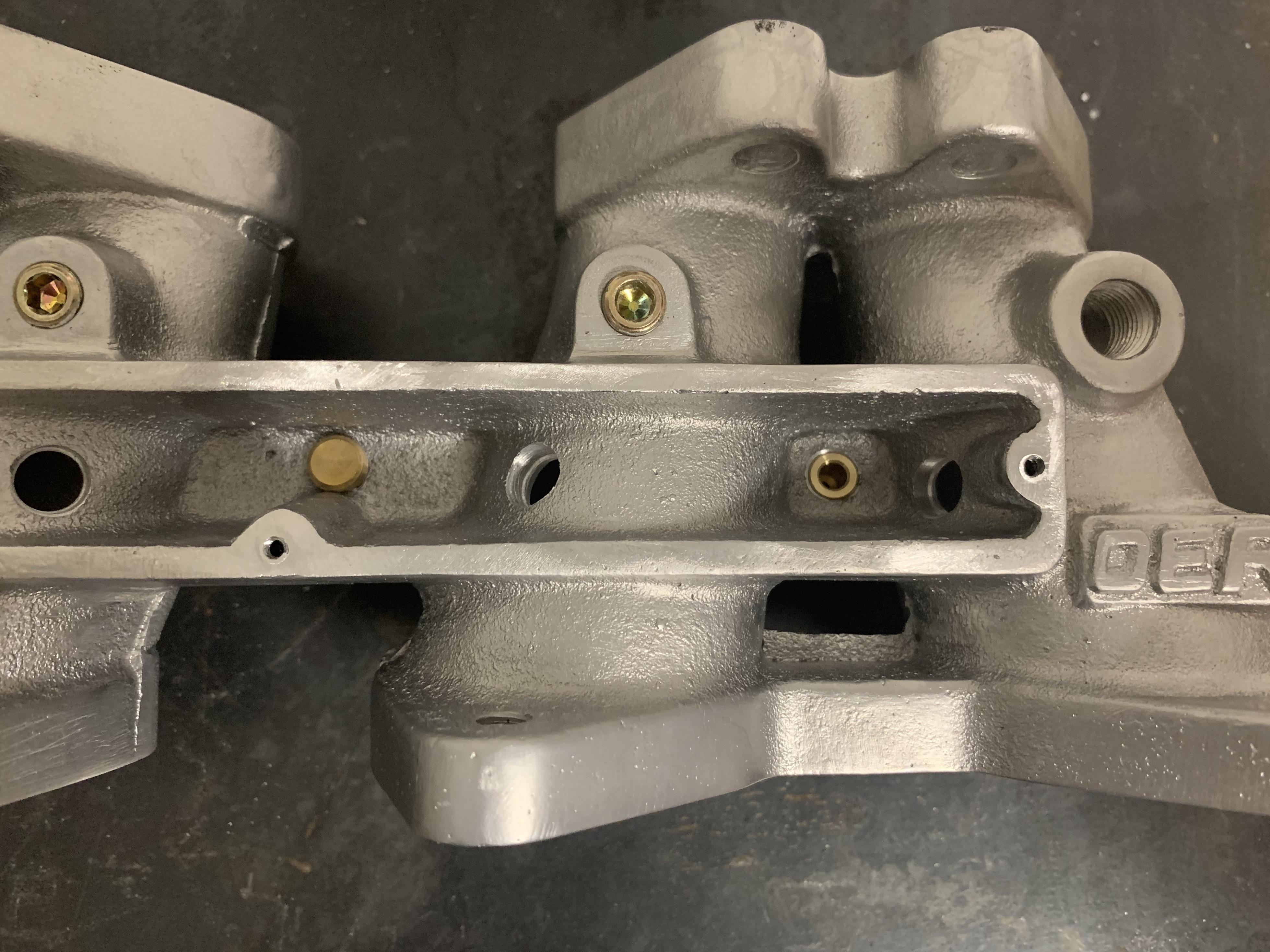

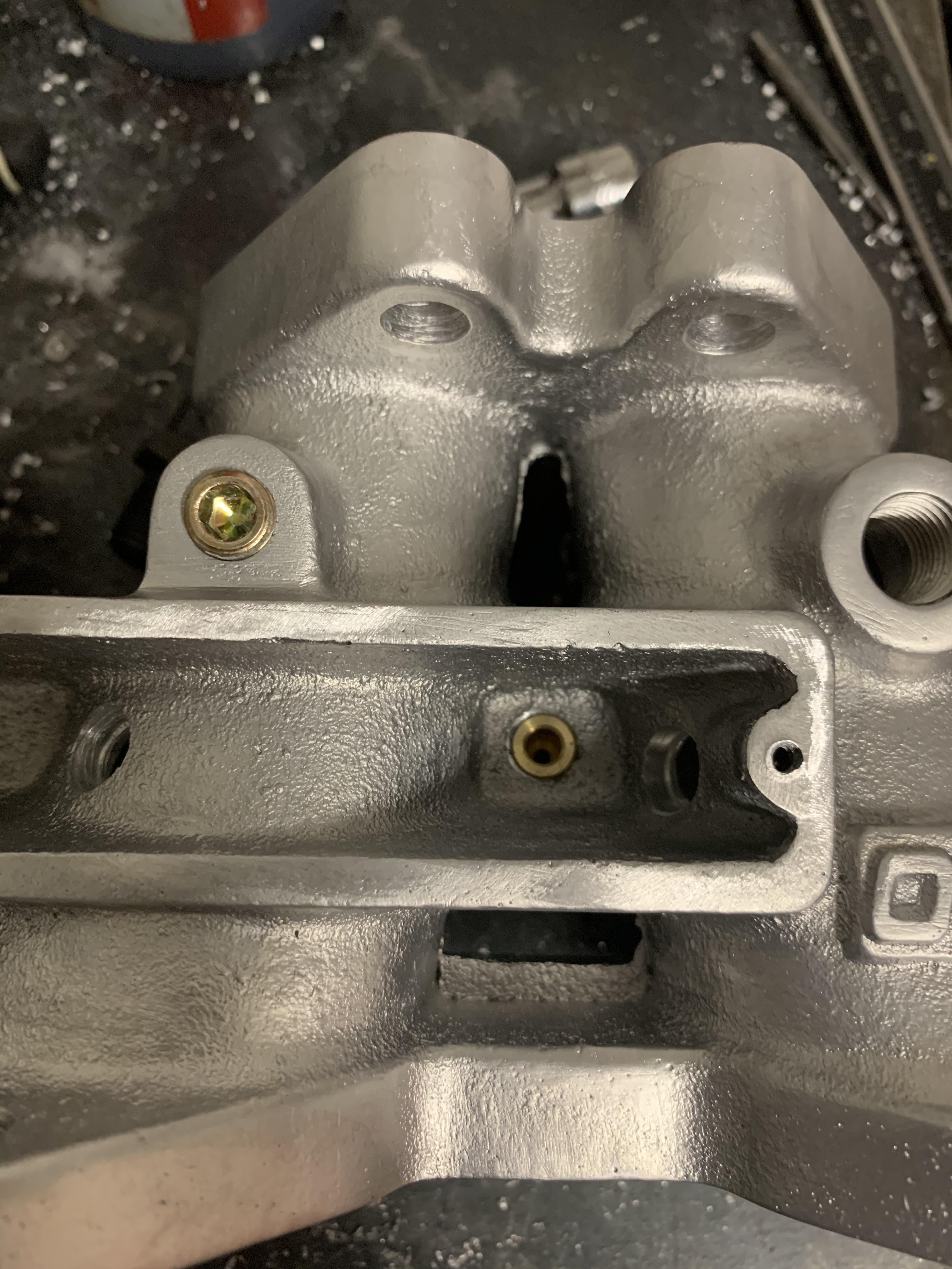

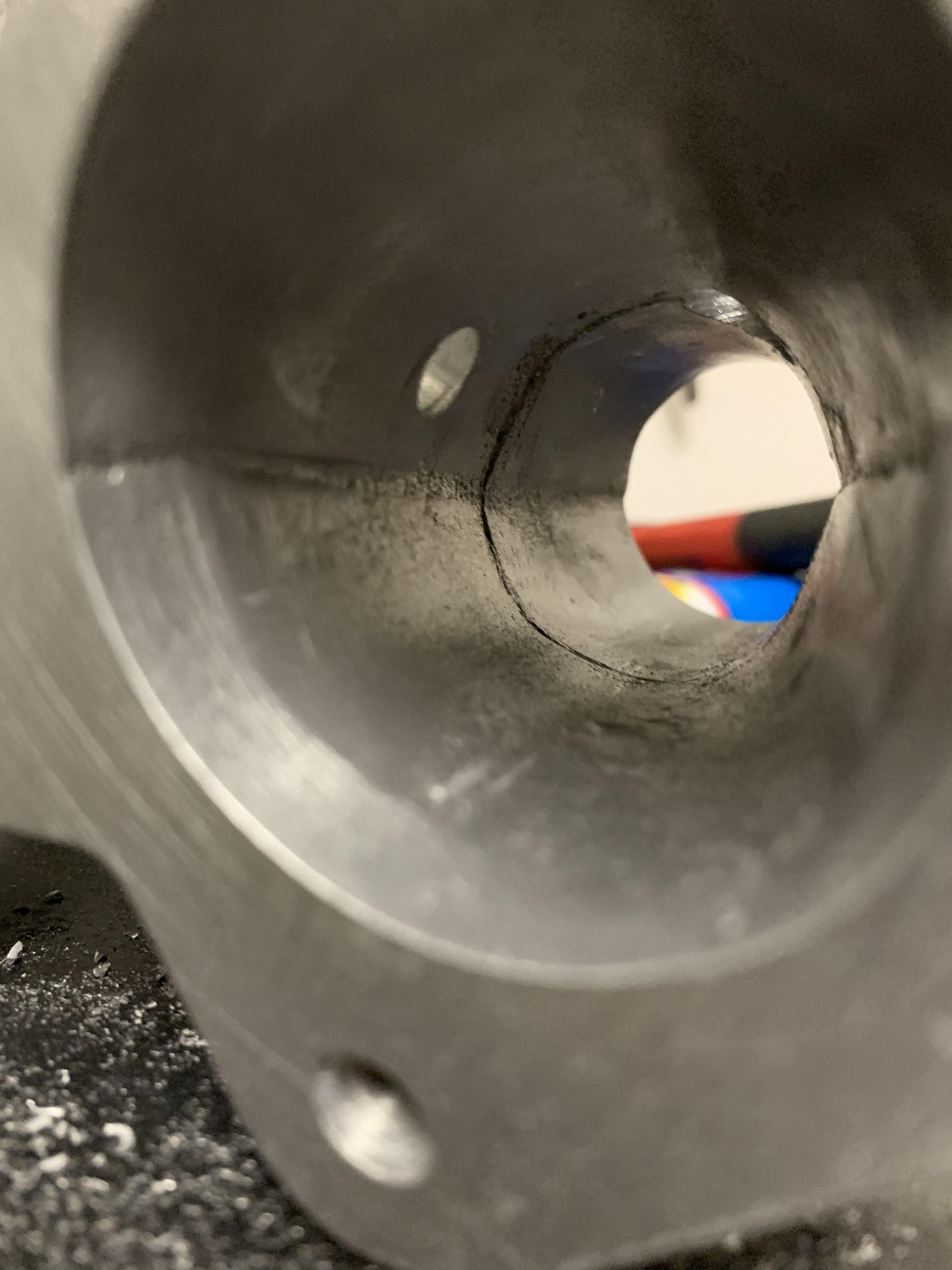

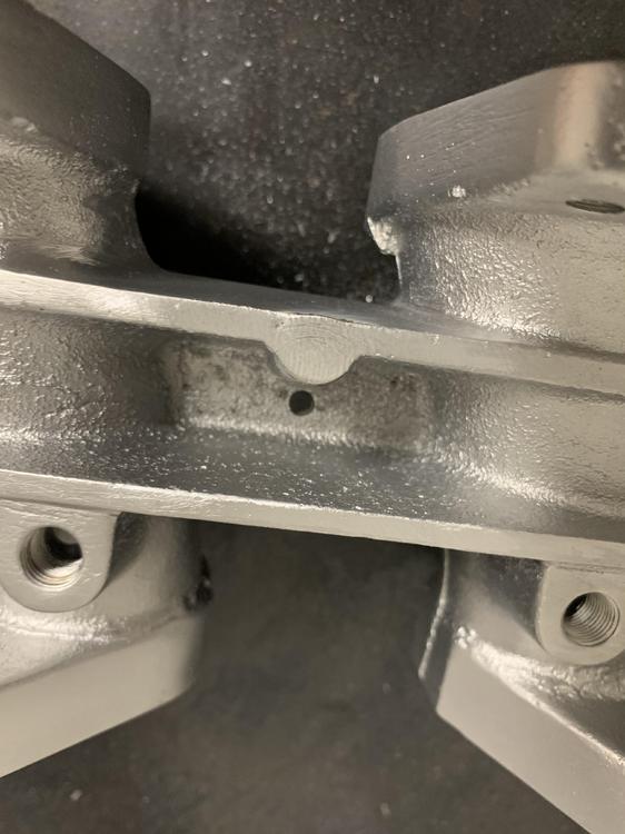

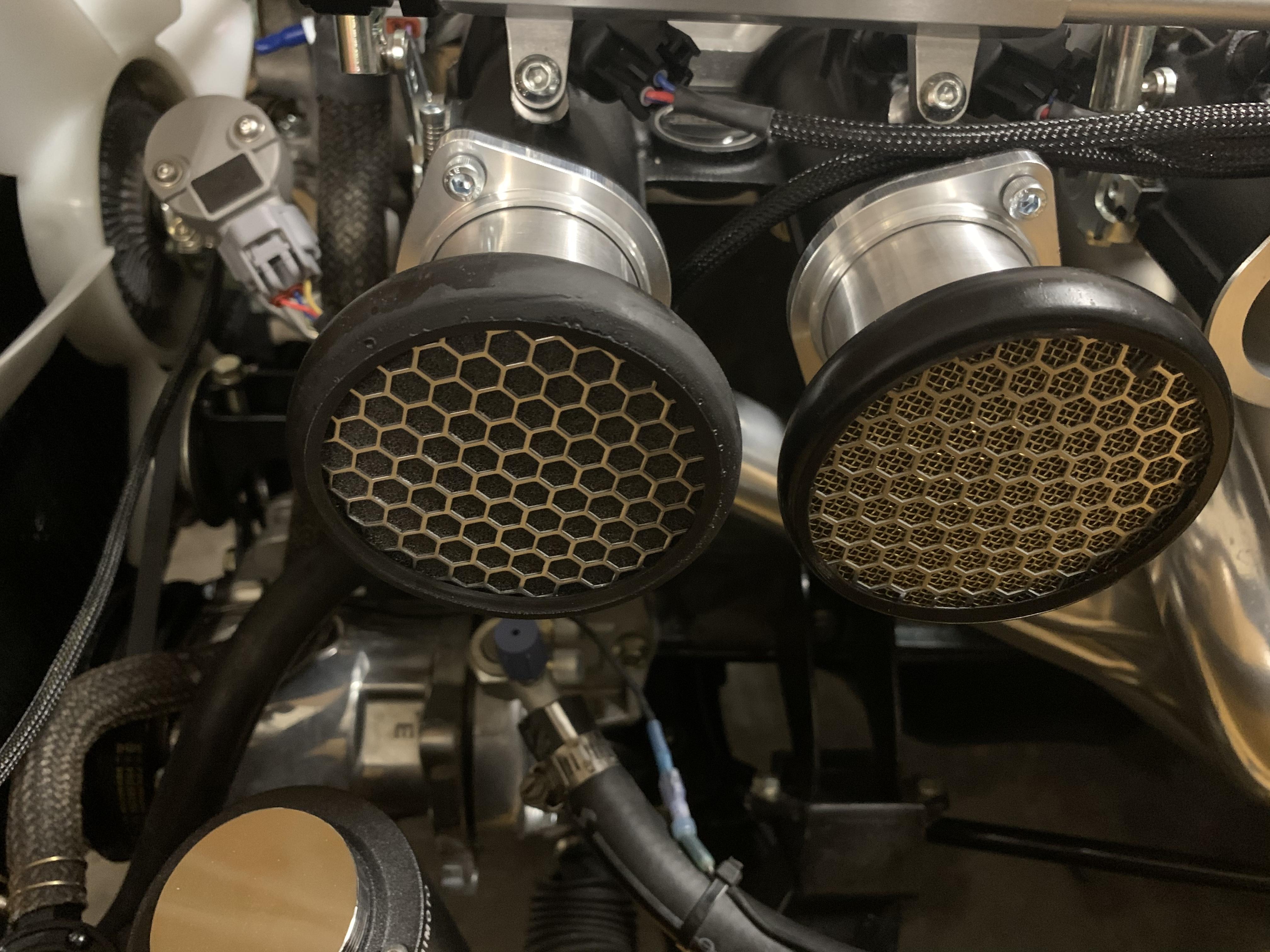

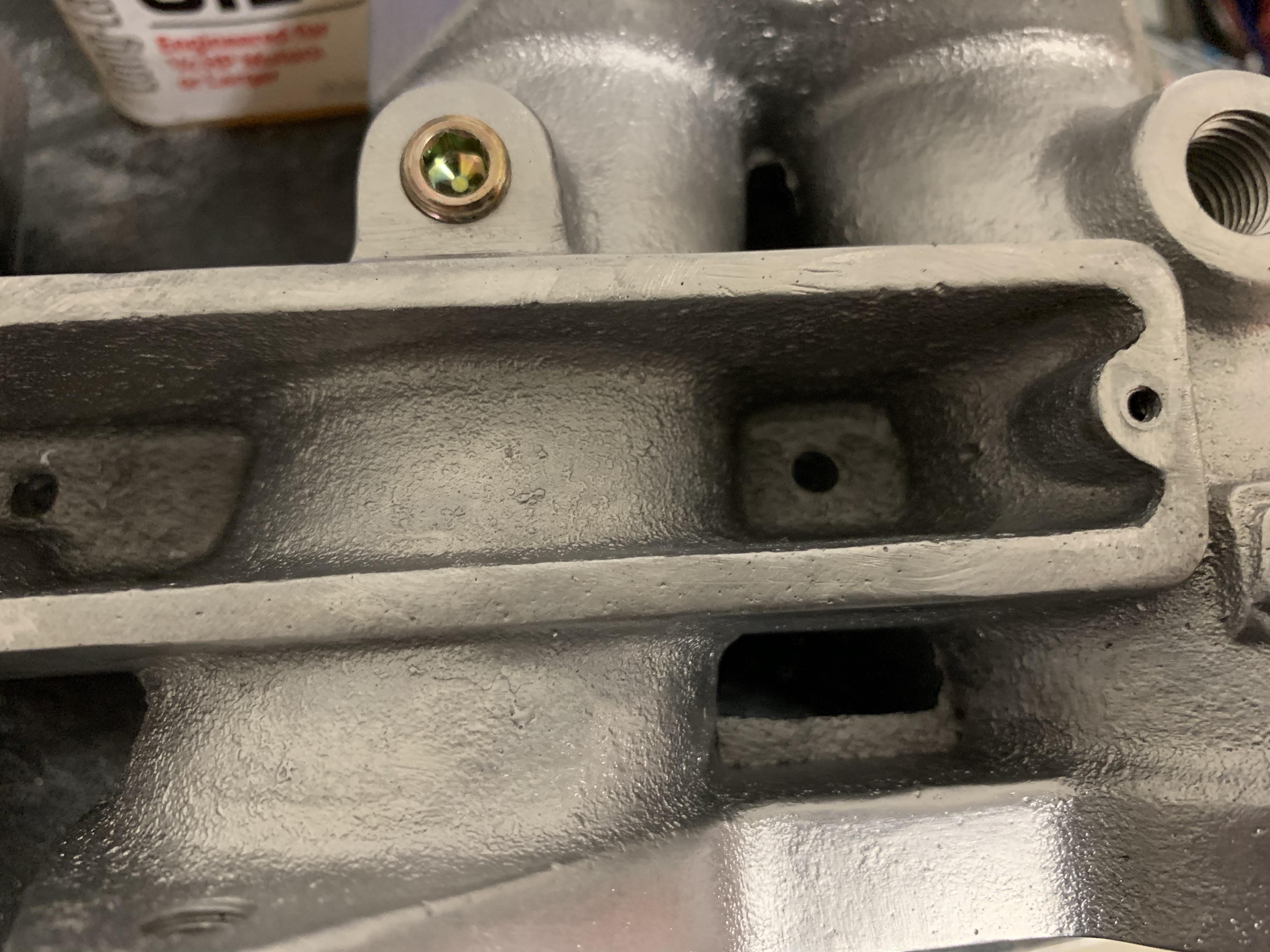

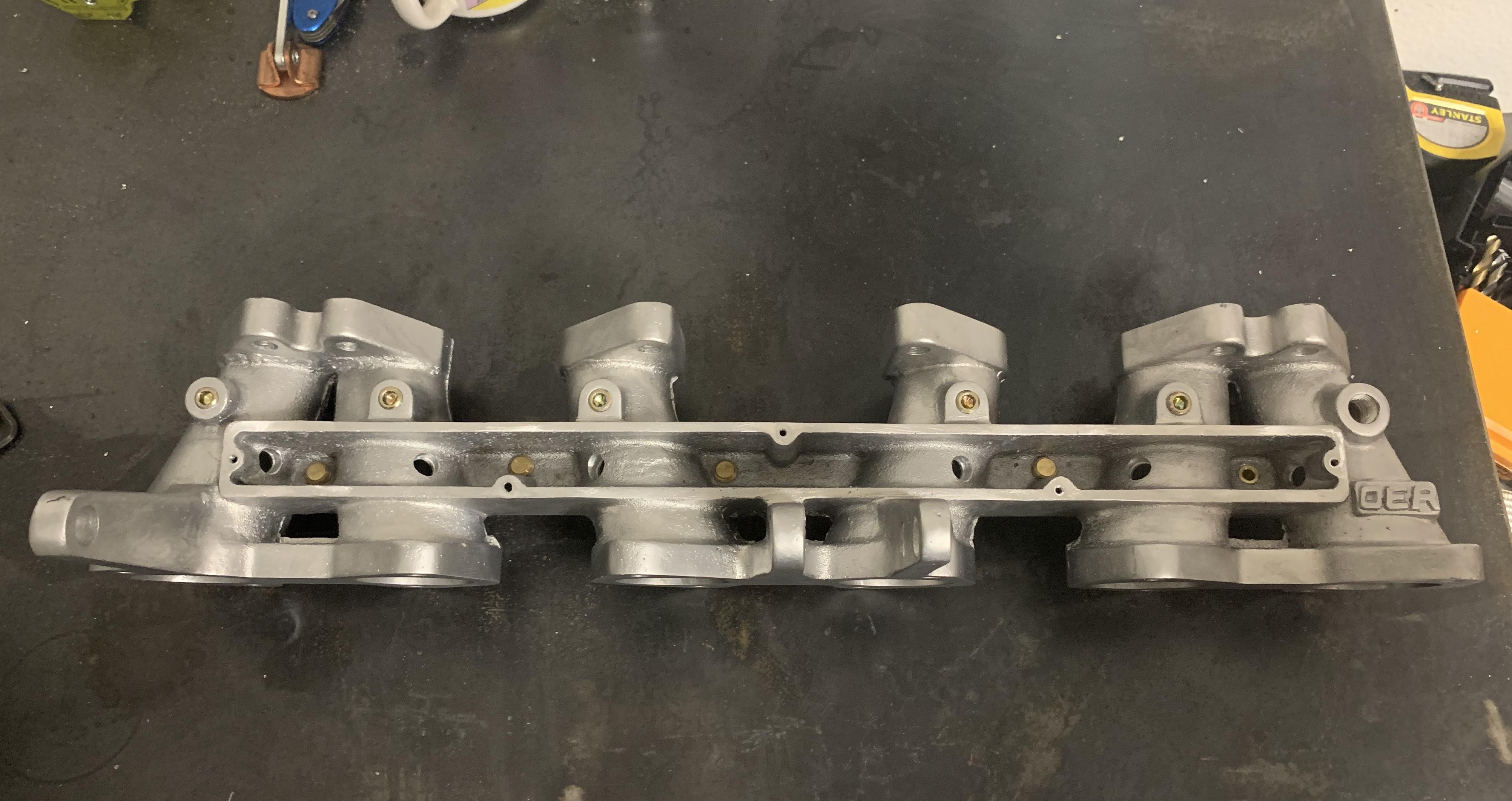

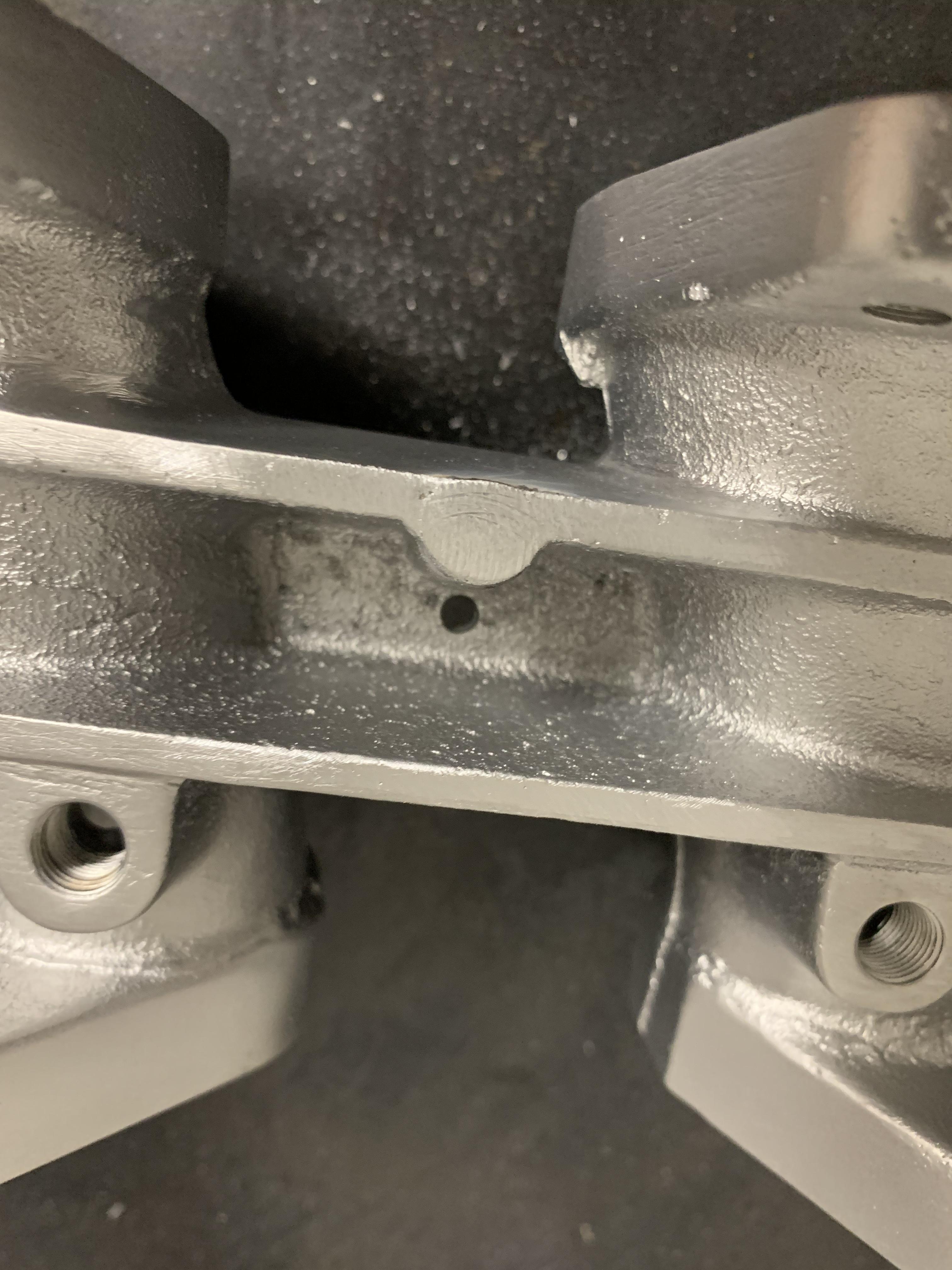

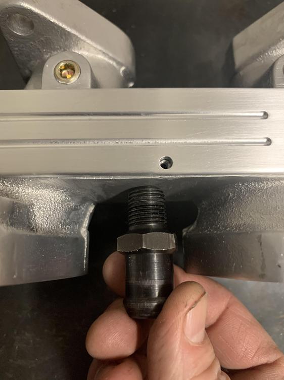

March 8, 20205 yr Author comment_593913  I got pretty far on the intake. I figured out my basic plan. I also tig welded the old holes and drilled and tapped new ones. So they are centered better.  I tapped all existing holes for npt plugs. I also drilled each runner to 9mm. I bought a bspt 1/4 for the stock pcv fitting. Also a 5/8 hose Barb by 3/8 npt brass for the iac.  I also had my stacks turned down to fit some cheap filters. Brass or no brass?   Edited March 8, 20205 yr by duffymahoney Link to comment https://www.classiczcars.com/forums/topic/58568-duffys-171-series-1-240z-build/?&page=49#findComment-593913 Share on other sites More sharing options...
March 8, 20205 yr comment_593918 No brass on the filters is my vote. Looking very clean. Link to comment https://www.classiczcars.com/forums/topic/58568-duffys-171-series-1-240z-build/?&page=49#findComment-593918 Share on other sites More sharing options...

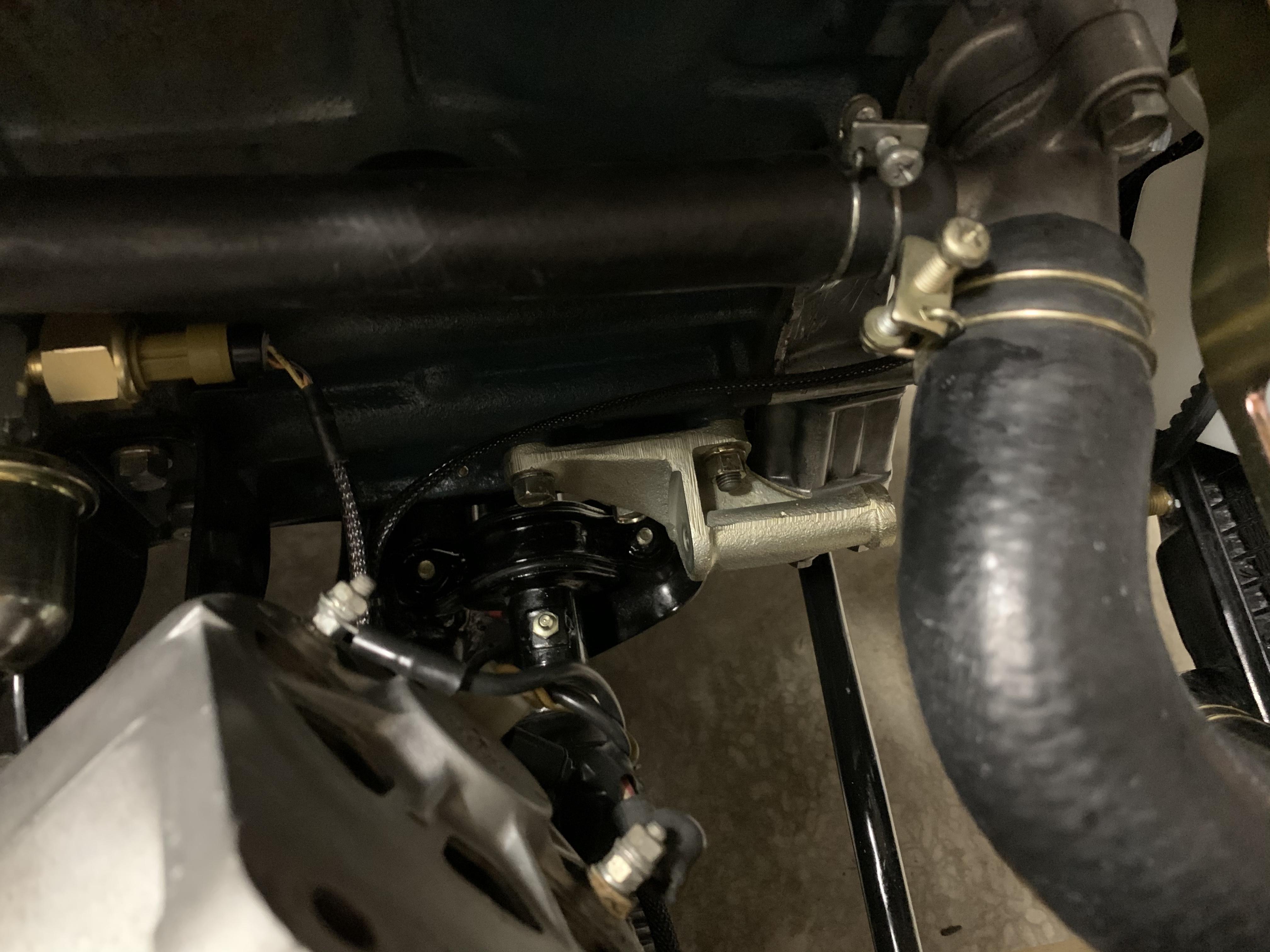

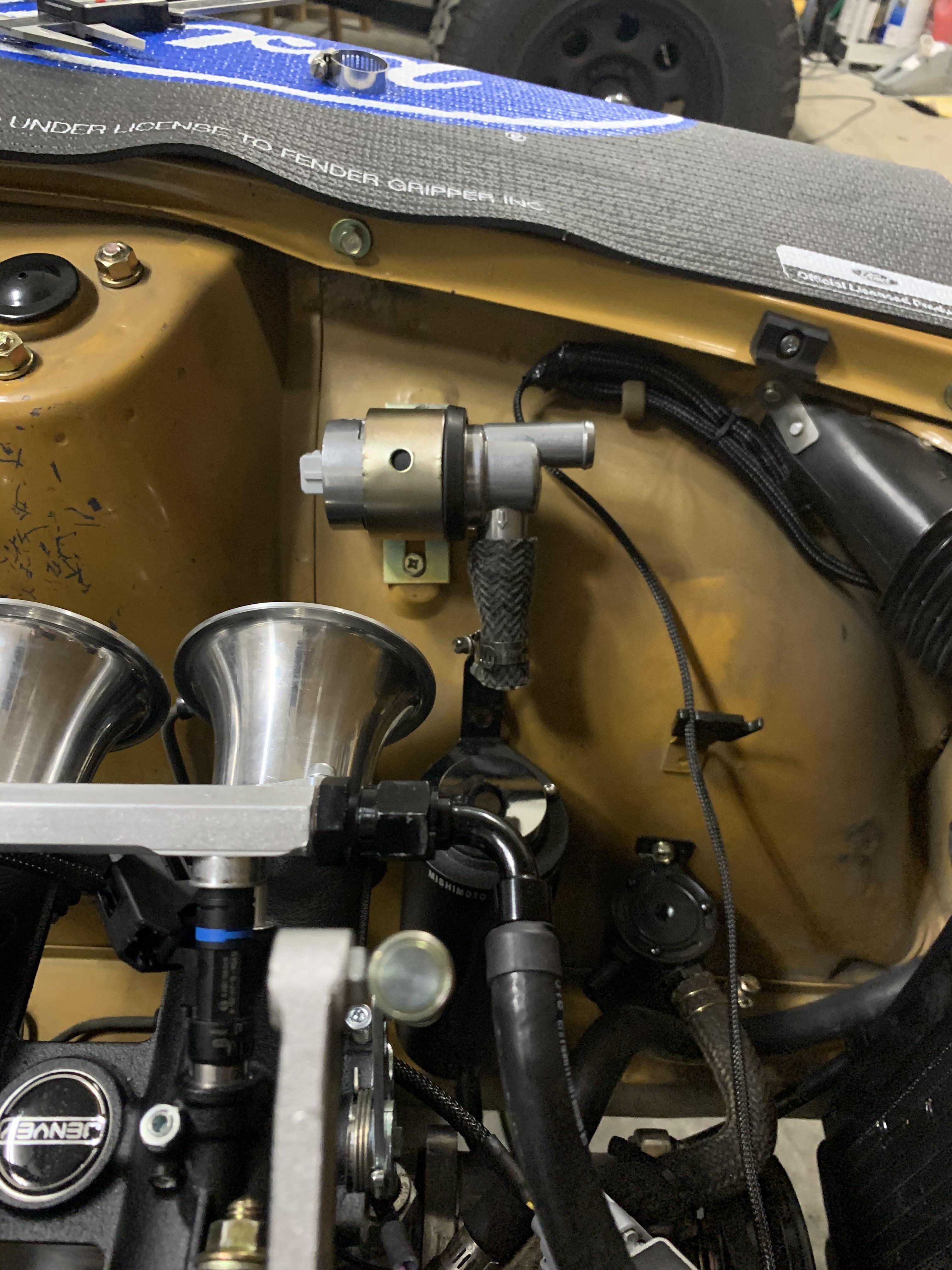

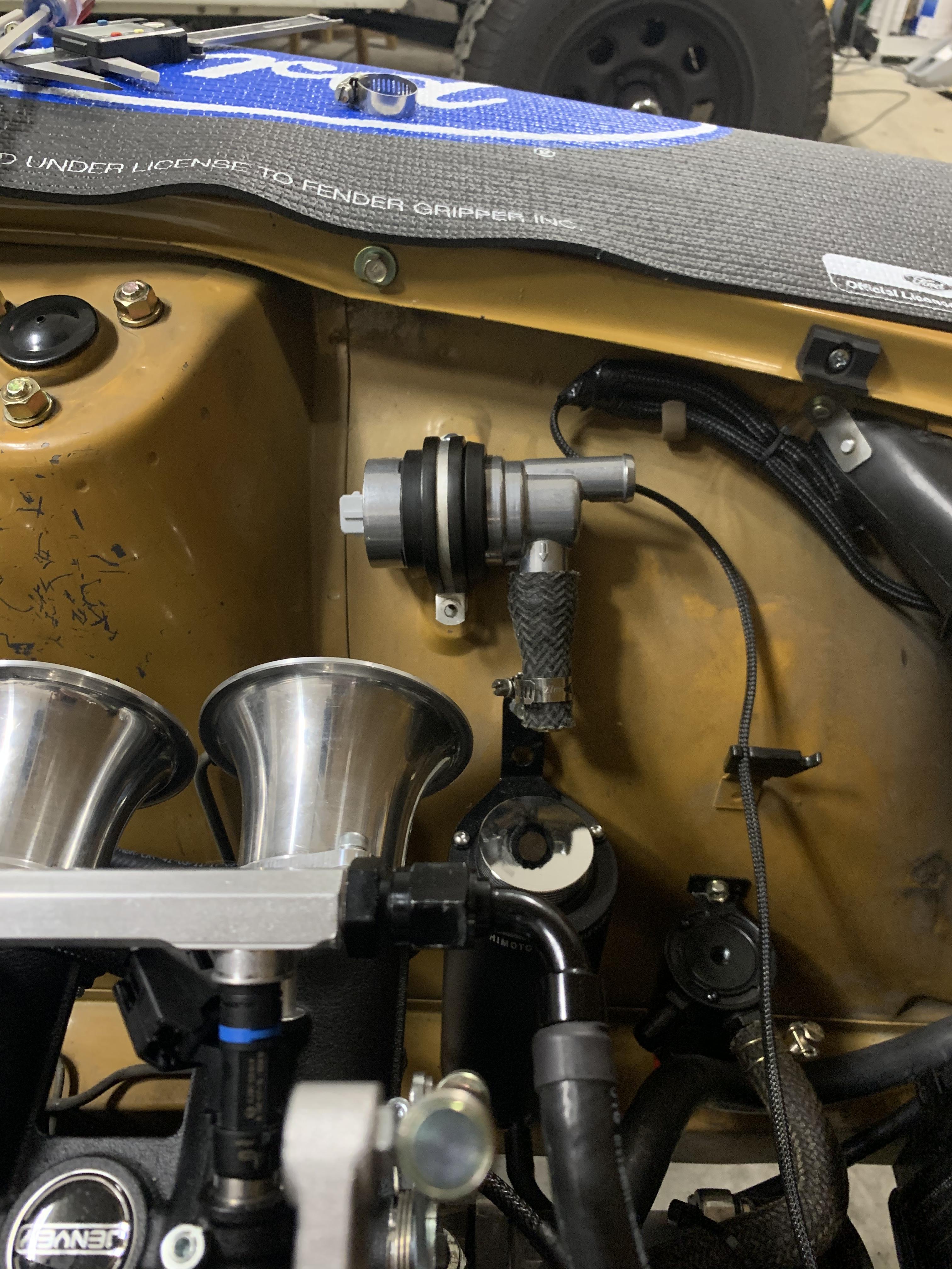

March 15, 20205 yr Author comment_594373 My decision on iac location.  I can use the stock 12v + from the coil and also the coil negative wiring for the iac connected to my haltech. So wiring will stay the same. Link to comment https://www.classiczcars.com/forums/topic/58568-duffys-171-series-1-240z-build/?&page=49#findComment-594373 Share on other sites More sharing options...
March 15, 20205 yr comment_594381 My decision on iac location.  I can use the stock 12v + from the coil and also the coil negative wiring for the iac connected to my haltech. So wiring will stay the same. Why don’t you live near me?? We have so much in common...Sent from my iPhone using Tapatalk Link to comment https://www.classiczcars.com/forums/topic/58568-duffys-171-series-1-240z-build/?&page=49#findComment-594381 Share on other sites More sharing options...
