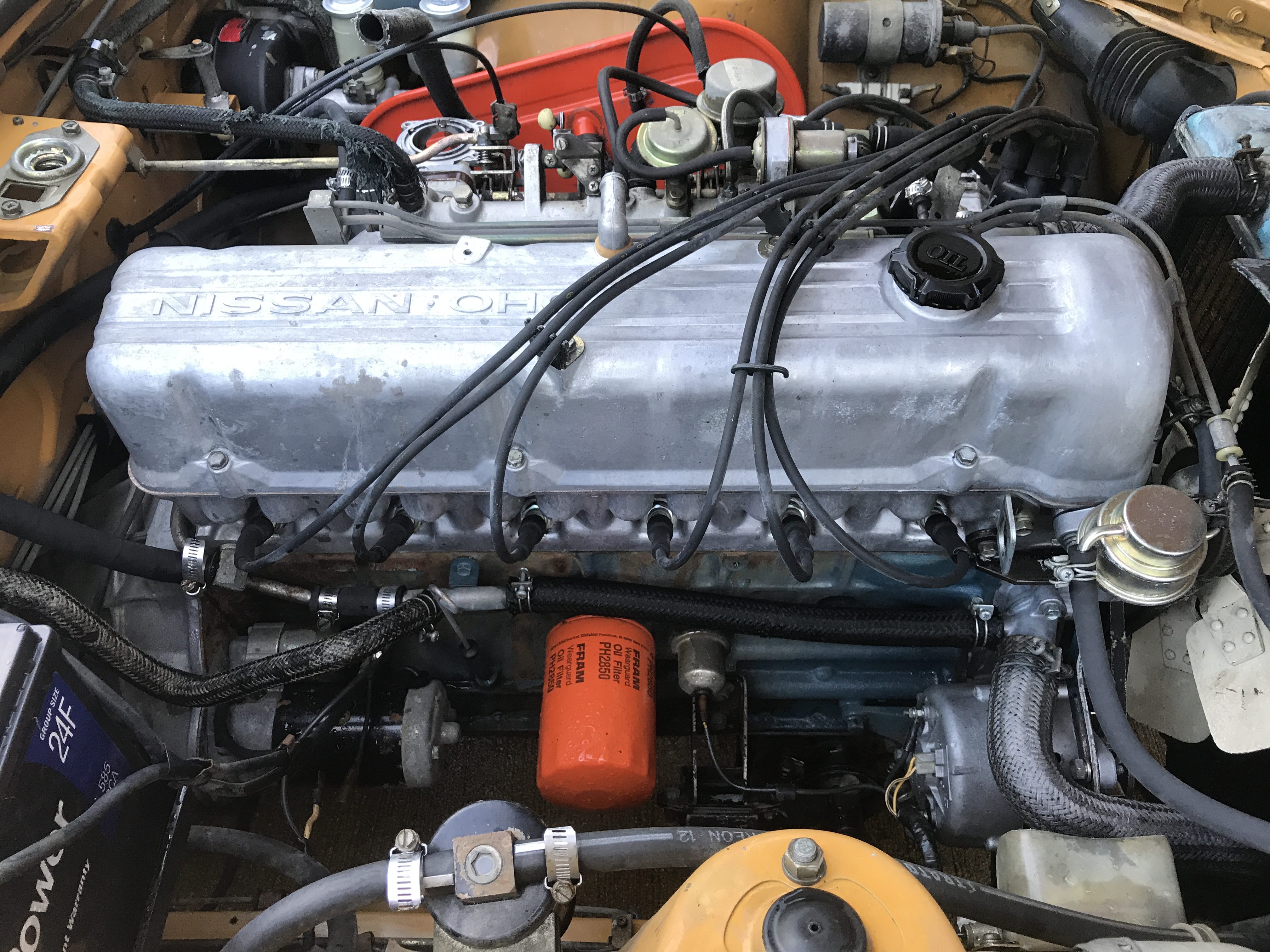

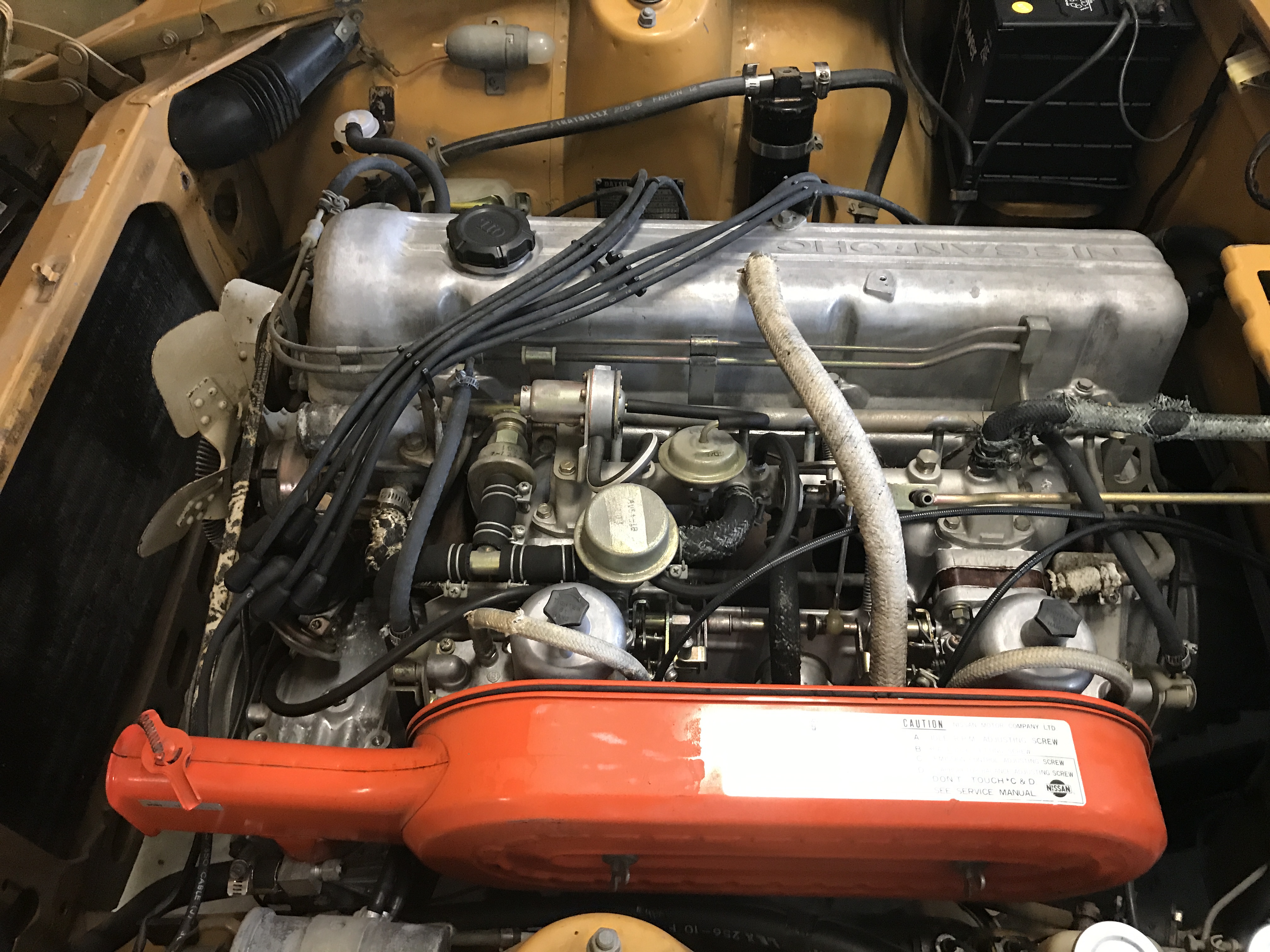

I got it running.  I wish I could post the video, it runs so nice.

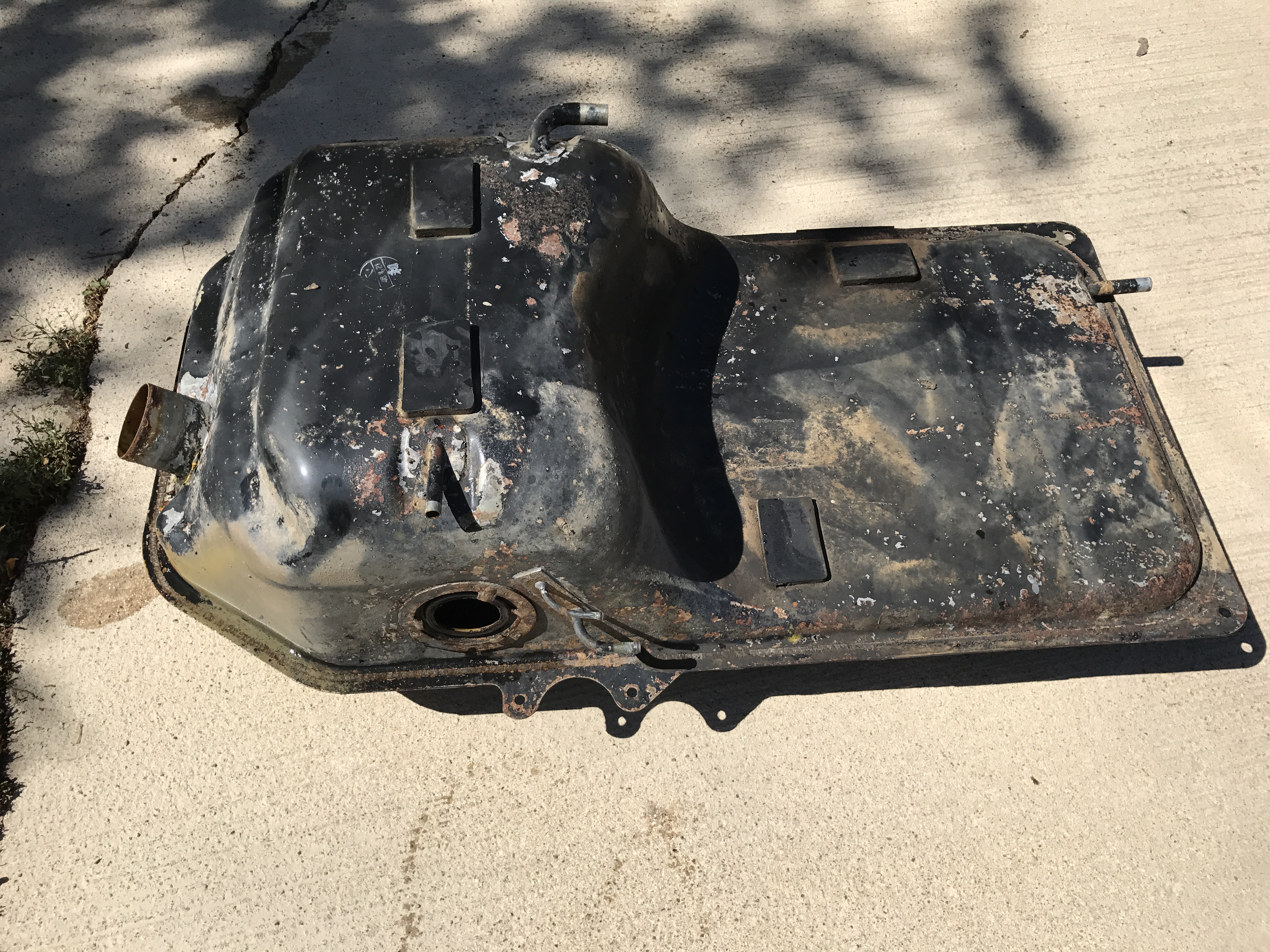

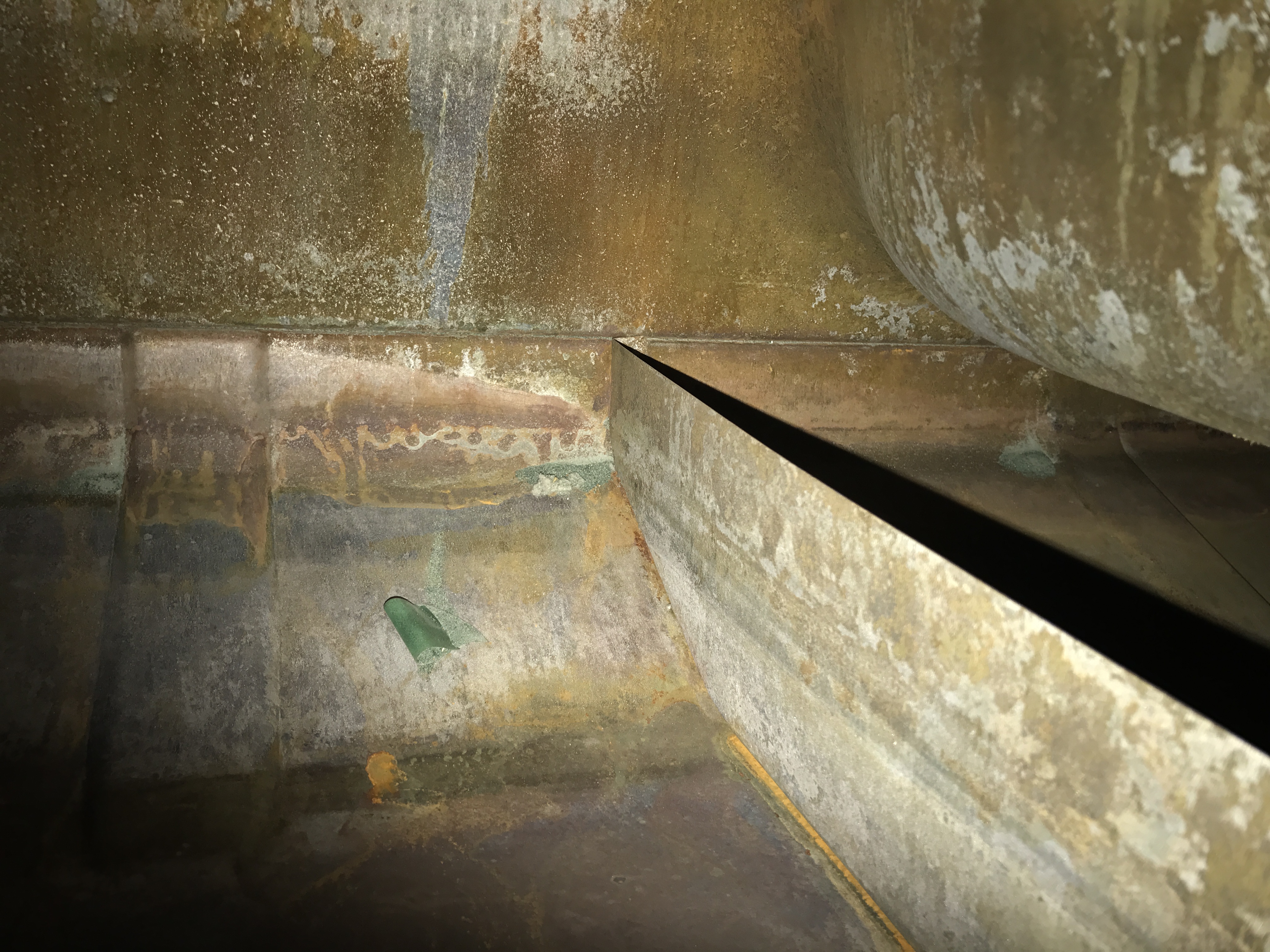

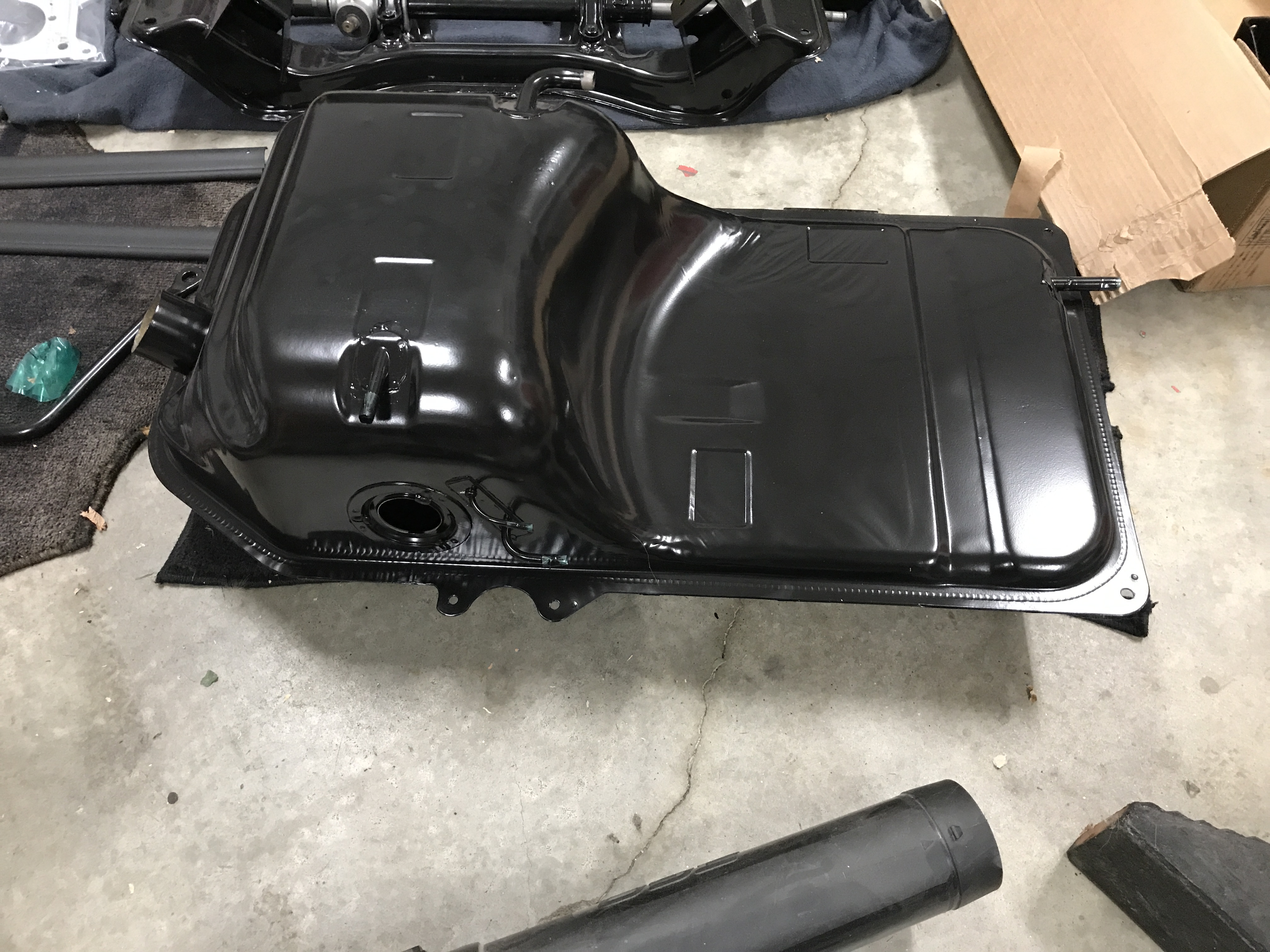

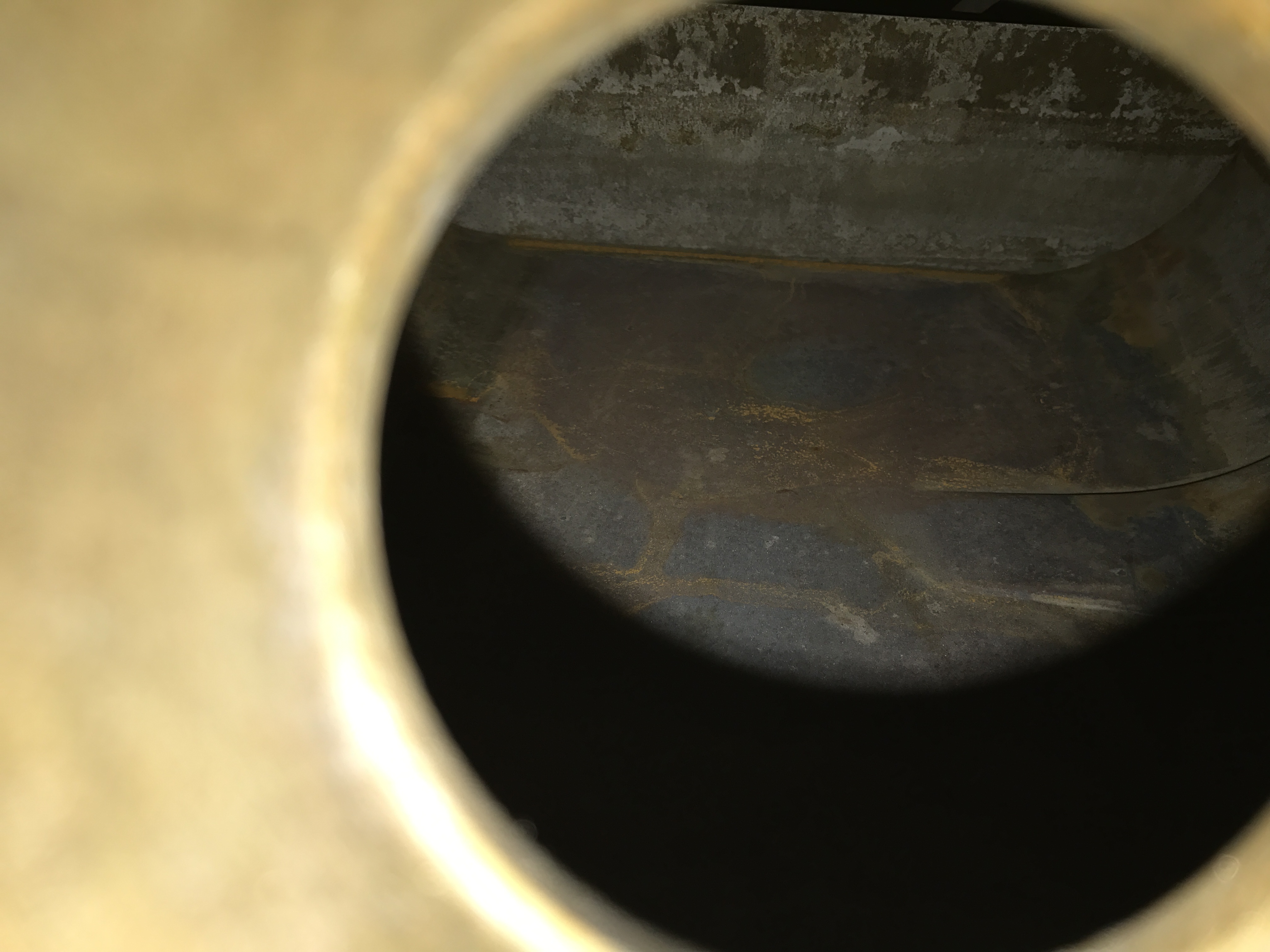

I cleaned the fuel system then I got her to start.  Wow am I happy.  Also spent some time detailing out the motor.  The gas tank is very very gross, it's off to get hot tanked and acid cleaned.  Then powder coated then red coat.

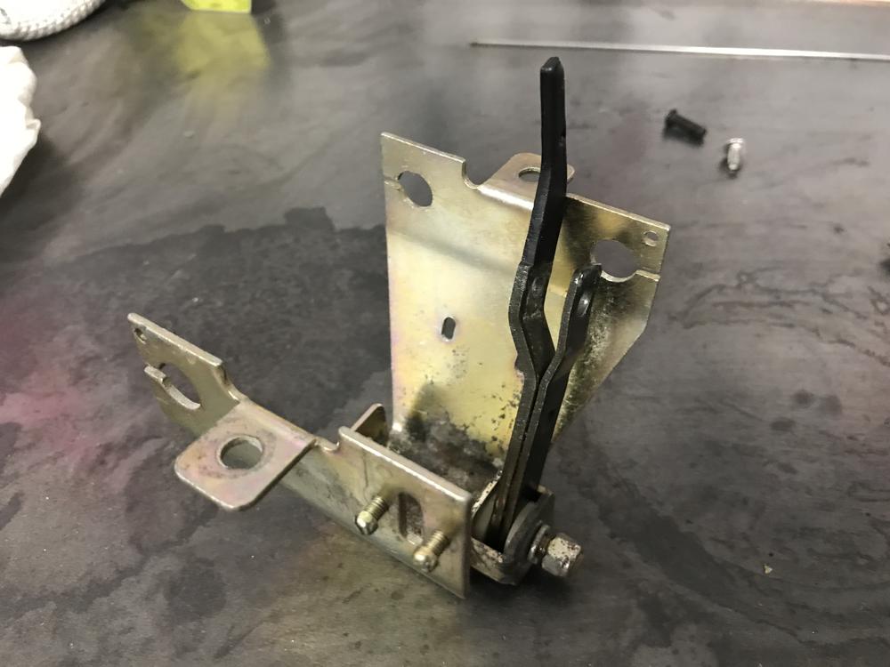

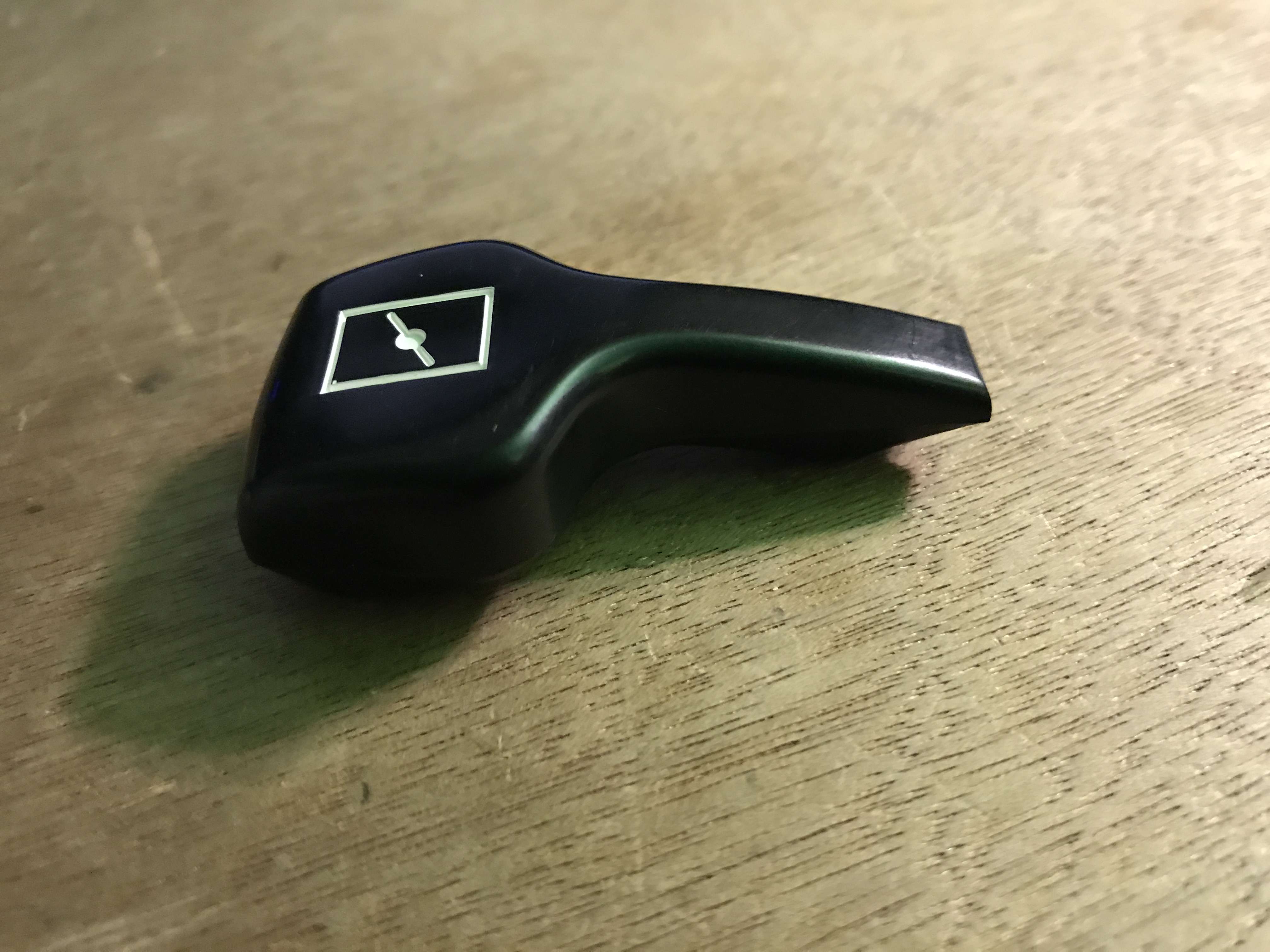

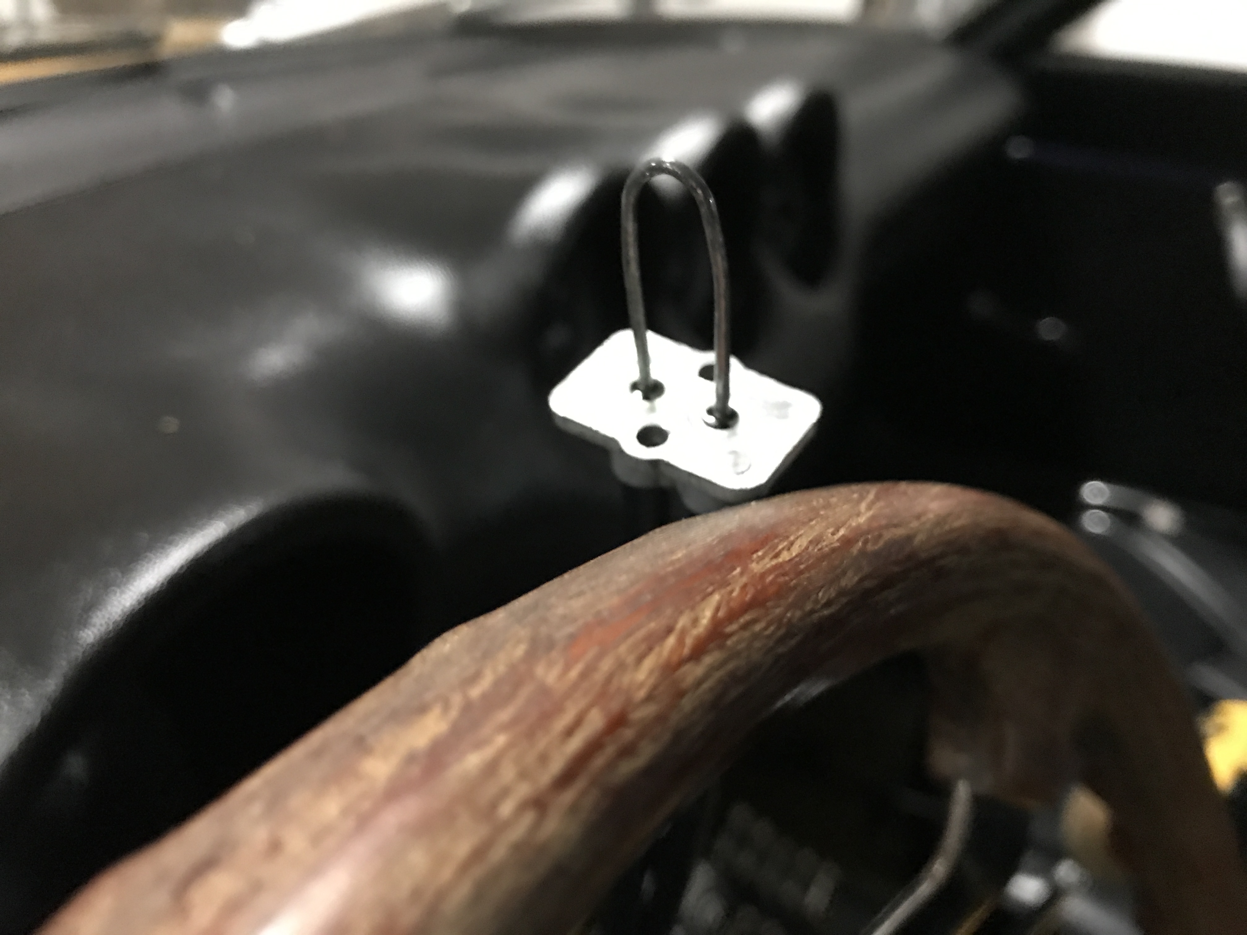

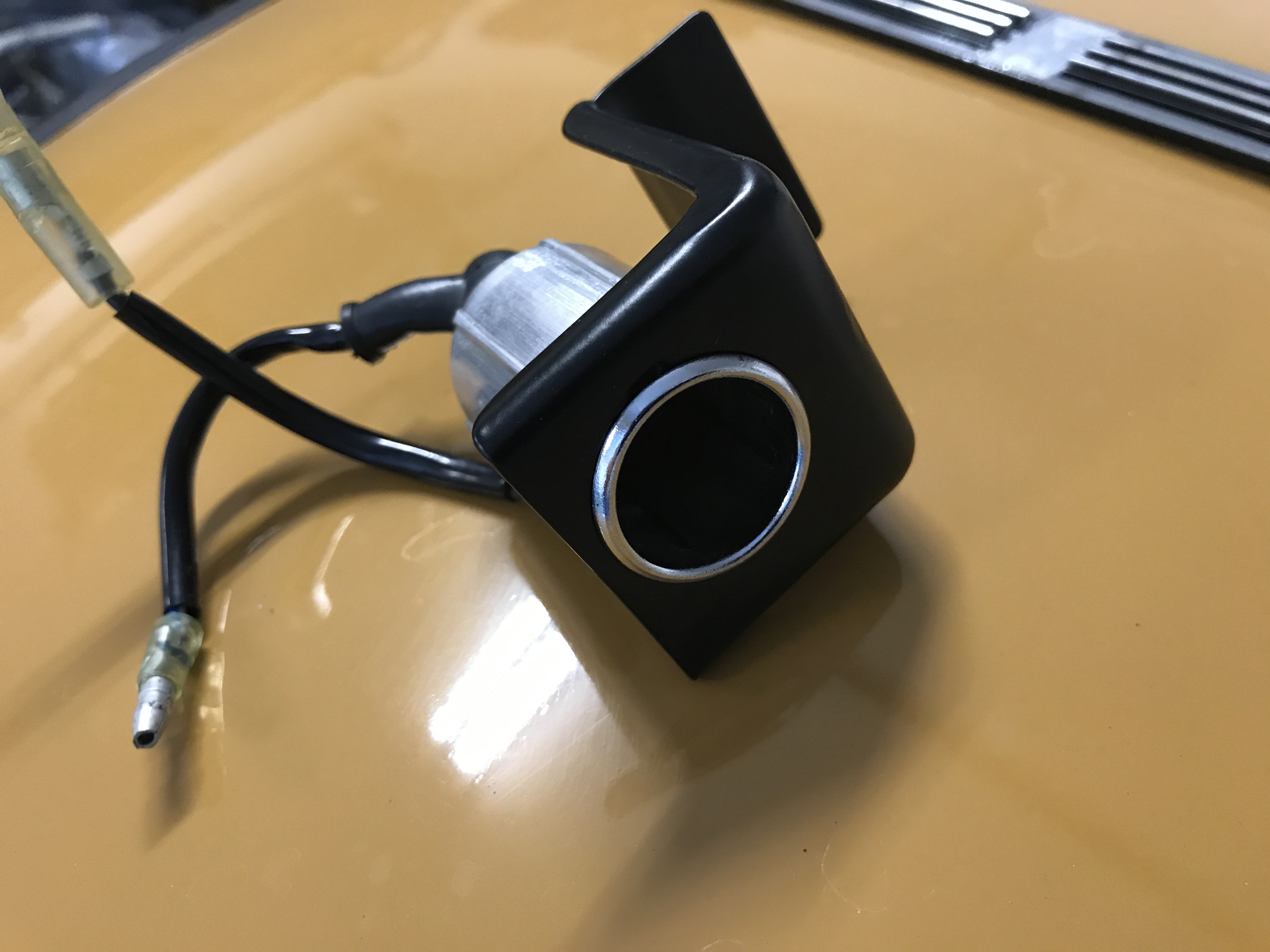

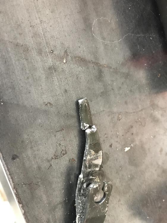

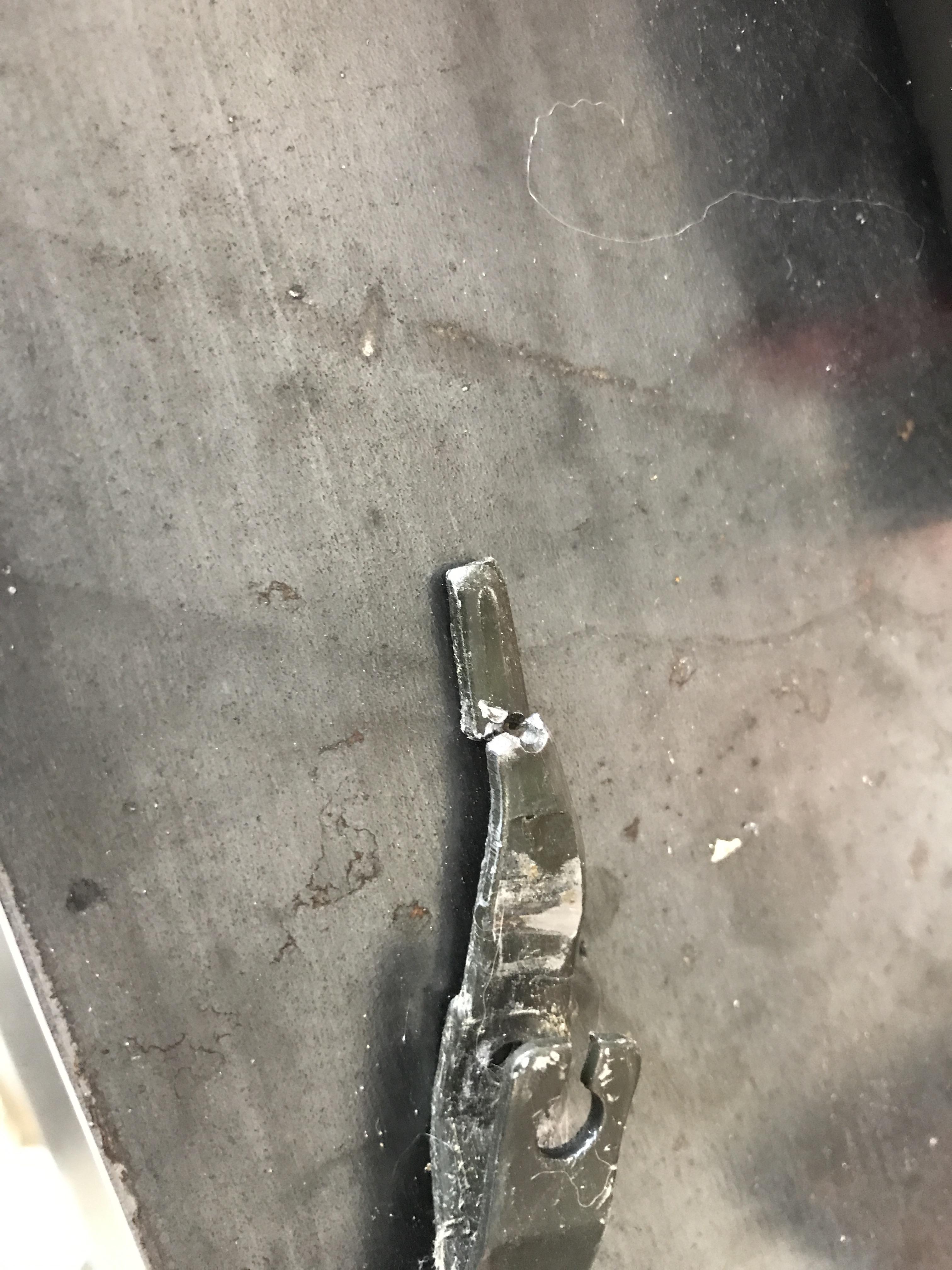

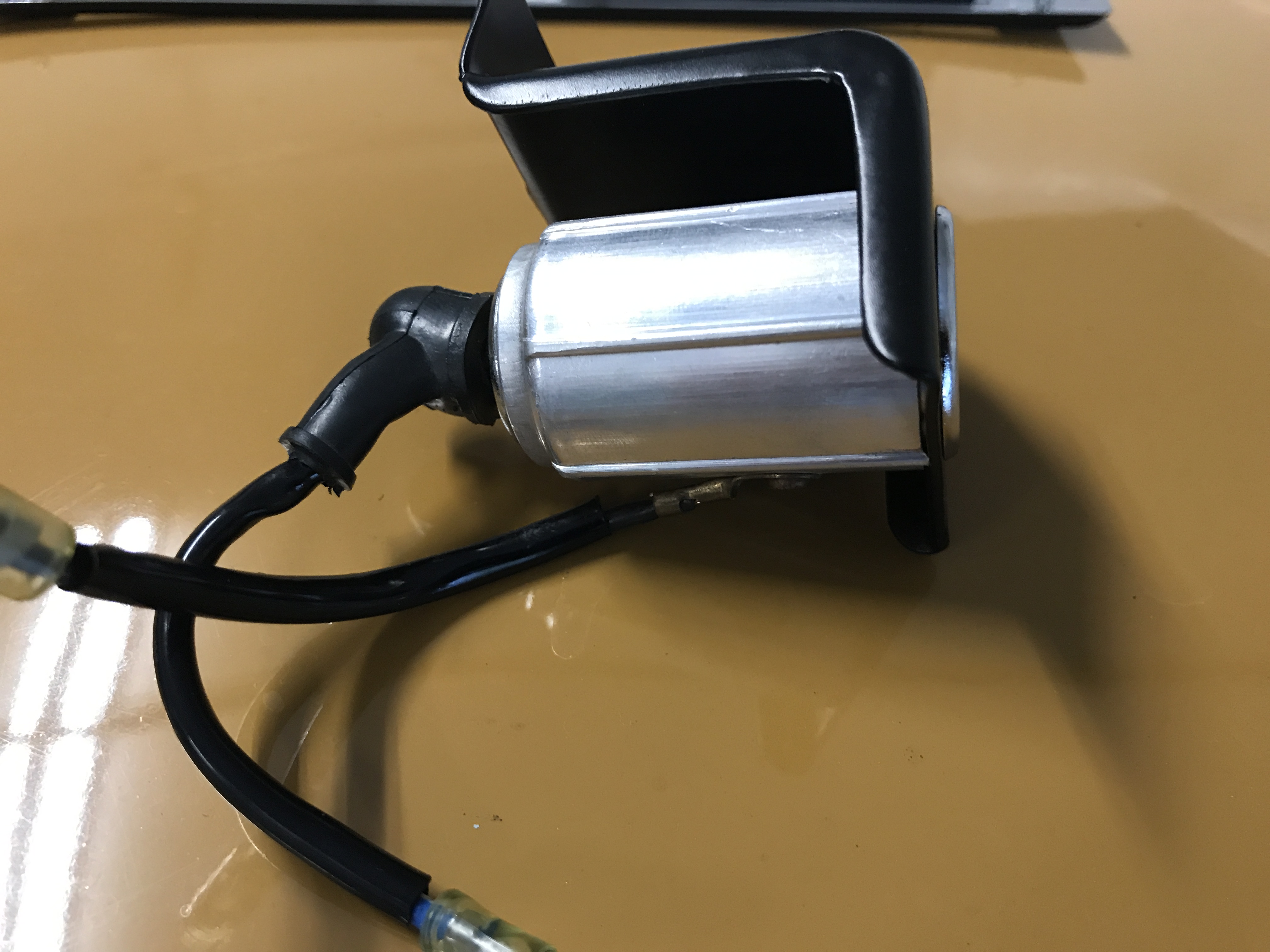

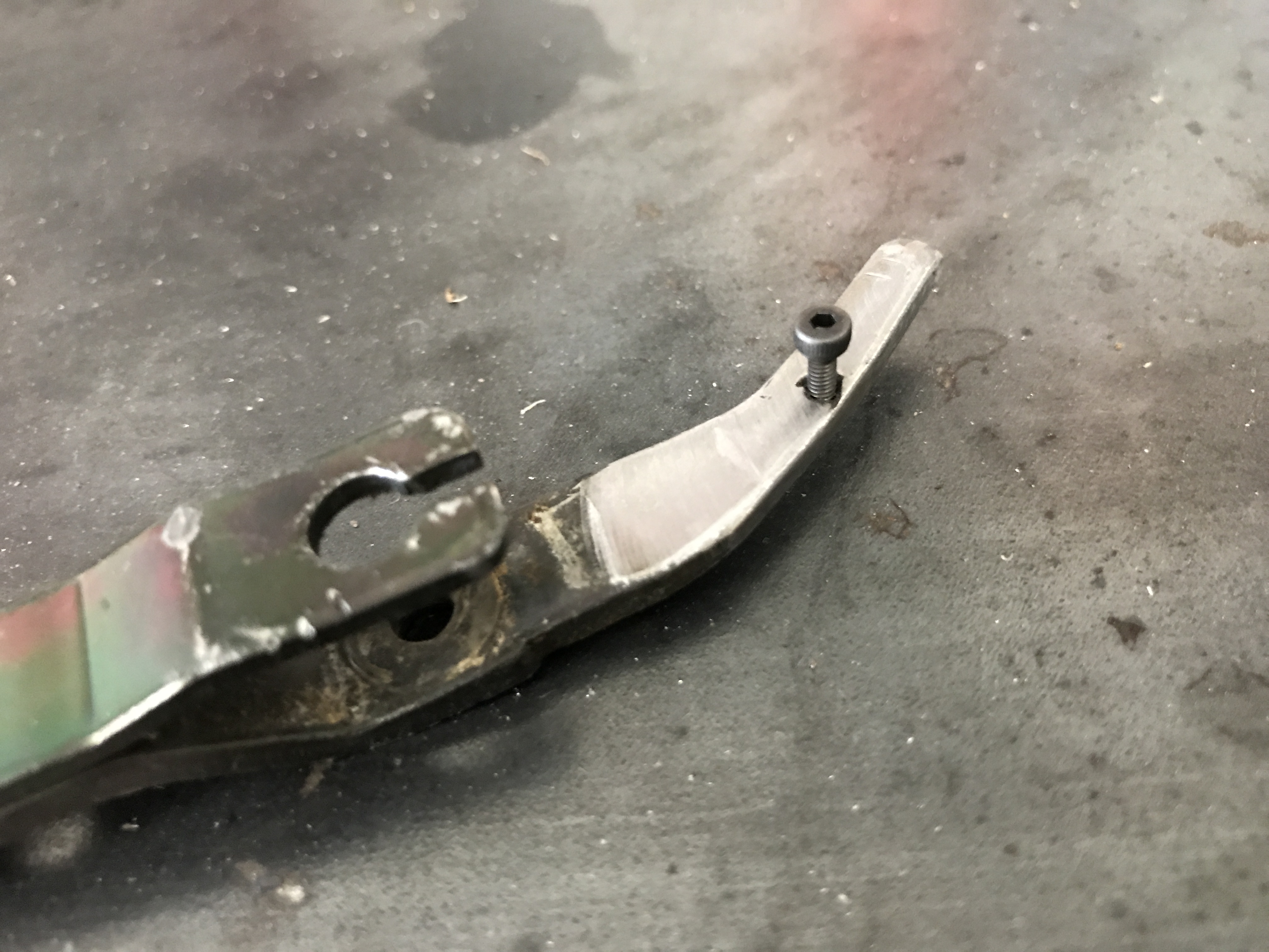

Choke cable was stuck which made it hard to start.  I greased the cable and  I also tig welded the choke handle back together.  I also have the electronic and all lighting to work.  Took the cig port fully apart and detailed it and powder coated its bracket.  Happy it all works now.

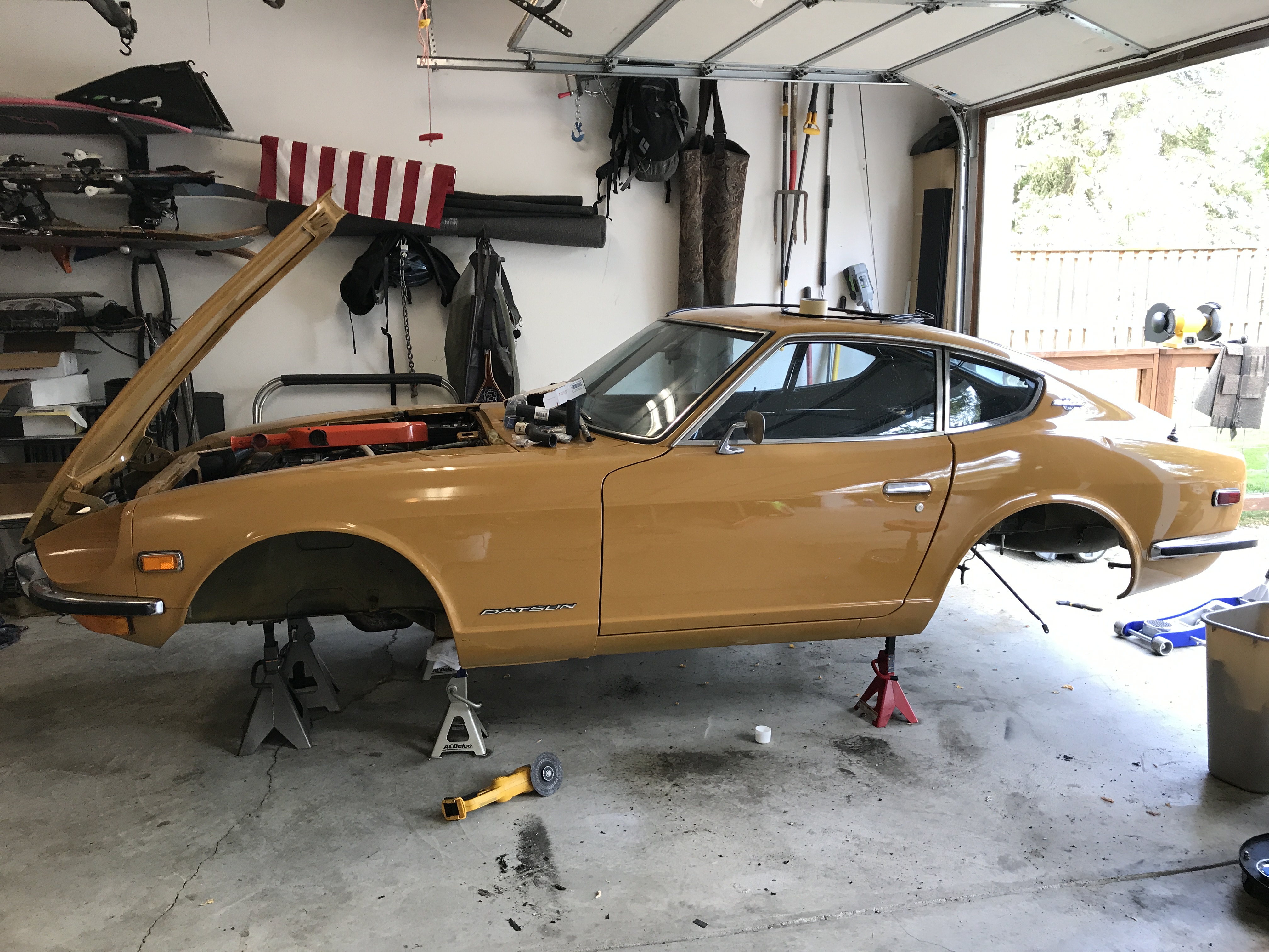

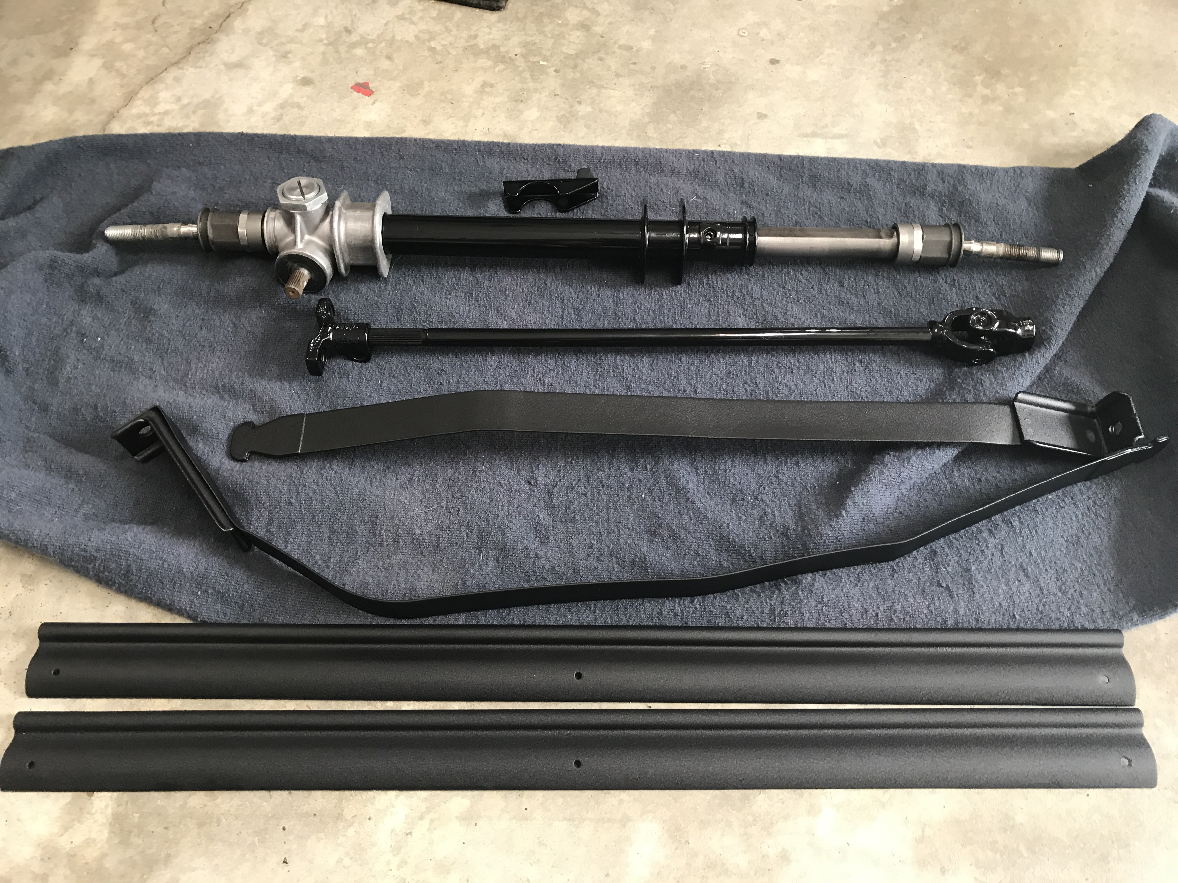

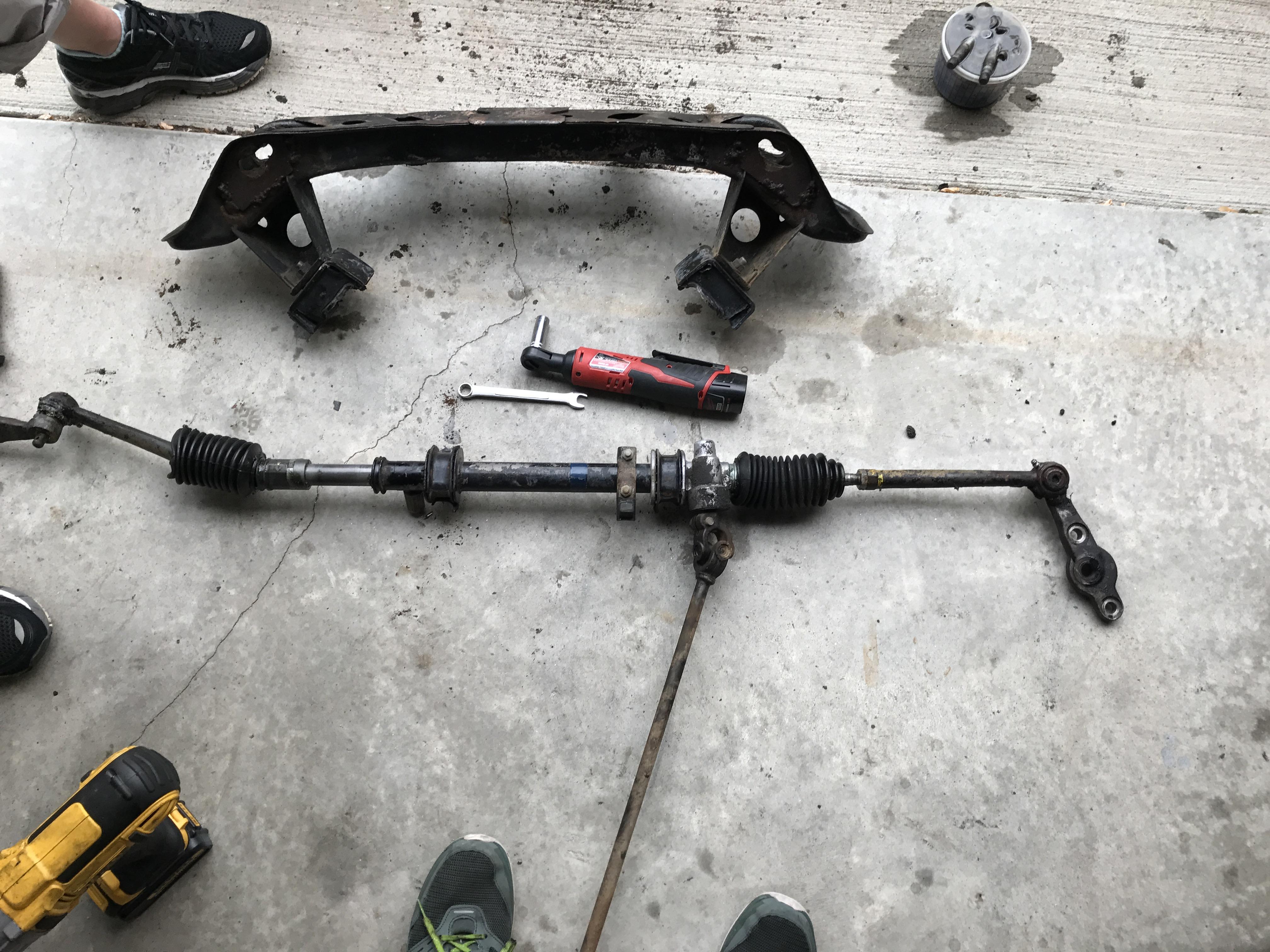

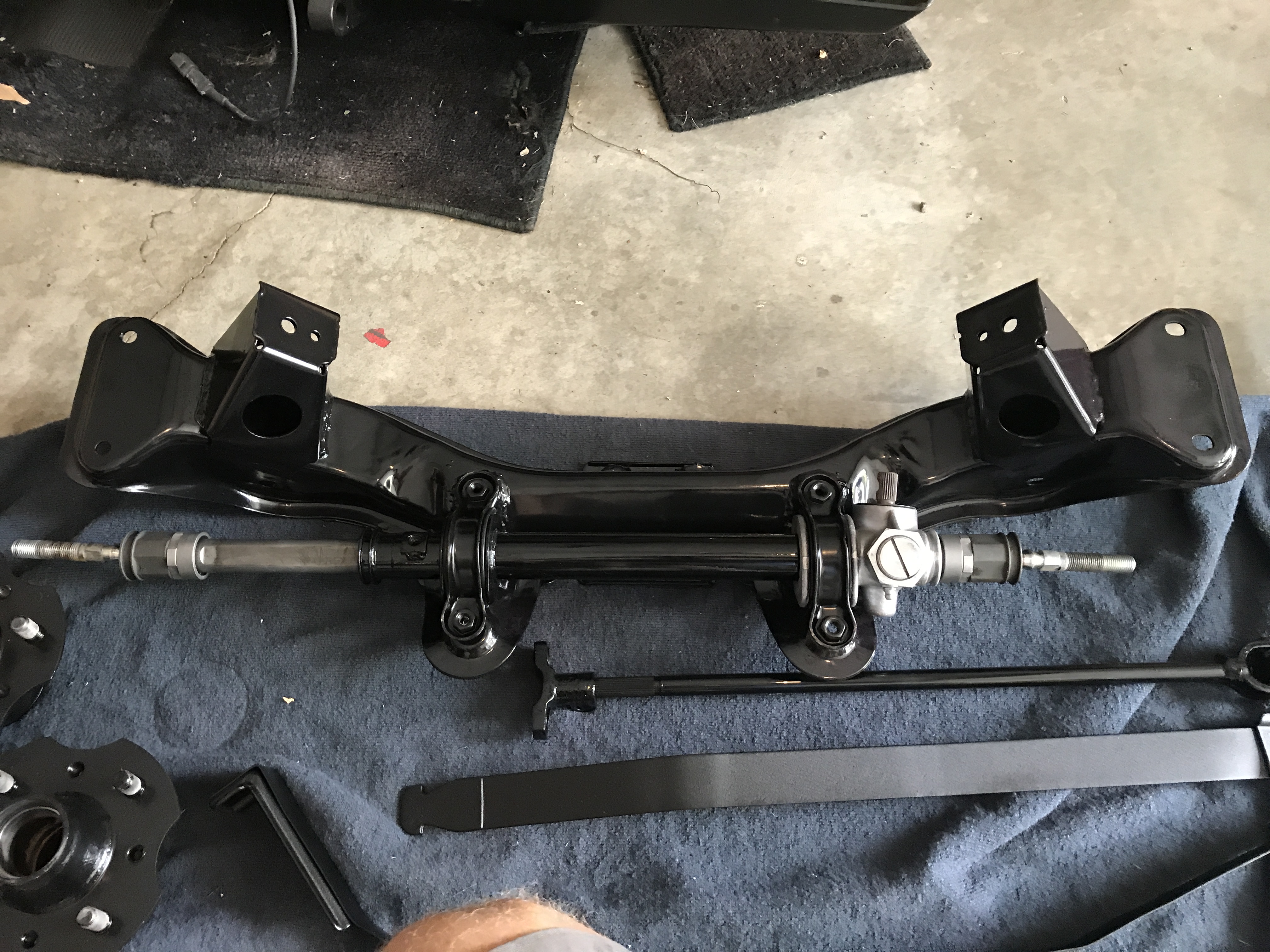

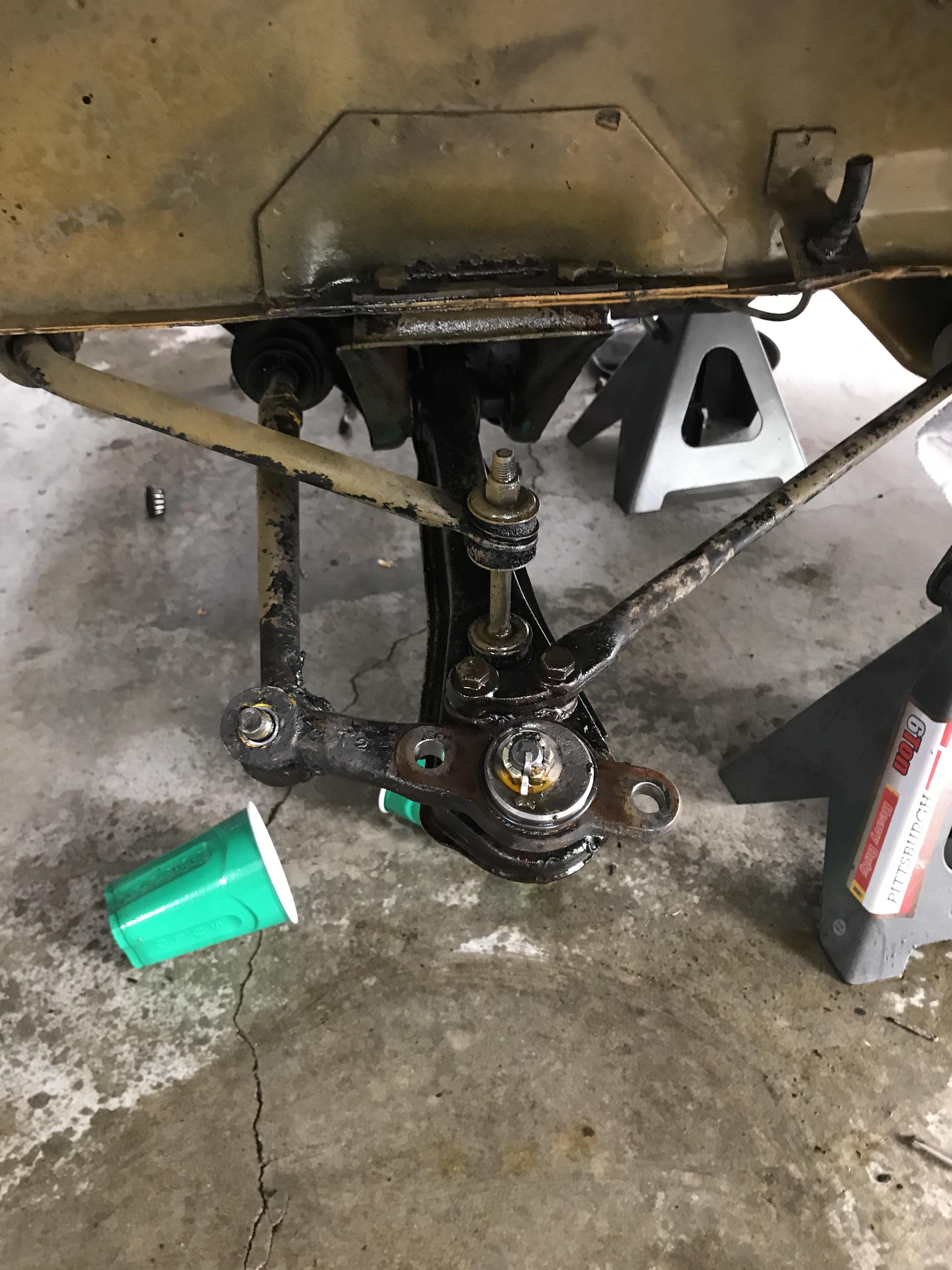

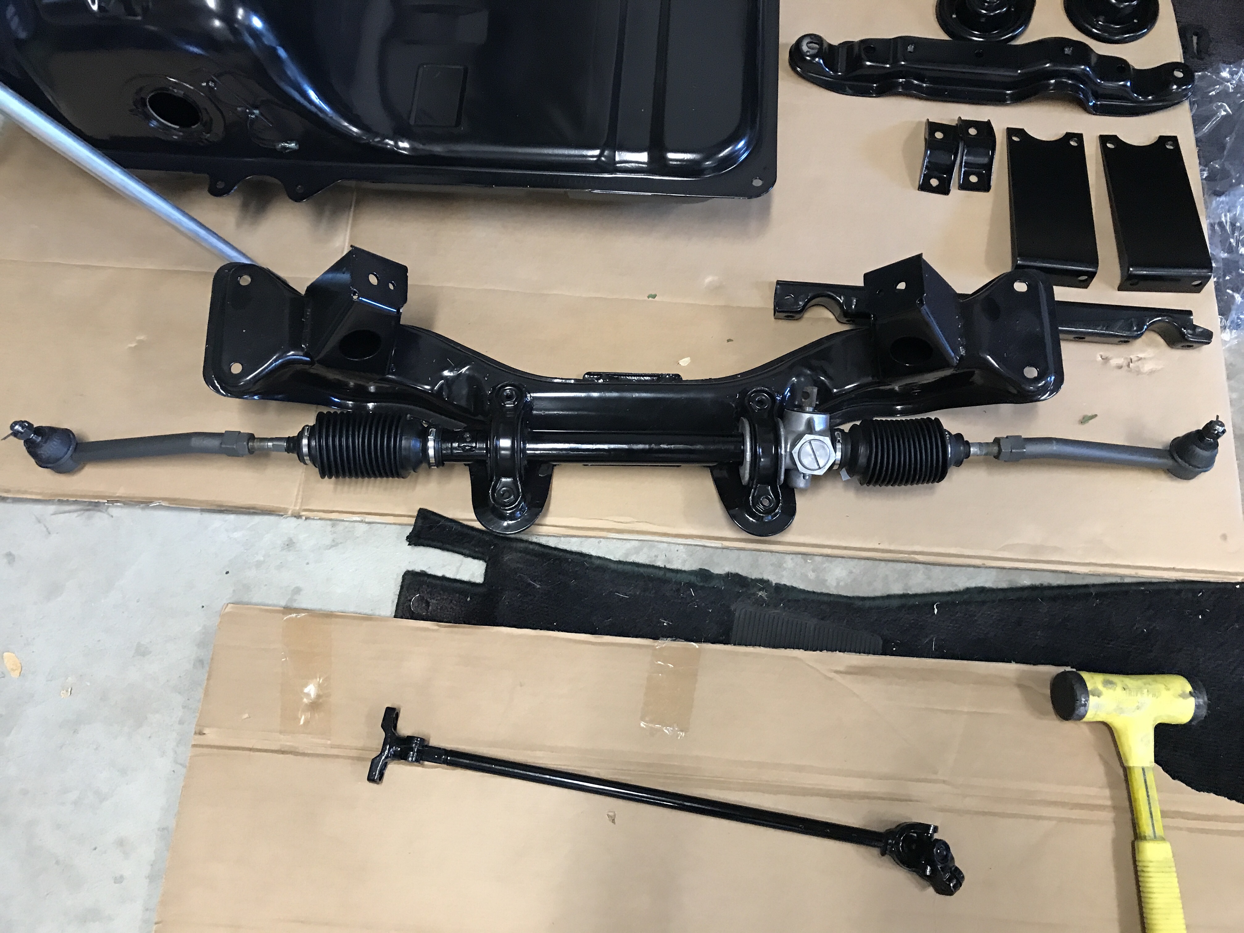

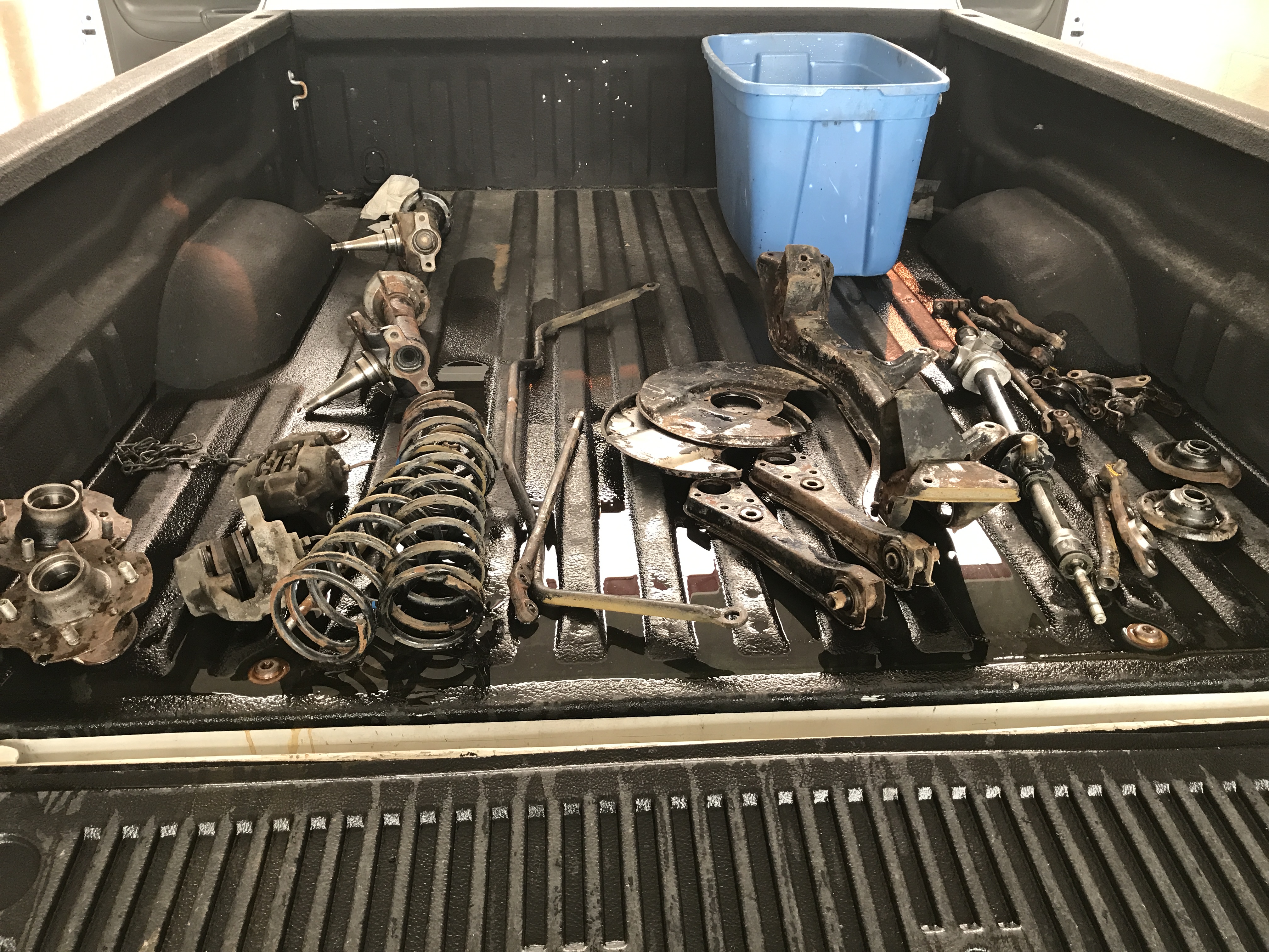

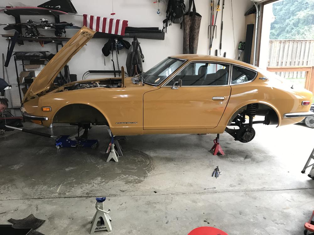

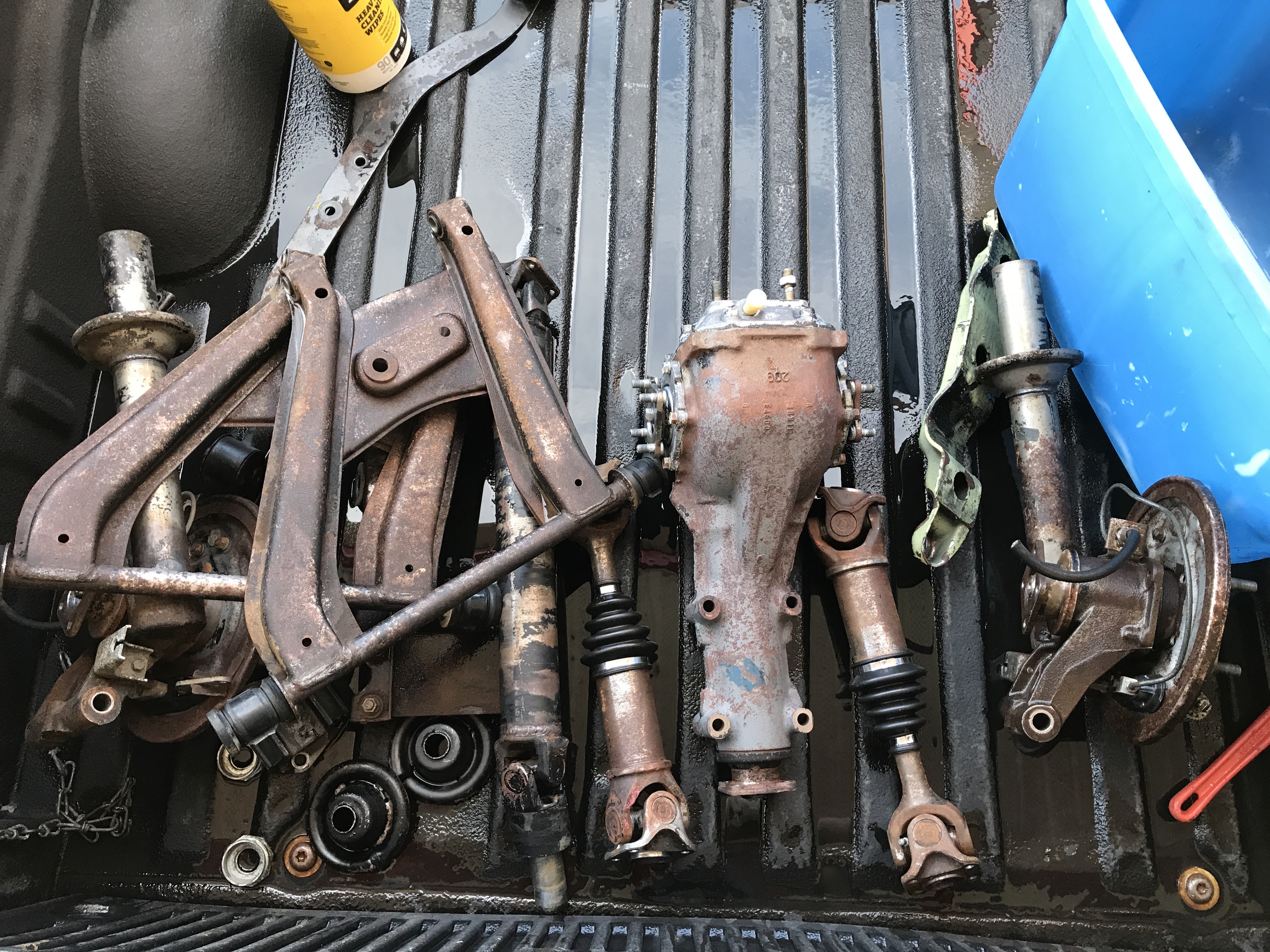

I have decided to tackle the front suspension/ steering work next.  This mean all bolts, nuts, washer etc.. off to zinc and powder coating everything I can or stripping and 2 part painting stuff like the steering shaft and steering rack.  It was a greasy gross mess, but it should look beautiful when done.

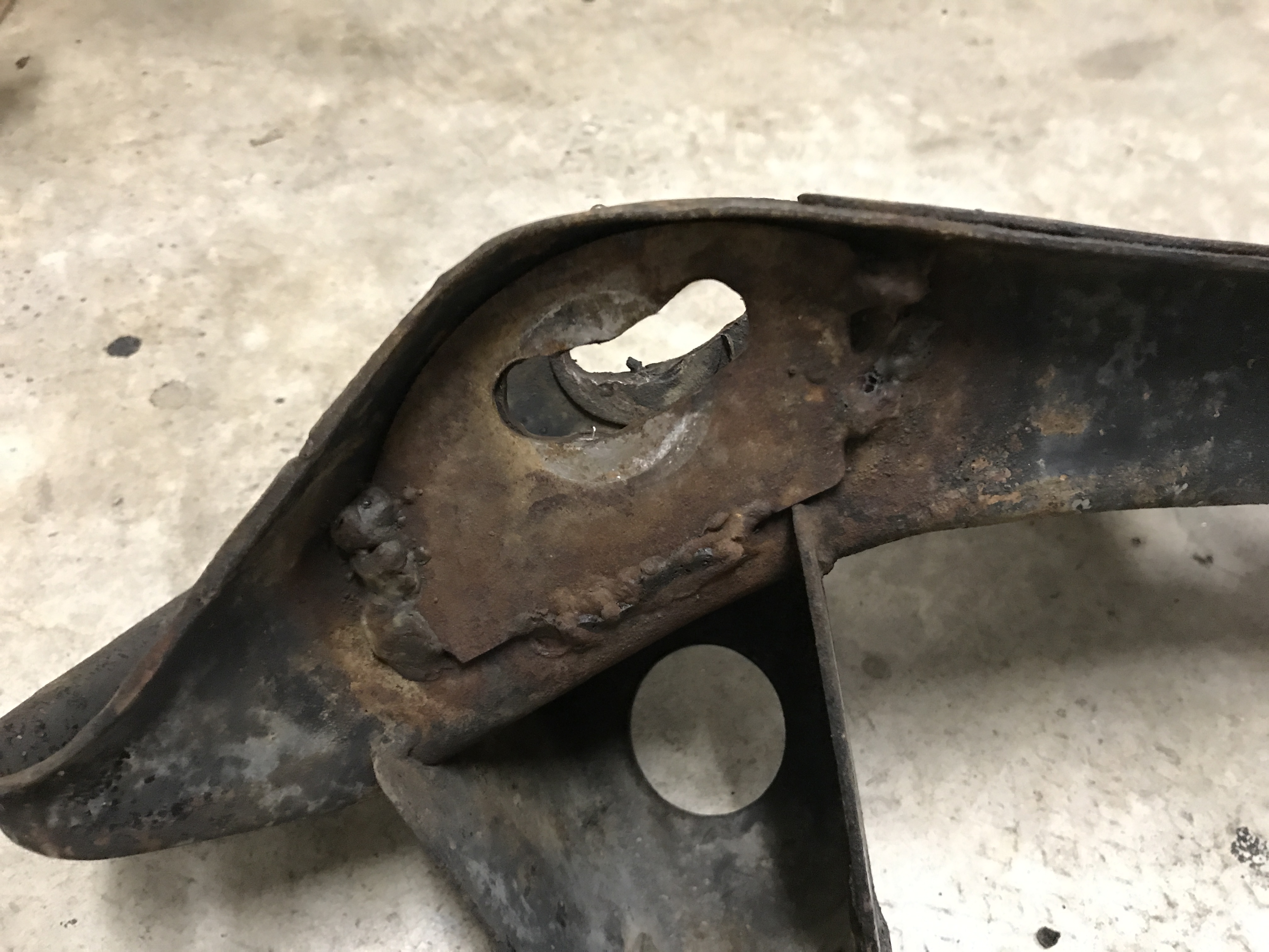

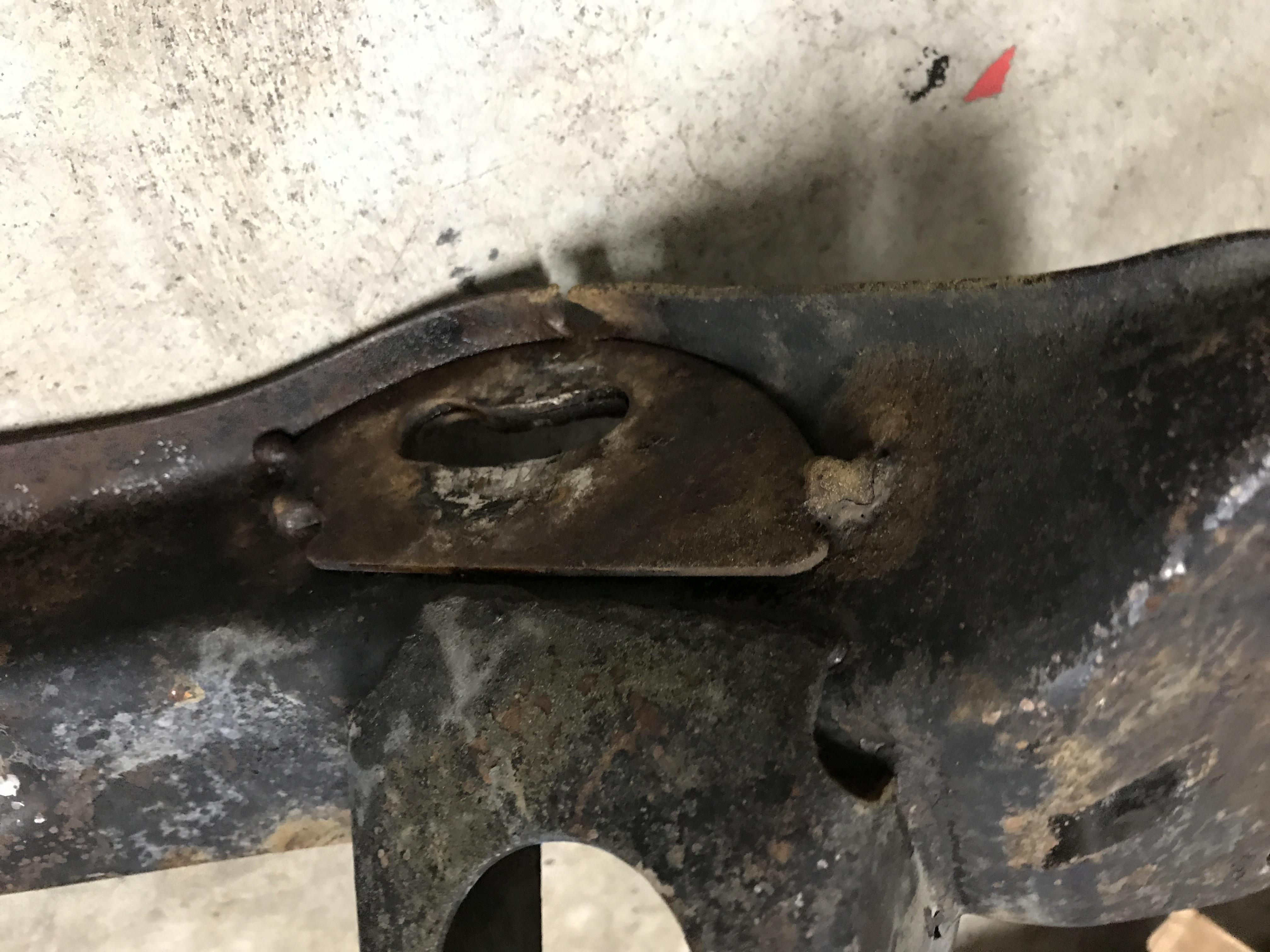

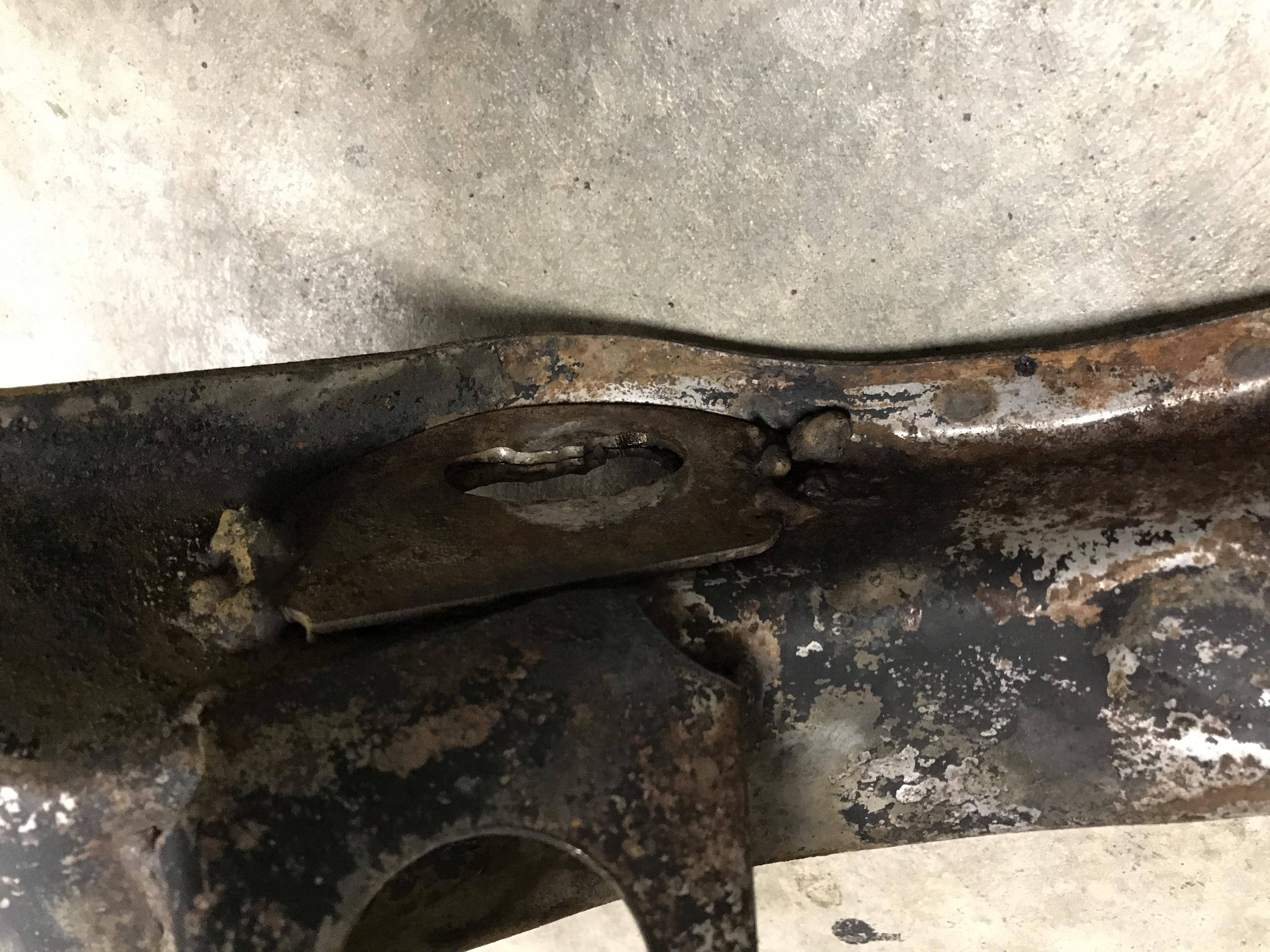

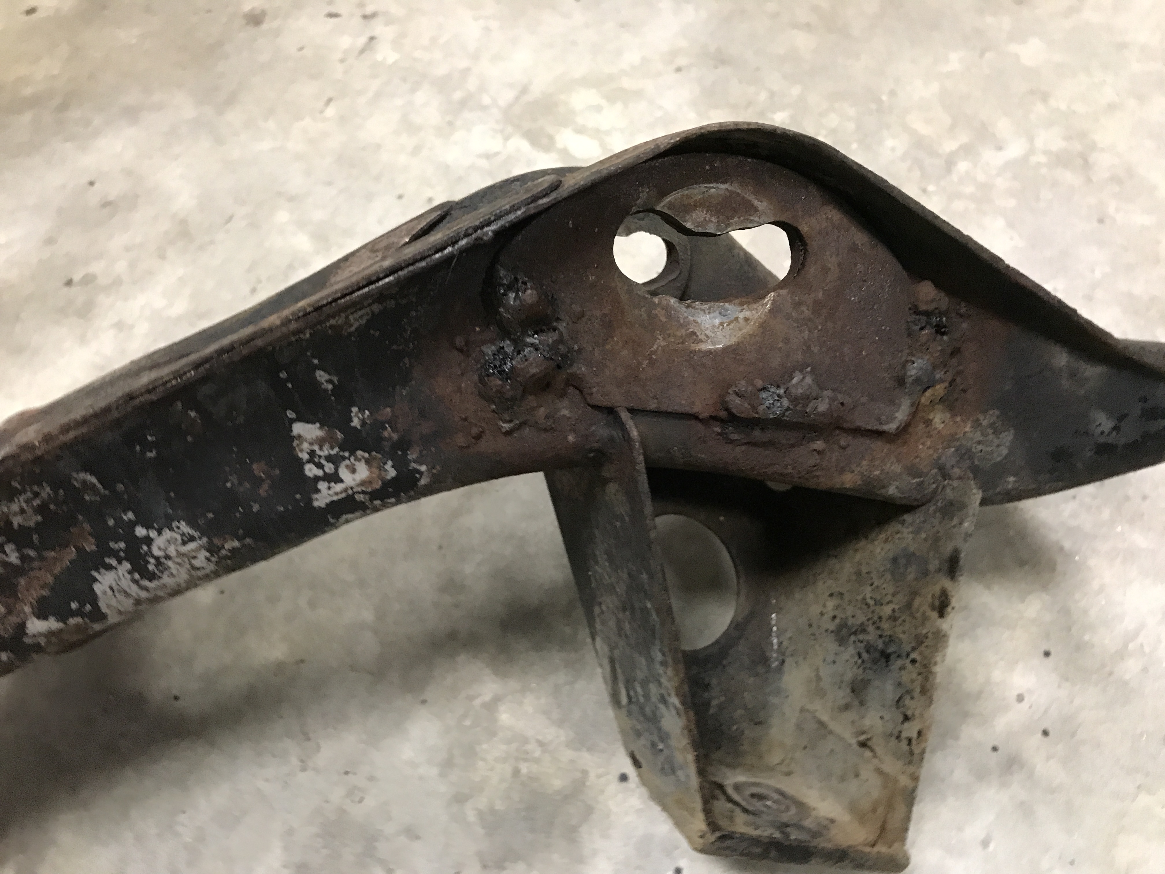

Looks like someone slotted my cross-member (no clue what it's actually called).  Luckily someone local had a series one for parts and that person made me a good deal on it.

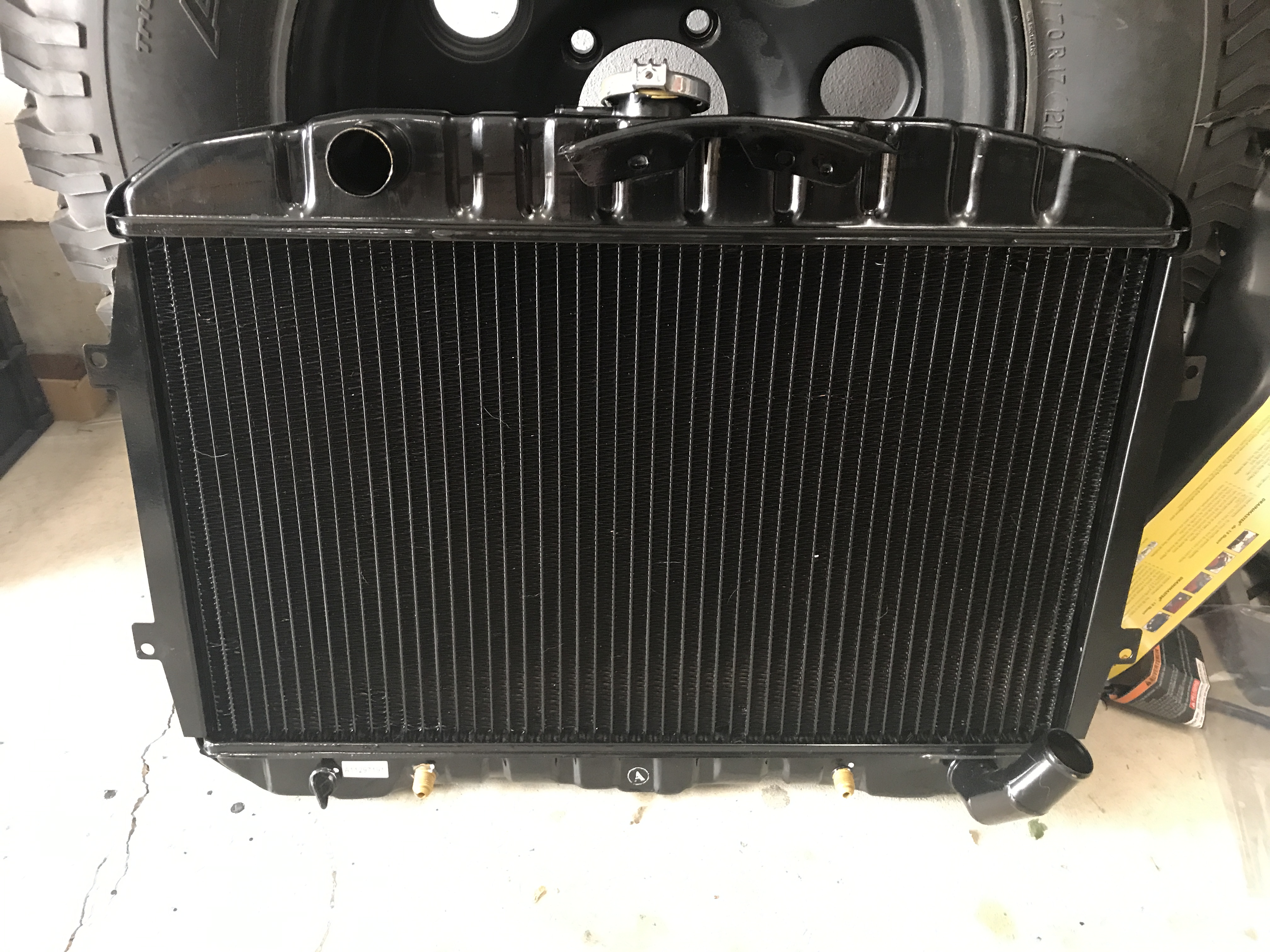

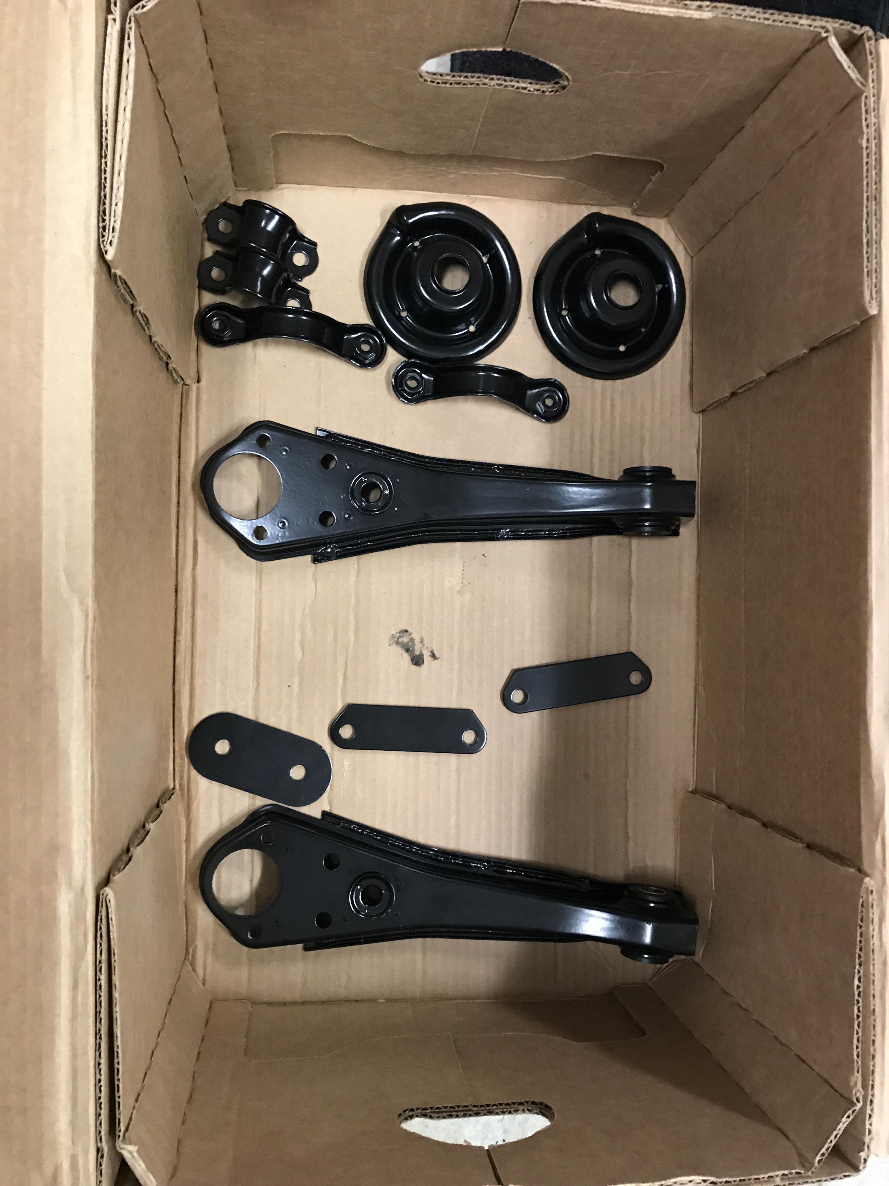

Got all but spindles done and back from powder.  I also had to get a new radiator, but I had my series 1 fan shroud welded onto it.  Hopefully getting all hardware back from zinc today.

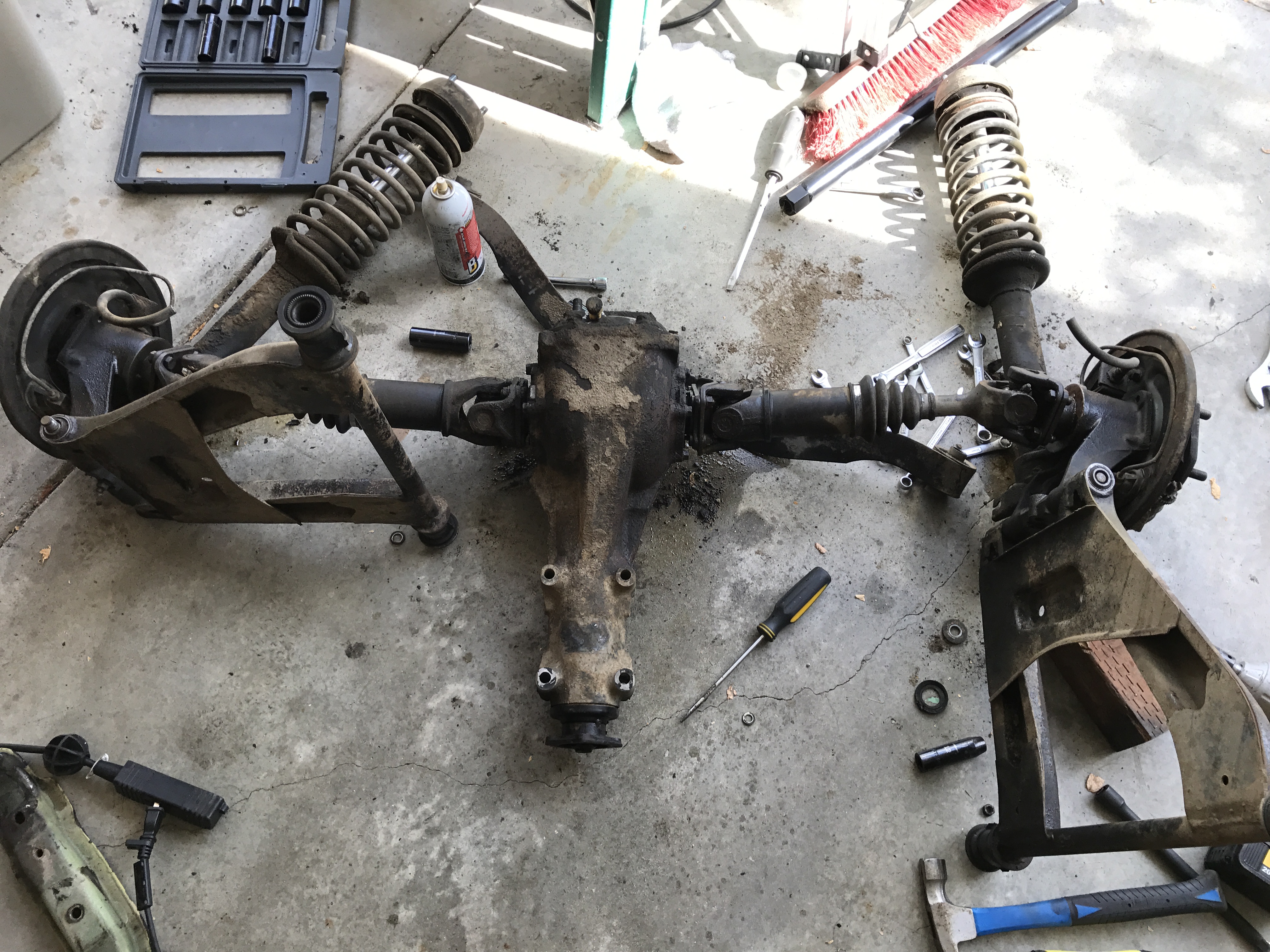

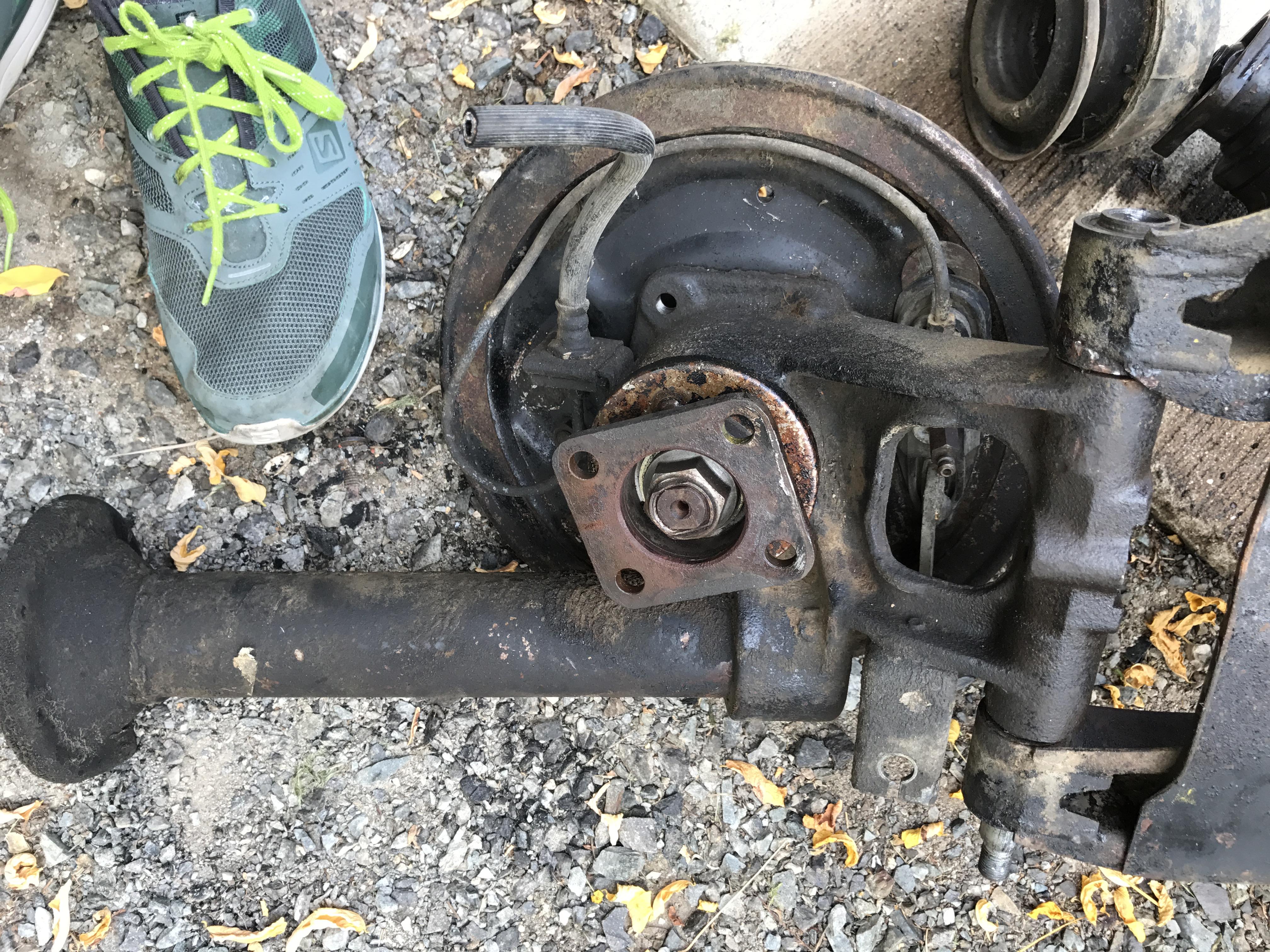

Next my focus was on the rear.  Same thoughts, pull apart, paint- powder and zinc.  Rear end was slightly harder to take apart.  But less grease!
I am also going to replace all u - joints and wheel bearings while its all apart.  Also poly bushings throughout.  Still waiting on a local shop to press all the bearings out.

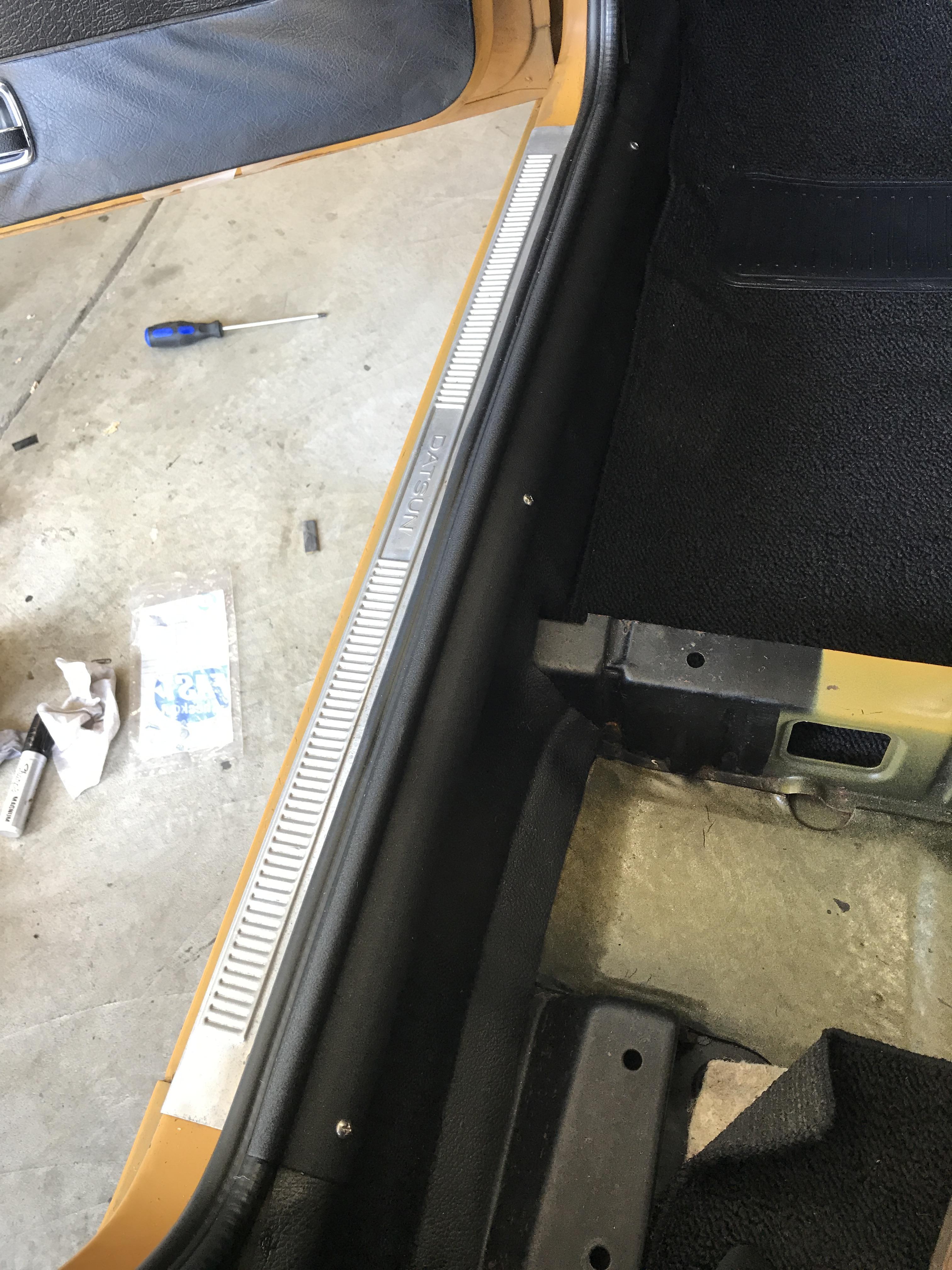

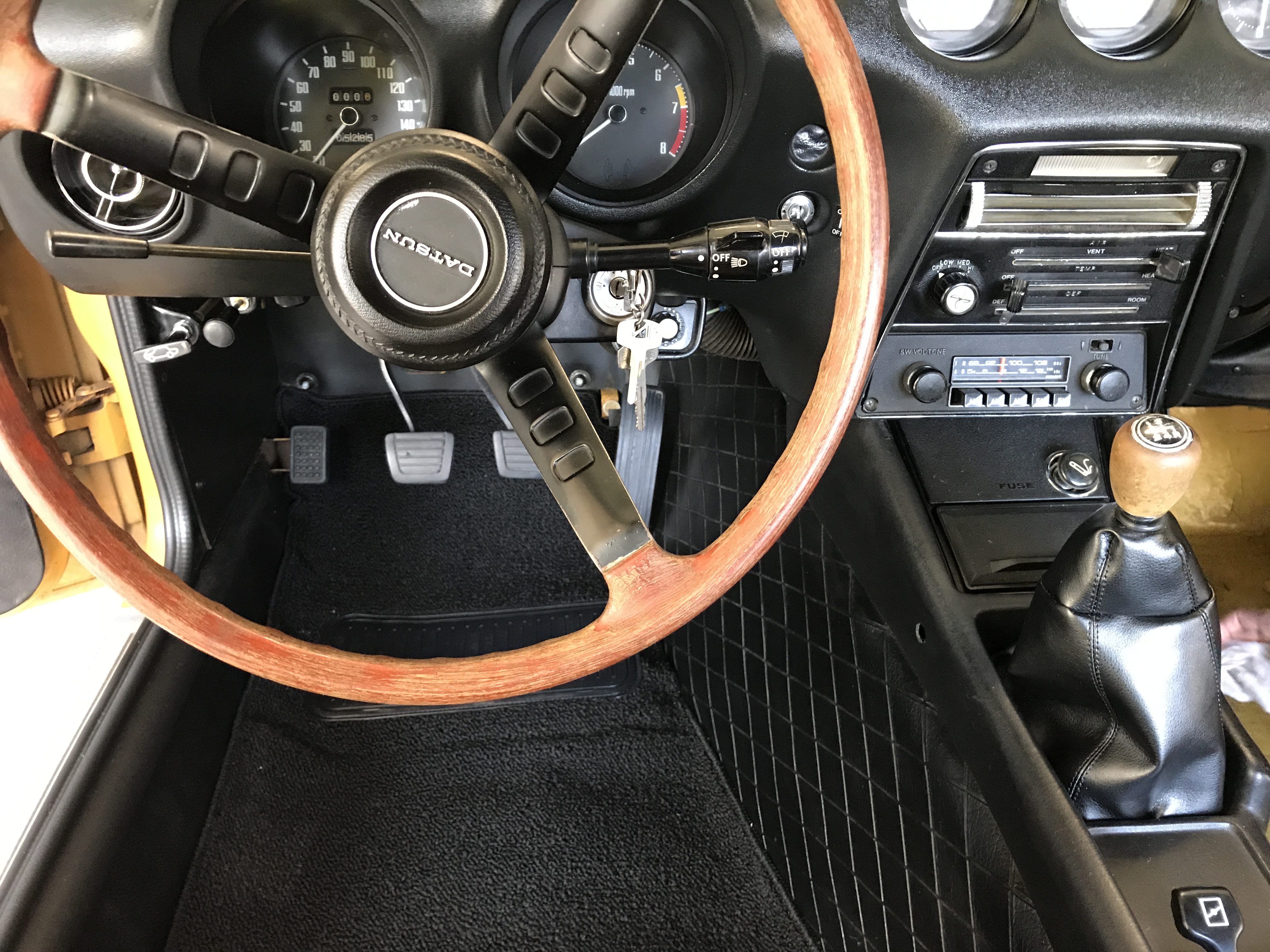

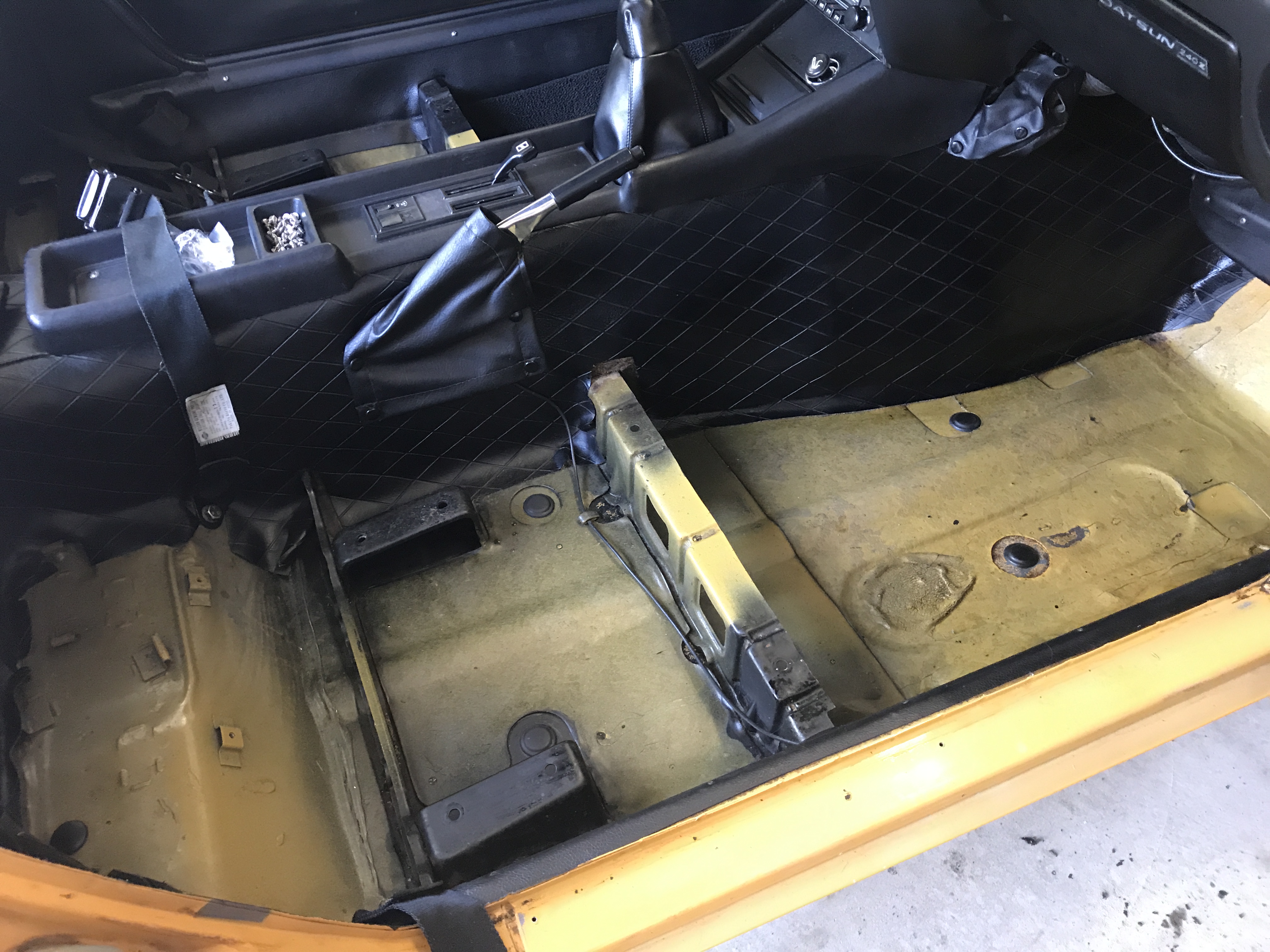

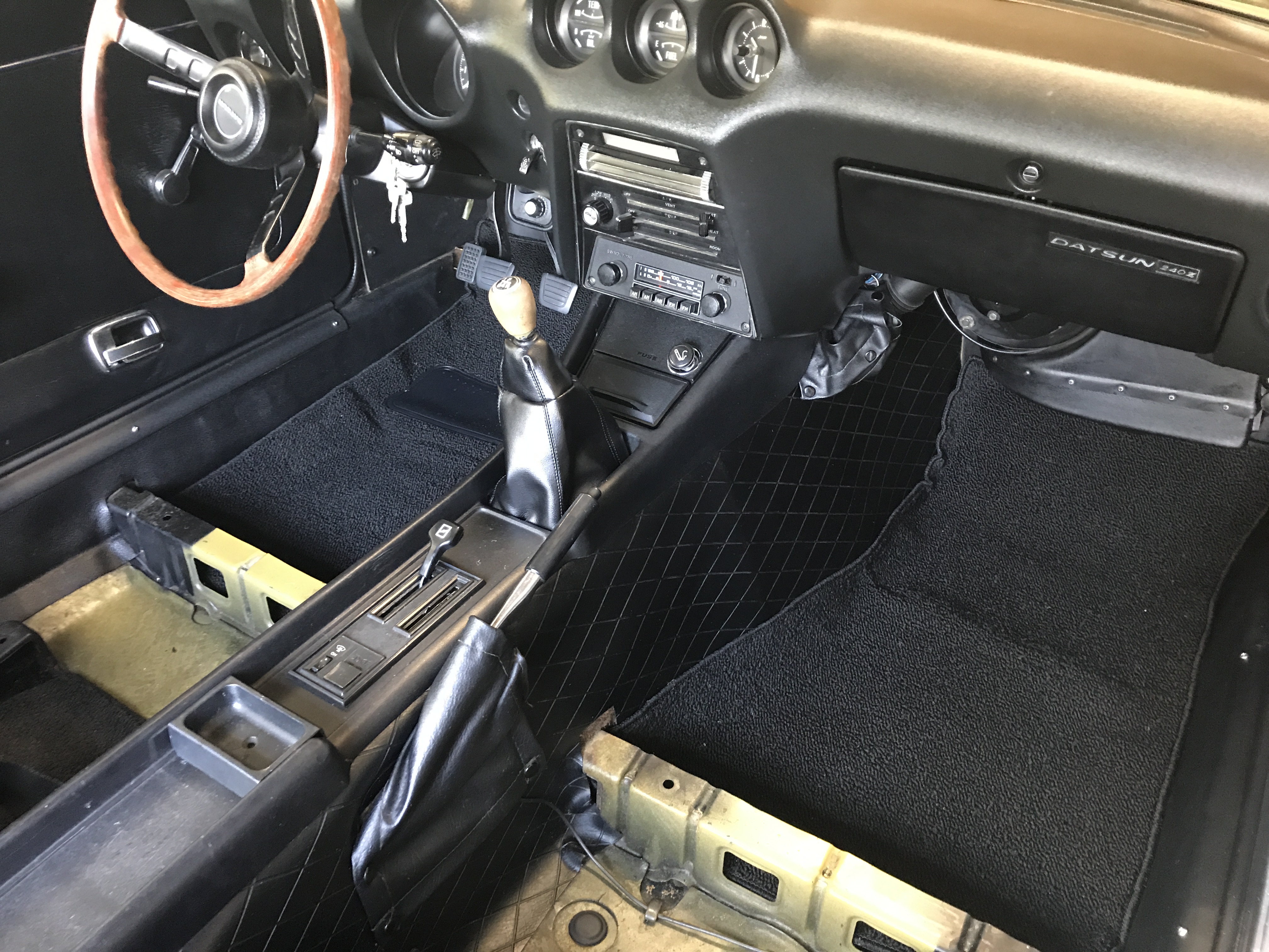

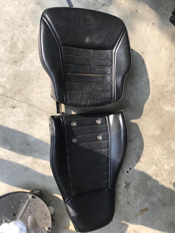

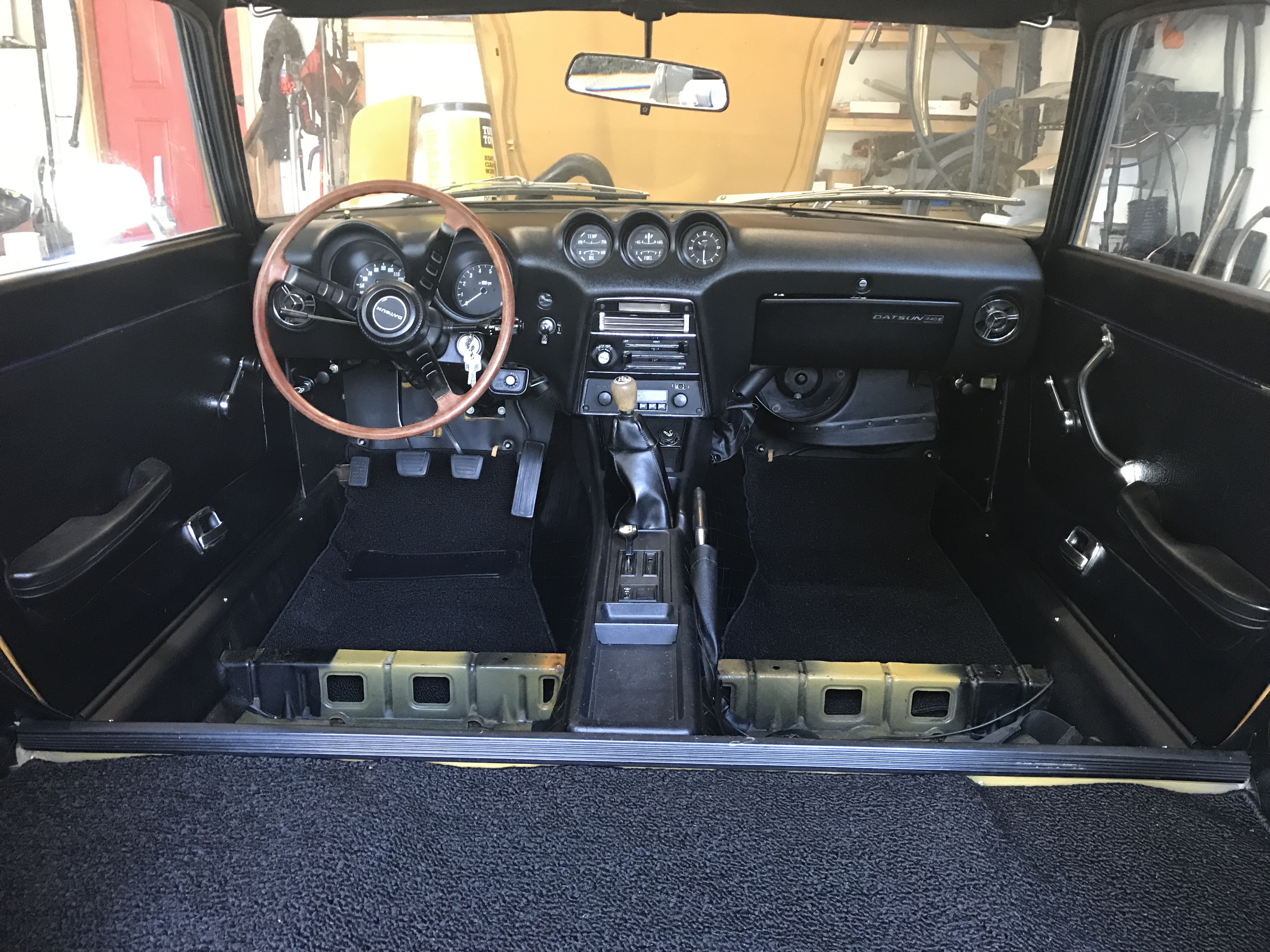

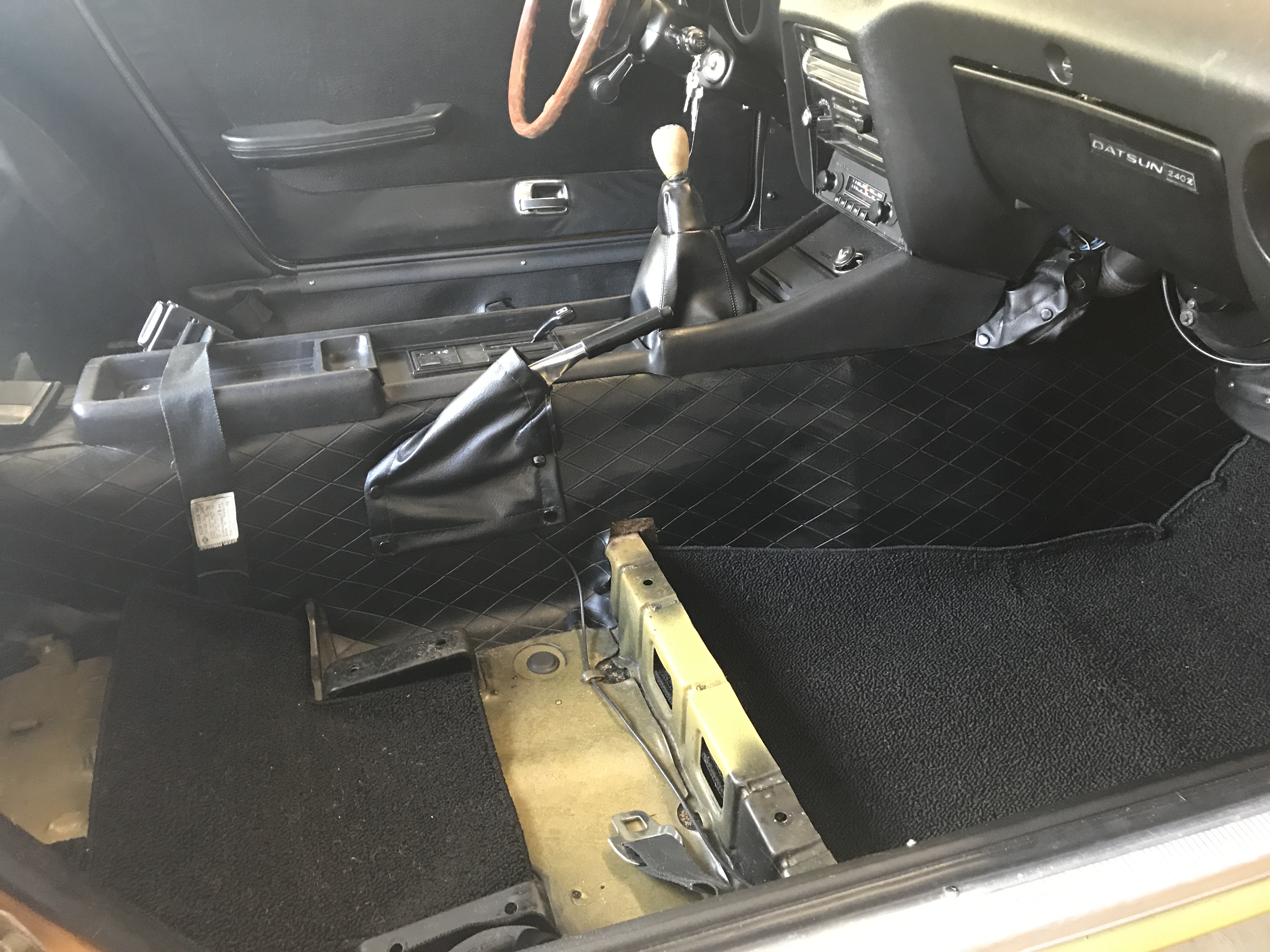

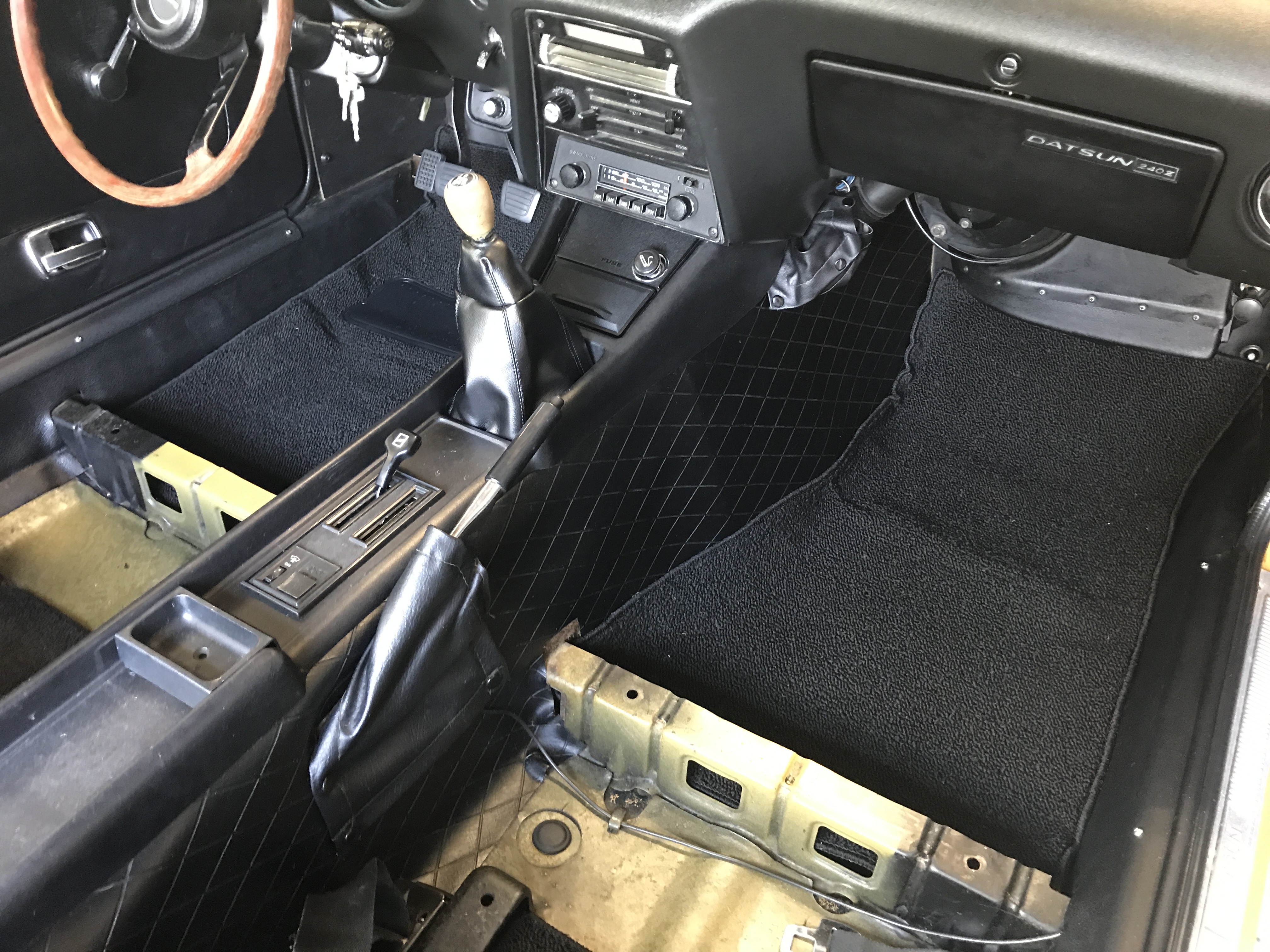

While I am waiting on zinc and bearings, I decided to work on the door gaskets and finish the interior.  I have (plus my wonderful girlfriend) about 10+ hours in adhesive removal/ detailing on the inside.  But very happy with everything but the carpet fitment.  Also the new door gaskets suck.  I ended up baking them for 3 hours on warm in my oven, they seem to be getting better day by day.

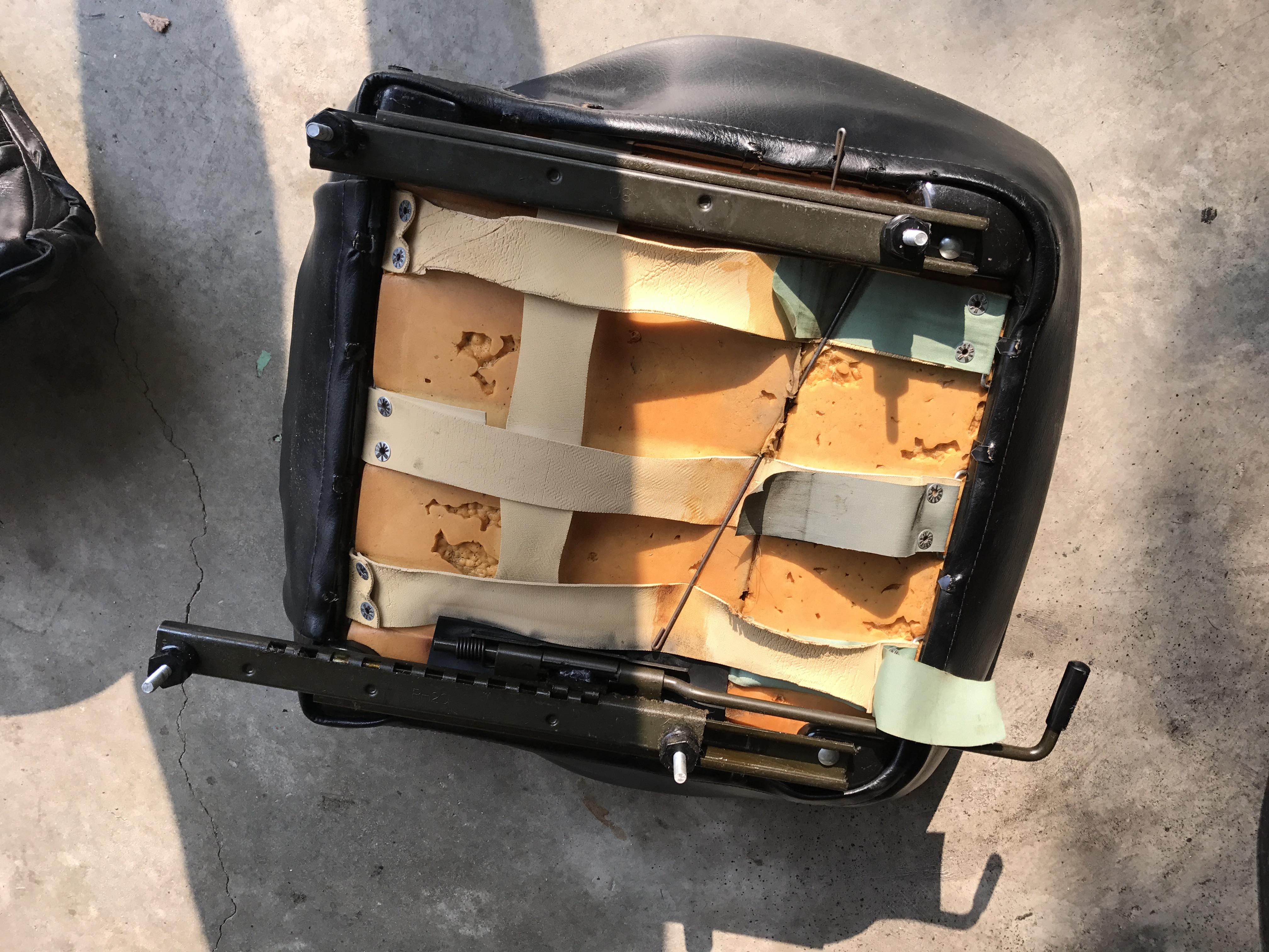

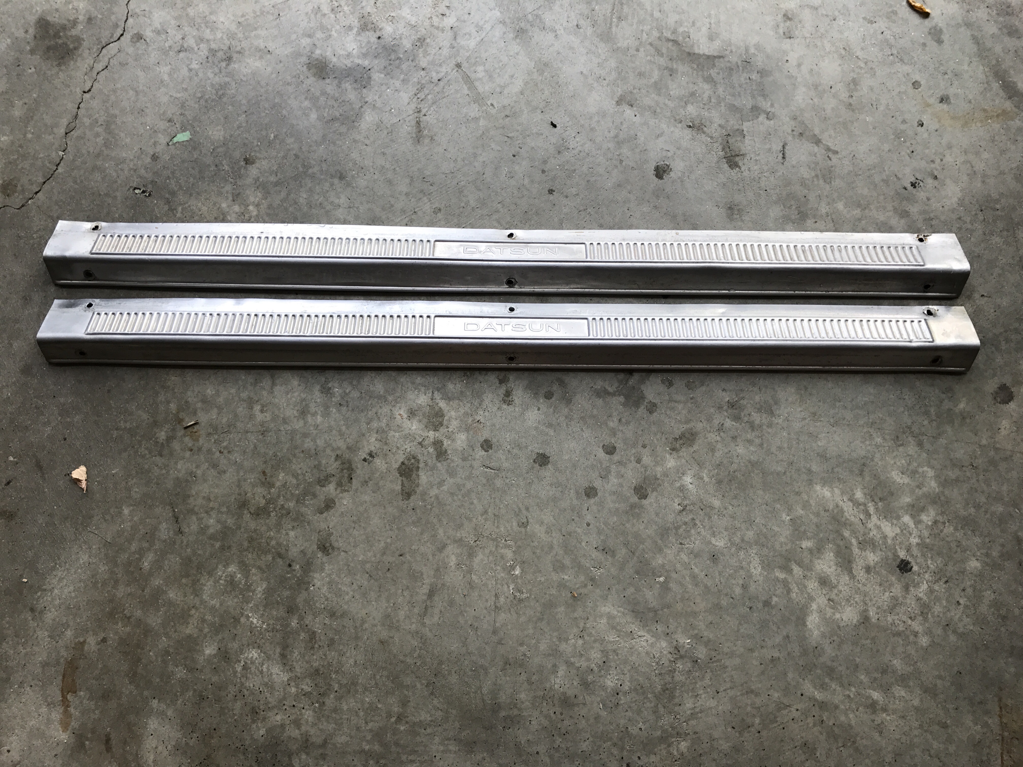

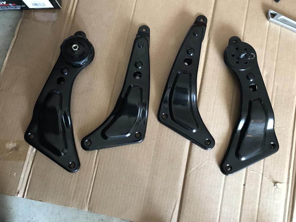

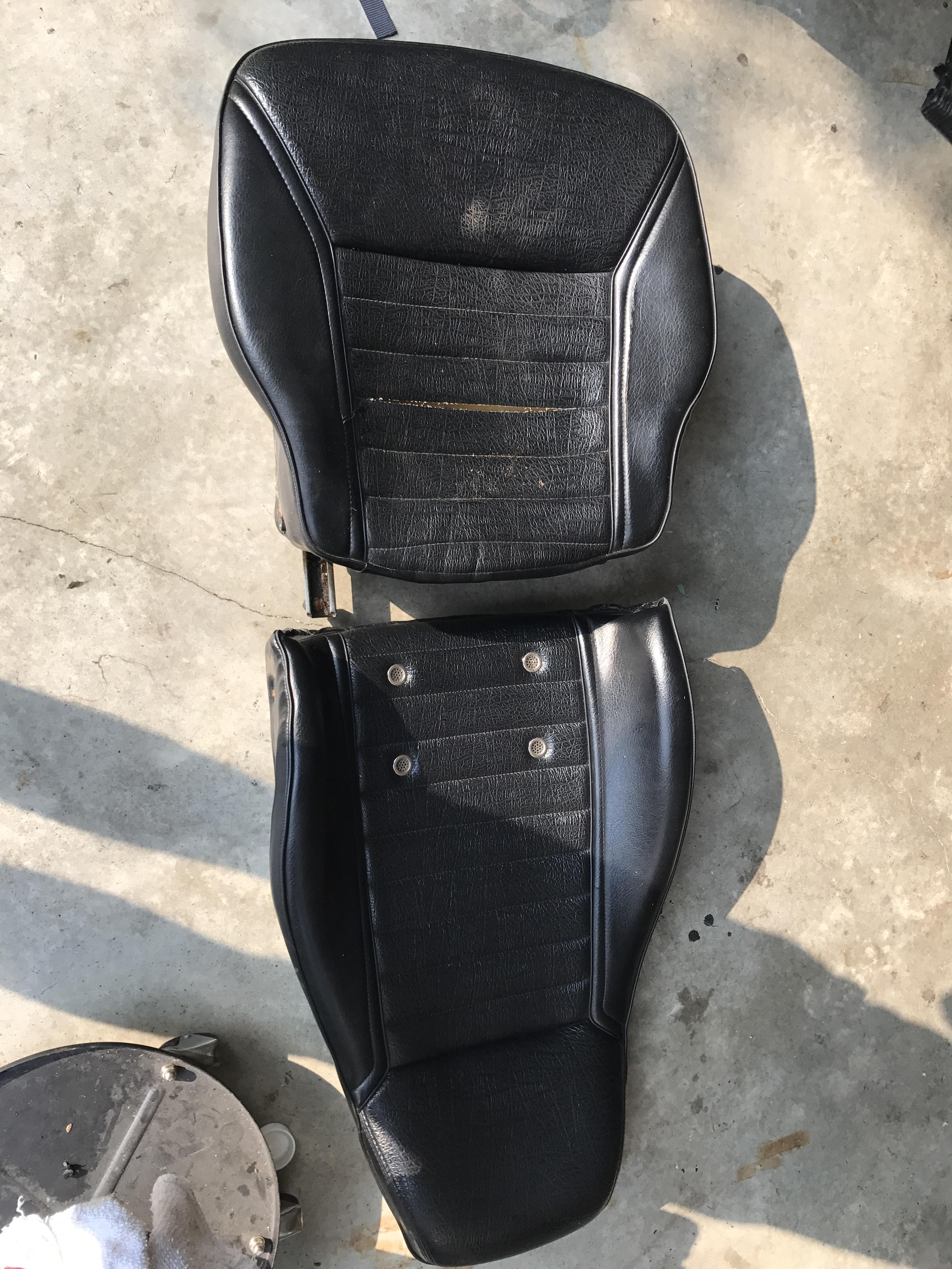

I ended up stripping paint off the outer sills (overspray), then I had to get new inner door sills, I had them wrinkle powder coated to sort of match the vinyl wrapped that comes stock on my year.  I am so happy with the level of rust on this z.  I also got a new shift boot.  I pulled the seats and the side hinges are powder coated now.  Which is always scary since the powder doesn't always work on moving parts, but a little lubrication and they work like butter.  I have new foam and skins waiting for the seats, hopefully have them back in by next week.

I made my first mistake on the z.  I didn't have a drain installed, so when I went to do my final acetone rinse before redkote on my tank.  I couldn't get it out and it messed up my pretty powder coating:(
So I am stripping the powder, welding on a drain to the top corner then re - coating it, then redkote without acetone rinse.

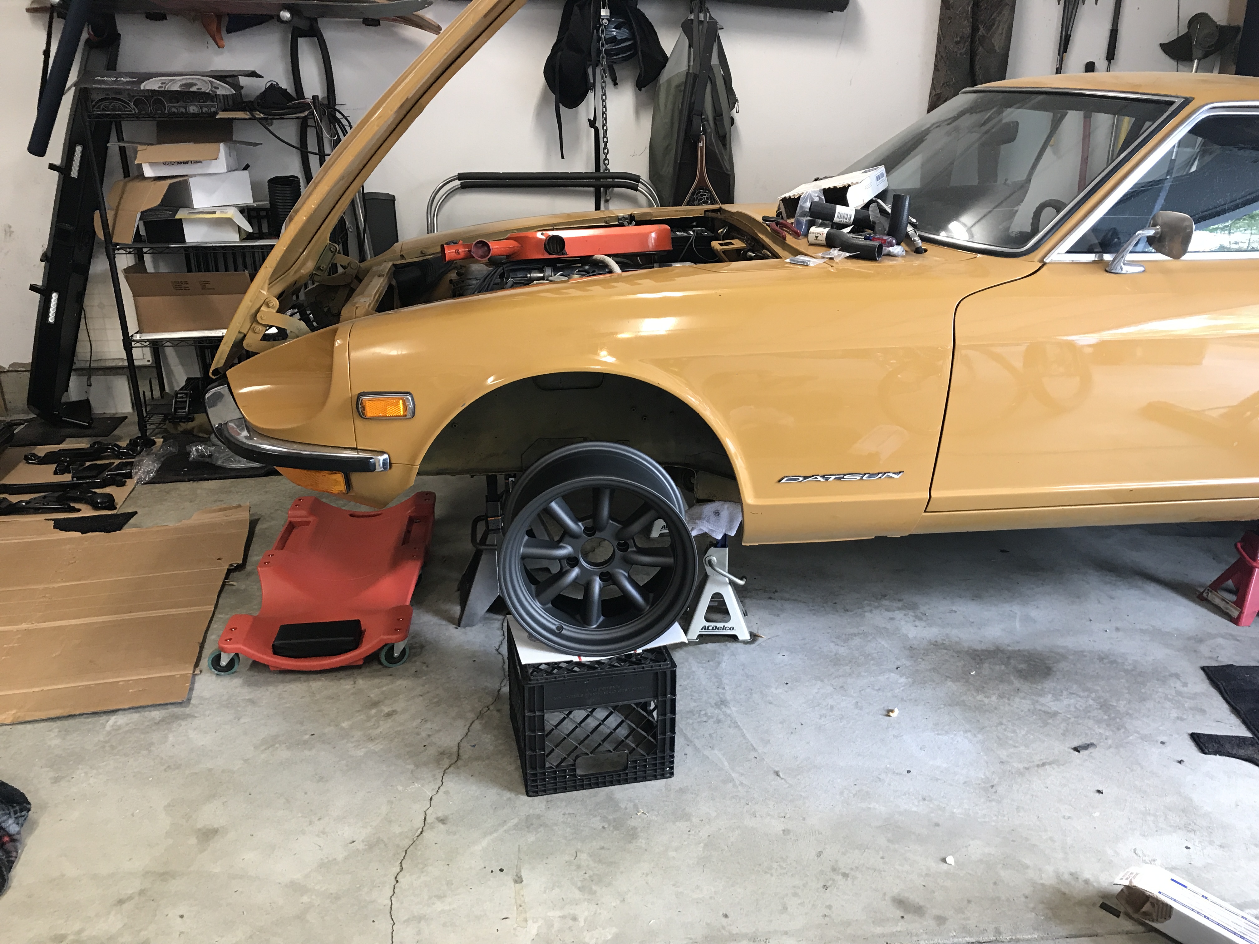

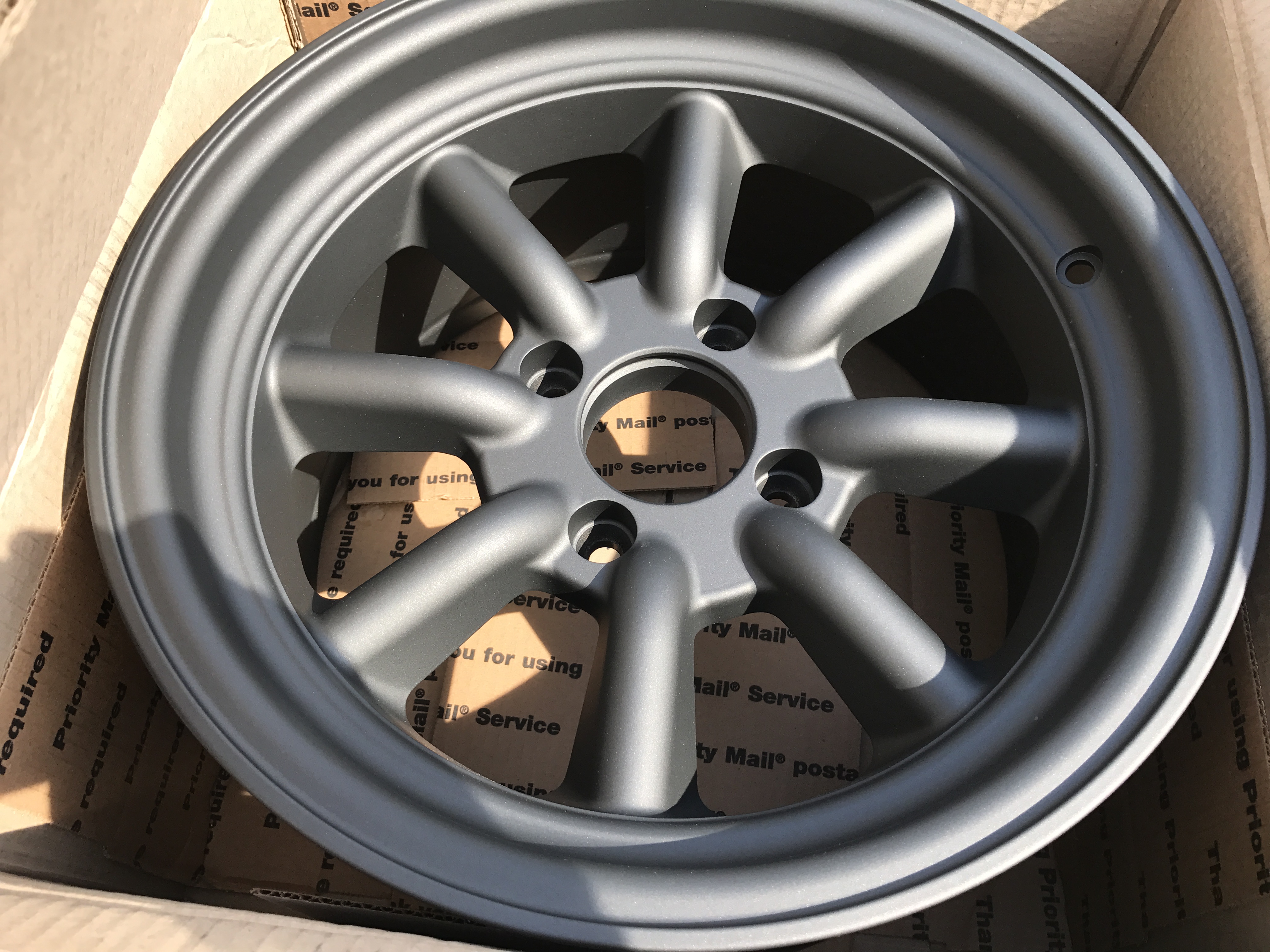

Wheels showed up.  Rota RKR, 15x8 with 0 offset.  Going 205/55 R15 on the tires.  I picked magnesium black, which is sort of a dark gun metal grey.  I think it will pop off the safari gold well!

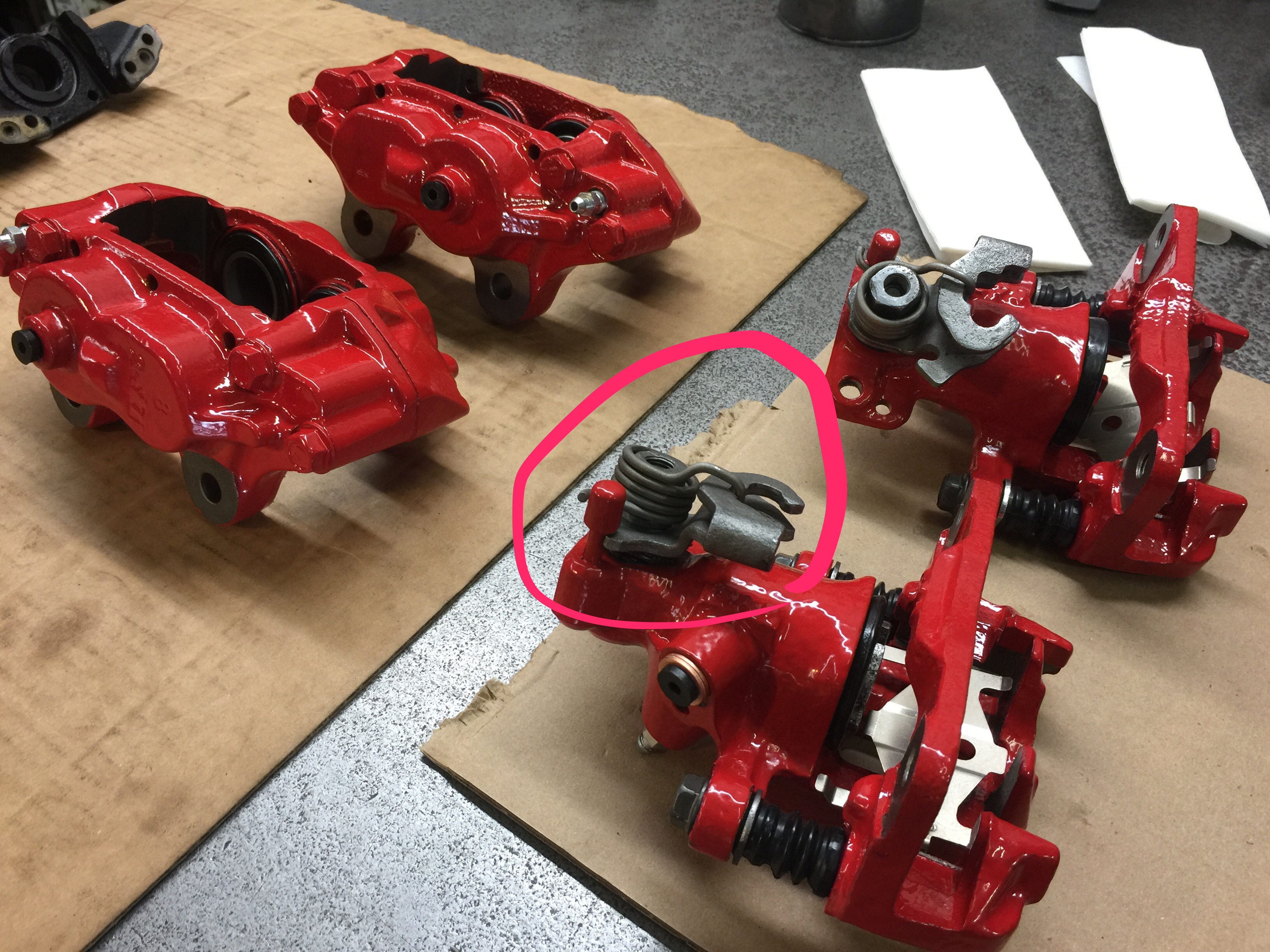

I also got my calipers back from powder. If anyone is interested in having calipers rebuilt and picking powdercoat colors.  Here is who did mine.  phoenixbrakeco@gmail.com http://www.phoenixcaliper.com/

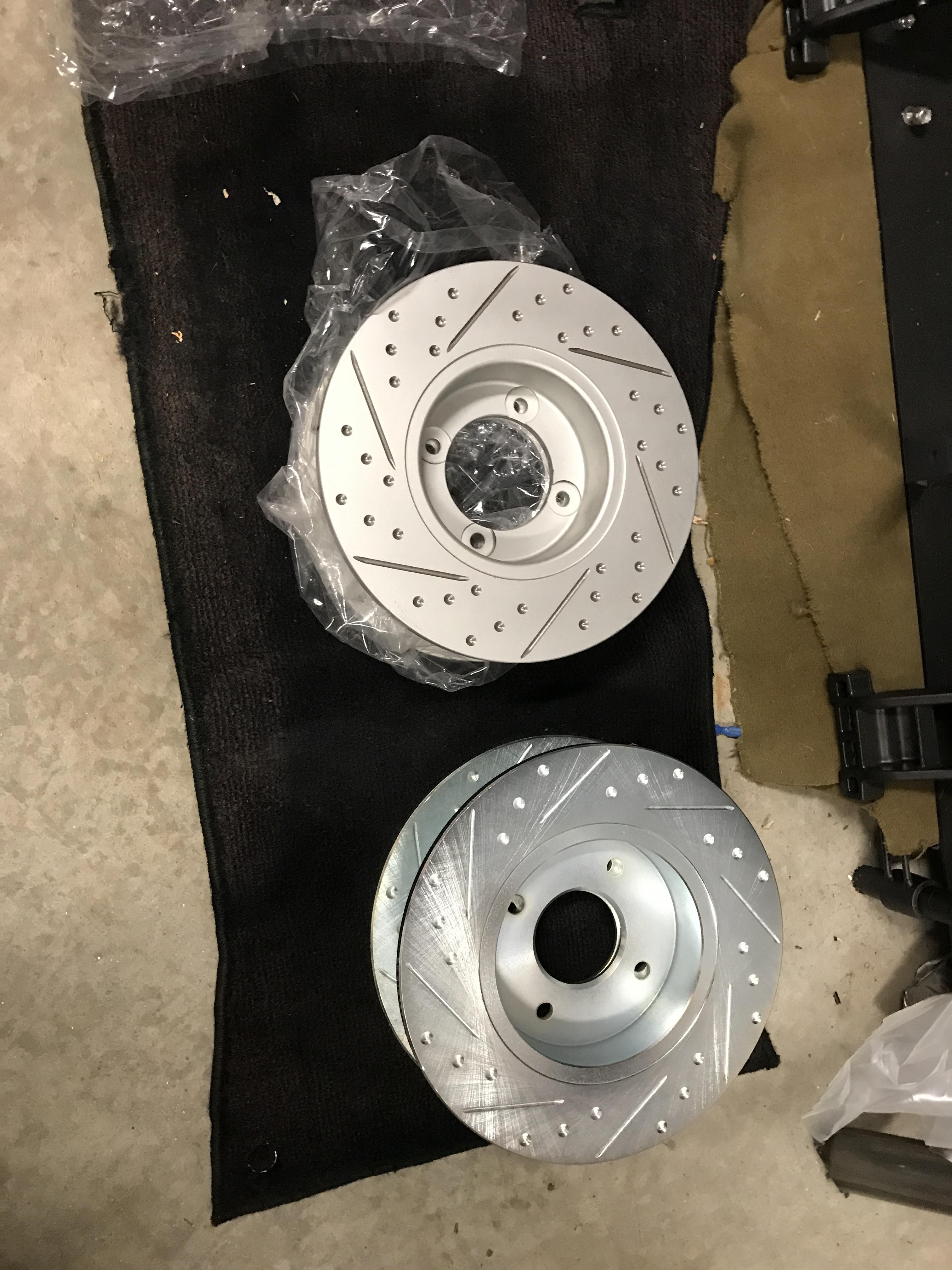

Going with 4 piston toyota fronts and maxima rears with zinc rotors from silvermine.

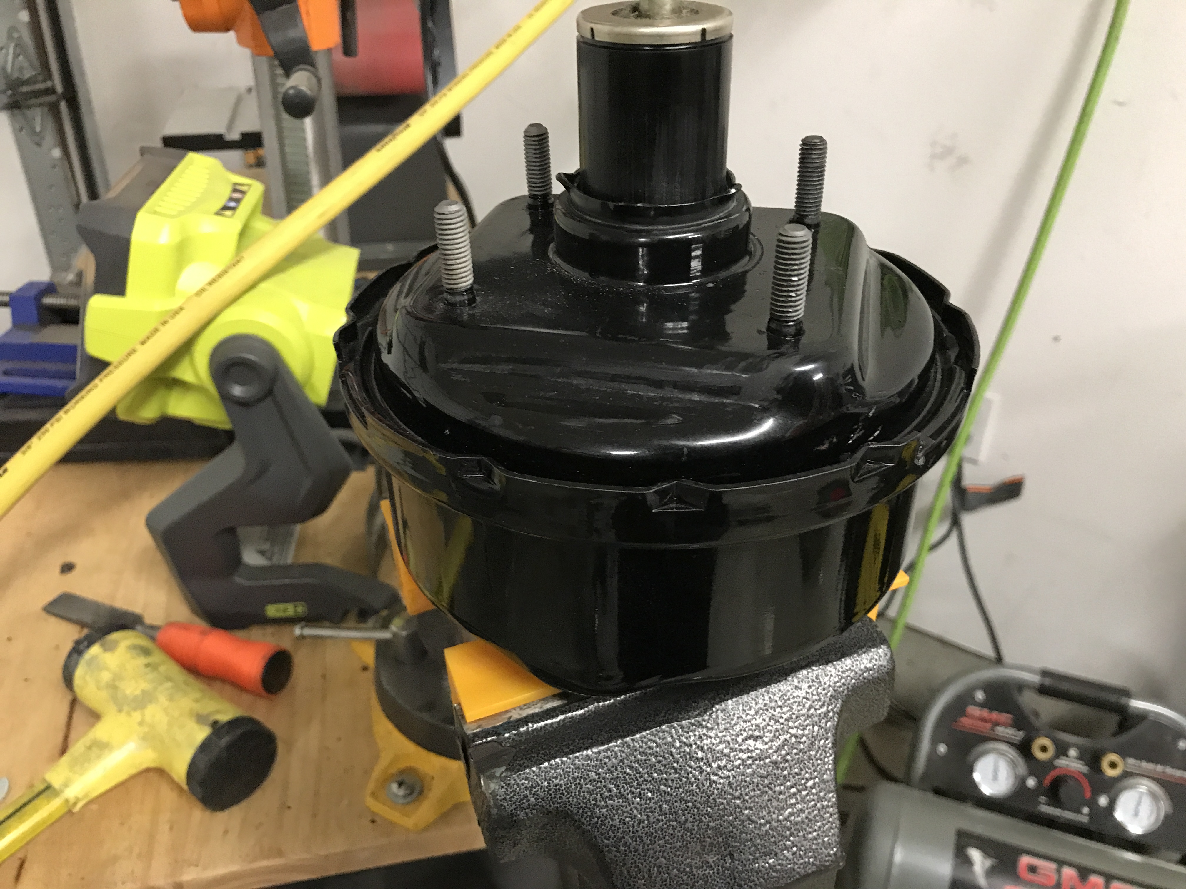

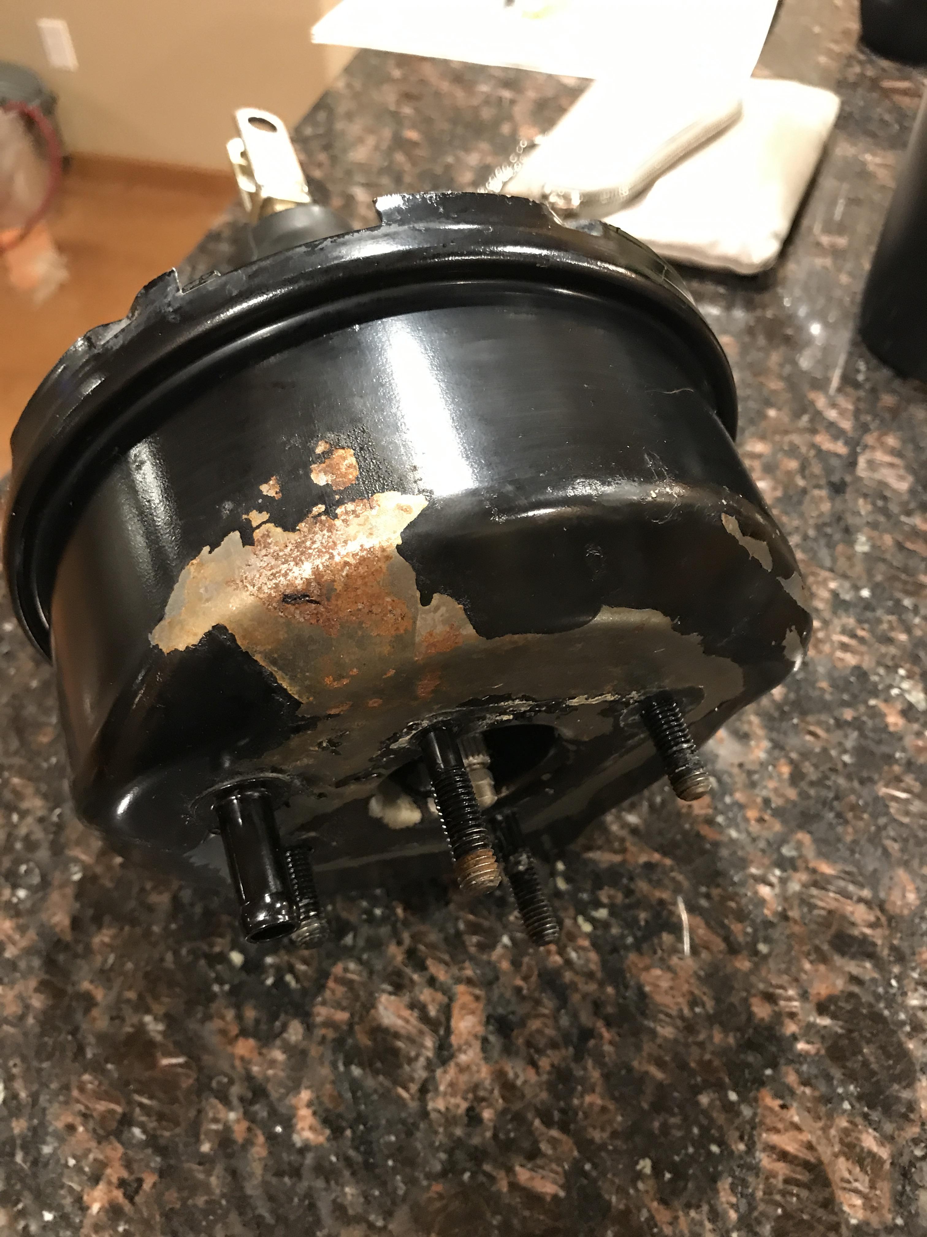

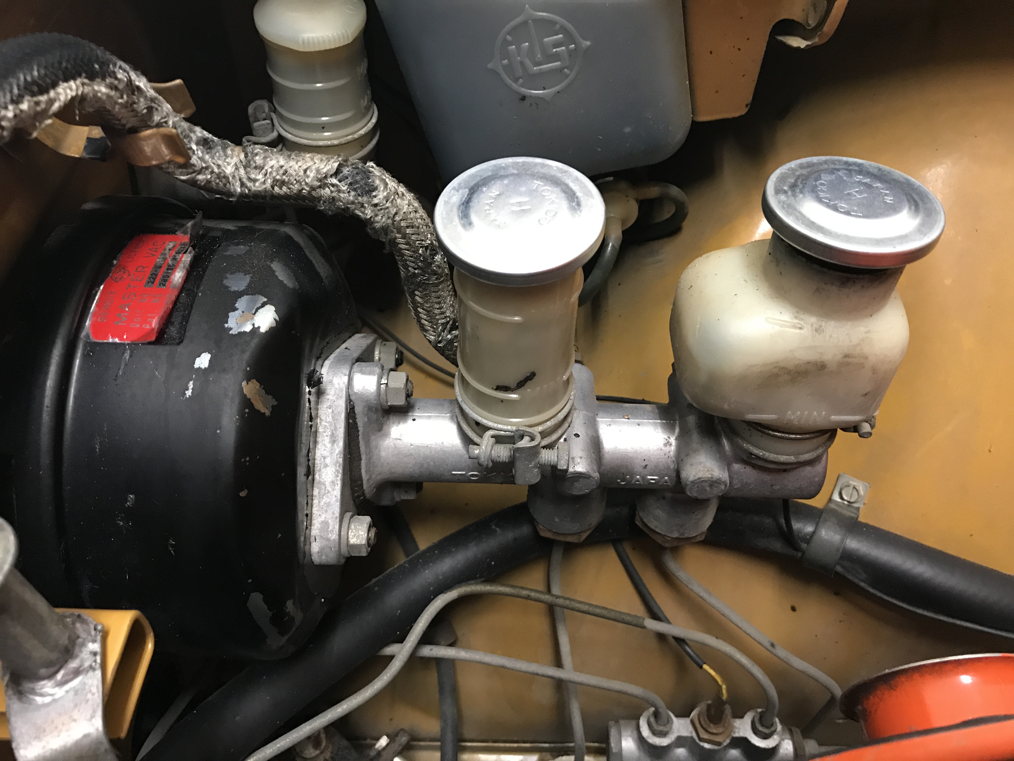

2nd major issue, well, not really my fault.  Painter didn't listen and didn't tape off the brake booster. So he got copper slad in it.  I then tried to clean the slad and dropped the rubber stopper inside the bowl, which is basically impossible to get out.  I then put duct tape on my finger to try and get it out, the duct tape fell off.  Then I tried to take it apart and now I have given up.   A fellow member suggested http://boosterdeweyexchange.com/ I called them and them and they don't list it, but they know datsun stuff well. The owner actually owns a 240z.  I should have it back next week, rebuilt and painted.  I am going with a upraded 15/16 master cylinder to help with the rear disk brakes and also it's a bigger.
