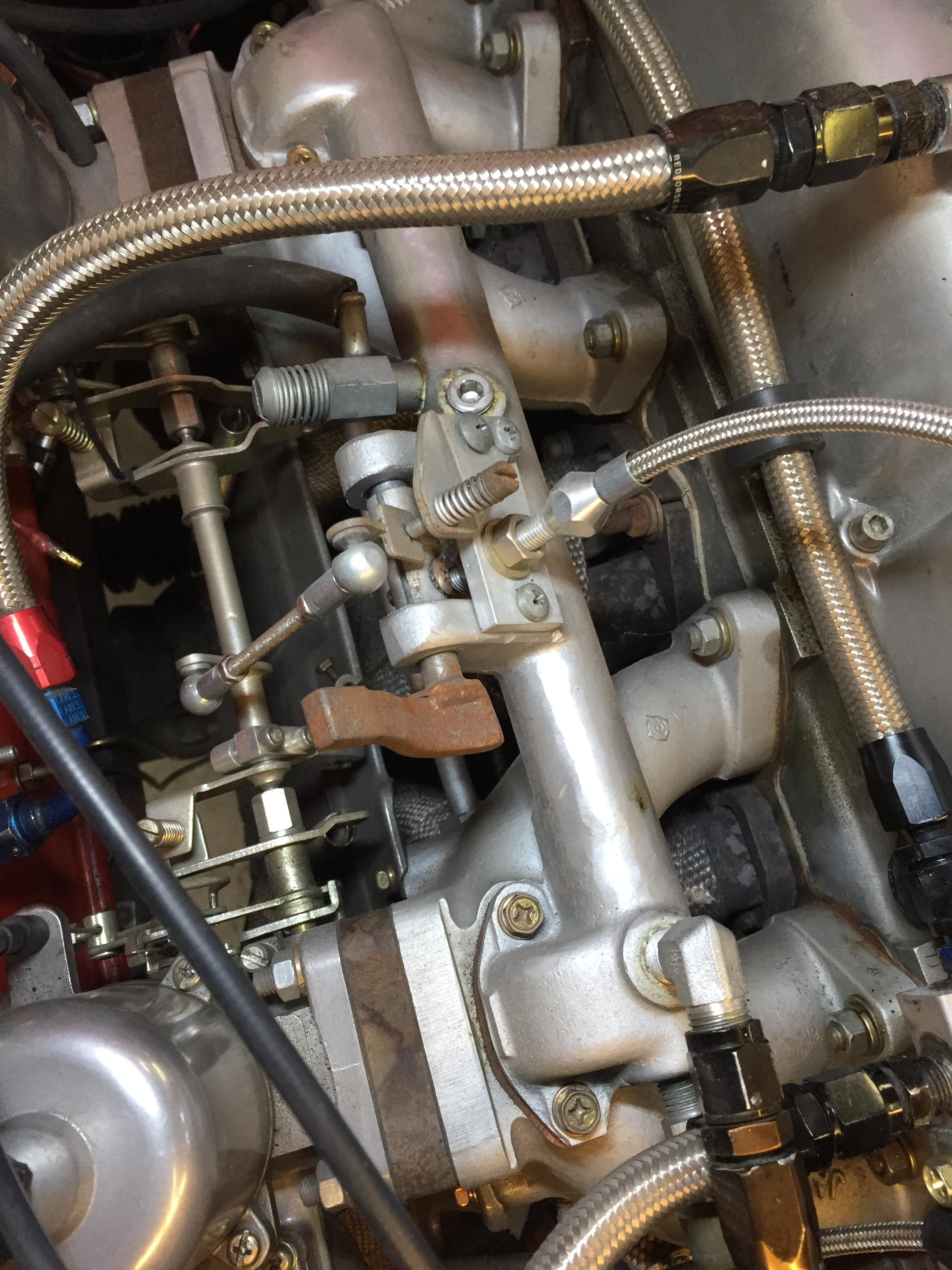

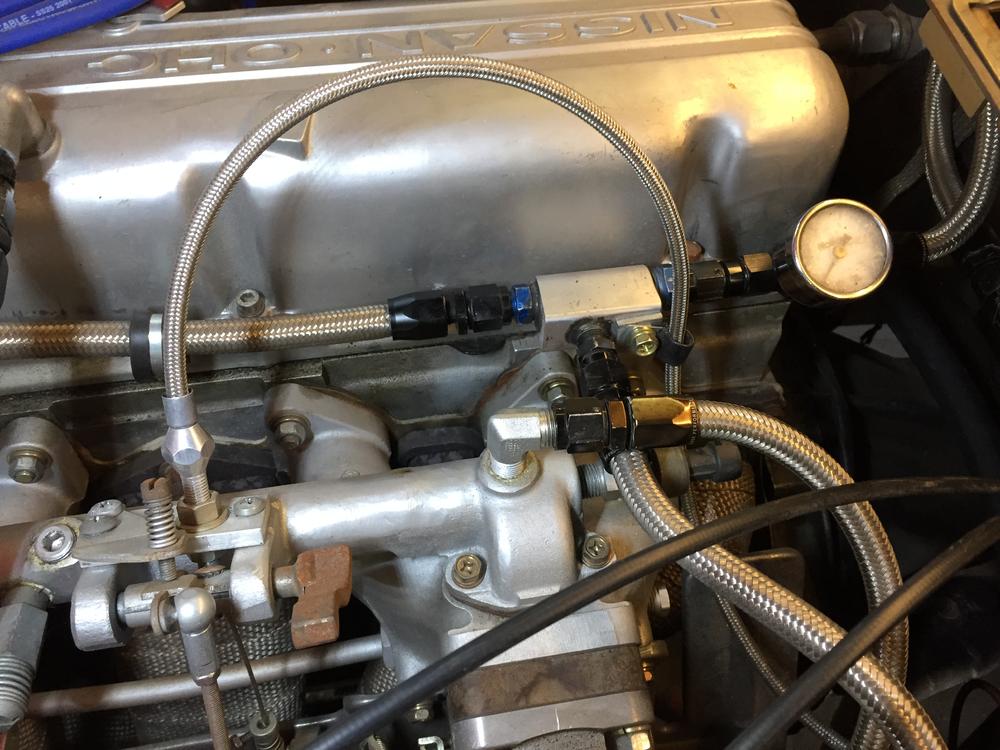

September 6, 20177 yr comment_529795 I do a pretty nifty throttle cable setup to the pedal. Both for SU's and triple whatever. I use the lokar kit as a starting point, and solder on a 8mm ball socket to bare cable end that snaps right on the pedal ball. Simple washer based system at the fire wall to fasten the cable sheath nut there. Trick here is the pedal ball is close to the fire wall when the pedal is at the "off" position, so you can't use the long ball cable end that comes with the Lokar kit, hence the short soldered on ball socket. The carb end has a couple of options depending on your setup. Needs a brackat somewhere to hold the cable sheath at that end. I don't have an handy pictures that show it all too clearly, but here is the SU based one, at least the SU end. It uses a commercially available arm that conveniently attaches/clamps to the carb center linkage rod. Not the best shot of here, the second pic shows the end of the rod clamp.  When the 44's were on her. Nothing shocking here at the carb end. I have to make up another set for a buddy, I'll try to take pics of the pedal end and the washer arrangement I make for the fire wall.  Edited September 6, 20177 yr by zKars Link to comment https://www.classiczcars.com/forums/topic/58472-throttle-cable-upgrade-all-the-way-to-the-pedal/#findComment-529795 Share on other sites More sharing options...
