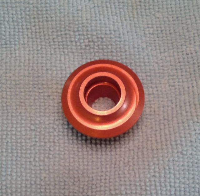

I'd say it safe to say that this engine hasn't ran in a long while . Interesting retainers !!
The retainer color looks like Racer Brown p/n LSA-312 to me but do not seem to be the same shape.

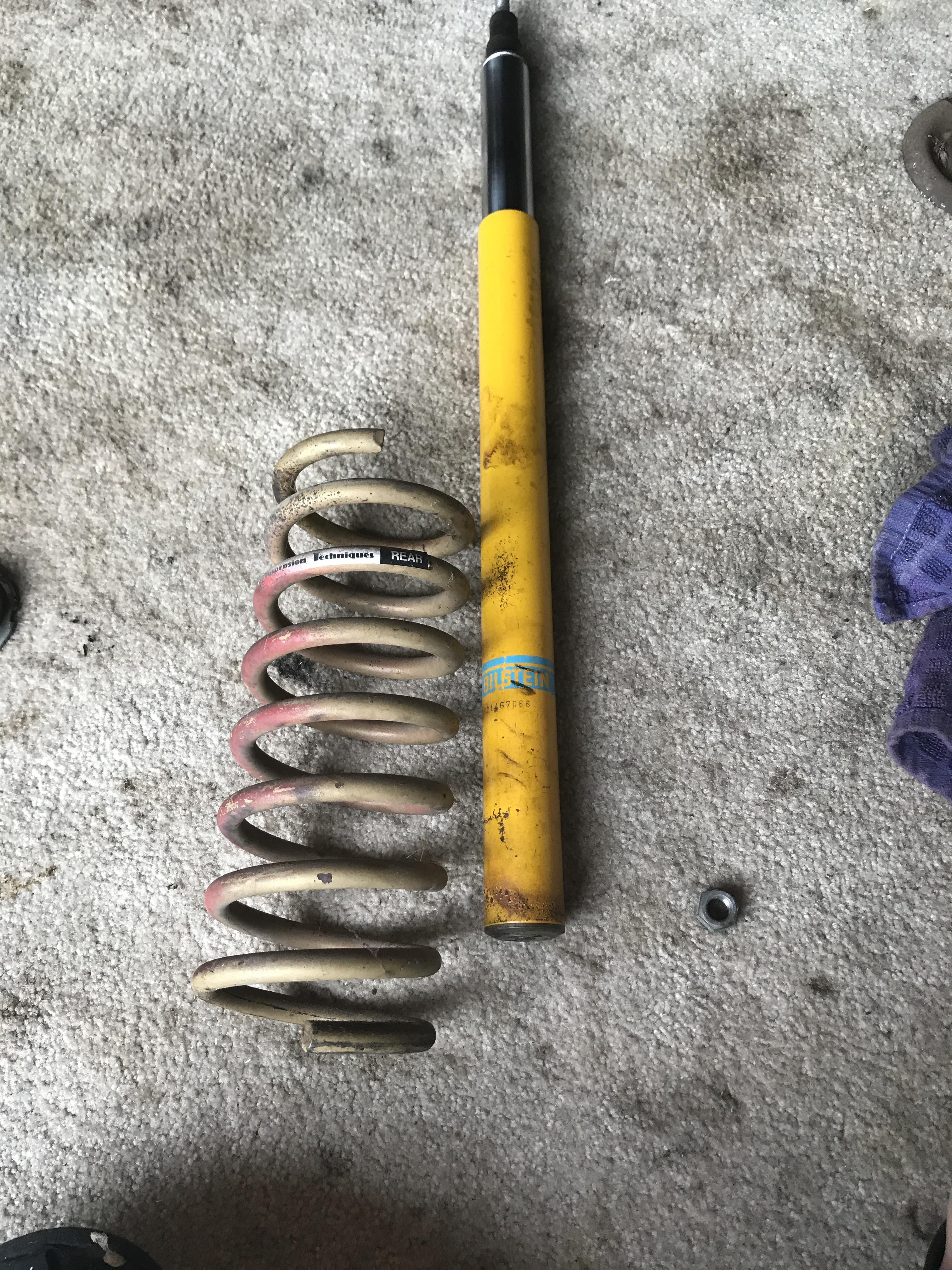

I didn’t take the front struts out to see if they were also Bilsteins . The springs on the back are ST ‘s , but front - not sure . They aren’t progressive so maybe a matching set to the back? The front shocks look like they have some kind of adjustment on the top- don’t know if that’s typical of Bilsteins.
The car is just a shell now with only suspension to keep it rolling

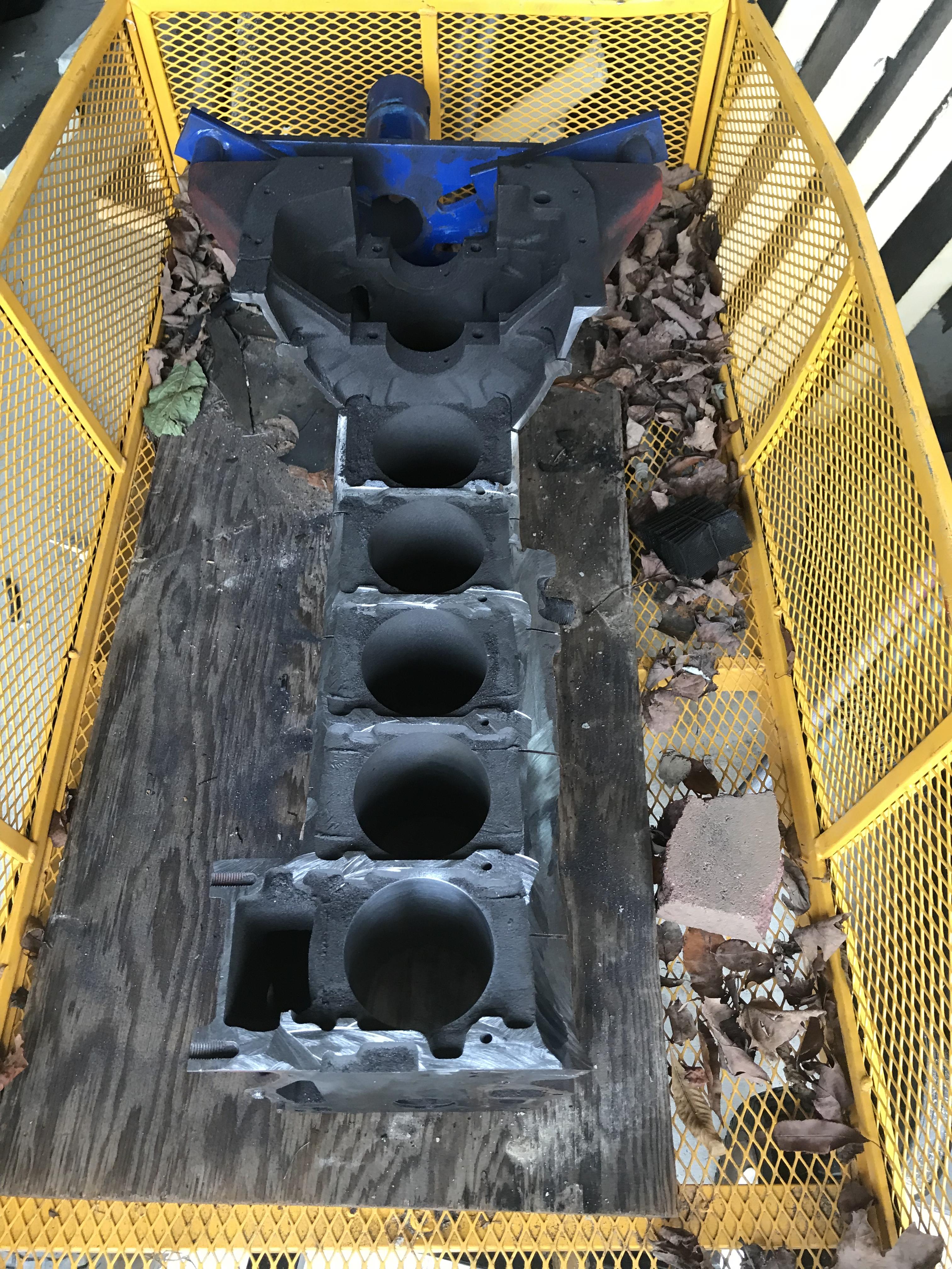

Not much left if the block - it’s now going to be a test jig for straightening warped heads . The pistons faired out better - my machinist checked them out and said they were good to go as far as still being round!
One of the pistons is stiff on the pin- but he showed me with just some warm water running over the pin it loosened up . Now the question is to use the pistons on what?
These are 86mm pistons so do I punch out another p30 block or .... ? Sures sounds fun but not sure I want to go that route . I have another p30 block sitting in front of me now and it’s tempting .

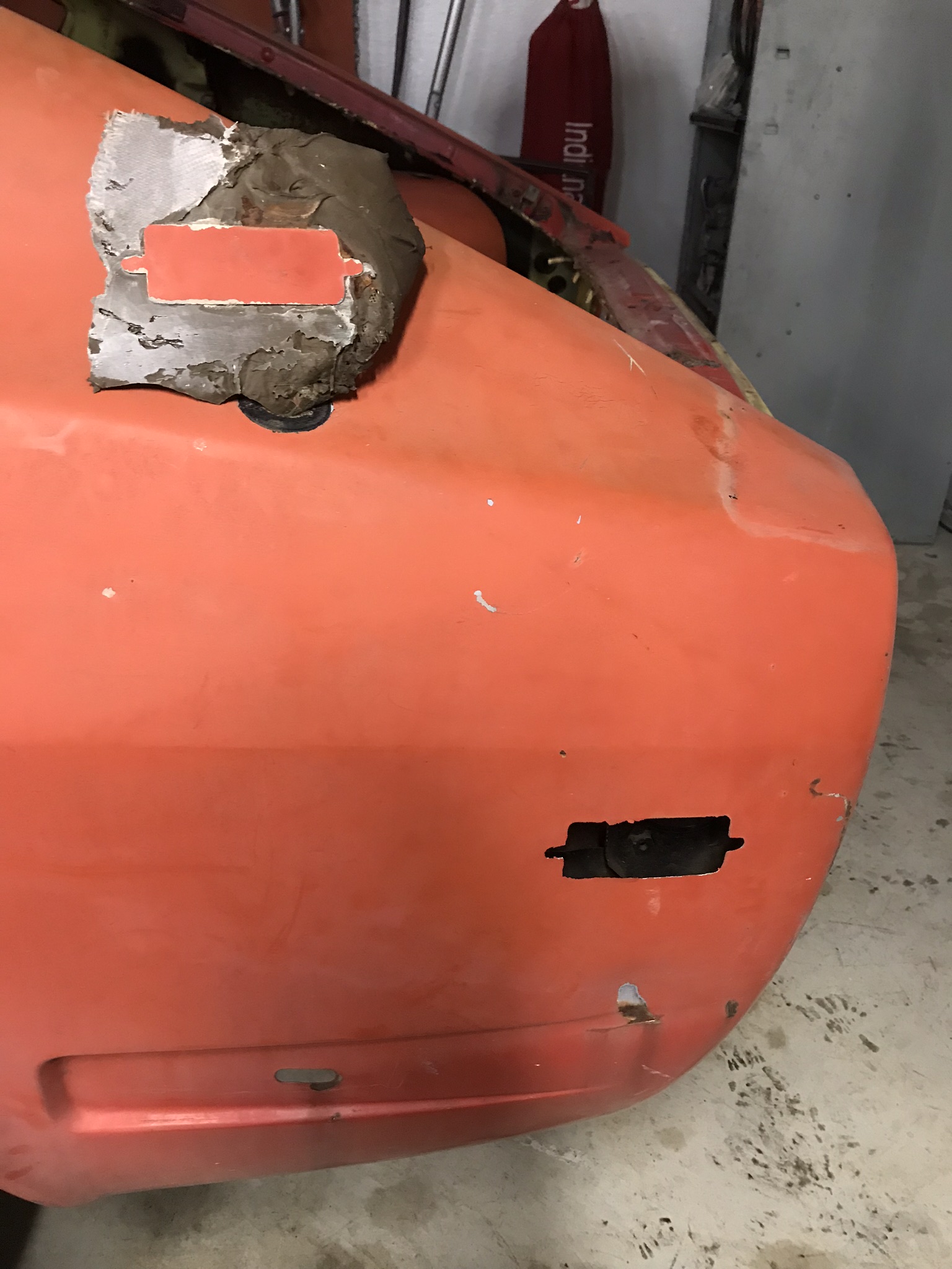

Did some serious bodywork today removing bad bodywork-lol. I got lucky that this guys fiberglass didn’t stick to anything much . I just tapped the marker area with a hammer and popped out the filler. It was a bad idea , badly executed, thank goodness ?
