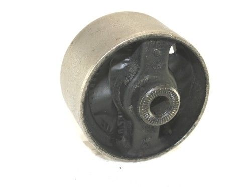

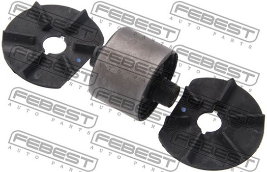

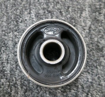

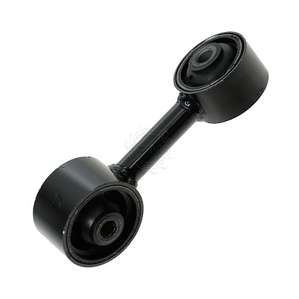

July 17, 20178 yr comment_525899 As a back burner project under @Patcon's guidance, I've been looking into this off and on for a while. The most promising bushings I've seen are things like engine torque strut mounts. The upper bar they strap on transverse mounted engines to keep the top of the engine from wretching around as the engine works. if you can't find something that has the exact same size as the original bushing, I muse that you could use something that is a little smaller than the stock bushing, and press it into a thin wall cylinder of appropriate ID and OD. Make the length of the cylinder long enough that there's extra material to swage over the mustache bar. Here's some pics of common cheap bushings that are probably large enough to consider. I bet with a caliper at a junkyard you ought to be able to turn up something .100 or so smaller than the original. There's got to be something out there. Little smaller OD than stock. Same or larger bolt through the middle. Length shouldn't matter so much. Here's some possible candidates. Next time I'm headed to the yard, I'm going to take my caliper: 73-79 Civic Camry: Excel: Paseo: Link to comment https://www.classiczcars.com/forums/topic/58037-mustache-bar-bushings/#findComment-525899 Share on other sites More sharing options...
