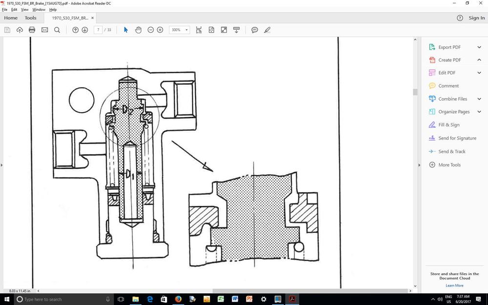

Thanks to "Grannyknot" (Chris) who replied to my May 24 post and offered me a clean, used proportioning valve, I now have brakes.  With neither my original valve nor the one I rebuilt passing fluid to the back brakes I was stuck.  I installed Granny's and it works.  Never before been so happy to see $$$DOT 5 brake fluid coming out of a bleeder.
Many thanks Chris.
Good to hear... but I'd still like to know how a proportioning valve turned into a no-flow valve.  The more I study the FSM (see below), the more it seems to me that the 'upper' seal is critical to the way the valve works.  It appears to have a unique cross-sectional shape.  Maybe you installed it upside down?
Edited by Namerow
FSM dwg added, with comments
That is good news, I am sure after helping you take it apart and look at all of the parts that the MSA kit came with two "lower" seals and no "upper" seal. But why we could not get it to work using a mix of the old and new parts I do not have a answer for. Glad you are done fighting with it.
