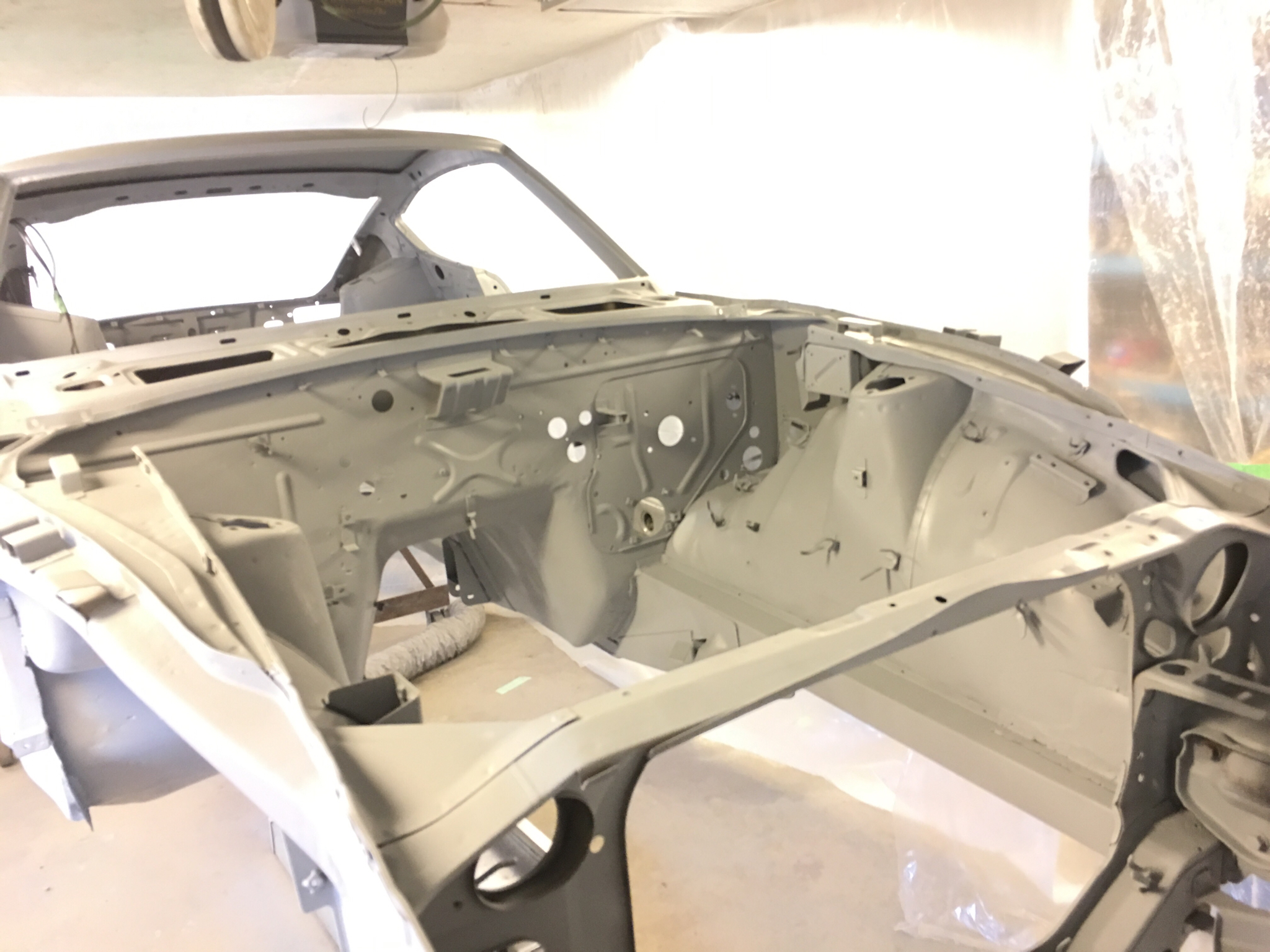

May 2, 20178 yr comment_519729 The inner fender intake opening is indeed still there, there is just no where for the hose to go to, as the FI intake goes through the round opening in the radiator support. The only way a 280Z could use this system is if there was no FI system on it... IMHO Notice the opening in the inner fender. Link to comment https://www.classiczcars.com/forums/topic/57603-fs-280z-fresh-air-duct-set/?&page=2#findComment-519729 Share on other sites More sharing options...

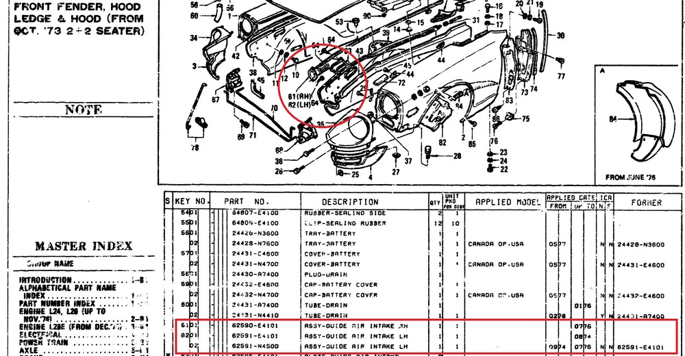

May 2, 20178 yr comment_519734 1 hour ago, jfa.series1 said: And maybe not. The parts came from a 11/74 build date 280Z which I think qualifies it as a '75 model. The P/N's and effective dates I supplied in post #3 came from carpartsmanual.com. If you can supply better P/N info, please do so. Nope. I stand on my assessment. Here are the Carpartsmanual part numbers. Here are the parts numbers for the parts as they appear on 240z body . 66 ASSY-GUIDE AIR INTAK 62590-E4101 1 67 ASSY-GUIDE AIR INTAK 62591-E4101 Here are the parts numbers as they appear in the 260z & 280z 2+2 body section. 61 ASSY-GUIDE AIR INTAK 62590-E4101 7607 1 62 ASSY-GUIDE AIR INTAK 62591-E4101 7408 1 62591-N4500 61 And 66 are for the right side of fresh air elbow which were standard in all ZCARs (coupe or 2+2) up until 7.76. 62 And 67 are for the left side which for the first number of 62 was up until 8.74. The second set of numbers in the second number of 62 has N45 in the part number which corresponds to Nissan internal identification for 2+2 vehicles. Having had a '76 280z there is no place to mount a left side fresh air elbow on a 280z as that is where the boot from the air cleaner to the air flow meter goes. This is true on all 280z's as they are all fuel injected. I have been pulling Datsun parts in salvage yards as a profession for close to a decade now and another decade before that for fun. It is in my best interest to nail parts applications down to the best of my ability because Nissan (Datsun) had alot of idiosyncrasies in the parts labelling and I do not like creating problems through misinformation. Edited May 2, 20178 yr by dhp123166 Link to comment https://www.classiczcars.com/forums/topic/57603-fs-280z-fresh-air-duct-set/?&page=2#findComment-519734 Share on other sites More sharing options...
May 2, 20178 yr comment_519747 Just to add to what @dhp123166 has summarized here are screen captures from the 1979 Nissan parts micro fiche. I did notice that the 62591-N4500 part number is shown applying to both the 2 seater and 2+2 from 09/74 to 07/76 Link to comment https://www.classiczcars.com/forums/topic/57603-fs-280z-fresh-air-duct-set/?&page=2#findComment-519747 Share on other sites More sharing options...
