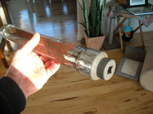

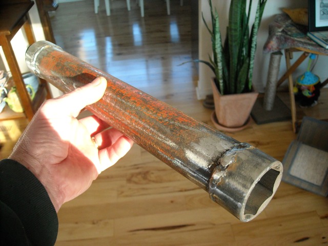

9 hours ago, Careless said:
I have spare sockets now, so my next version will be a socket "tube" that is long enough to go passed the threaded strut with a square drive welded onto the other end so I can use a 1/2" impact gun, but the wrench has been good on the last 4 or 5 sets I've done. No heat required.
Like this, cut the socket in half and weld a pipe in between, I had to rig this one up to remove and tighten the main nut on a Datsun 5spd transmission
I like that tool you made grannyknot!  Goes to show, when you a very specific job to do, you need a specific tool.  On the topic of "force" needed to get the gland nuts off, I left my rear strut tube attached to the car, disconnected the parking brake cable and half shaft, and was able to swing everything down and away to work on it.  My experience was the same using the socket I modified and a pipe wrench as it only took a one good push and it broke loose.  I know from previous experience that some heat and 50/50 mix of ATF and acetone might be needed to help break the gland nut loose.  However, for anyone using channel locks or pipe wrenches, once the glad nut starts to deform or shear, just stop and walk away.  The picture of carnage above and on the previous page can certainly be avoided.

Granny - are those impacts? That was my idea as they're softer. I was going to weld two pipes to the socket for leverage.
The issue really is holding the strut in position. I used two 4x4s lag bolted together with holes drilled for the 4 lugs to sit in and then clamped the whole thing to my workbench.
Actually it was the cheapest socket I could find, $25 I think, the alternative was a very expensive crows foot wrench and since it was for a transmission the tightening torque was important, now take the 5" of the crows foot wrench and put that on the end of a calibrated torque wrench and you end up with math problem that I couldn't figure out, so, I built the cave man socket. It's a good weapon too.
