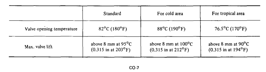

It's been so many years since I last changed my thermostat, I have no idea what the temperature rating is.  What temp range thermostat was installed in the factory?  Were there alternates depending on what part of world the Z would be shipped to?
Since the purpose of the thermostat is to make the engine run most efficiently and reduce wear on parts, is it bad to use a different temperature rating than what the engineers felt was best?  Enough questions for one day, but I look forward to any answers.

There's a chart.  The 160 must be like the Death Valley special recommendation.  I assume that Standard came from the factory.  180 is pretty common across manufacturers, probably because they all burn the same fuel, I'd guess.  But fuel has changed since the 70's so maybe the original recommendations don't hold anymore.

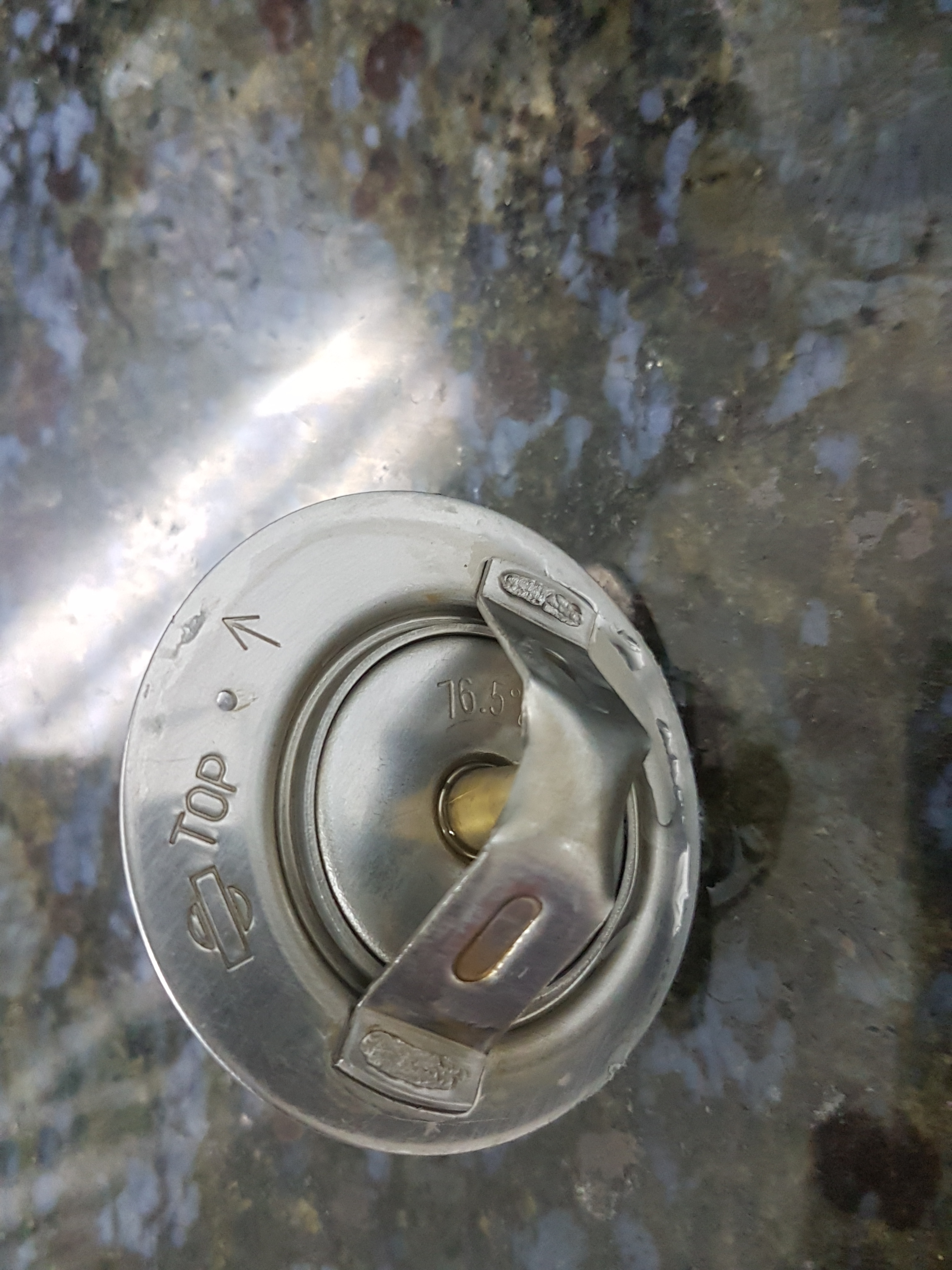

So you currently have a Brand new Nissan 76.5 c ( 170F ) thermostat in the car. That should be good enough for 33C weather easily. I've run my Z in 38C temps in traffic with the AC on and with a 180F temp stat. Car never has cooling issues now,  but that is ONLY after I had the 3 core Rad boiled out and everything in tip top shape.
Is the rad stock? You may want to consider upgrading to a heavy duty aluminum core rad is your old rad is a stocker. MSA and other sell them at reasonable prices. Don't buy the cheapest one. Get something decent and not made in China. Not much point boiling out a stock Rad in your climate.  My situation was different, as rad had a custom triple core already installed. It just needed cleaning.

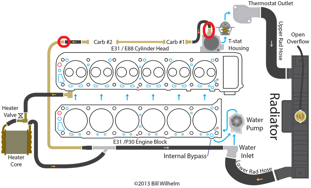

I tested the car yesterday. Race it for 15 mins, came back and open the lid! there is a small leak on the housing. I dont want to tighten the bolts anymore as i might break then. Should i open the housing and drop some high temp rtv silicone or could the gasket be defective. Its just a small wáter leak.
Another thing i am noticing is that since i removed the inline manifold thermostat and plugged the system as shown, the car takes more time to warm up. is this normal? any problema on leaving the choke on for more than 1 mins and driving with the choke open until it reaches 1/2 at the temp gauge?

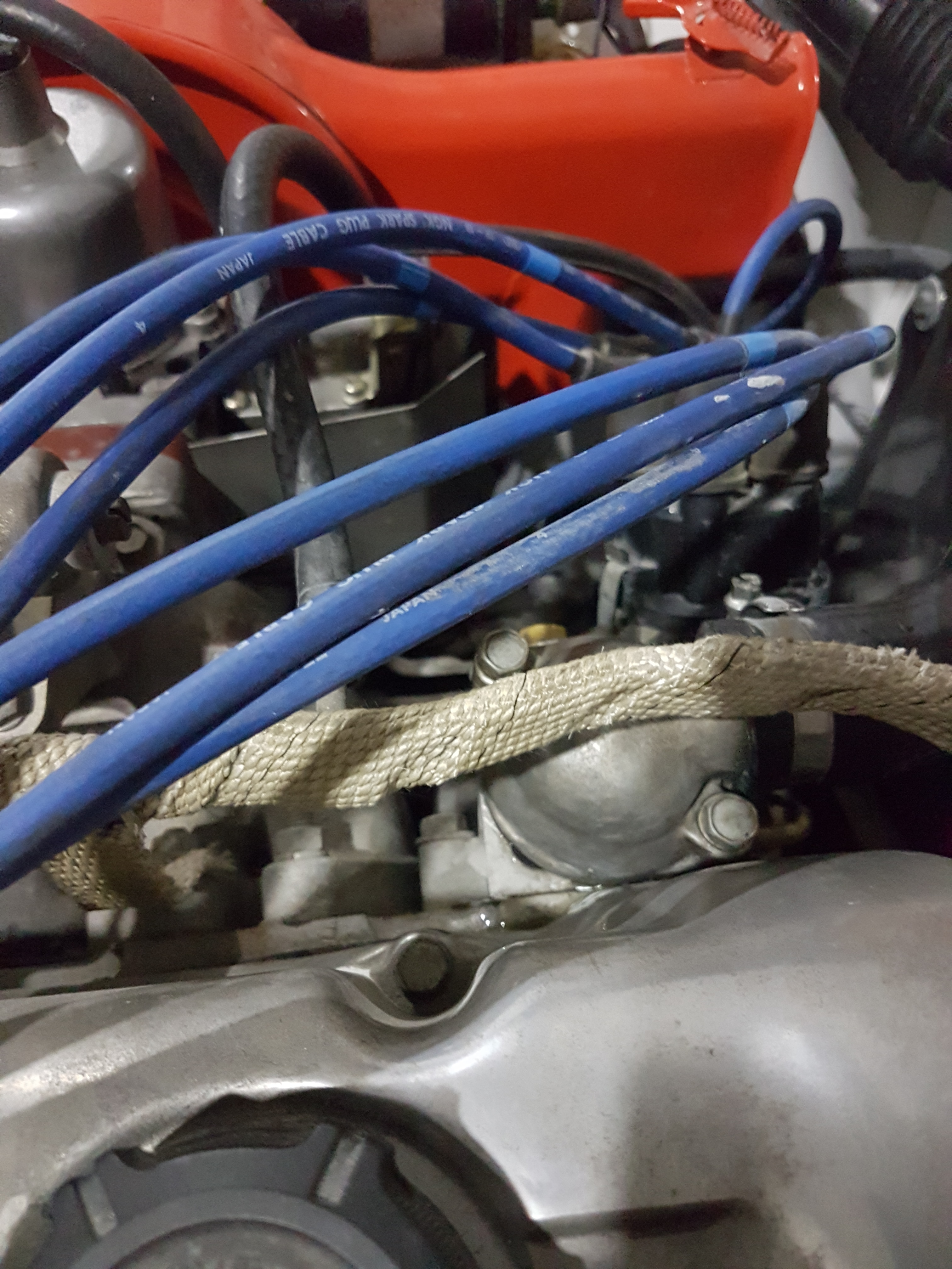

I am having a leak after cleaning the thermostat cover and reinstalling the 170°F (76.5 C) tropical thermostat. I installed it as shown using a nissan gasket. I did notice rust on the bolts when i removed them and sprayed some WD40 on them. It is jusk leaking wáter and no coolant. Is this normal???? Will i need to open in once again and reinstall tightening the bolts even more? No rtv or high temp silicone. Just the gasket!

what do you mean leaking water and no coolant? that does not make any sense. if you have a leak you need to check the mating surfaces, make sure  they are clean and in good condition, the torque it to spec with a new gasket. If there is still a leak, something else is leaking, like the hose or something else.
1: First of all, make sure the bolts you are using are not too long and bottoming out.
2: Top thermostat housing could be warped. Check with a straight edge.  Take it off and get some sheets  of wet and dry emery paper in grits 100, 200 and 400. Get a flat steel plate or a flat sheet of glass. Use WD40 as a lubricant. Start off with the 100 grit and lap the stat housing. Lap housing in a figure 8 pattern. Any high spots should become readily apparent. Lap with 100 grit until housing is totally flat, then finish by polishing with 200 and 400 grit. You can also lap the bottom housing, although that one is less likely to warp.
Use new gaskets every time. I prefer to use Permatex Aviation Form a Gasket ( Brush on liquid ) as a sealant. Much tackier than RTV, although a bit more difficult to remove. Will never leak though!! GL.
Did something similar above to my water inlet and it worked great! Took a couple hours but worth the effort. I couldn't source a new one. NLA.
Edited by rcb280z
i mean that there is some wáter running out of the thermostat housing as per the picture attached. I will check the mating surfaces and sand them with grit paper and reistall the thermostat again. I really dont like the idea of using high temp rtv!! Please see the picture closely and the wáter leak.
