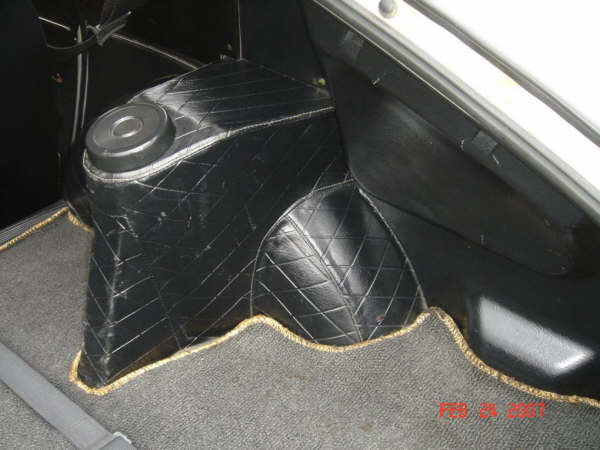

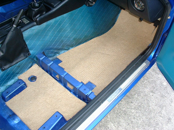

Kats posted pictures of the insulation he bought for his blue 240Z.  You will find his complete photographs in the archives.  That's what it (NOS) is supposed to look like.  I have some pictures from MikeB also.  His early cars show faded out stitching from original.  Finally, the edge stitching, loop detail and snap fitting from the new replacement carpeting.  This is as close as you are going to get to NOS.  I also want to mention that the early cars did not have a hook fitting welded to the floor under the front of the seat for holding the the front pieces in place.  It was a Velcro pad glued to the floor.  You can see the cutouts in the pad in Kats' car.

still trying to find the two front floor jute pieces that go under the feet. the ones i have access to are torn at the ends, otherwise unusable. I may be able to guesstimate end length, based on carpet length.
