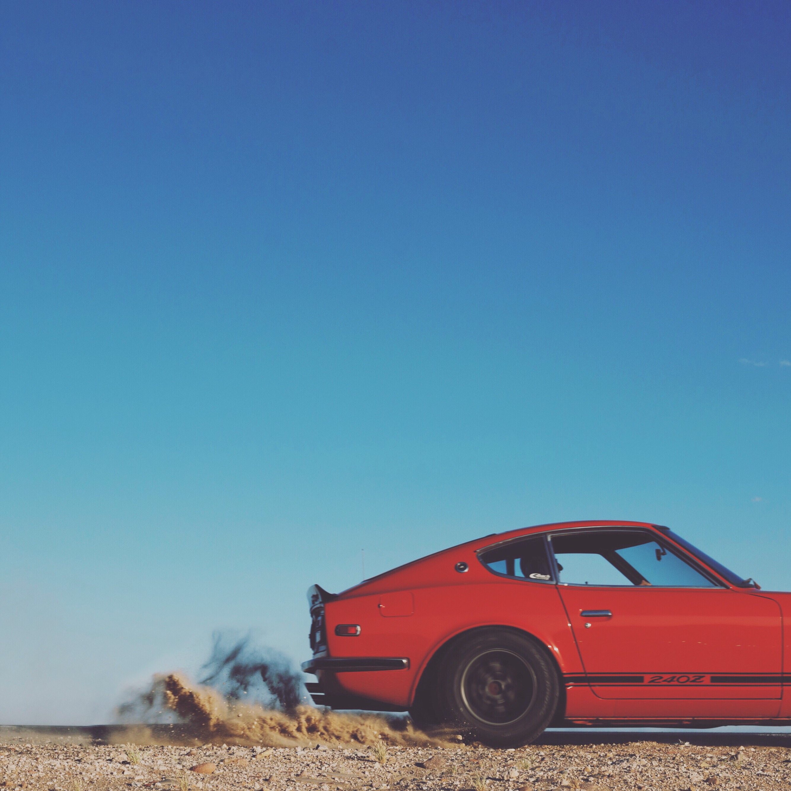

I think I'm gonna try that, make the tip stick out beyond the bumper although looking at a side shot of my car it seems the tips already are passed my bumper. Need to go down to my car and take  closer look
