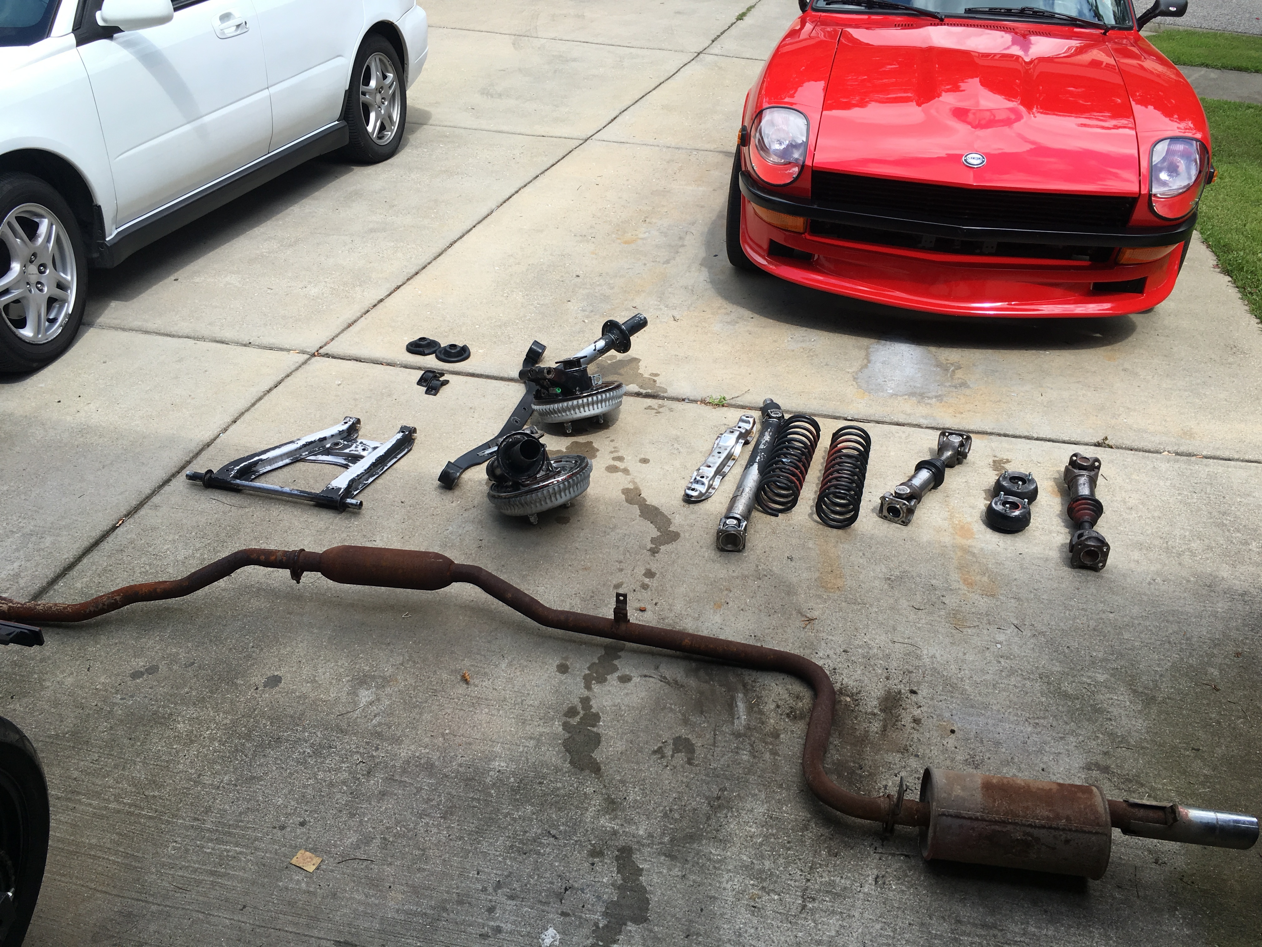

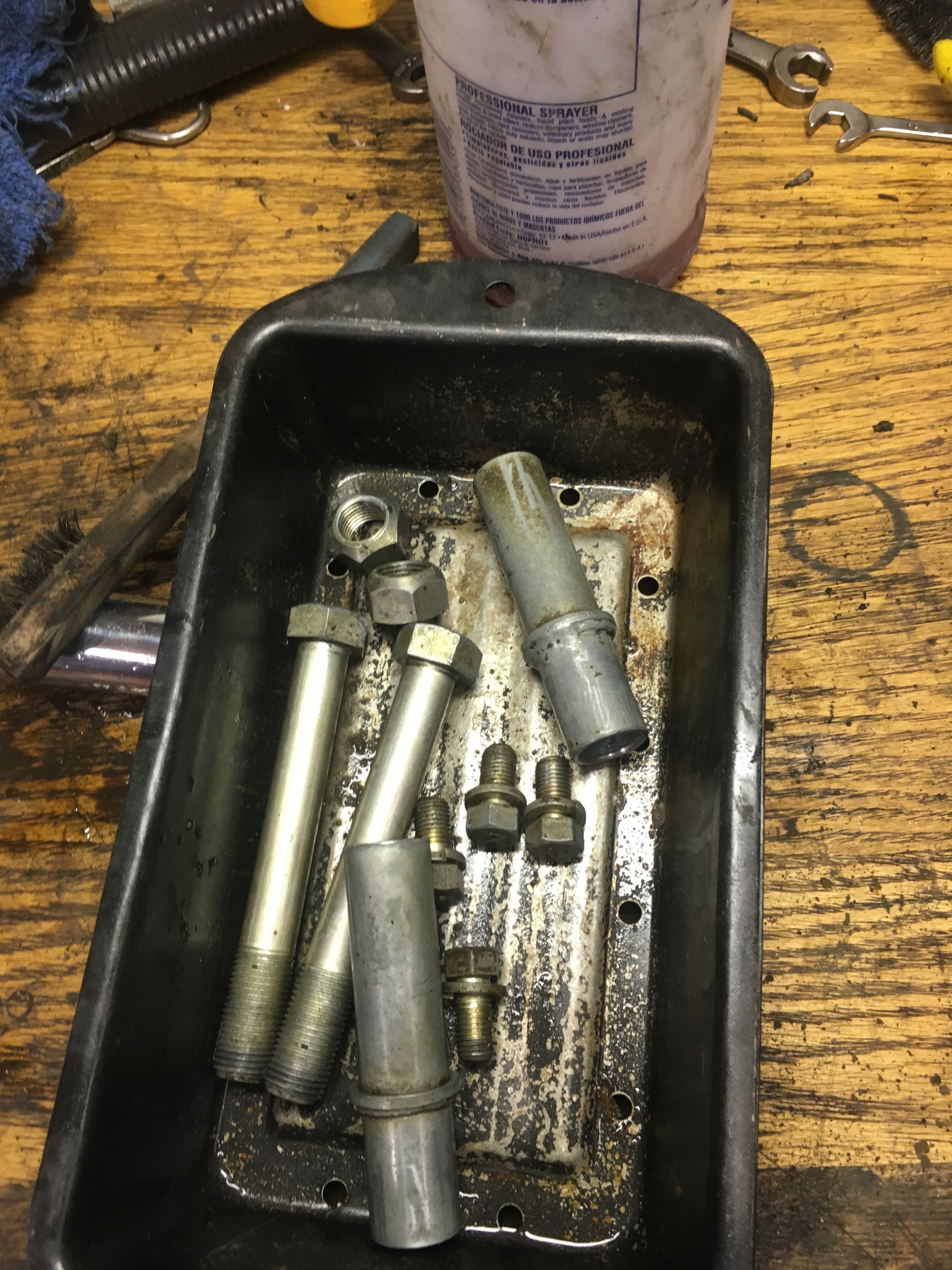

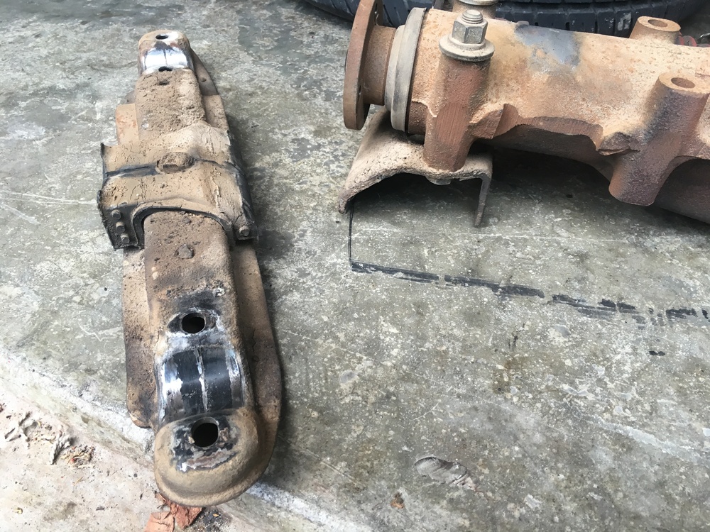

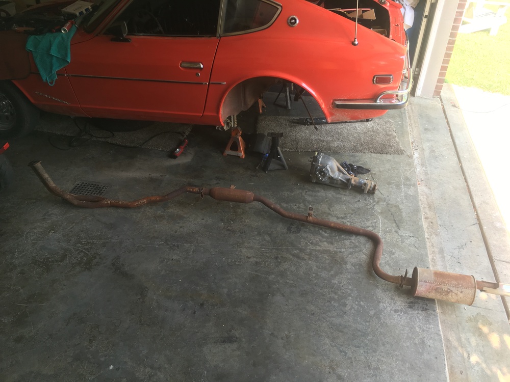

Well the front suspension is done and moved on to the rear . Same story as up front with dry poly bushings, and throw in there a totally separated front diff mount . The original arrestor strap did its job and kept the diff at bay. Found a few bolts not torqued and a bad spindle pin, but everything is repairable - and almost done. All new rubber bushings back in and stock mount and strap for the diff. New spindles all around . Hope to have it her own her own legs today, but will see. Half shafts getting new universals and boots with the main driveshaft also with new joints.
Can say enough about how nice it is to work in a rust free machine. We haven't had to replace hardly any hardware and it still looks good too
