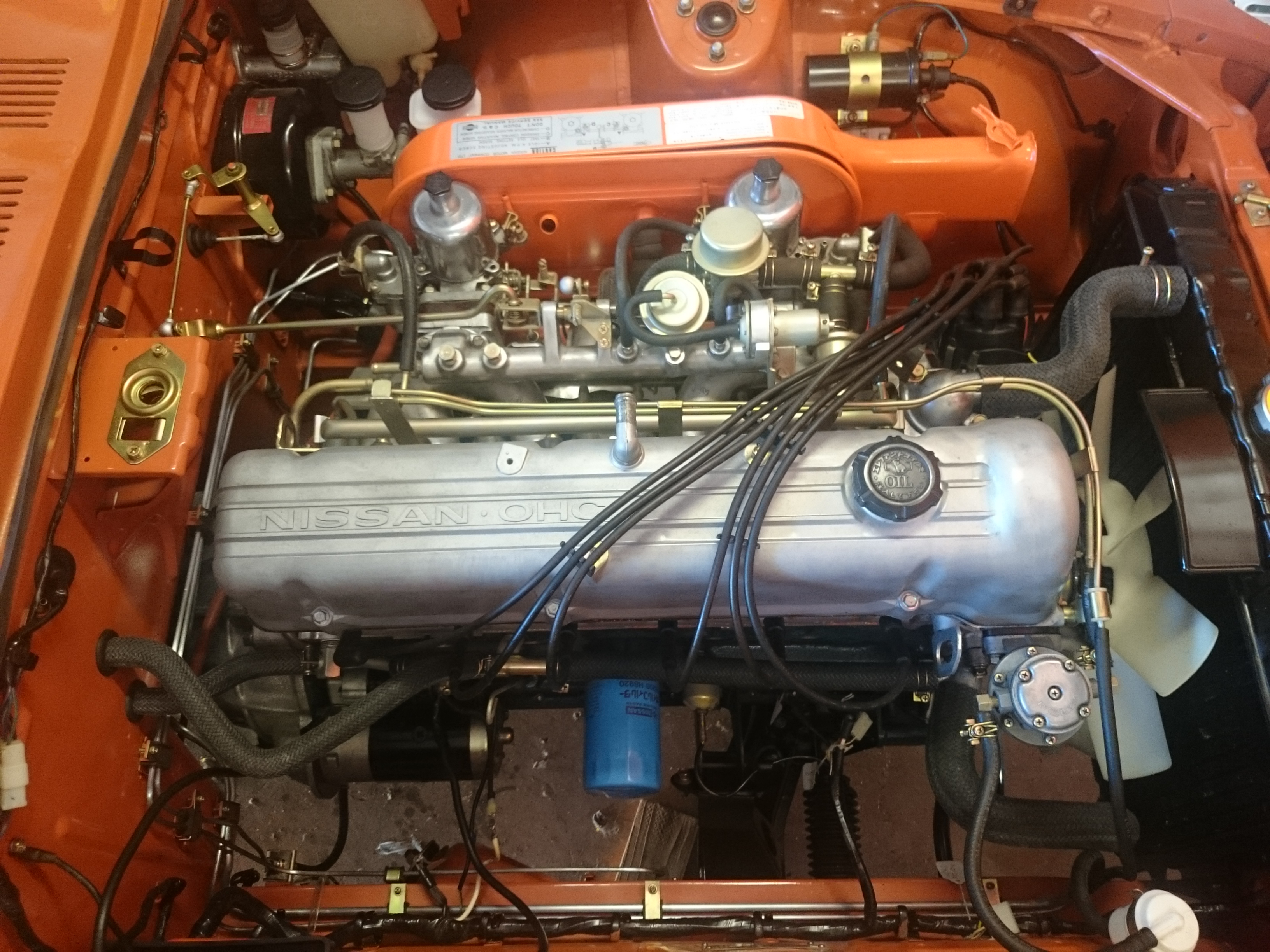

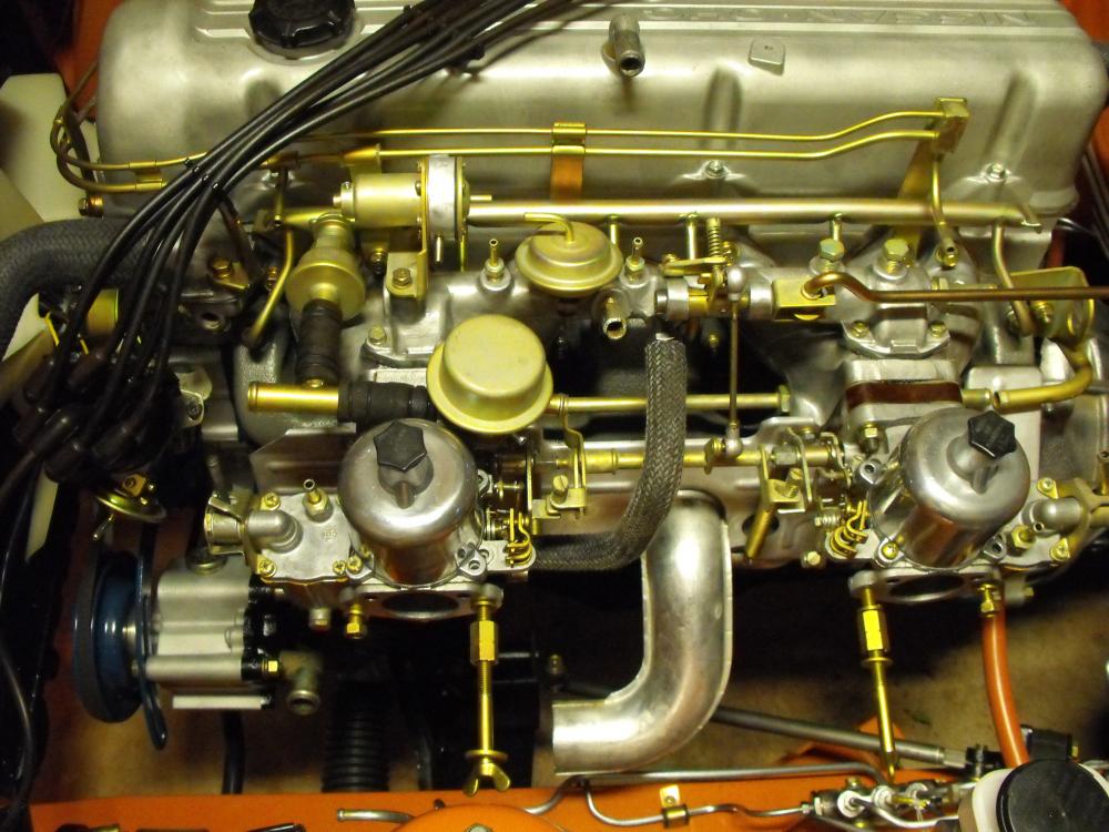

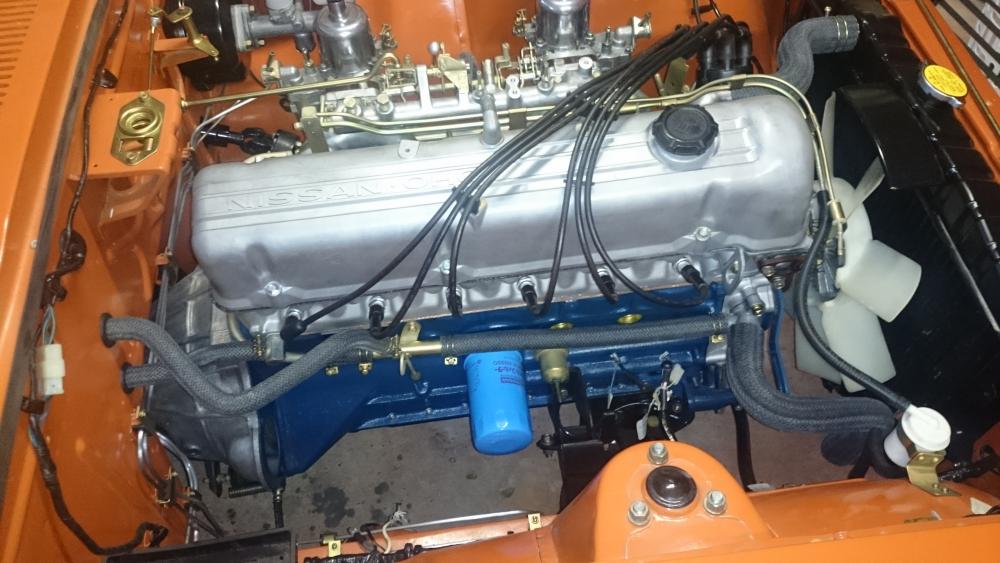

Here are a couple updates until the thread is restored.  Got the carbs cleaned up and mostly installed.  Got new braided hoses from Jay at http://jdm-car-parts.com/.  Jay does a great job with these hoses.  The quality is amazing and they look great with the wire clamps.  Will continue adding parts to motor.  Also doing a bit of interior work.

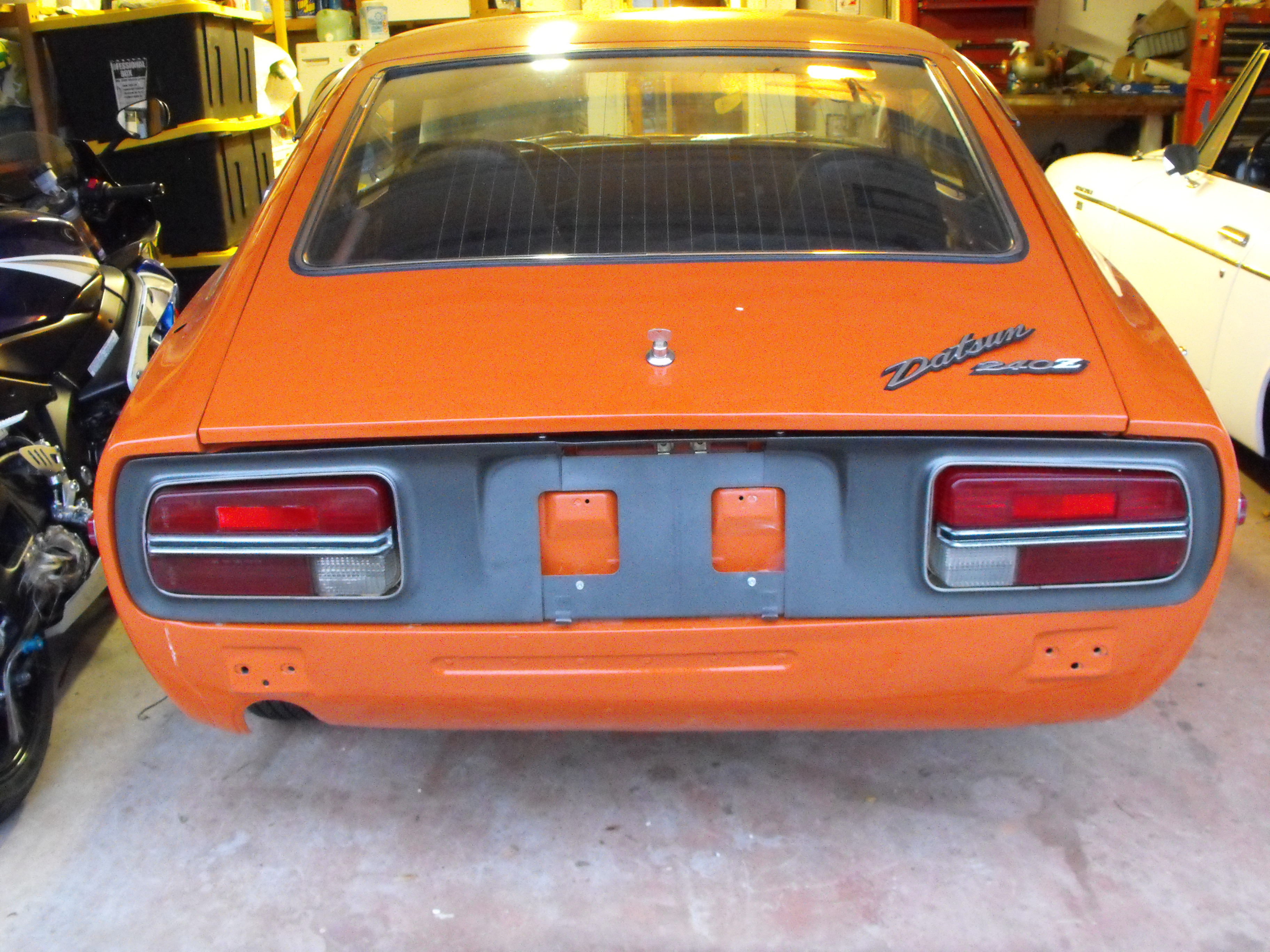

Got a passenger side taillight from 'Montezuma'.  Thanks Dave, looks great.  Now I am waiting for the bumpers to come back from the chrome shop to finish out the back end.  Should get those back in a week or two.

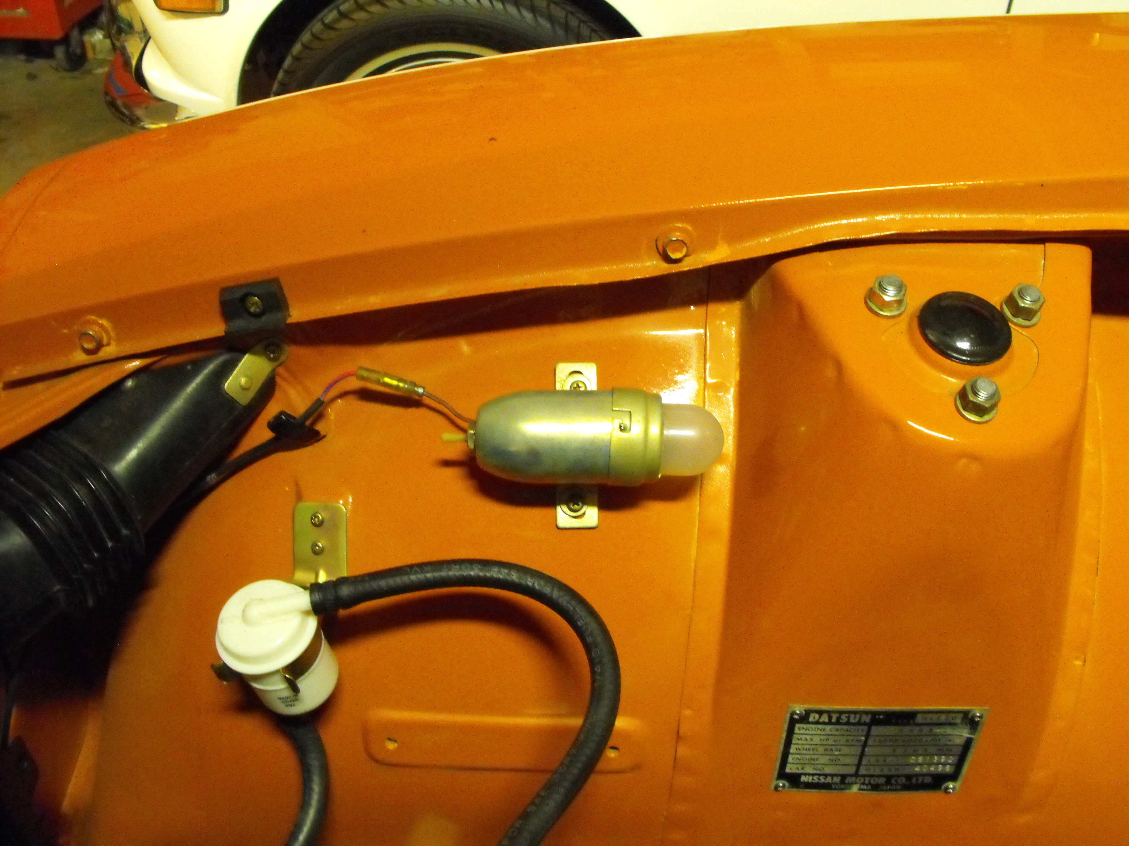

Got the smog parts that sit on the balance tube zinced today.  That went well.  Also got the inspection light zinced today.  I was thinking of just buying a light, but the price for the lights has gotten insane.  It was smarter just to plate the old one that I had laying around.  It came out pretty well.  Also got the air warmer tube in.  Here are the latest pic

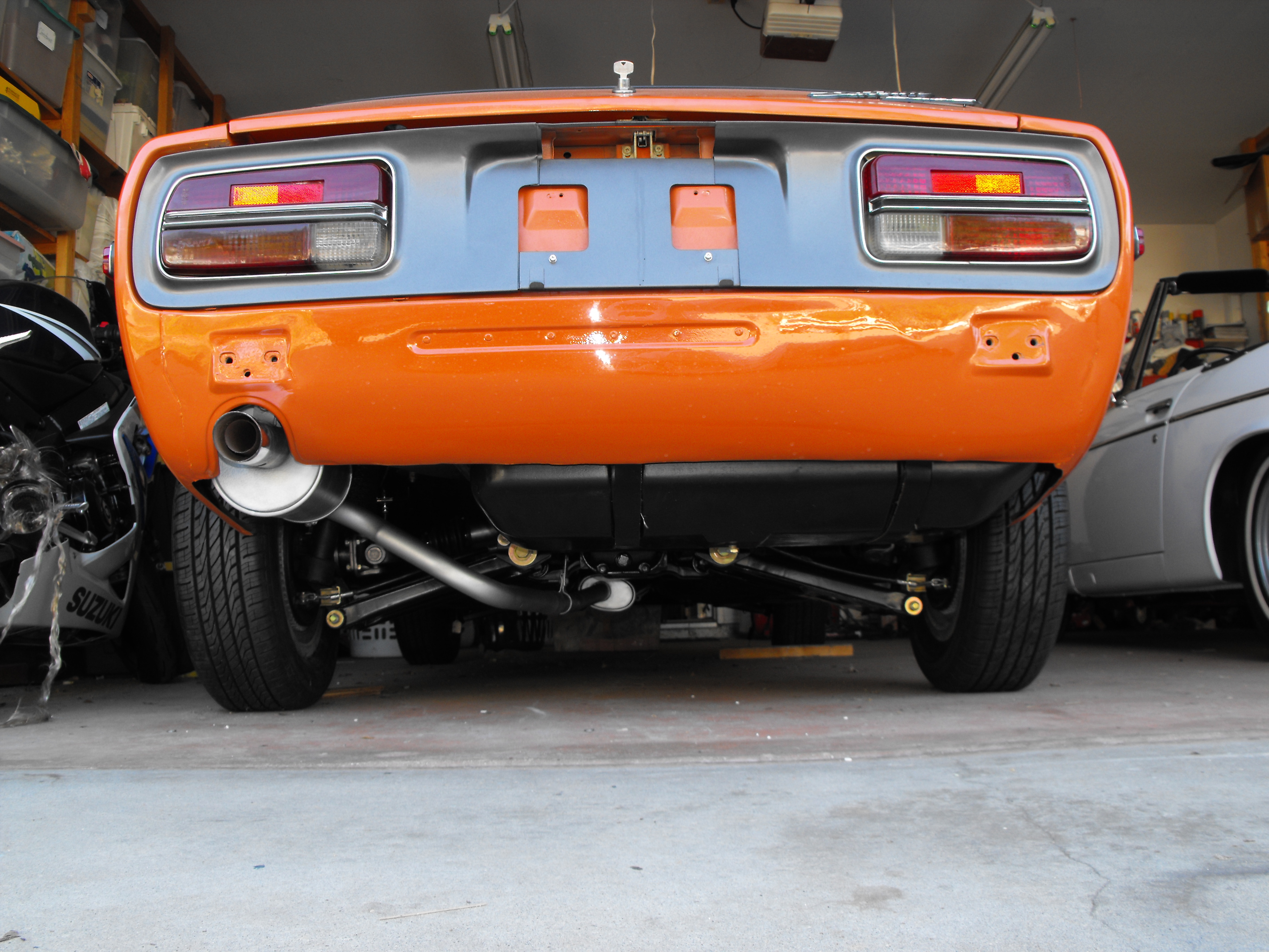

If all goes well, I will have the exhaust system put in tomorrow.

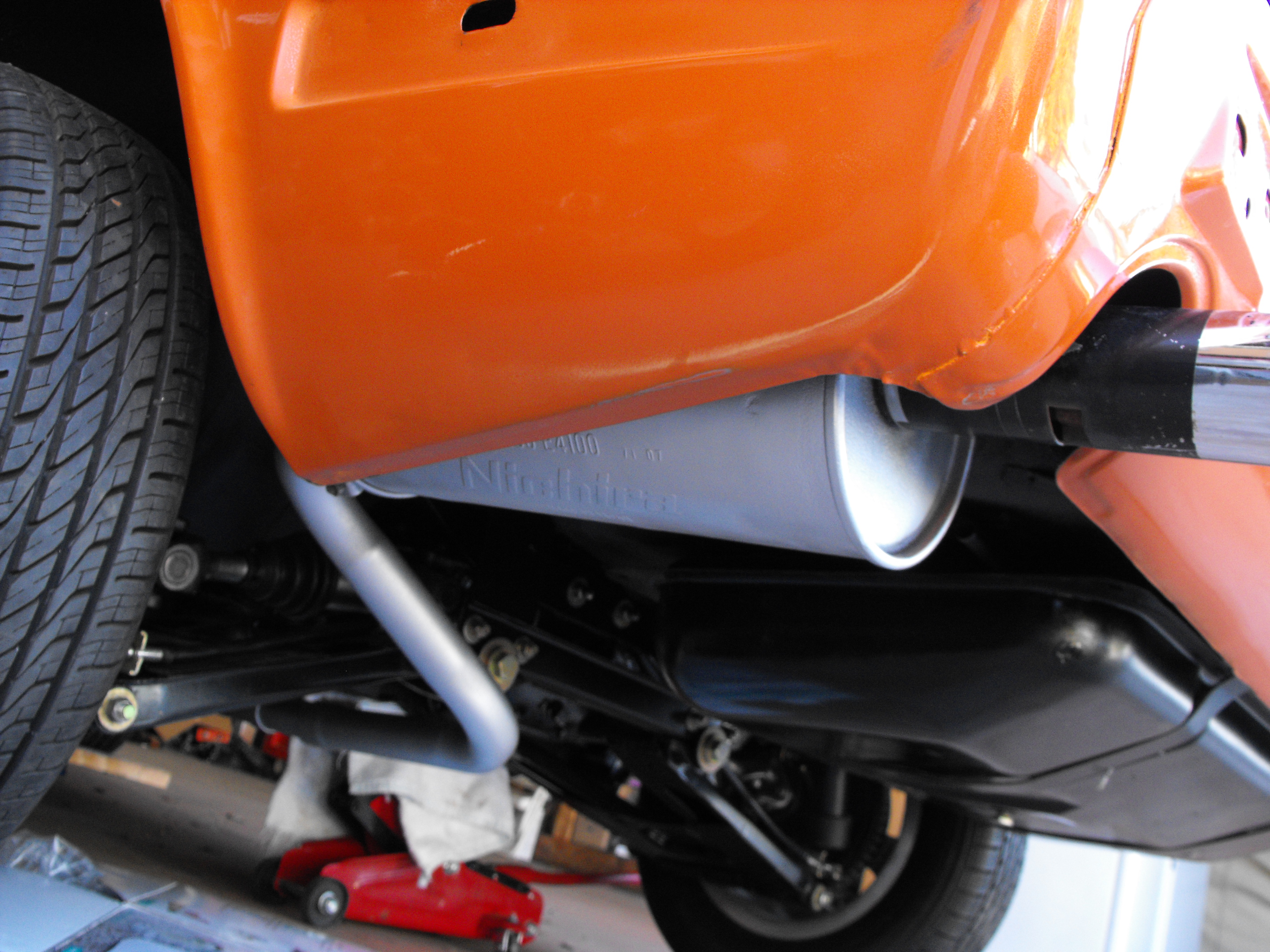

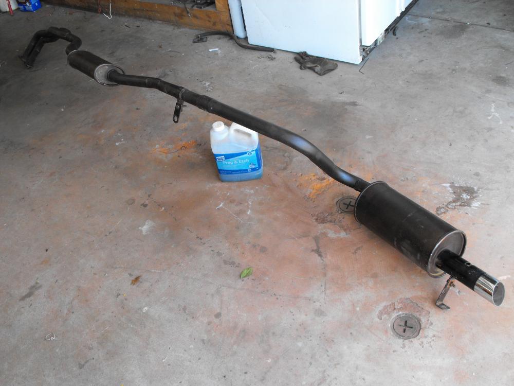

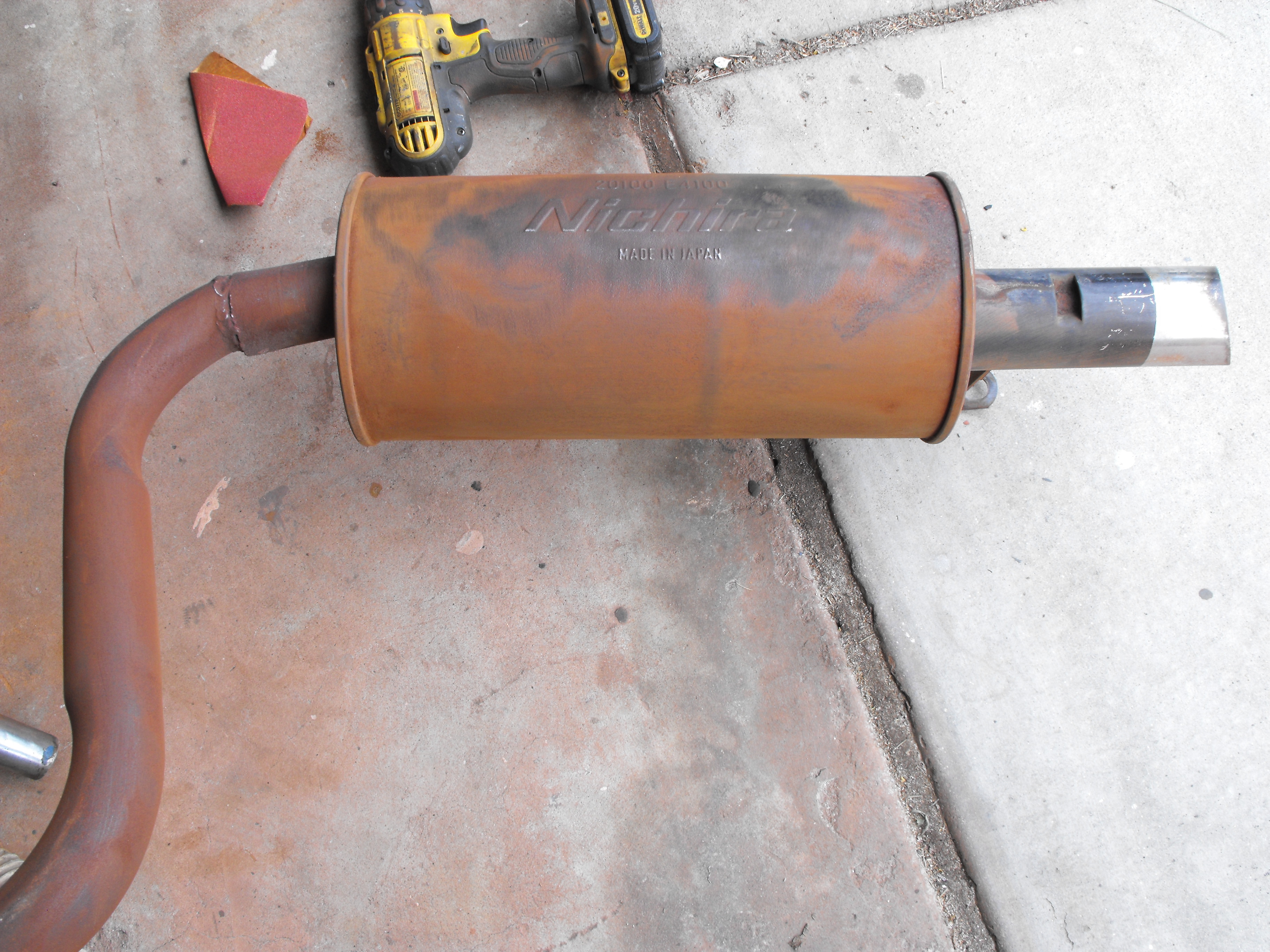

Got the exhaust system in today....very cool.   It took about two hours of sanding and wire wheeling to clean the outside of the exhaust.  After a final sand with 80 grit, I used the phosphoric acid to etch the steel and minimize further rust.   The exhaust actually is very solid.  After the etch, I did a clean with paint prep thinner and then sprayed with high temp aluminum paint.   Nice to see the Nichira name on both mufflers.  Now i just need to figure out how that one hanger attaches.
Also cannibalized the original style fuel pump from my yellow Z and installed that.  I had a new aftermarket pump laying around so put that in the yellow Z.  Yellow Z will eventually get an LS motor, but that is down the road.

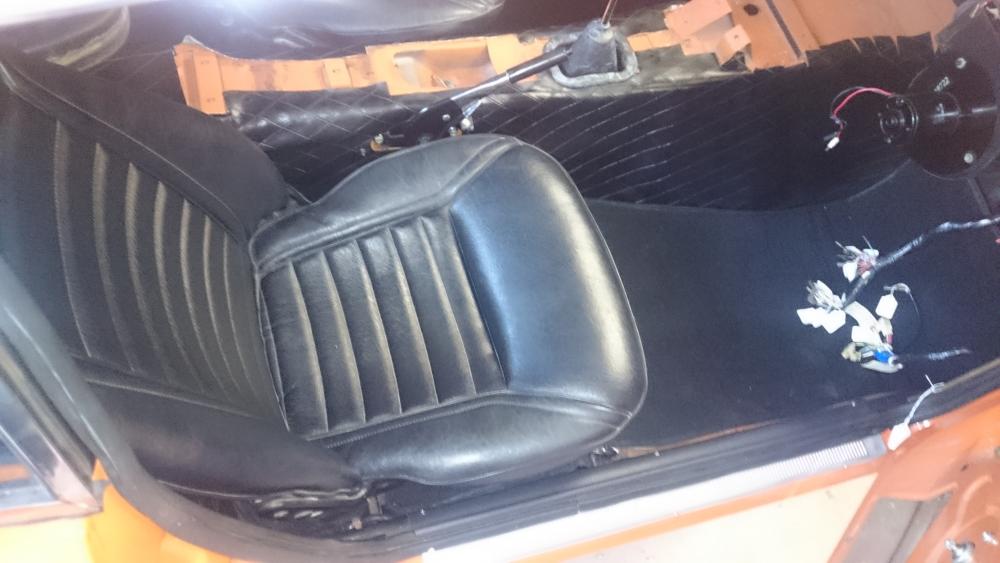

Also got the Speedo cable installed, mostly.

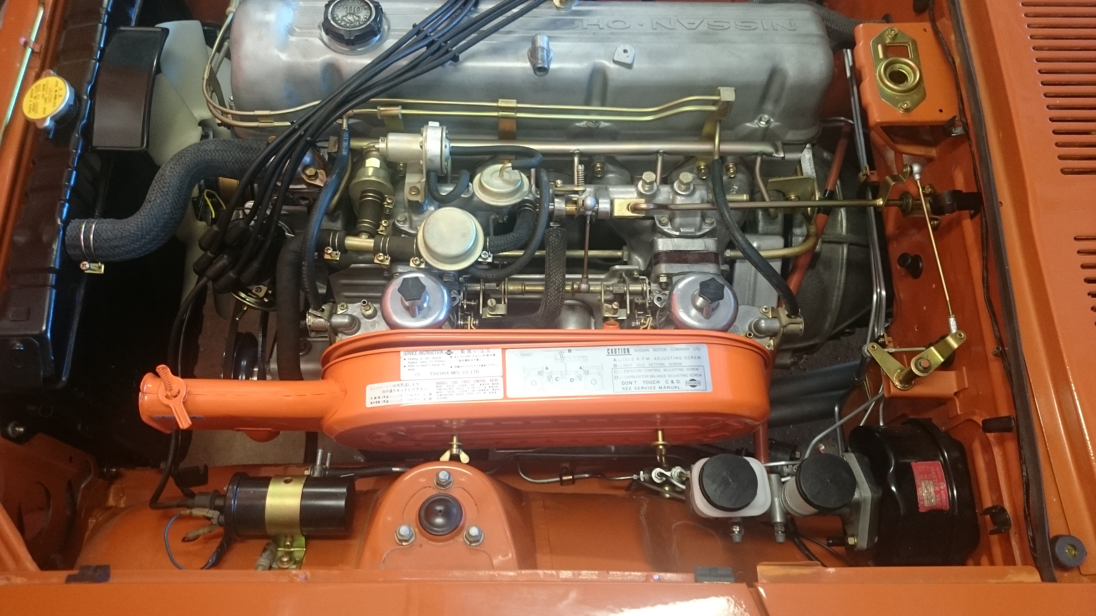

Finished the smog parts, hoses and clamps.  Will finish up the carbs over the next week or two.   I threw on the air cleaner just for the pics.  The air cleaner was powder coated and decals applied.

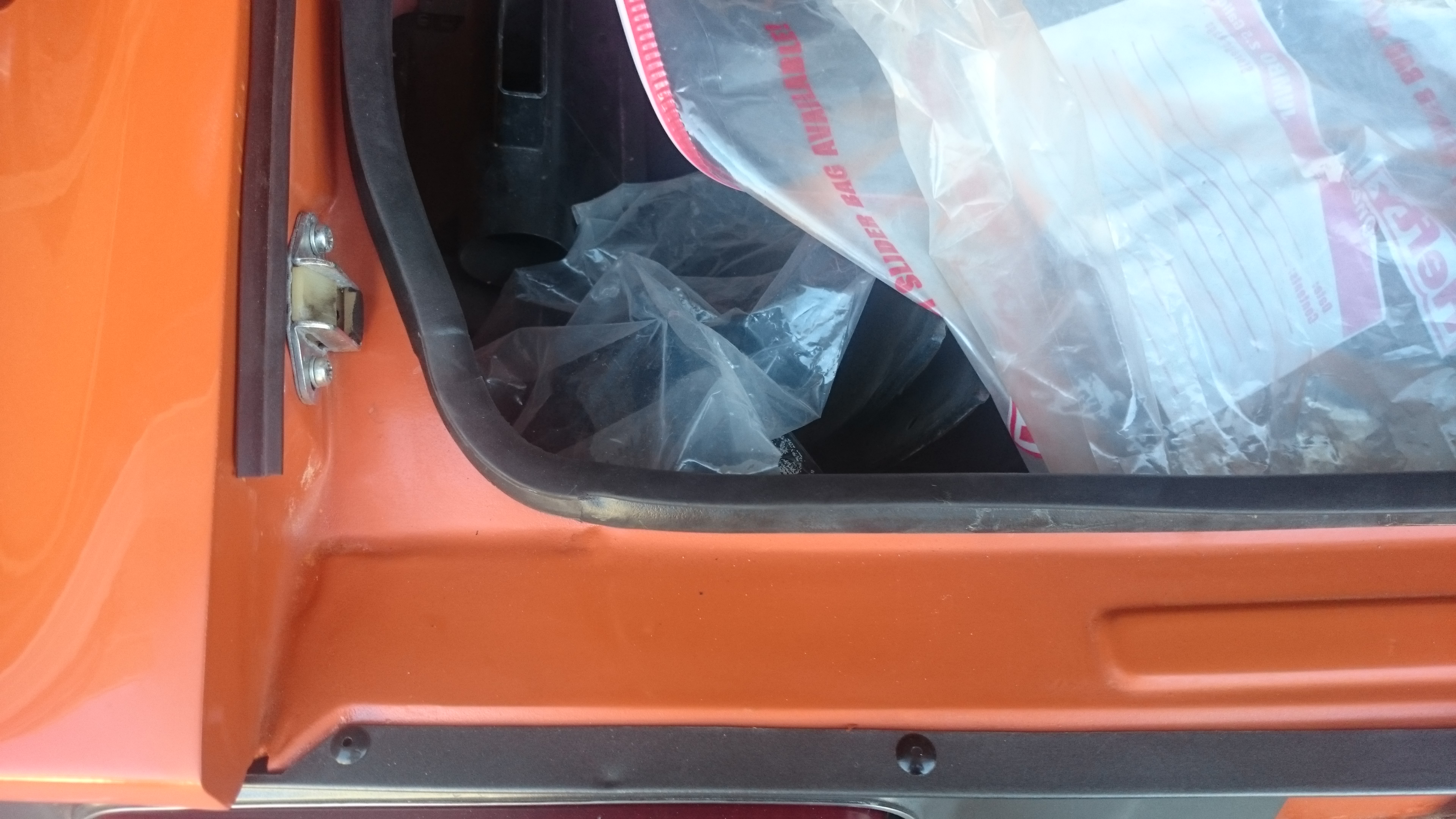

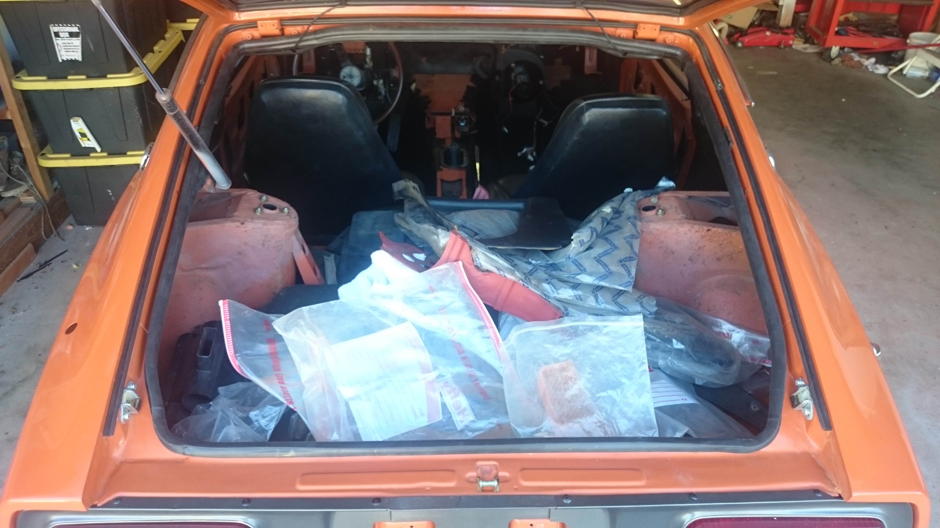

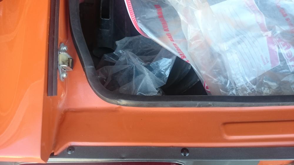

Got the weather stripping in on the rear hatch.  Went in easy enough, but I still hate doing weather stripping.  The only part I like about doing the weatherstripping is peeling the glue off of my fingers.

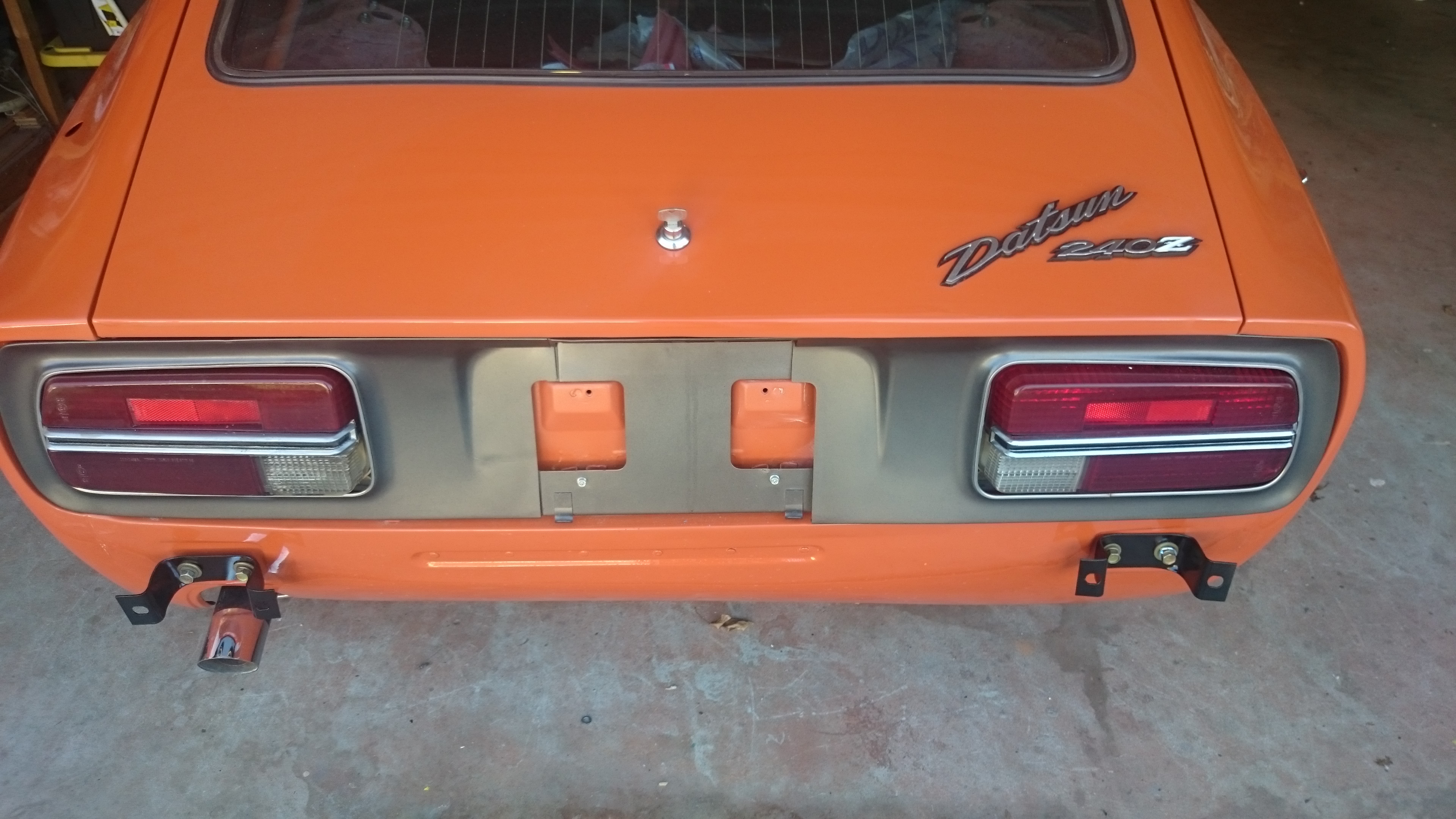

Cleaned up and painted the bumper support brackets and just picked up the freshly chromed bumpers this AM from West Coast Plating.   Will attach those in the next week or two.  Also got new rubber strips for the bumpers.  They should look nice when done.
