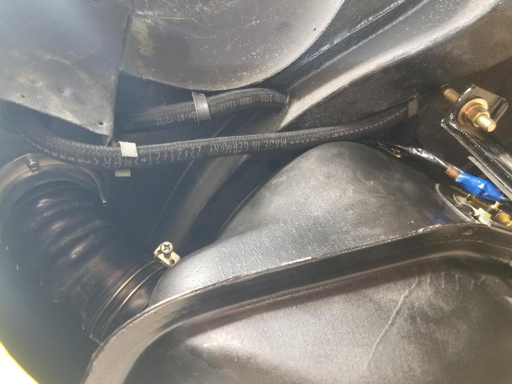

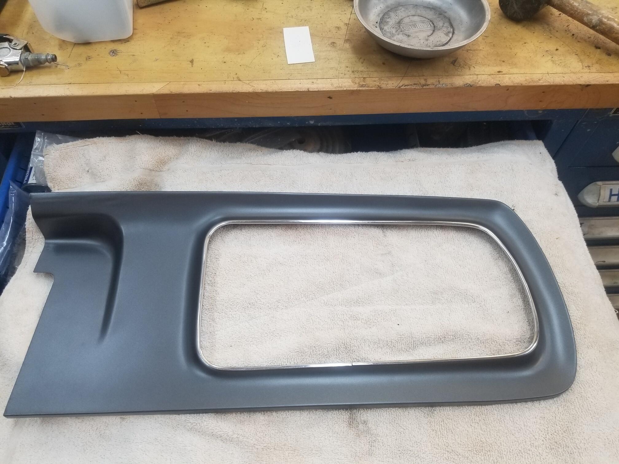

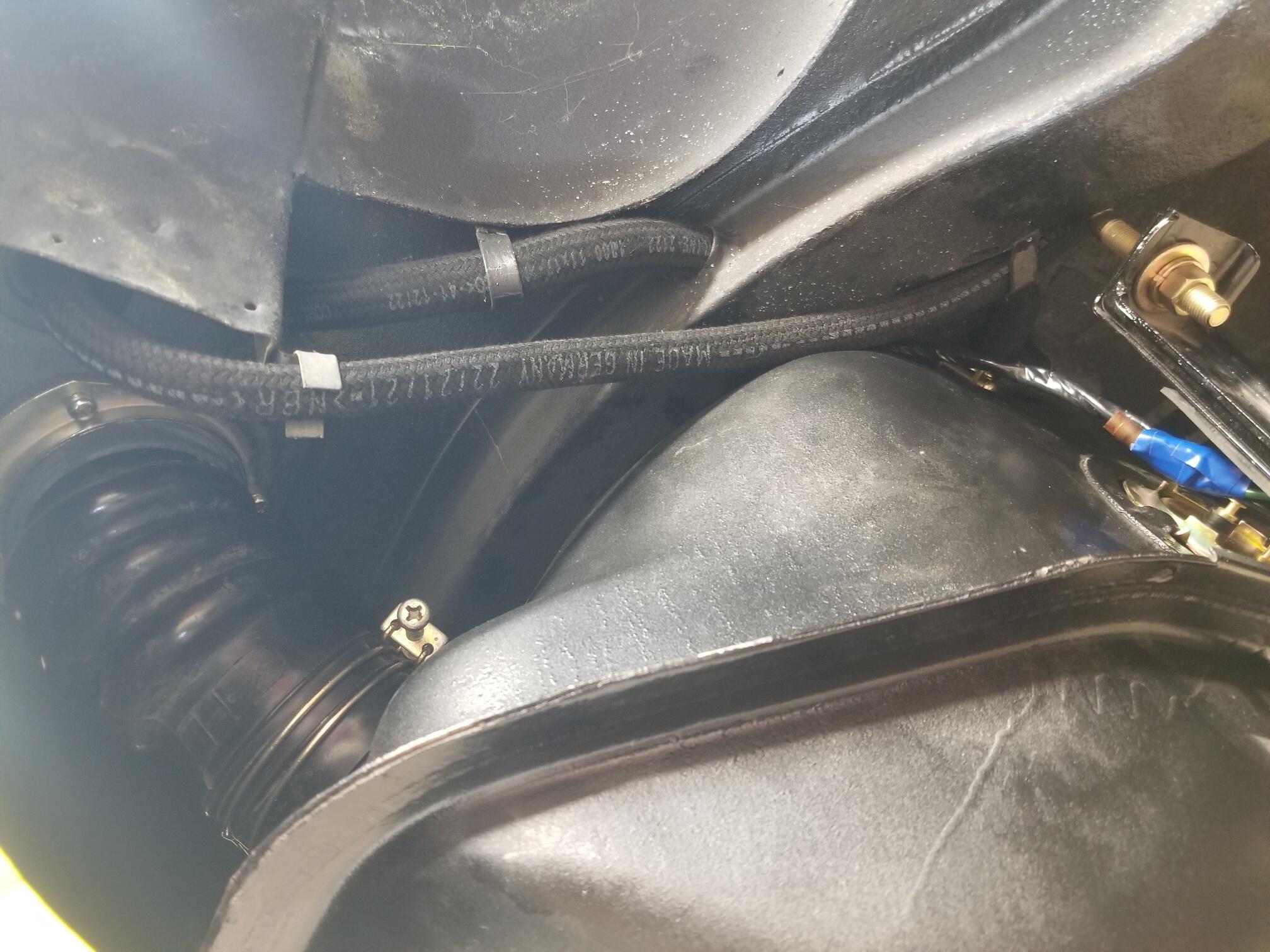

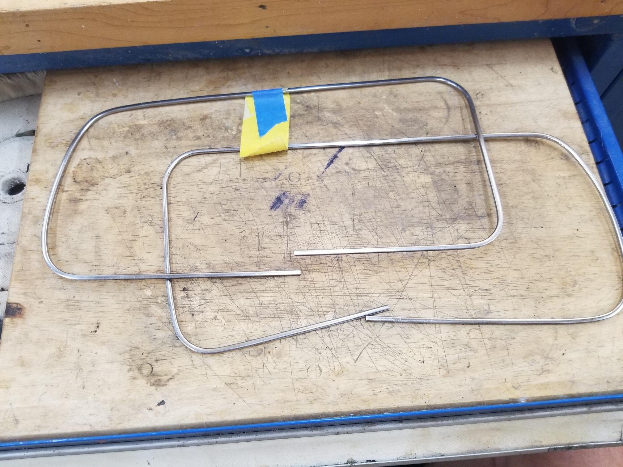

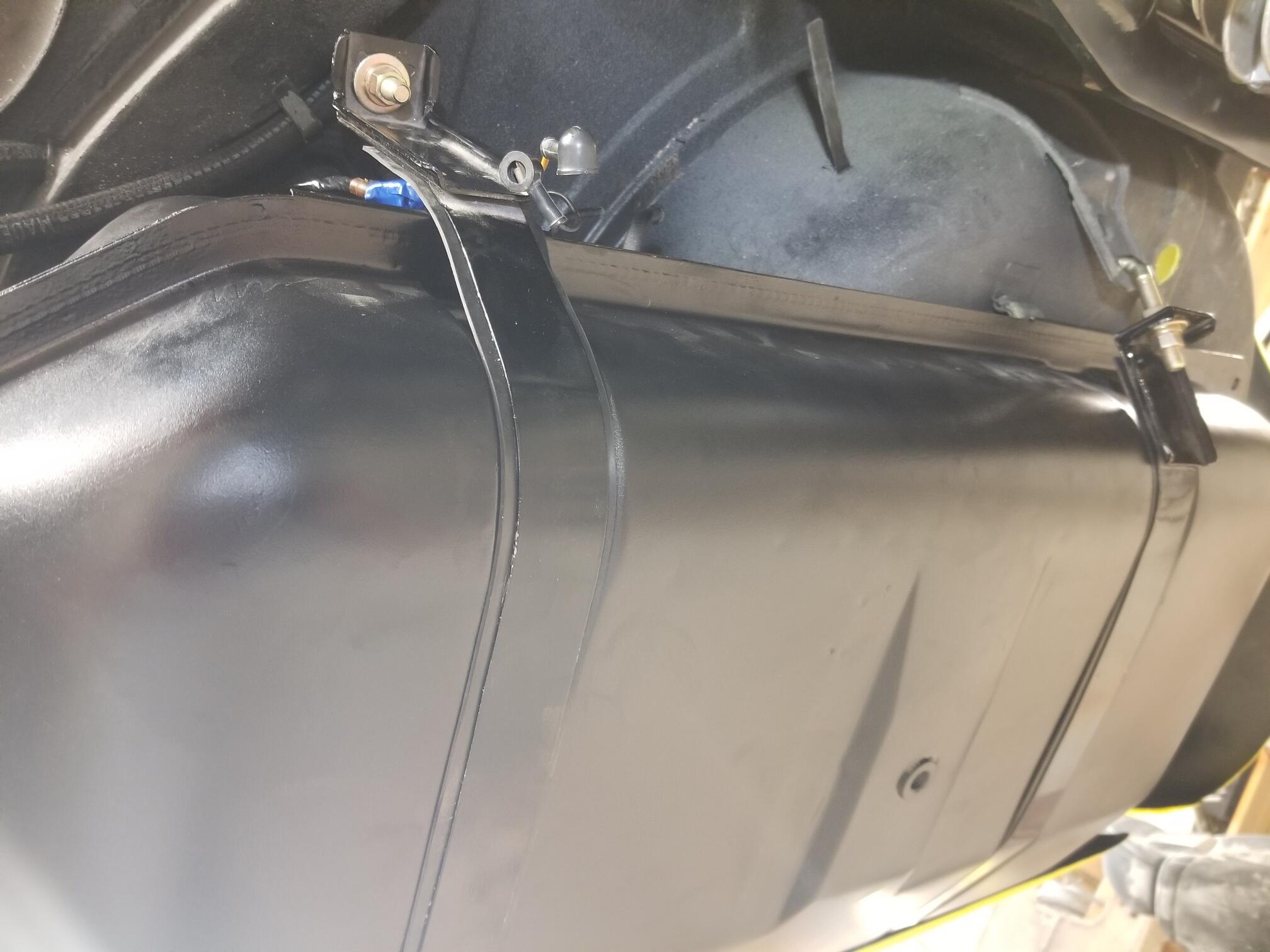

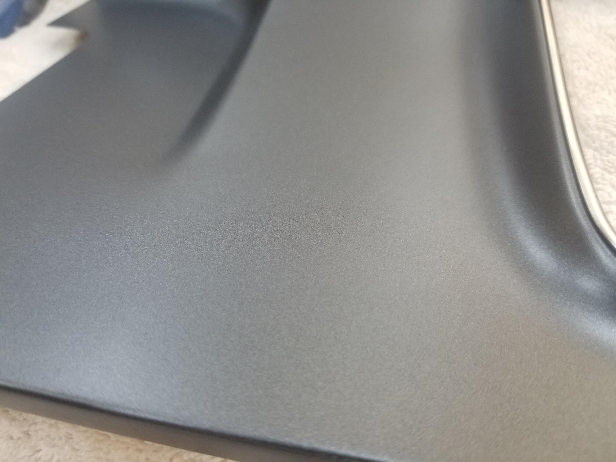

October 2, 20231 yr Author Popular Post comment_657693 I also sprayed the rear tail light panels with clear matte today per Jim A's recipe. I worked on the trim for those panels also. I removed it to make it easier to paint them and polish the trim. We will see how hard they are to get back on. An interesting note, these piece are carbon steel and must be plated. They are magnetic. I was surprised they weren't stainless! I also got the last vent line at the tank worked out by lining it with a spring. I then got the tank straps installed and the filler neck all setup. If I could have found all the clamps I needed I would have gotten the vapor tank all taken care of too Link to comment https://www.classiczcars.com/forums/topic/55369-1971-hls30-14938-lily-build/?&page=64#findComment-657693 Share on other sites More sharing options...

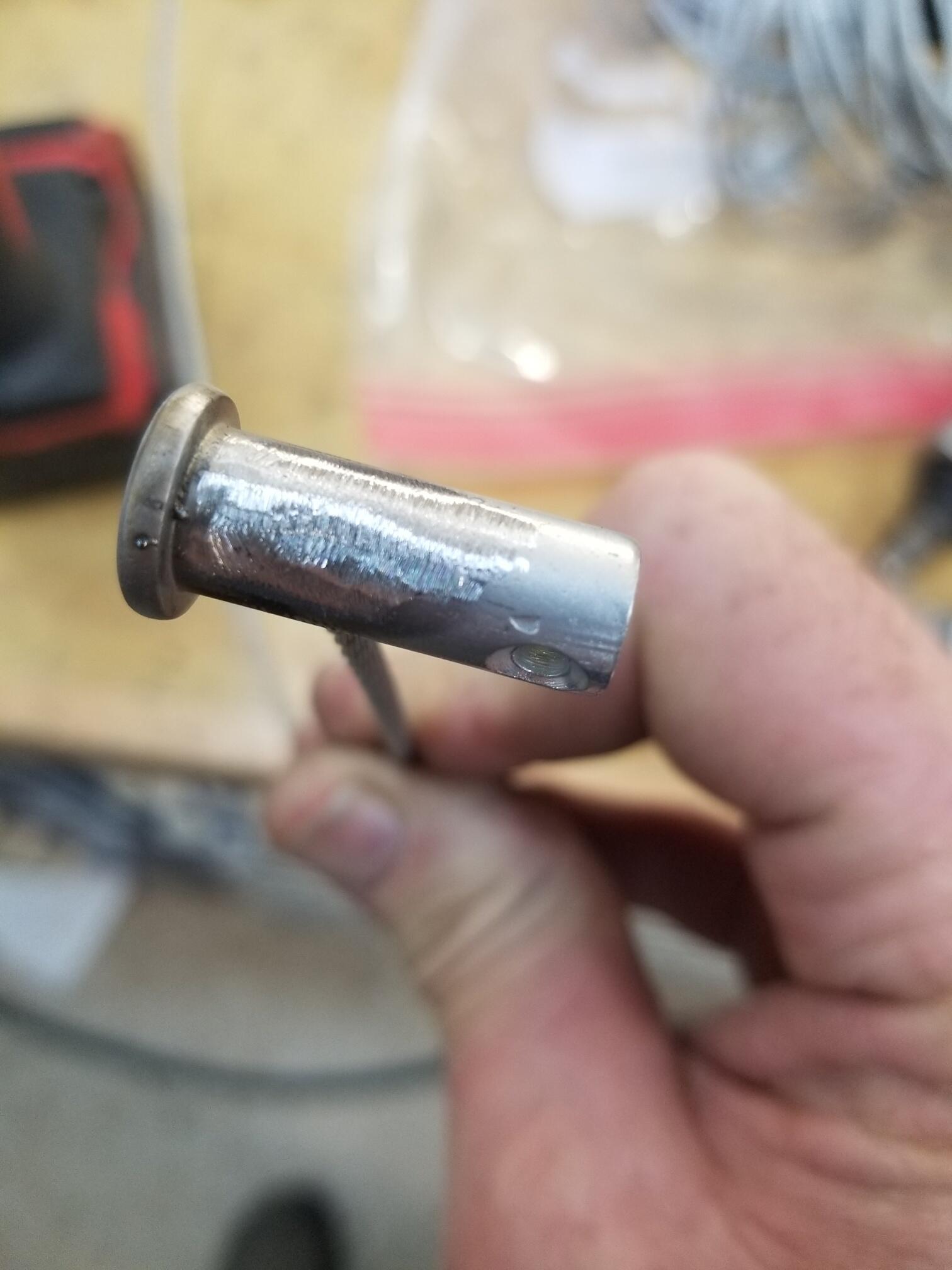

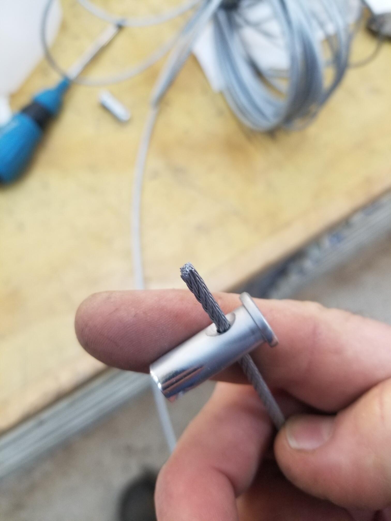

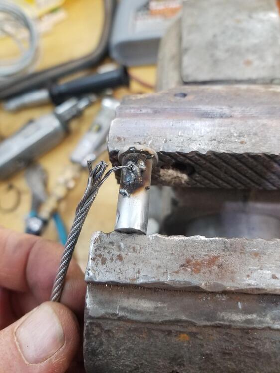

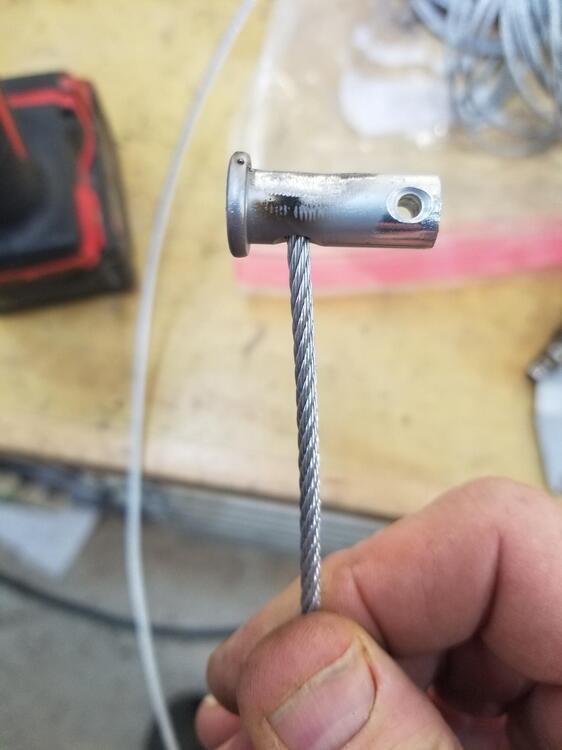

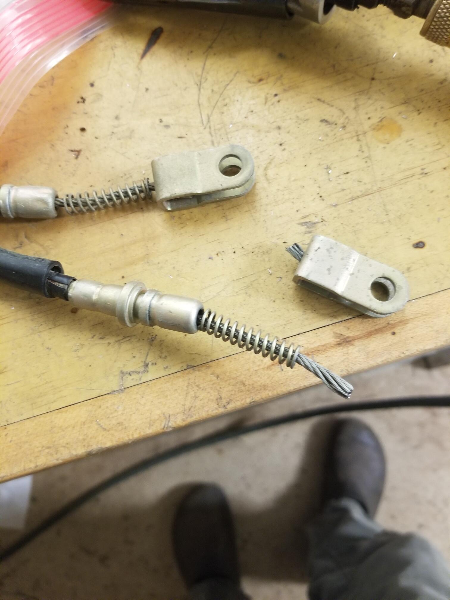

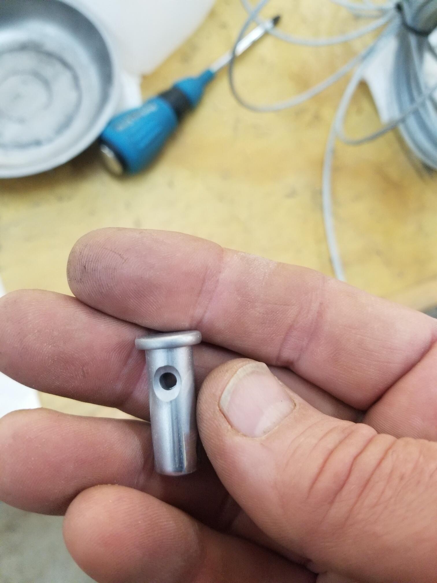

October 9, 20231 yr Author comment_657997 So I started on the emergency brake cable redesign. I've been procrastinating on this So I pulled it back out of the car, which is a pain with the differential in place! Cut off the factory end Welded the pin When I welded the back side of the pin, I burned through the cable. So I had to redo it Link to comment https://www.classiczcars.com/forums/topic/55369-1971-hls30-14938-lily-build/?&page=64#findComment-657997 Share on other sites More sharing options...

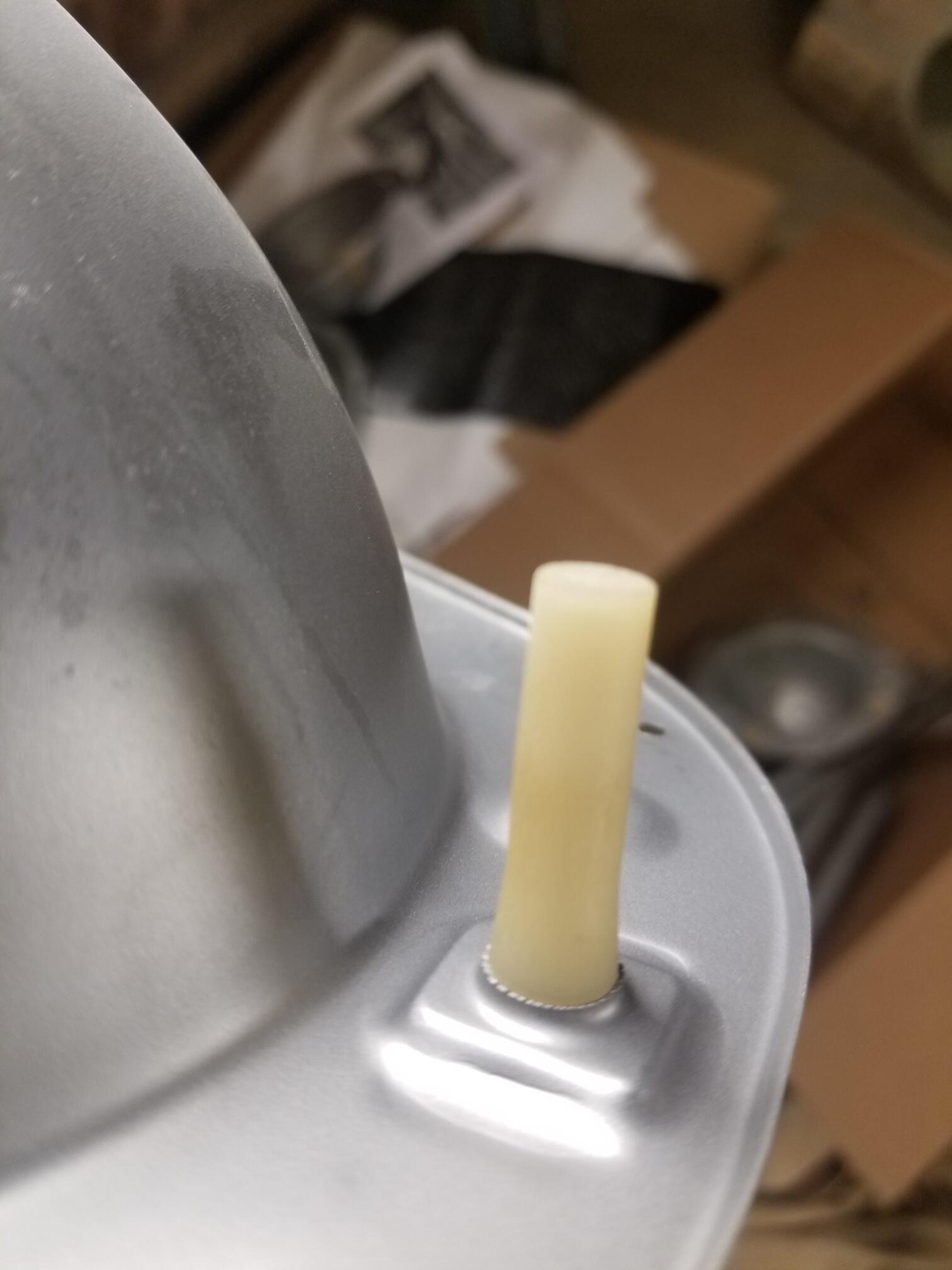

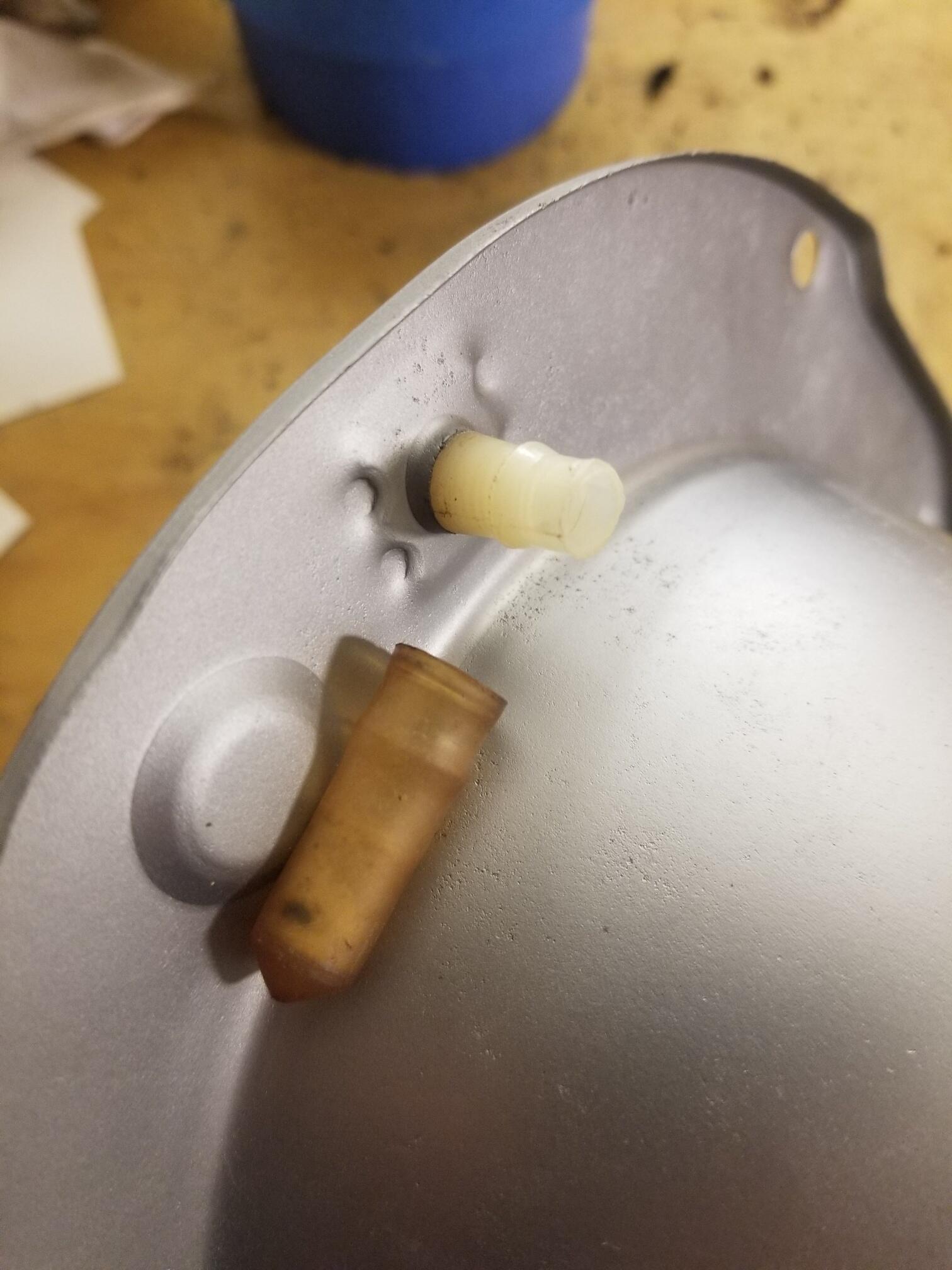

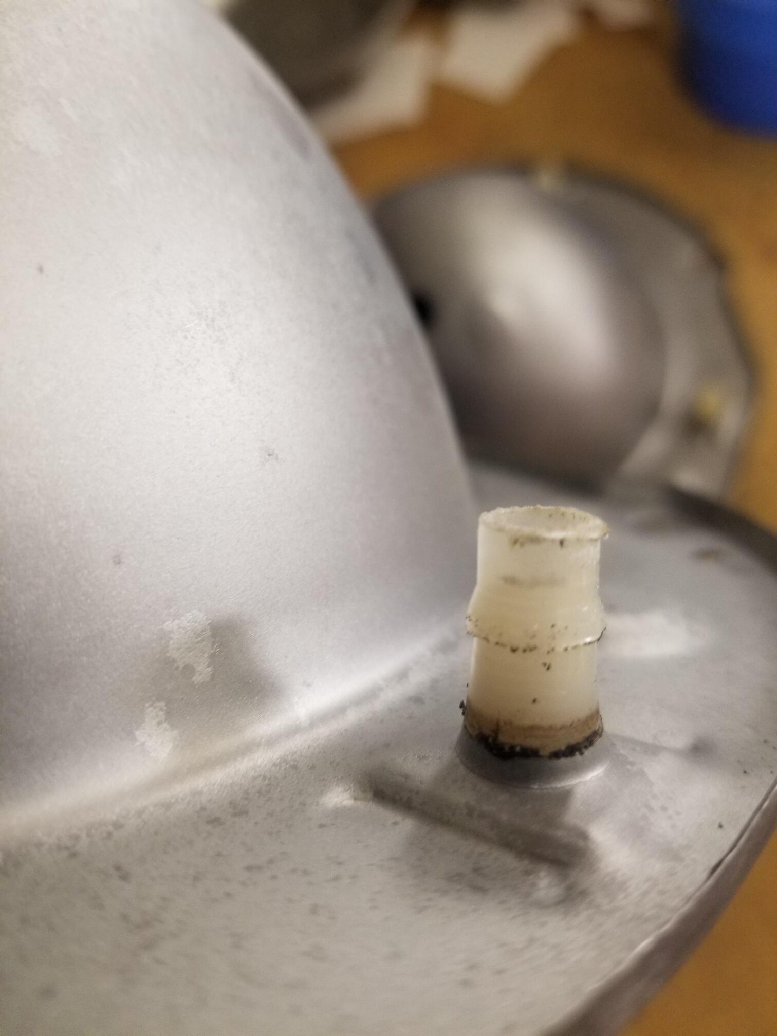

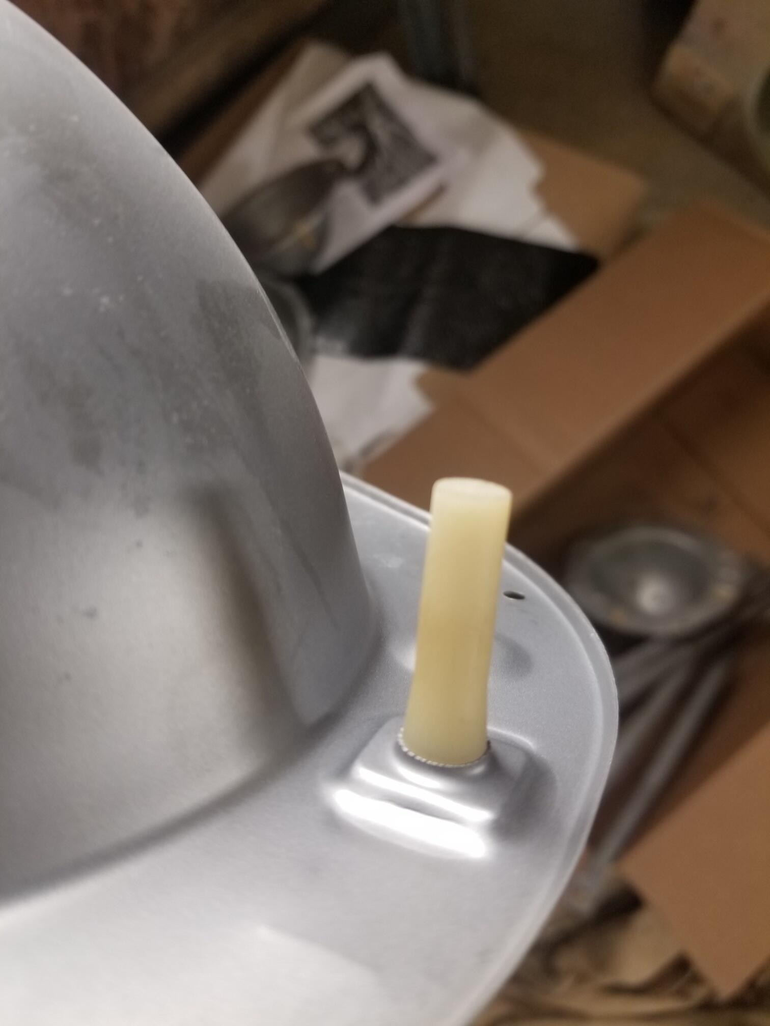

October 9, 20231 yr Author comment_657998 I worked on the headlight buckets some more A little heat and the caps will come off Then I noticed that the buckets were different. The older ones with the caps and then I assume a newer style that the plastic adjuster thing is all one piece. I tried to get some of these out of the buckets but that wasn't going to happen with out destroying them! Link to comment https://www.classiczcars.com/forums/topic/55369-1971-hls30-14938-lily-build/?&page=64#findComment-657998 Share on other sites More sharing options...
October 10, 20231 yr comment_658004 43 minutes ago, Patcon said: When I welded the back side of the pin, I burned through the cable. So I had to redo it When you did it a second time, did you weld both sides of the pin, or just the far side from the cable? Also, did you consider silver brazing the cable into the pin? I think I would have tried that. Link to comment https://www.classiczcars.com/forums/topic/55369-1971-hls30-14938-lily-build/?&page=64#findComment-658004 Share on other sites More sharing options...
October 10, 20231 yr Author comment_658014 Silver brazing might work. Especially if you dish both sides to lock it in. I only welded the back side on the second attempt. It seems to be pretty strong but it's going to see some significant force, so we'll see ... Link to comment https://www.classiczcars.com/forums/topic/55369-1971-hls30-14938-lily-build/?&page=64#findComment-658014 Share on other sites More sharing options...

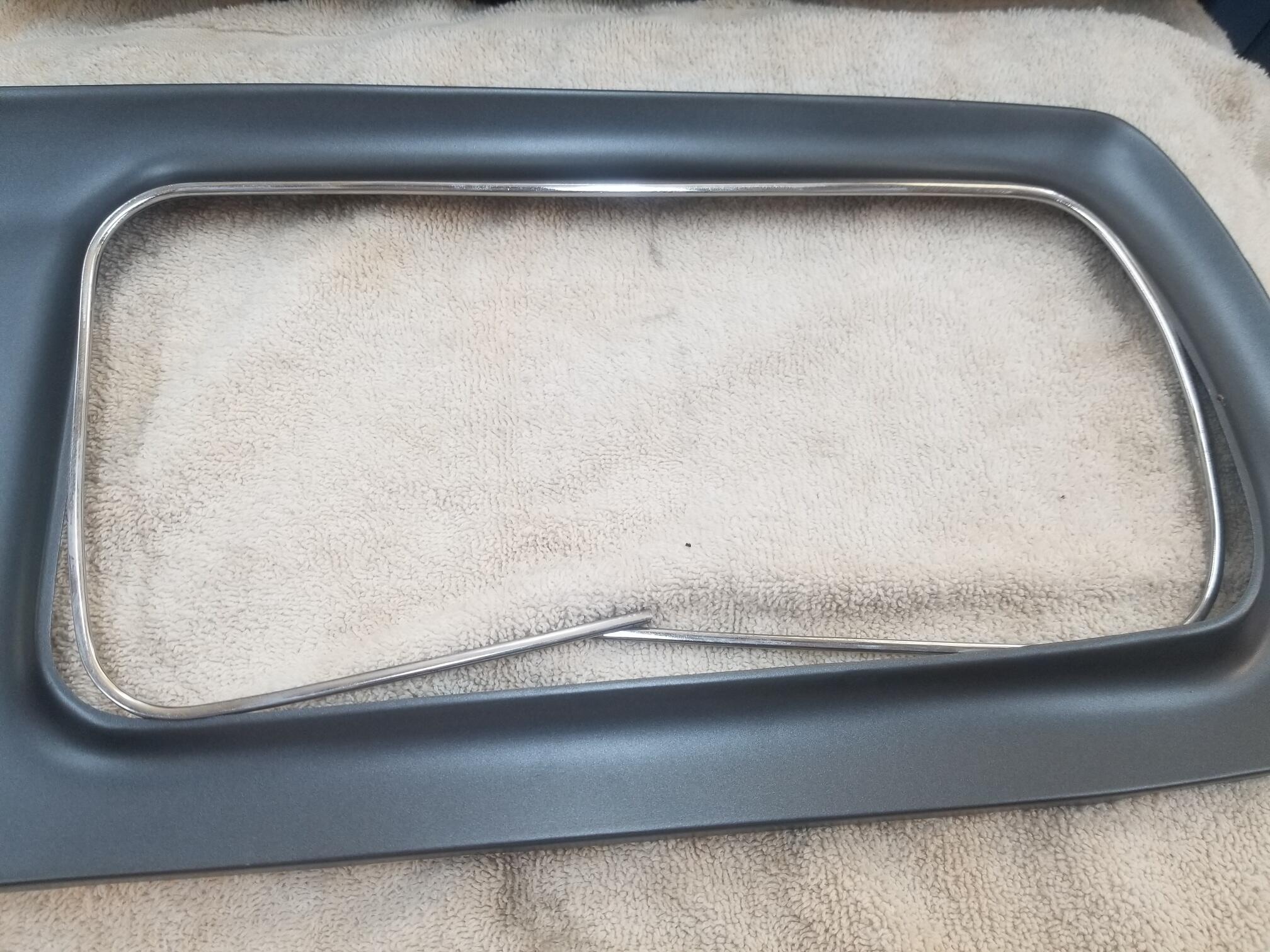

October 10, 20231 yr Author Popular Post comment_658030 I put the trim back on the rear finishers For the most part it went on by hand. I tapped it a little with a soft rubber mallet. Thanks so much to Jim for the excellent recipe! @jfa.series1 Link to comment https://www.classiczcars.com/forums/topic/55369-1971-hls30-14938-lily-build/?&page=64#findComment-658030 Share on other sites More sharing options...
October 10, 20231 yr Popular Post comment_658031 2 minutes ago, Patcon said: I put the trim back on the rear finishers For the most part it went on by hand. I tapped it a little with a soft rubber mallet. Thanks so much to Jim for the excellent recipe! @jfa.series1 Awesome work Charles. All the credit for the paint products selection goes to @CanTechZ who did all the testing to make this possible. Link to comment https://www.classiczcars.com/forums/topic/55369-1971-hls30-14938-lily-build/?&page=64#findComment-658031 Share on other sites More sharing options...

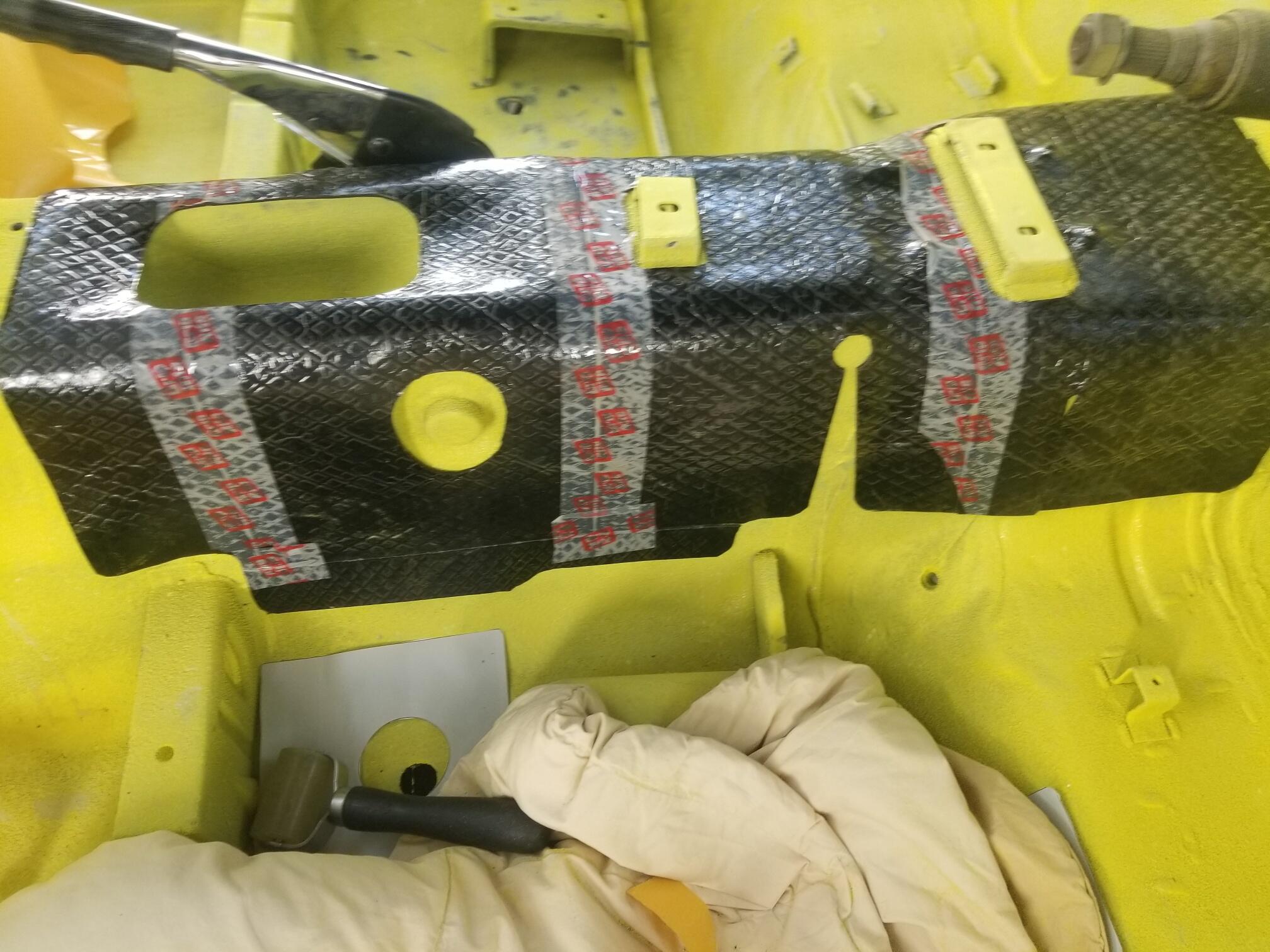

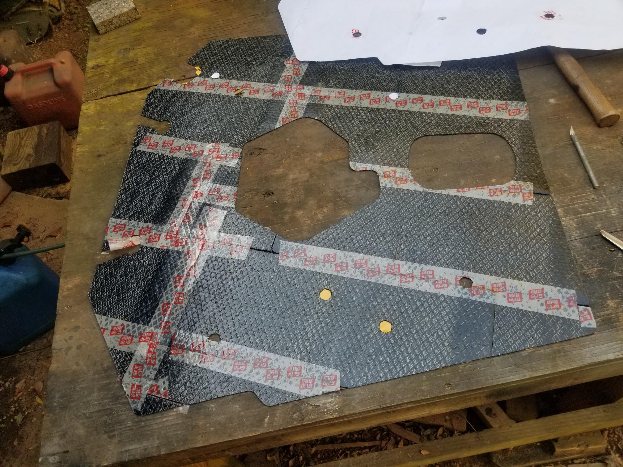

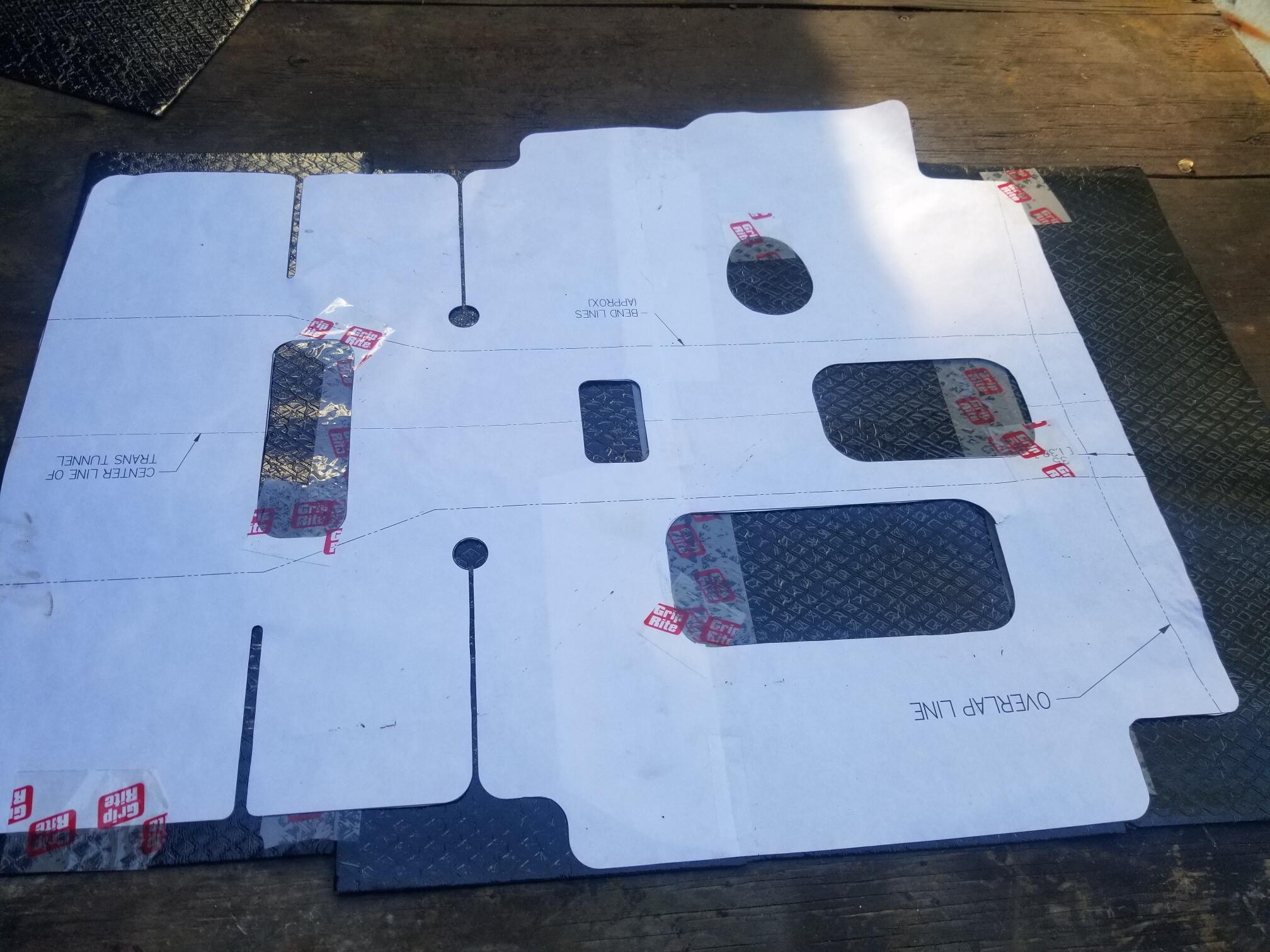

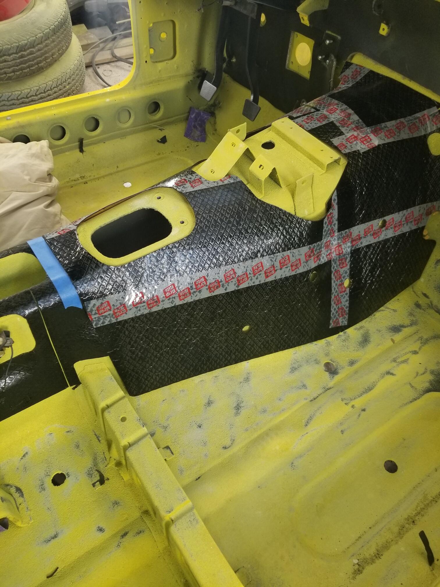

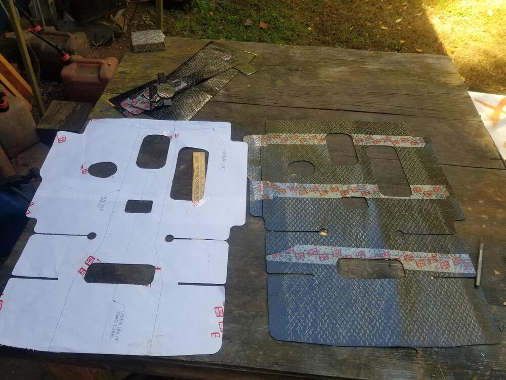

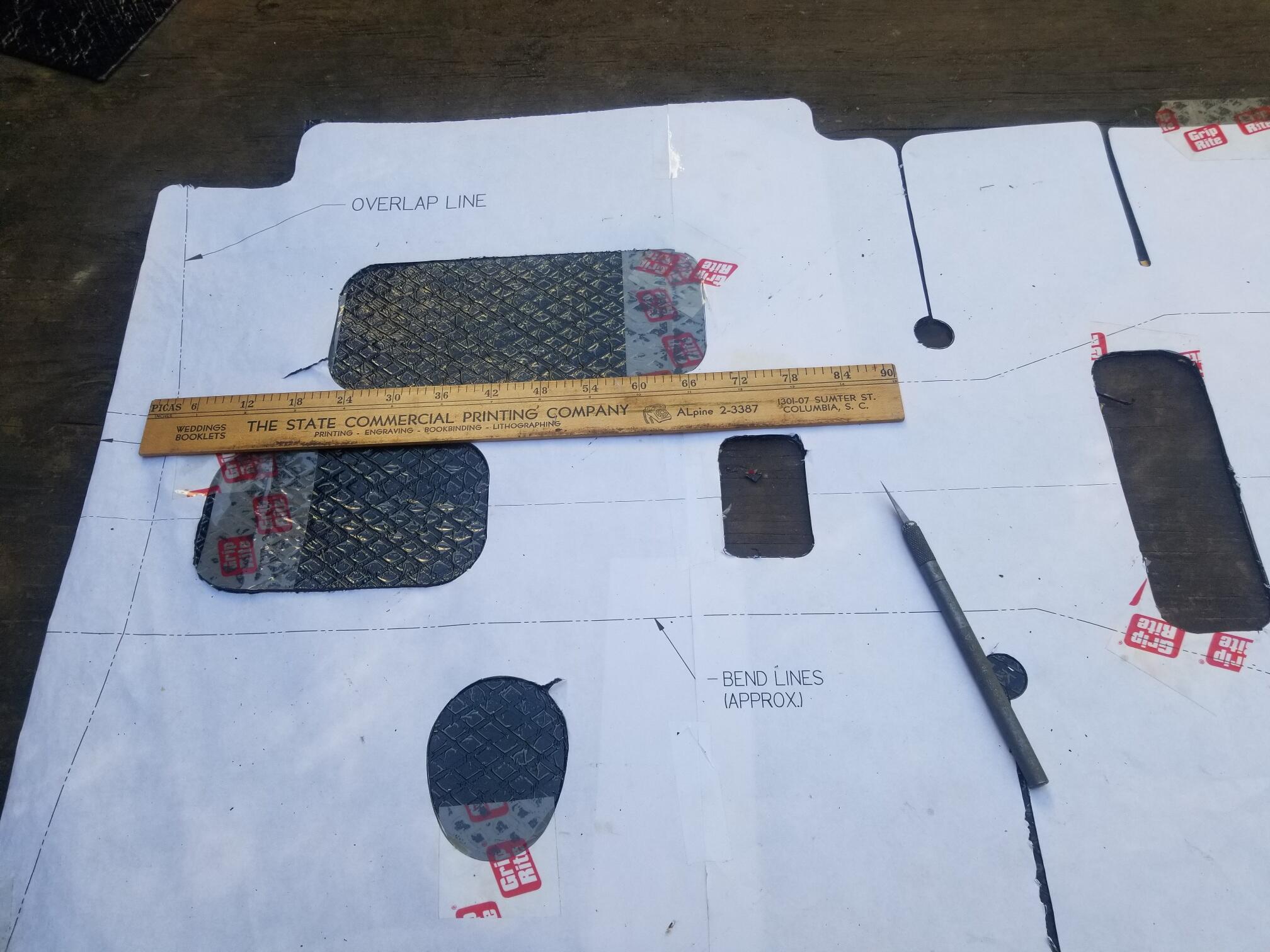

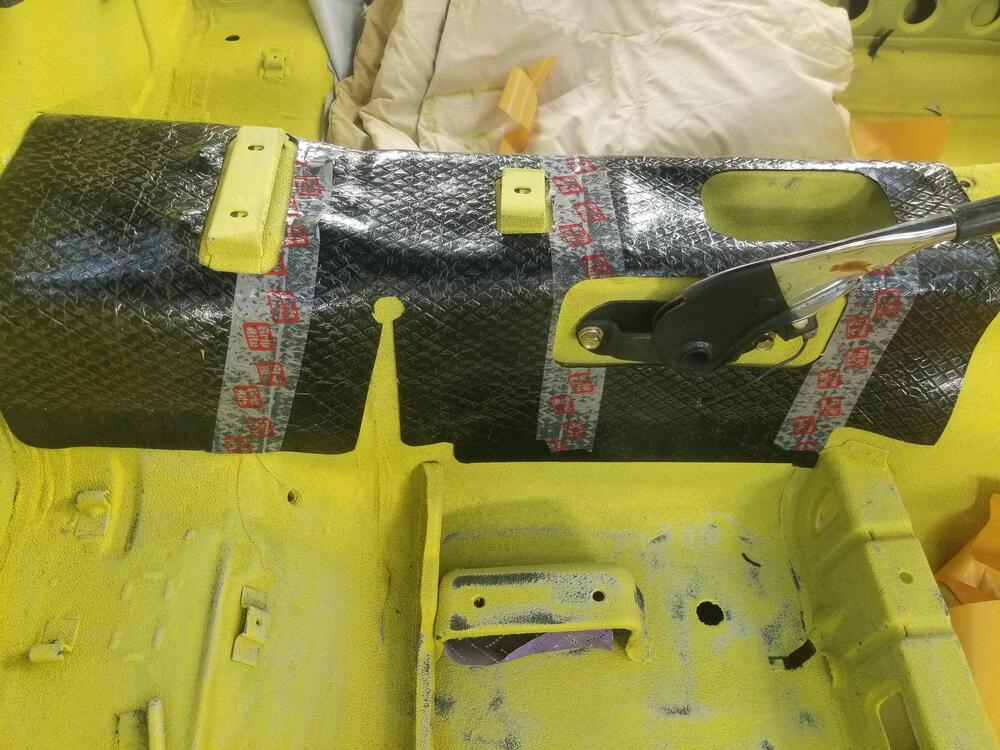

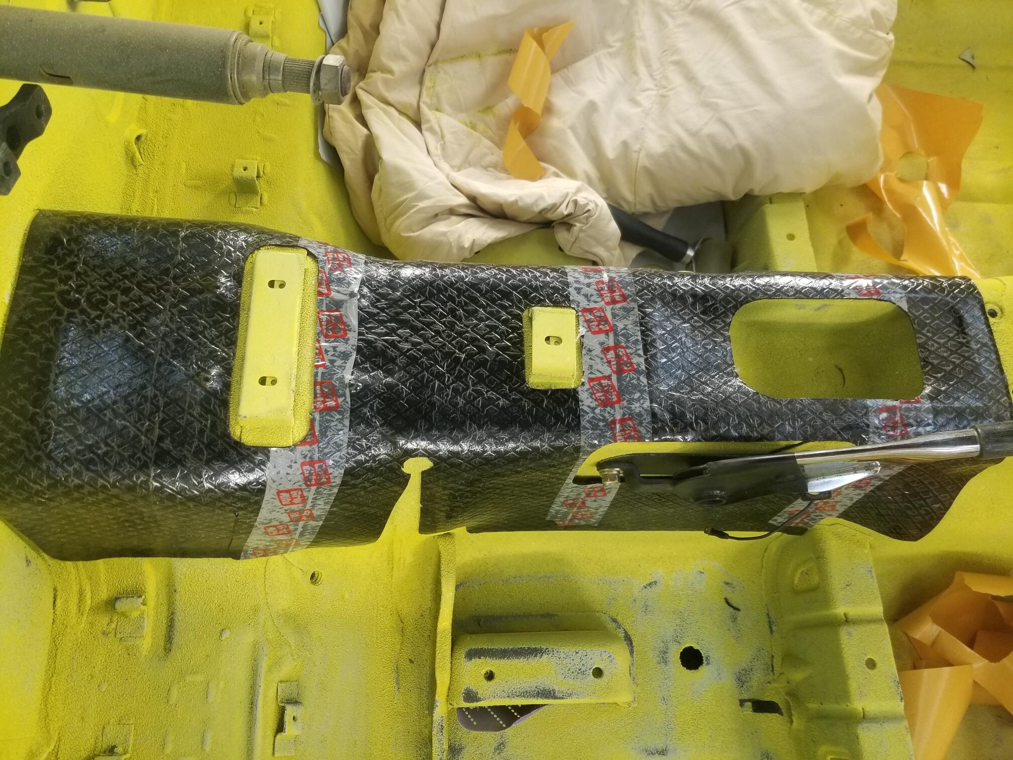

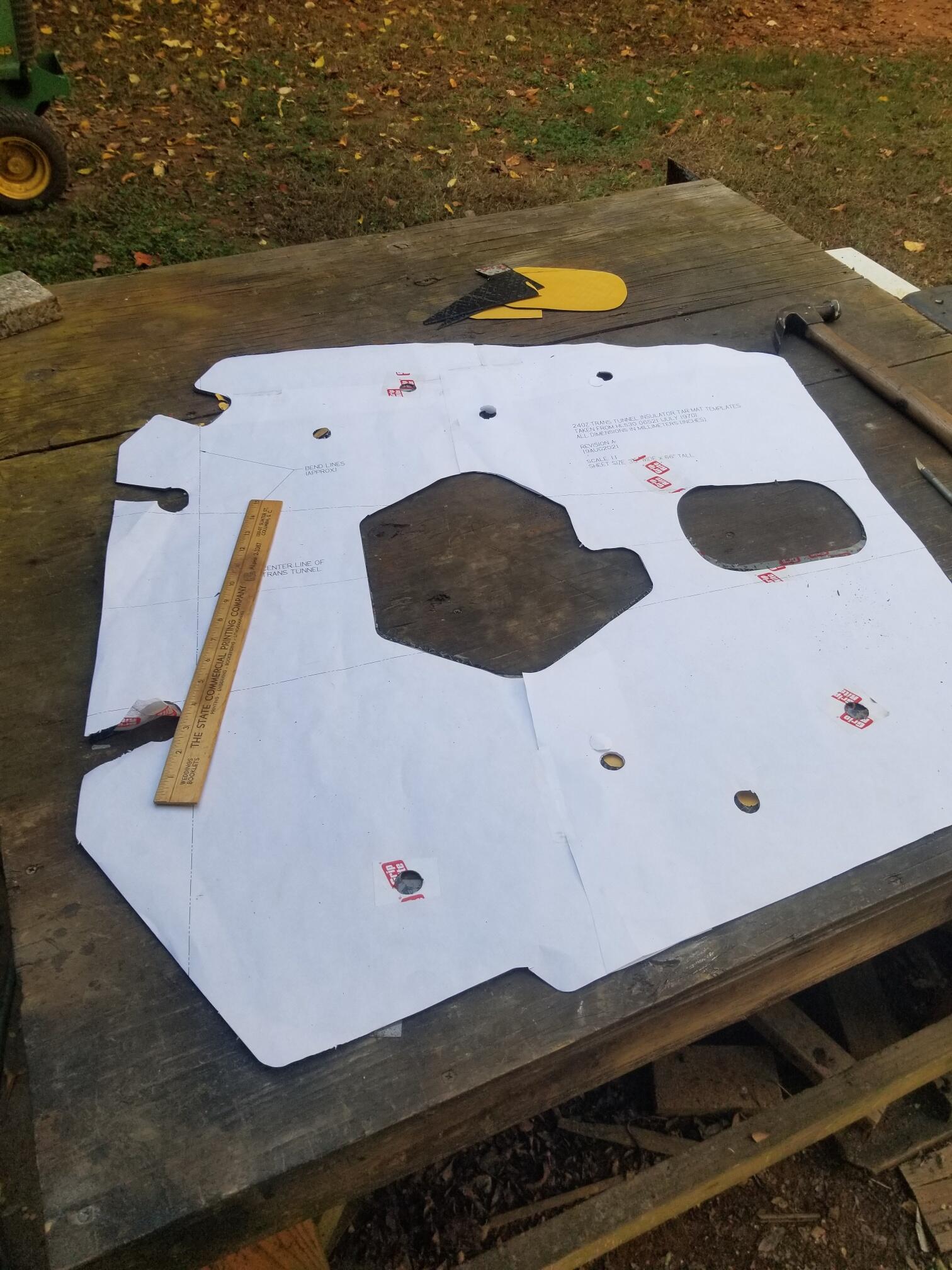

October 29, 20231 yr Author Popular Post comment_658807 So I worked on tar mat some. I used the Wurth tar mat @Zup recommended in another thread. One box is just enough to do the tunnel. I will have to get some more later for the floor boards and hatch floor. The patterns I used are in the resource area Here is the rear pattern over the mat. I layed the mat out and used some clear tape to seam them together. Then I used a few pieces to tack the pattern down. I used this ruler that has a brass edge to help on the long straight cuts. Everything else was freehanded All cut out This is installed. I have that roller tool to get it stuck down properly. The film on top has been peeled since then. I didn't take any pictures of that This is the larger front piece I had to scrap out some areas on this. If I were going to do this again, I would be more selective on where I used the scrap. My scrapped out section was near the top edge of the tunnel and that made it difficult to hold together on install. I used a blue tape line to mark the overlap point Edited October 29, 20231 yr by Patcon Link to comment https://www.classiczcars.com/forums/topic/55369-1971-hls30-14938-lily-build/?&page=64#findComment-658807 Share on other sites More sharing options...
