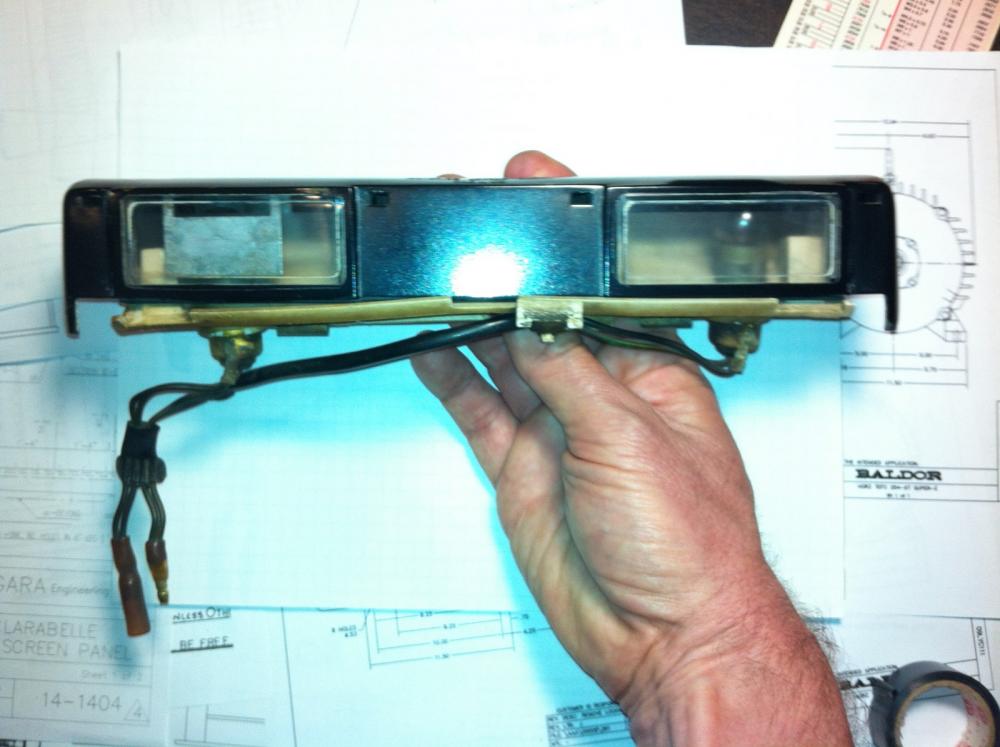

I'm in the midst of 'restoring' the license (licence?) plate light assembly for my 70 Z.  For those familiar with these units, you'll know that many are heat-damaged so that both the outer shell (black plastic) and the inner base plate (white plastic) sag and no longer seal well, esp. along the top seam and despite the rubber gasket.  The illumination is, of course, provided by two #89 bulbs.  These apparently generate enough heat during long periods of lights-on driving to cause the plastic pieces to soften and deform.  The housing assembly is 98% sealed (there are four small, open drain holes on the bottom surface of the outer shell) to keep out water, with the reverse effect that it seals in the heat.  I have a couple of questions for anyone who's tried to remedy the situation:
  1. Clipped inside the black outer shell are two zinc-plated, stamped-metal insert plates.  They fit over the clear-plastic 'lens' surfaces on the left and right side of the shell, such that they block the center 70% of the lens, leaving only the sides of each lens (and a little centre slit) open to light passage.  Some say that these metal inserts are to keep heat away from the clear-plastic lens, but I find this hard to believe.  Metal is a pretty good heat conductor and these things sit right on top of the clear-plastic lens surface, so how they act as heat protection is beyond me.  My guess is that they're actually installed as 'shades' because -- for some markets - Nissan decide that the fully-open clear-plastic lenses allowed too much illumination onto the license plate.  I'm wondering if they're possibly responsible for the excessive heat build-up inside the housing.
    Anybody know the real reason for these metal inserts being installed?  Were they also found in Euro-market or Japan-market Z's?

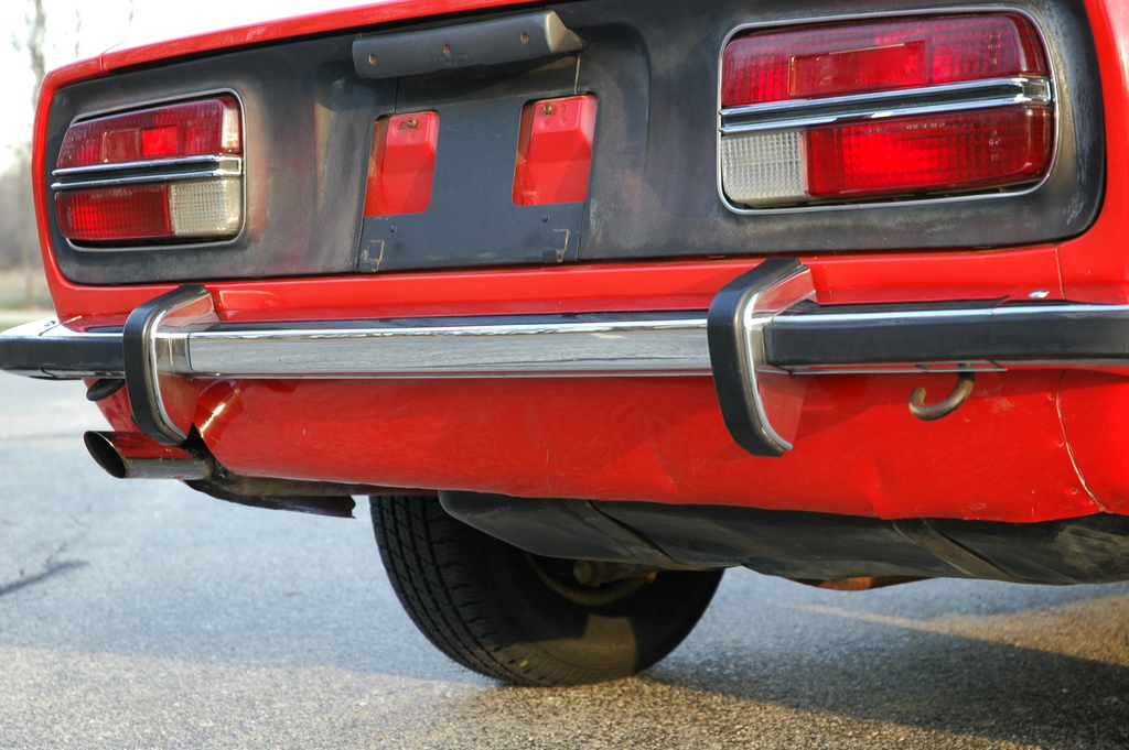

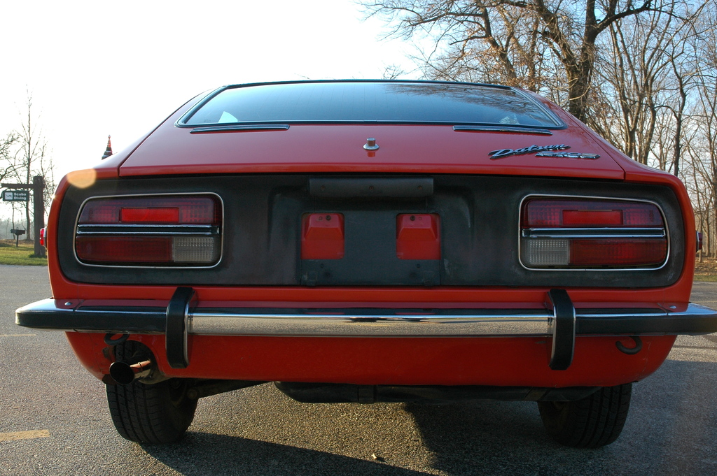

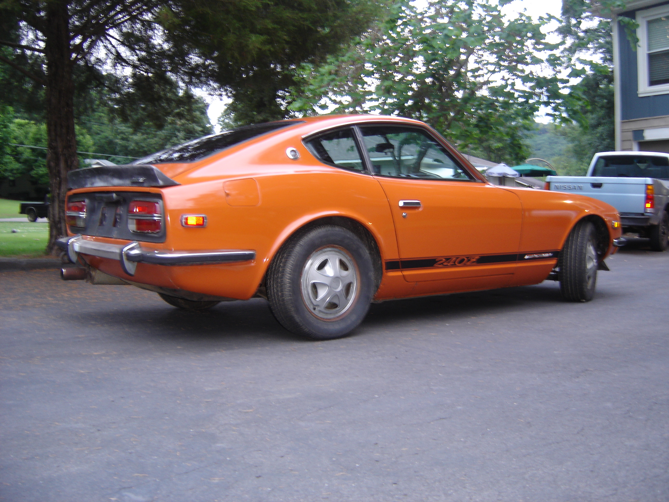

I painted mine back to the graphite color when I bought it.  It was painted black as was the finisher.  I've always thought the dealership did it when they put the black rocker stripes and the black spoilers on.  The reason for thinking that is behind the tag is the only part of the car that's painted black, like they didn't pull the finisher off.  Just taped off the lights and stainless strip and sprayed it with no tag.  My other 240 is the body color behind the tag, not black.
I think that metal is to keep the bulbs from melting the clear lenses, my guess. :)
Here's a picture from the day I got it home.  You can see the black where the tag holder is.
Here's the other one;

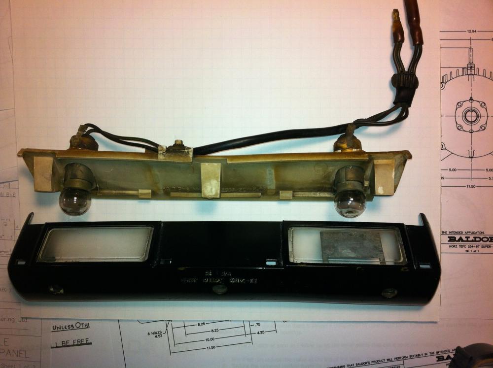

I decided to take my rear license plate for cleaning after reading your topic (and because I have been planning to) and I found something interesting.  My license plate light has only one "metal shade", on the left side, and that side is noticeably more deformed from heat build-up than the right side. I think your theory about heat build-up is correct. Here are a few pictures of mine:
Great photos, CanTechZ.  Couldn't have asked for a better real-world illustration of the (good) possibility that those metal inserts have nothing to do with heat protection and, in fact, create the opposite effect.
Auto manufacturers never spend money on parts that don't have a purpose.  These insert plates look like they were designed to be installed only in particular situations.  Otherwise, the housing looks perfectly happy (very happy, in fact) to have them left off.  My theory is that the plates are shades and were only installed for markets where there was some government-enforced limit on the amount of illumination that could be used on the rear of a vehicle above and beyond the left and right 'running lights' (brake and turn signal lights don't count, because they're occasional and short-duration).   It will be interesting to see if anyone from Europe (or Japan) reports that their lamp housing does not have these insert plates.

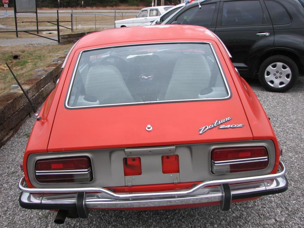

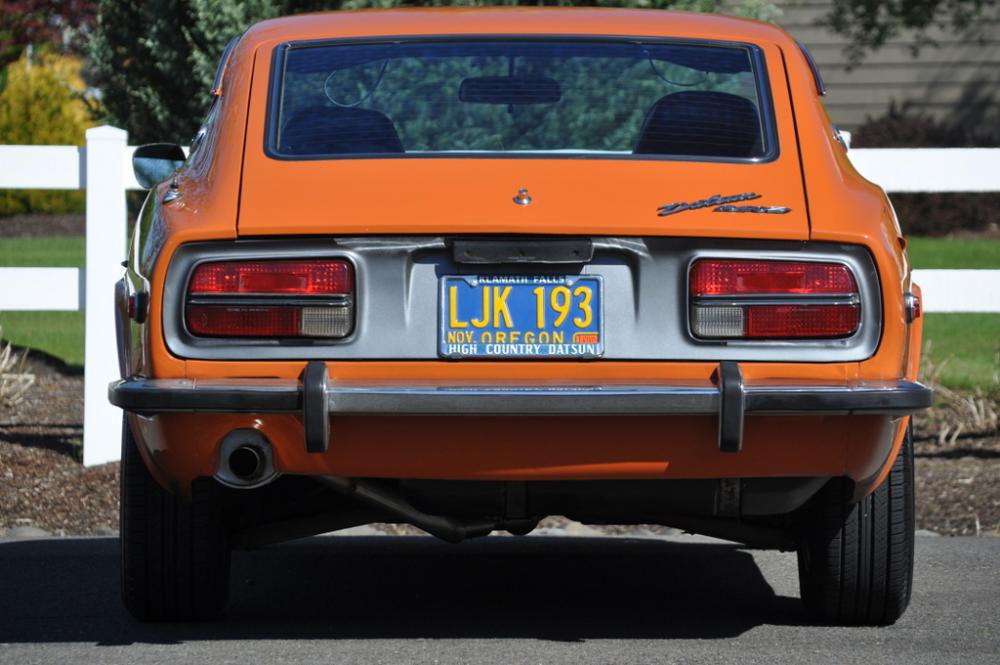

Regarding colour treatment for the black-plastic housing cover (i.e. should it be left as plain black plastic or painted to match the rear finisher panels?), I'm still perplexed by photo of this apparently-unmolested '70...
Looks grey to me.

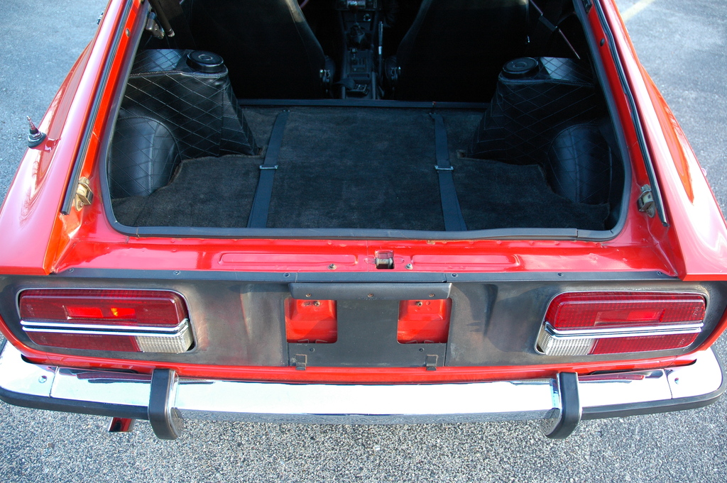

Here's a different Z that was recently up for sale.  In this case, the license plate light housing appears in basic-black, unpainted condition.  To my eye, it just doesn't look right.
5 hours ago, Namerow said:
More on the topic of black vs. grey...
 IMO, License plate light cover should always match the color of the rear panel regardless of the color. This combination looks like a black fender on a silver car.
