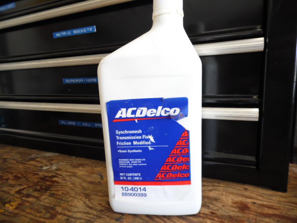

Had a notchiness in 1 to 2 shifts on my low mileage trans.
Decided to try Royal Purple as that was all I could find as "upgrade" locally.
No change.
Changed to Redline after ordering it from online as it was the one that was supposedly much better.
No change.
Enter A/C Delco Friction Modified-----kaaaazzing-----we have a winner!!
~$32.00 for three quarts----some of the best "bang for the buck" money I've spent on the Z. Notchiness is gone --all shifts are much smoother.
Spend the money on it and be done with it for years to come-----enjoy the benefit with every shift!!!
HIGHLY RECOMMENDED AAAA++++

 Thanks @Zup. Don't have my Z on the road yet to try it. You can bet the A/C Delco FM oil is what is going into it tho. I'll use it in the RX7 too.

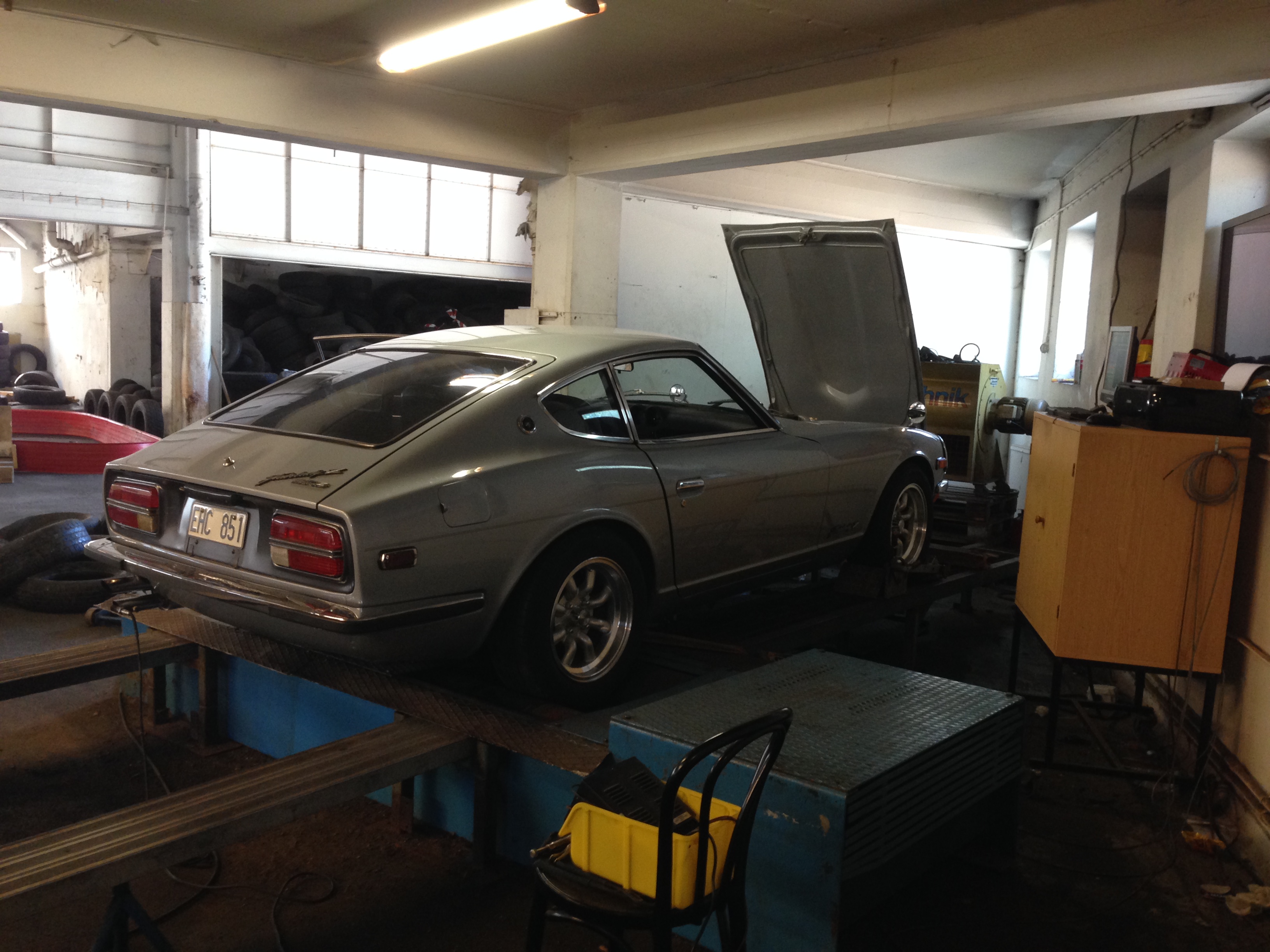

Dyno tuning has been done!
had almost the "perfect" settings in timing and carbs.
 We had to changed the air jets to 160 instead of 155 to make it a bit leaner. That made a difference as it now makes power all the way to 6800 rpms before it flattens and dropps at 7100.
Now to the Sad part. Something made the dyno read to much horsepower (366 engine hp) when i let of the gas at 7000 rpms (to much resistance said the dyno guy) could depend on bad bushings or something else?? Don't know?? He dident either.
Problem only occurred when I let of between 7000-5500 rpms after that it was normal.
But I will have a go at another dyno this week or next. A dyno that connects to the hubbs this time (No rollers), that should give me some numbers.
So now to what he calculated the hp to. And this is just what he estimated it to with the data that was accurate. Around 220-240 Engine hp.
Well we will know in a week or two.
