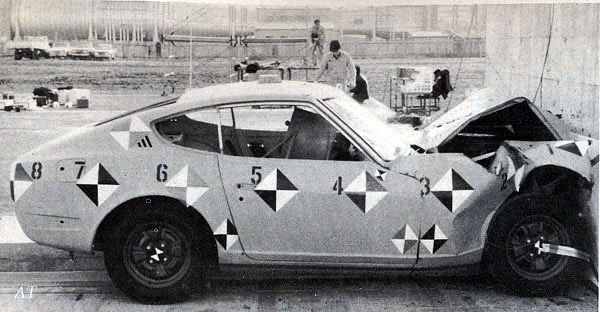

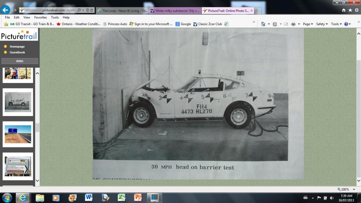

Crash test results for the Z.  One by Nissan, pre-production.  The other by U.S. government testers.  Both, I believe, at 30 mph.
