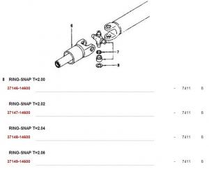

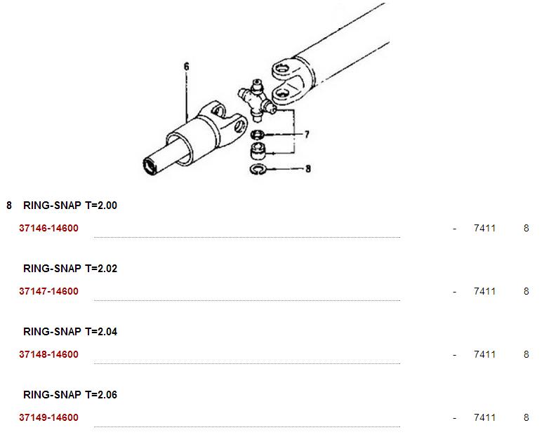

EuroDat Posted July 28, 2015 Share #2 Posted July 28, 2015 (edited) Balancing wouldn't hurt, but if the vibration wasn't there before you changed the U-joints, something is out of alignment since the change. Did you check the clearance in the U-joints? There are Snap rings available from 2.00 to 2.06mm to get the clearance within specs. If the clearance is excessive then the propeller shaft be of center and vibrate. TWhen I did the u-joints they were delivered with standard 2.00mm snap rings. After fitting them I put the yoke in the bench vice and tapped the other side with a rubber mallot to get all the cups out against the snap rings. Measured the movement with a dial indicator and divided that by two. They ended up at 2.04mm on both ends of the propeller shaft and the diff flange. The transmission yoke needed 2.06mm IIRC. It doesn't sound like much, but it could be enough to cause the vibration. Edited July 28, 2015 by EuroDat Link to comment Share on other sites More sharing options...

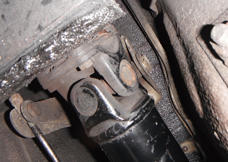

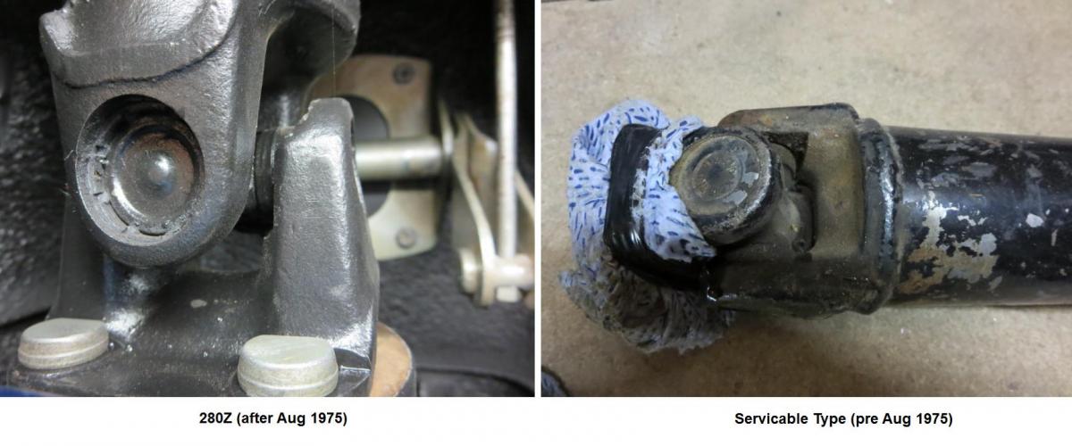

Stanley Posted July 29, 2015 Author Share #9 Posted July 29, 2015 Are these replaceable? Don't see snap rings. Thought they were up to 1975. Link to comment Share on other sites More sharing options...
EuroDat Posted July 29, 2015 Share #10 Posted July 29, 2015 Yep, They are servicable per Aug 75 type. The snap rings are on the inside and hard to see. If it was the non-servicable type you would be able to see the spurs pushed in on the outside to hold the cups in place. Link to comment Share on other sites More sharing options...

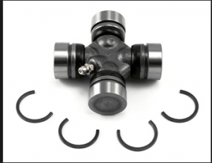

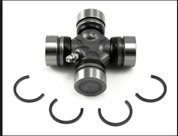

Stanley Posted July 29, 2015 Author Share #11 Posted July 29, 2015 OK, picture worth 1000 words. But the new Moog U-joints I bought have the snap rings on the outside. Will the still work? Link to comment Share on other sites More sharing options...
Zed Head Posted July 29, 2015 Share #12 Posted July 29, 2015 External clip u-joints typically have the groove for the clip machined in to the yoke. The Nissan type, internal, have a flat machined in to the yoke fro the clip to sit on, but the groove is on the u-joint bearing cup. So they're not interchangeable. Stole a picture from the ZStore below. I'm with zKars, I think that your first shop may have sent you off on a wild goose chase. May also have screwed something up. Probably started here - "This was after I reported various noises that started after they installed new front pads and turned one rotor. The noises just got worse after they worked on it again, and the vibration started soon after." Link to comment Share on other sites More sharing options...
