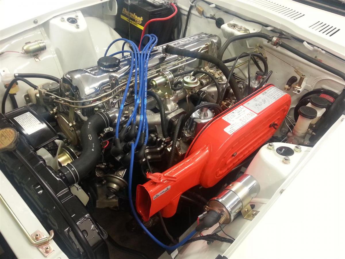

I finished my engine transplant with a 280zx/P79 with a stage II cam and wanted to keep it all looking original and I am wondering if the stock air box is limiting air. I  do have a K&N filter installed to help. Any thoughts?

Good to see another 280zx engine with SUs! That's a beautiful engine bay.
I'm running a Stage III cam, E88 head, K&N air filter. Seems to breathe wonderfully!

Thanks! I have seen Guys and yours looks great also! It was a great winter project. I have about 350 miles on the engine, I think after 500 I am going to drive it like I want. BIG difference from the 240 engine for sure.
