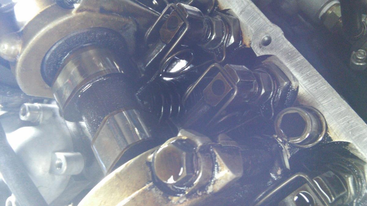

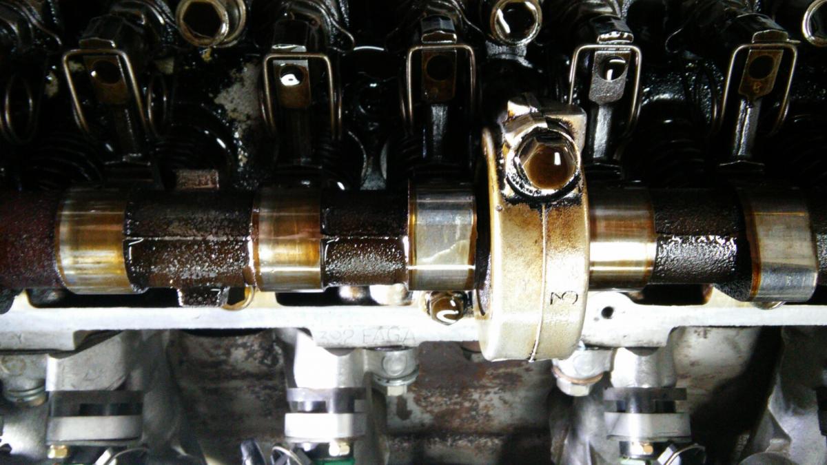

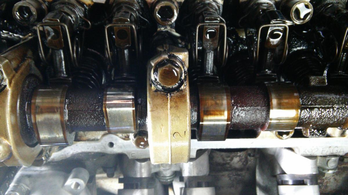

post-20387-0-30651400-1428960659_thumb.jpost-20387-0-26142500-1428960689_thumb.jpost-20387-0-82734900-1428960728_thumb.jI have nearly 101,000 miles on my "overhaul" I did in 91'. Rings, all bearings, valve seals, 3 angle grind, timing kit. Didn't have any major work nor did I have to replace any major engine parts. I have been using Castrol 20W50 since then and have no problems or signs of excessive wear here. Here are a couple pics of my cam.
My engine is stock BTW

I forgot to add some info. I change the oil every 3000 miles give or take a 100. Adjust valves twice a year. Have never added any additives.
