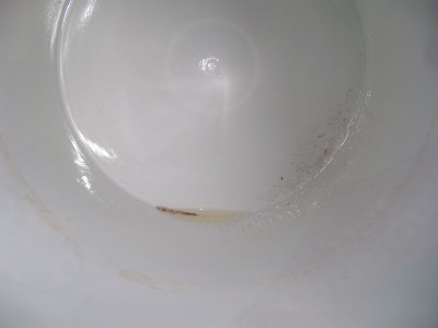

Electrolyte Bath
Although a 3-gallon set-up would be great, that was going to push the cost of the Caswell 'Part A' and 'Part B' chemicals pretty high, so I opted for the 1.5-gallon set-up instead.  That meant doing some head-scratching about bucket sizes and shapes, so as to get the most out of the fixed, 1.5-gallon fluid volume. I looked at three possibilities:  5-gallon pail, 2-gallon bucket, and std-issue dishwashing bowl.  I filled each with 1.5 gallons of water and then measured the resulting depth.  The floating bottle caps give you an idea of the results.  While the 5-gallon pail gives a couple of extra inches in diameter, it also produces a relatively shallow bath depth.  In the end, Mr. Happyface won.  It gives me a bath depth of about 9" and a diameter of about 10".  The dishwashing bowl is what I propose to use for plating bigger parts (haven't tried it out yet).  Note: I cleaned all of the bowls in advance (wiped down with alcohol) to make sure there was no parting compound or other manufacturing residue on the inner surfaces.
The Caswell electrolyte chemicals consist of a bag of lumpy power and a jar of liquid.  They need to be pre-mixed, after which you add 1.5 gallons of (distilled) water.  I used the 5-gallon bucket to do the mixing.  The Caswell 'Part A' powder also contains a lot of big white chunks of stuff (metal salts?).  The chunks eventually dissolves, but not right off the bat.  Before adding the Caswell 'B' liquid to the Caswell 'A' powder, I broke down all of the powder lumps (not to be confused with the chunky stuff) and picked out a few suspicious-looking bits of small stuff that didn't look like they belonged.  After adding the 'B' liquid, I used a (clean) spoon to mix the two together (creates a watery paste) and then I added the distilled water.  I mixed the water in thoroughly, using a paint mixing attachment (pre-cleaned with alcohol) in my cordless drill.  The result is a kind semi-opaque, brownish liquid (which eventually turns clear).  I did all this mixing on a Saturday evening and just put the lid on the bucket before calling it a day.  Not sure whether the white chunks had fully dissolved at that point, but when I came back to the job the next day, the mixture had turned clear brown and there was nothing at the bottom other than a bit of undissolved debris...
I poured the liquid into another (clean) 5-gallon bucket, using a coffee filter to get rid of the debris.  Then I poured the filtered liquid into Mr. Happyface.  More details and pix tomorrow.
