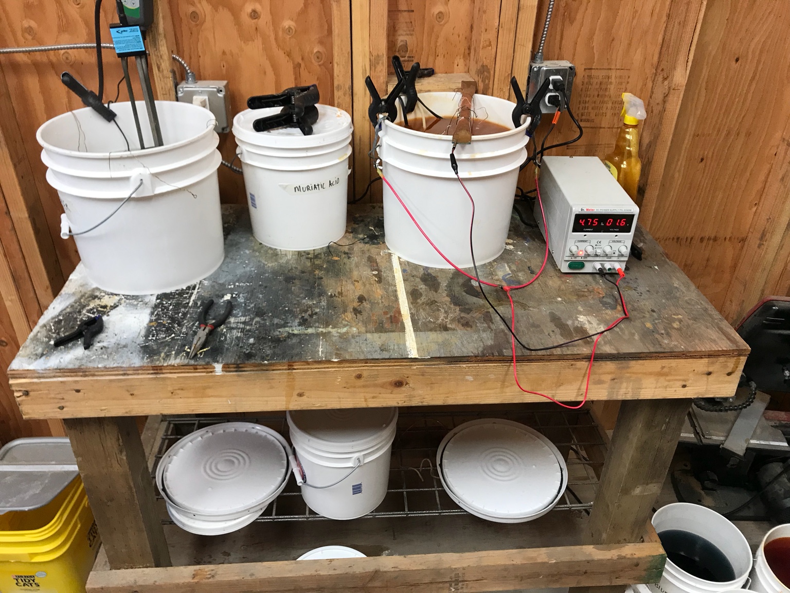

I thread all polished hardware on to 18g brass wire. I found that other materials are unpredictable and left pieces in the same soak dull
Then dip in muriatic acid 50/50 distilled water until it quits fizzing.
Rinsed in distilled bucket
Per Joe Newsom
Let hang into degreaser at 120 degrees until ready usually about 15 min.
Load into zinc tank. Which is constantly heated to 75 degrees with one of submersible heater for fish tank. Loads were calculated to run at 5 amps the max my rectifier will do, for 15 min.
Trying to remember to rotate in middle of load became challenge.
Dipped into Blue Chromate for about 5-10 seconds
Dipped into Yellow Chromate for about 15 seconds
Yellow chromate I mixed myself using 10 oz of sodium dichromate which I bought cheaply on eBay and 1 oz sulfuric acid ( battery acid) to one gallon of distilled water.
All other products were bought at Caswell
Hope this helps. I really noticed the difference in the properties of the zinc by adding brightener at the beginning of each day I was going to zinc. Noticeably different outcome when I didn’t add it in the beginning of my day.

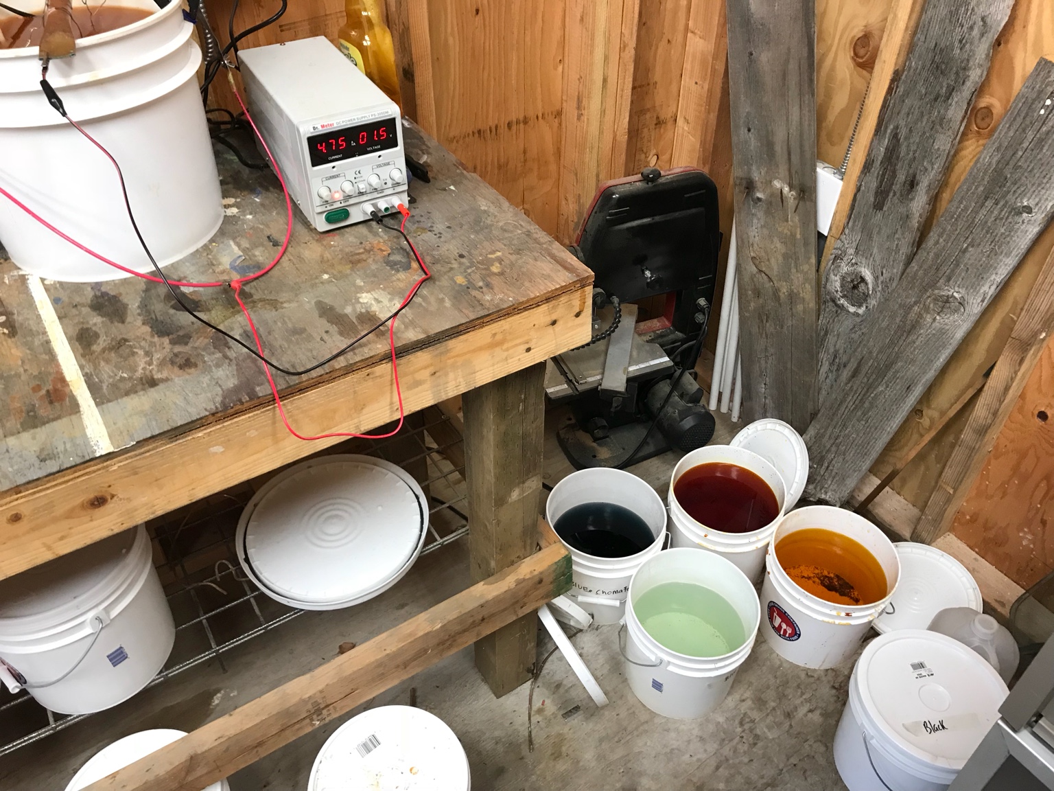

Here are some pics of the set up. It is not much to let look at but it works for me. IMG_4476.JPGIMG_4477.JPG

Now if we could just figure out a DIY for the Blue Chromate. It is pretty expensive and  would allow for a larger dipping tank...
Good write-up.  Thanks for taking the time.
Not much difference in your methodology vs. mine, except for four things:
  • Use of brass wire:
    Your comment about this making a difference is intriguing (although not intriguing enough to make me drag out all my chemicals to try it out).  It would seem to be a matter of net conductivity at the contact point(s) between the wire and the part.  I used copper wire (should be better  than brass).  Not sure that it was a determining factor in the quality of my plating, but seem to have observed a difference with brass vs. 'other' (steel?).
  • Batched jobs
    I had miserable luck trying to plate multiple pieces at once.  Too much difference from one part to another, so lack of reliable way to control for best net result.  I adopted an approach of max. 2 parts at a time.  Took forever, of course.
  • Current setting
    Many detailed write-ups on zinc plating specify a current setting based on the immersed surface area of the part(s) being plated.  Current set to high = fluffy/flaking zinc over-deposit on the part.  Current set too low = long plating times or minimal plating activity.  I have a notepad full of surface area calculations.  You seem to have gotten away with a 'let 'er rip' approach, by just cranking your power supply up to max and putting as many parts as will comfortably fit on your wire.  Is so, I am in awe.
  • Yellow chromate
    I used Caswell's stuff.  Your DIY formula is interesting, but I don't think the yellow chromate dip is the determining factor in the end result.  Nor the blue chromate dip.  Instead, it's the quality of the zinc plating job that, in my experience, determines the quality of the final finish.  The chromate dips embellish a good zinc plating job, but they won't rescue a badly plated part.  In fact, they just exaggerate any deficiencies.
  • Zinc
    I used 'MossBoss' roof flashing.  It's an uncoated, thick zinc foil.  I lined my electrolyte bucket with it.  Although not shown in your photos, it appears that you used Caswell's zinc plate and hung it on one side of your bucket.  In theory (emphasis on 'theory'), my approach should be better because it reduces the directional effect.
Things we've done the same:
  • muriatic acid dip
  • distilled water dip between every stage of the process
  • Caswell chemicals for the electrolyte bath
  • Caswell brightener added on a regular basis (with notable effect)
  • heated degreaser bath (I used an ammonia/water/TSP solution in a crock pot -- I think you used the Caswell stuff)
  • heated electrolyte bath (I think I ran mine a bit hotter than yours... maybe 100 degrees F)
  • size of electrolyte tank (mine bucket might be about 10% smaller in depth and diameter)
The main things I had problem with were:
  • hyper-sensitivity of end results to the prep and cleaning of the parts.  Once a part displayed a 'flaw' after initial plating, I had to take it right back to the sandblasting stage to get rid of the problem.  Wire-wheeling and acid-dipping wouldn't get rid of it.
  • irregular plating over large surfaces (e.g. timing chain inspection cover) and parts with bends (e.g. brake line clips)
  • inability to get satisfactory results when trying to plate multiple parts in on go
Edited by Namerow
