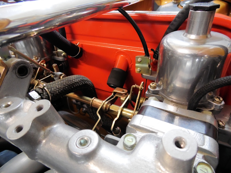

April 22, 20169 yr comment_493337 Cliff, I presume the hole your referring to is a short tube on the backside of the filter box, pointing down. If so, that was previously for the air pump. You don't want any open holes on the filter box other than the snorkel else you will be getting unfiltered air, dust, ...etc. pulled into the carbs. I plugged that hole with a 7/8" rubber cover for a chair leg from a big box store. I mounted the cover on a short piece of dowel, spun it in my drill and used sandpaper to change the shape down to a nice slim profile. Its a perfect fit, no tacky hose clamp required. Jim Link to comment https://www.classiczcars.com/forums/topic/50909-72-240z-rebuild/?&page=27#findComment-493337 Share on other sites More sharing options...

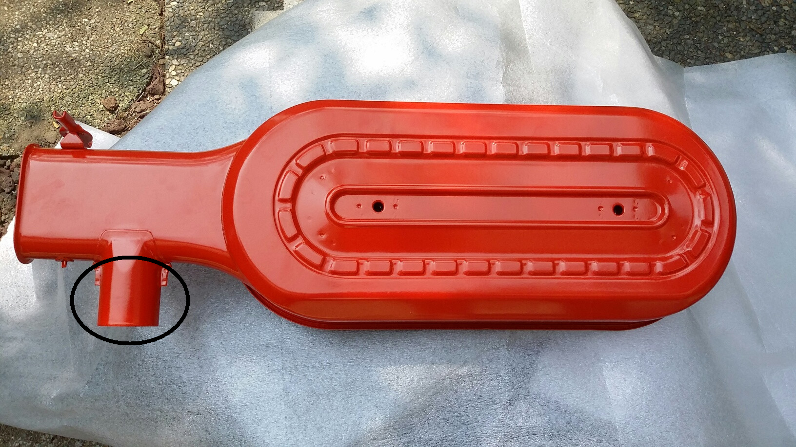

April 23, 20169 yr Author comment_493373 Thank you Mr Arnett, I have an ugly hose with a 3/8s to 1/4 adapter stuck in it. That chair stopper will be much better. Here's what I'm talking about though, Here's what I think I can use if I need to. I was thinking the more air the better so just put screen wire over the opening to keep the varmints out? Link to comment https://www.classiczcars.com/forums/topic/50909-72-240z-rebuild/?&page=27#findComment-493373 Share on other sites More sharing options...
April 23, 20169 yr comment_493377 Ahhh - that hole, sorry to mis-read your post. If you think about the OE configuration, that hole is always open so there should be no concern over air volume as the carbs will pull only what they need thru the filter. I've also got a header and left mine open, but then I don't have a potential varmint issue. Great looking finish on that filter box! Link to comment https://www.classiczcars.com/forums/topic/50909-72-240z-rebuild/?&page=27#findComment-493377 Share on other sites More sharing options...
April 23, 20169 yr comment_493379 That large round hole was originally connected to a hose that sucked warmed air off the exhaust manifold. I've always called it the "heat riser" connection. It's unfiltered at that point, so the only thing you have to worry about would be critters. However, if critters are looking for a warm spot to make a nest, they could simply crawl into the other oval hole at the end. Both those holes go to the same spot which is the dirty side of the air cleaner. Link to comment https://www.classiczcars.com/forums/topic/50909-72-240z-rebuild/?&page=27#findComment-493379 Share on other sites More sharing options...
April 23, 20169 yr Author comment_493380 I wish that was my air box! That's on down the road for me. 8^) Alright "Blind Mellow Jelly" we're thinking alike, heat riser it is. See post #316. "I want my daddies records" I'll put some screen on there just in case. Thank you Gentleman! Link to comment https://www.classiczcars.com/forums/topic/50909-72-240z-rebuild/?&page=27#findComment-493380 Share on other sites More sharing options...
