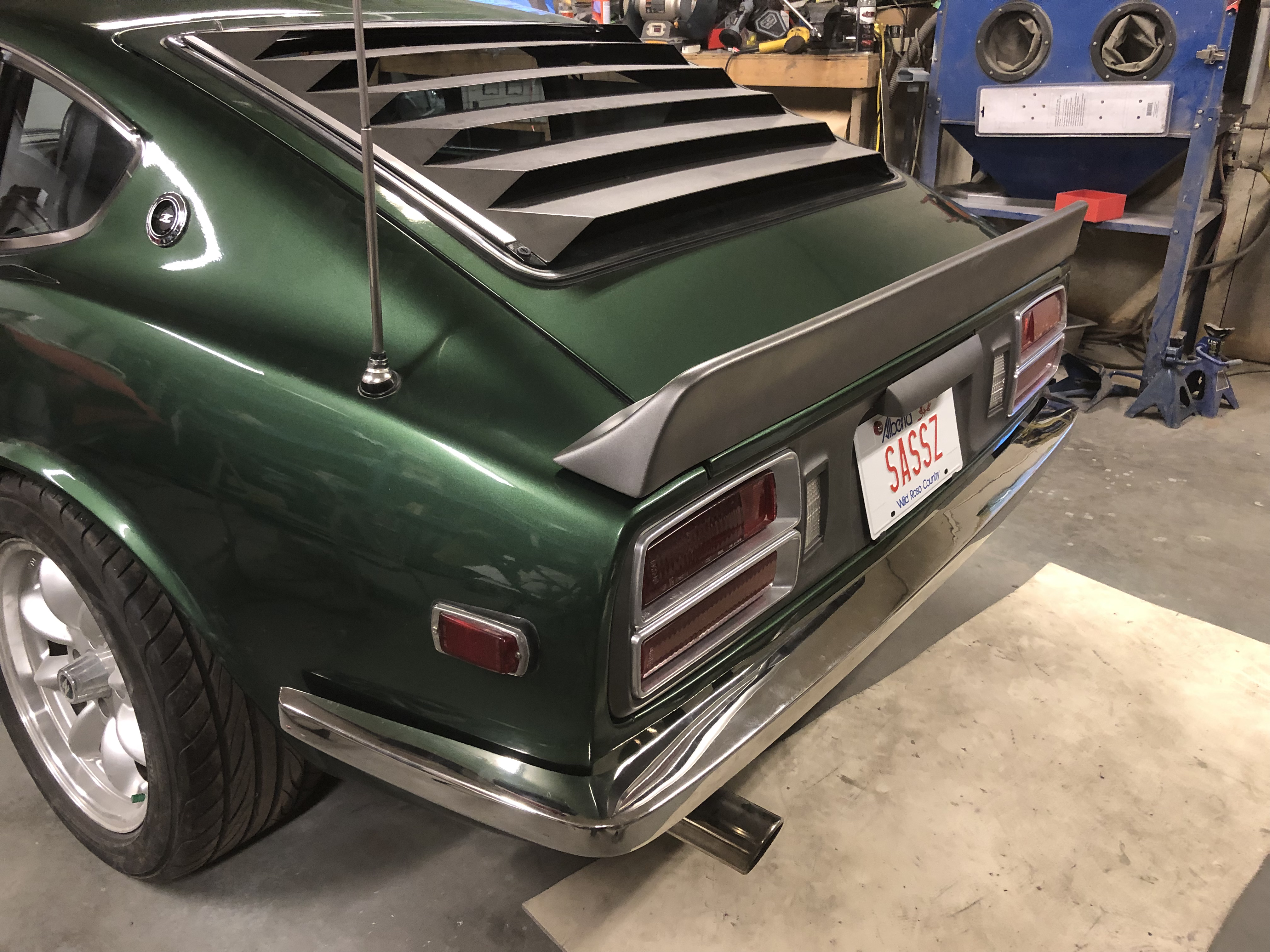

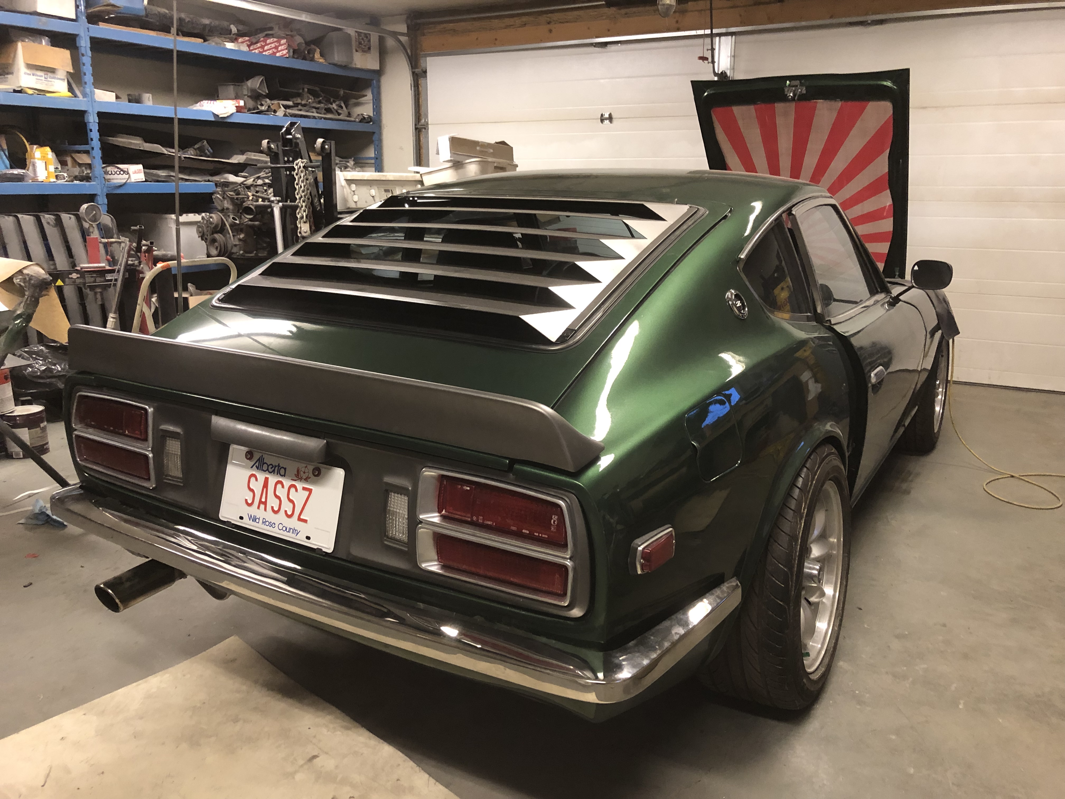

A bit of a milestone last night. Got the rear bumper mounted and the hatch spoiler finished.
I did the spoiler same as the taillight panels, matte graphite. I’m pretty happy with the look! The tall hatch seals spoil the overall finish but I hope they will settle in.
Mark, the louvers on the hatch, are they the kind held on with the inserts that slide into the rubber seal or the kind that use throw bolt hasp and hinges?
LOL, I have both kinds but the Interpart Louvers are on the car. They mount under the glass trim.
