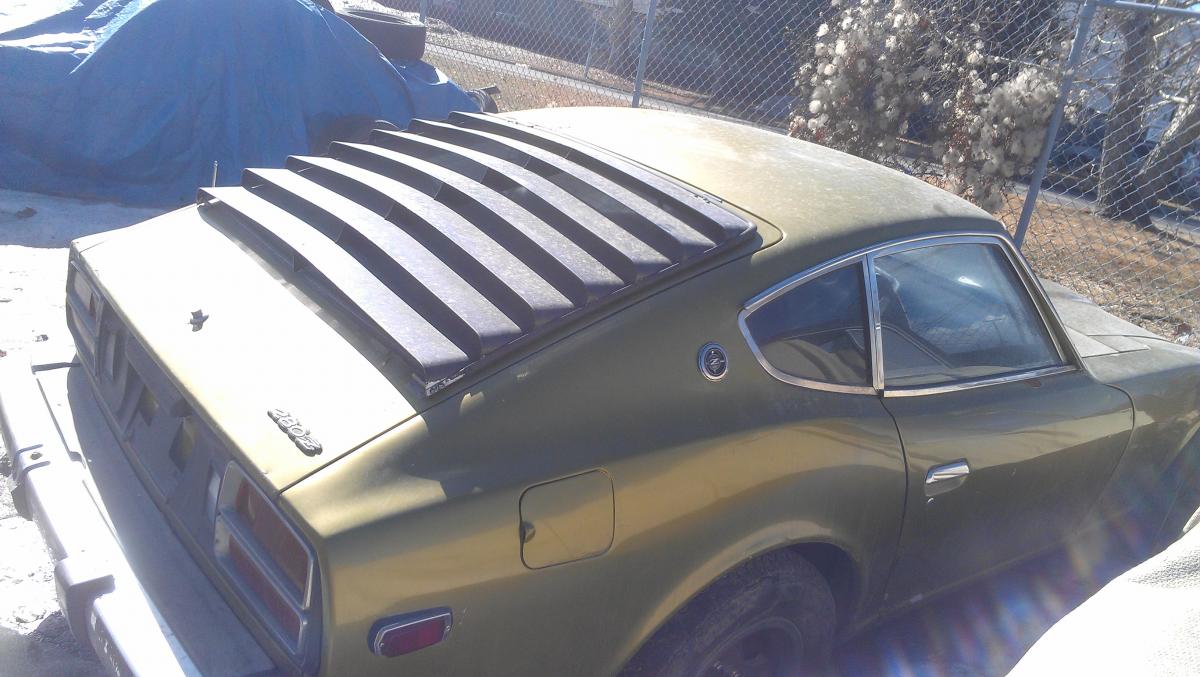

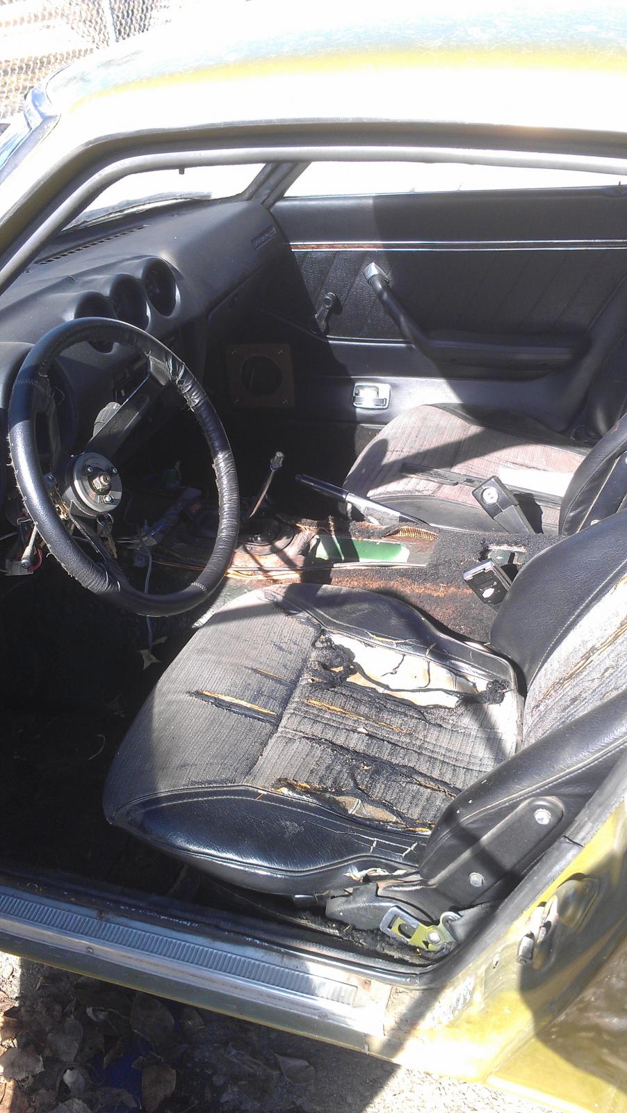

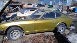

wheee! 1,884 Posted February 6, 2015 Report Share #1 Posted February 6, 2015 Hi everyone! My name is Mark and I will be restoring my 1976 280Z coupe HLS30-271295 starting this year. I look forward to your feedback and help as I am sure most of you have a lot of experience with restoring your own cars! I am hoping you will all chip in and help me avoid some common pitfalls and mistakes along the way. I will post photos and updates as I go. For now, these are pics of the day I picked up the car in Calgary in March of last year. 1 Link to post Share on other sites
