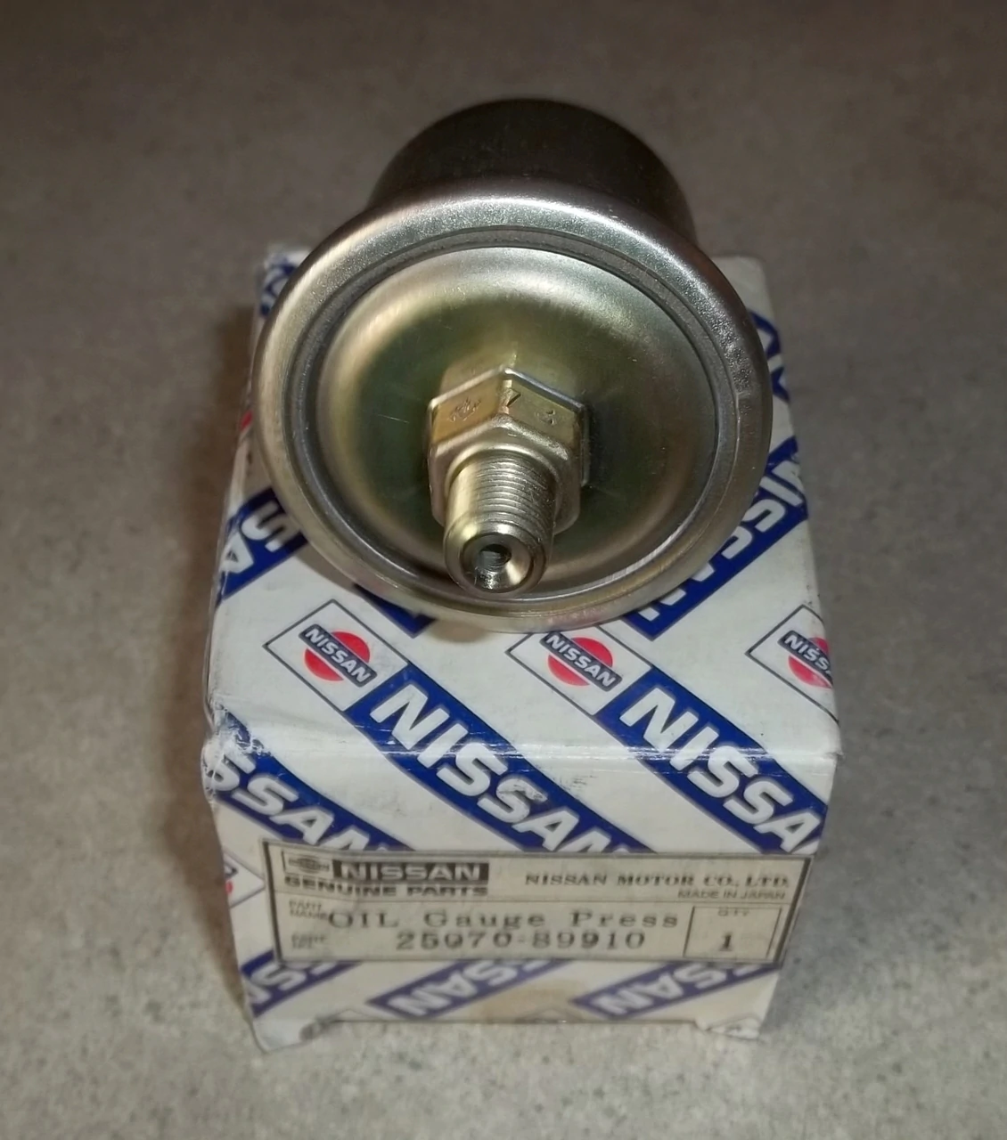

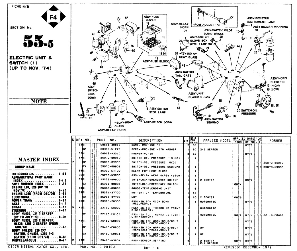

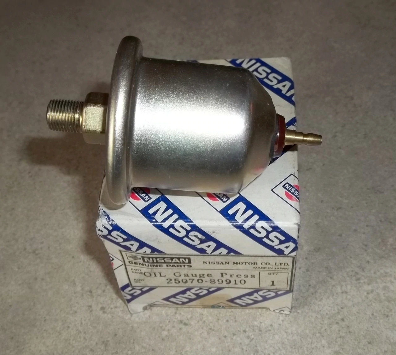

I replaced my series I oil sending unit PN 25070-89910 in 1979 with the correct 10 KG OEM switch and it stills seems to read OK on the 140 psi gauge. Attached is a parts page showing different PN's for the 10 KG and 6 KG units. Is there a date on shop instructions sheet that you have? Sorry I don't have any specs for the 10 KG sender.
Mike

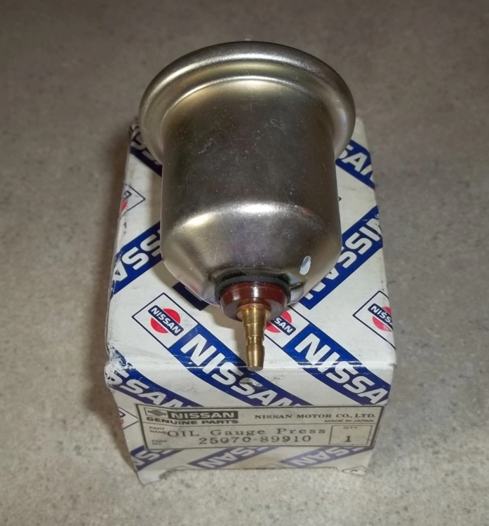

Sorry about that, good luck on your search on an NOS part, maybe you will get lucky. I did a quick search and saw this on ebay, no idea if this is a good vendor:
Vintage Nissan Oil Pressure Sender Part Number 25070 89910 | eBay
Sorry, just noticed it was an old auction, but at least they do come up, cheers.

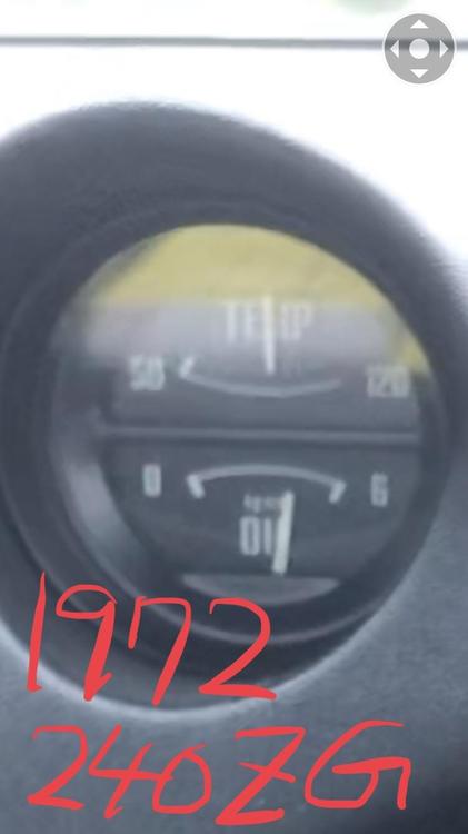

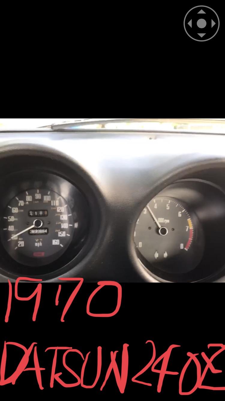

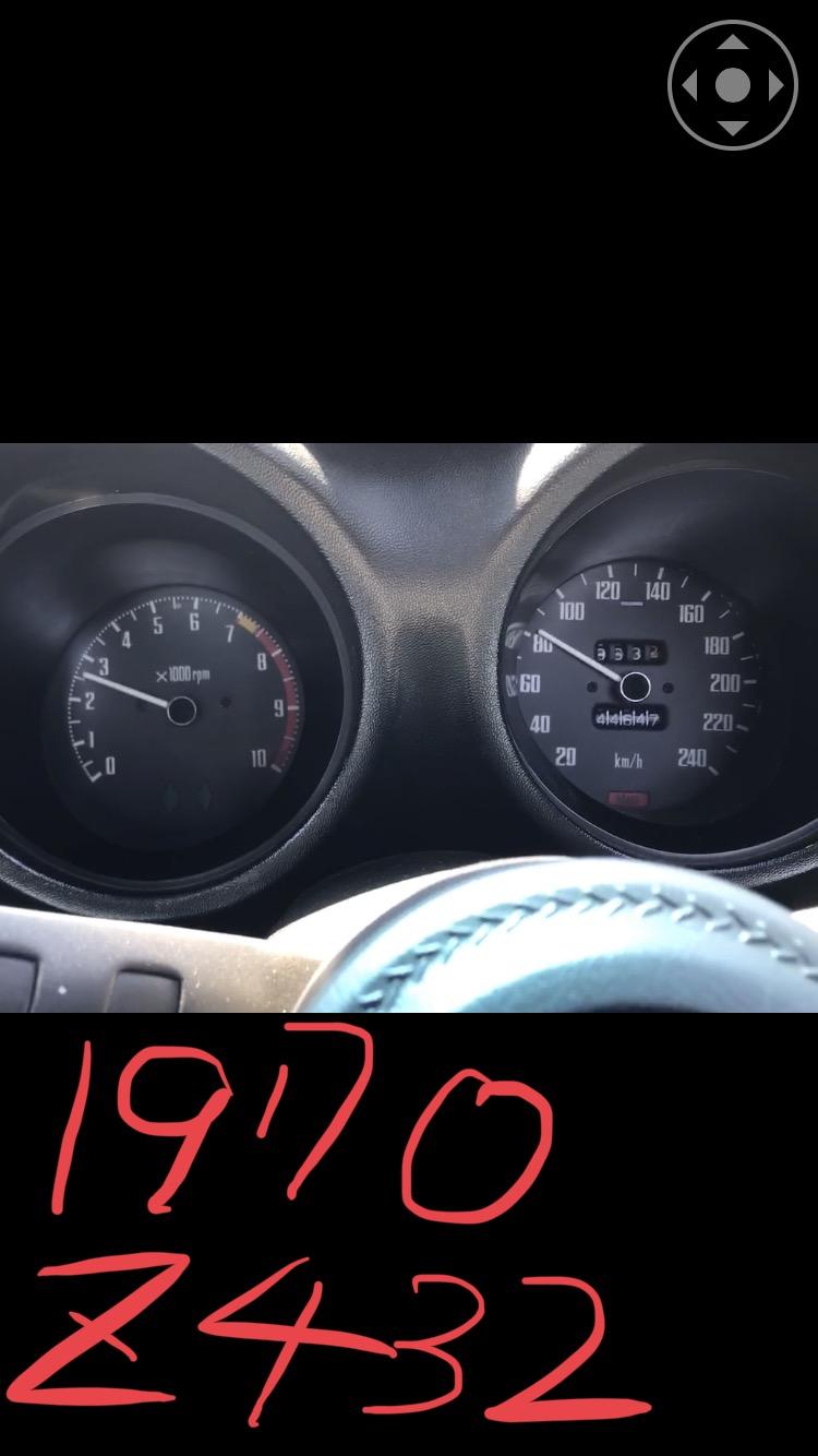

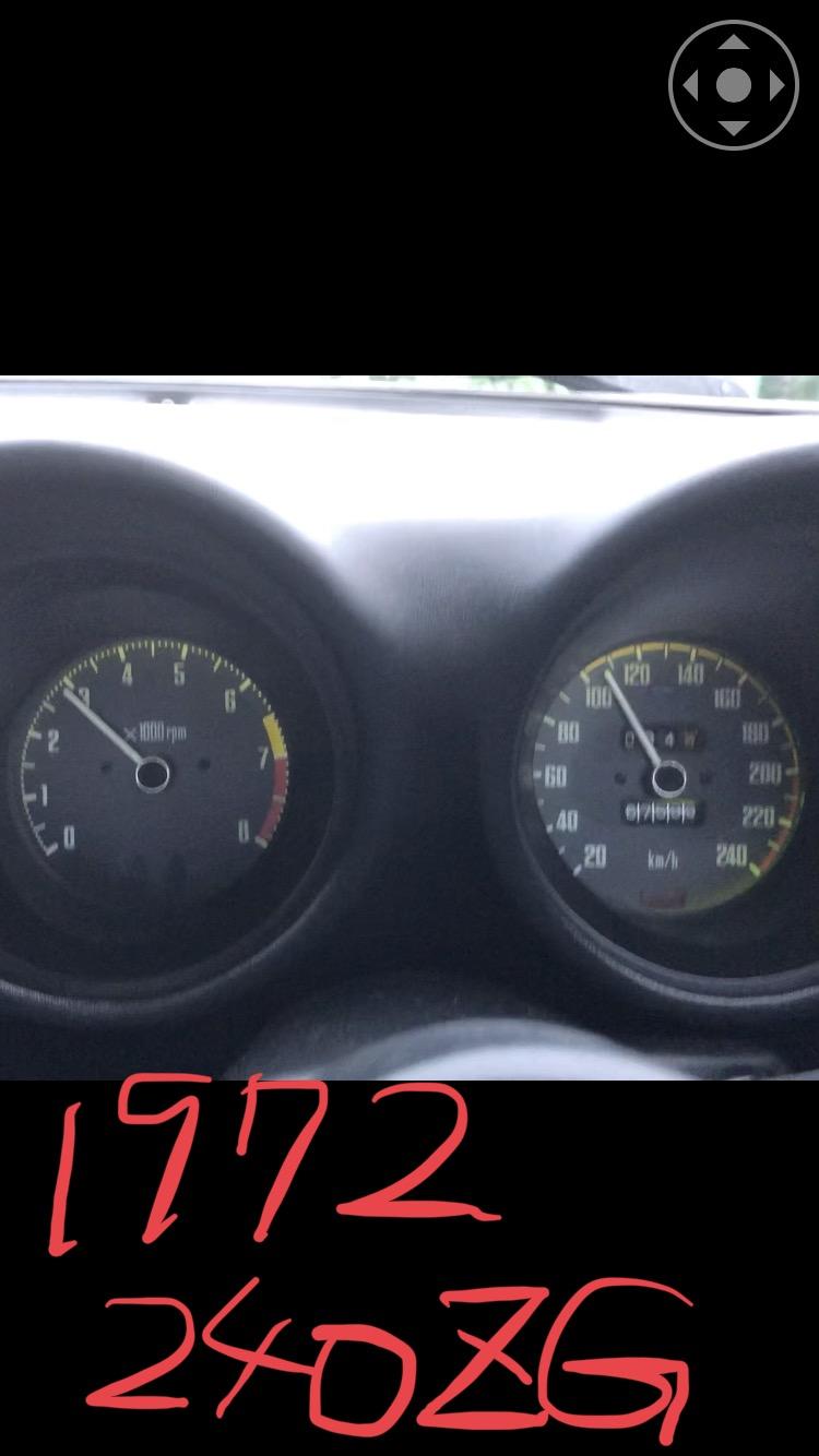

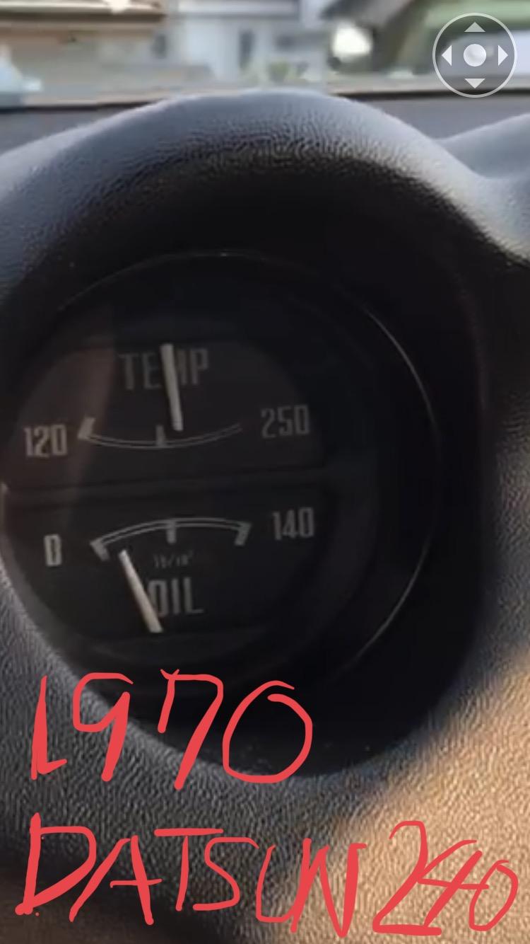

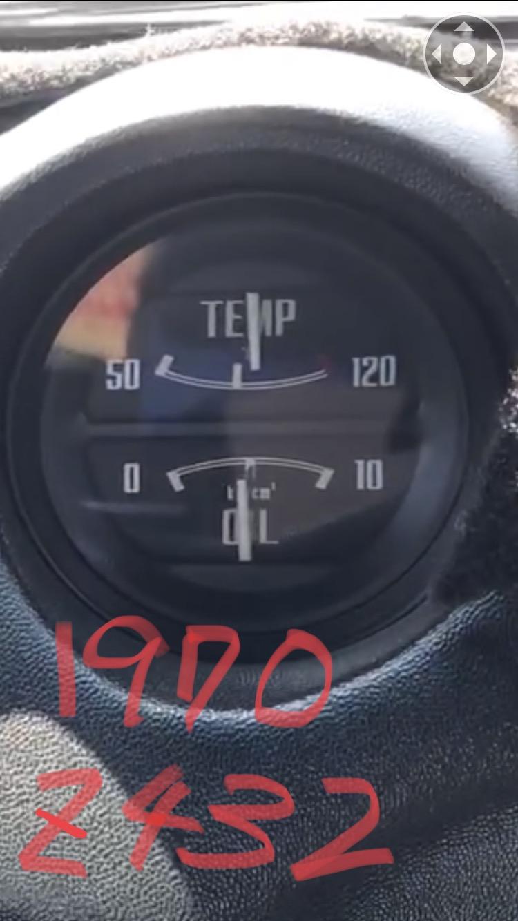

Hi Dan , your  data helps everyone a lot  , I was also wondering too about the low readings of the oil pressure. My first Z is a 1972 240Z when I was living in Bakers Field CA which always showing middle in the gauge. Then I bought a 1970 240Z , it always stayed very low in the gauge.
I remember I was reading Mr. Wick Humble ‘s book and learned  my 1970 car was not wrong .
Here are pictures which were taken recently, my 1970 Z432 ( shared with all the other S30 DOM & EXPORT using the same 10kg switch , 10kg scale ) and 1970 Datsun 240Z , And 1972 Fairlady 240ZG ( 6kg switch with 6kg scale ) .
Just for your reference.
By the way , 25070-89910 ( 10kg ) switch is now approximately 200-400 USD if it is a new , S20 owners are seriously want it .
Looking at my Z432 , S20 might able to be said it’s oil pressure relatively higher than L -series engine , what do you think of it.
Kats

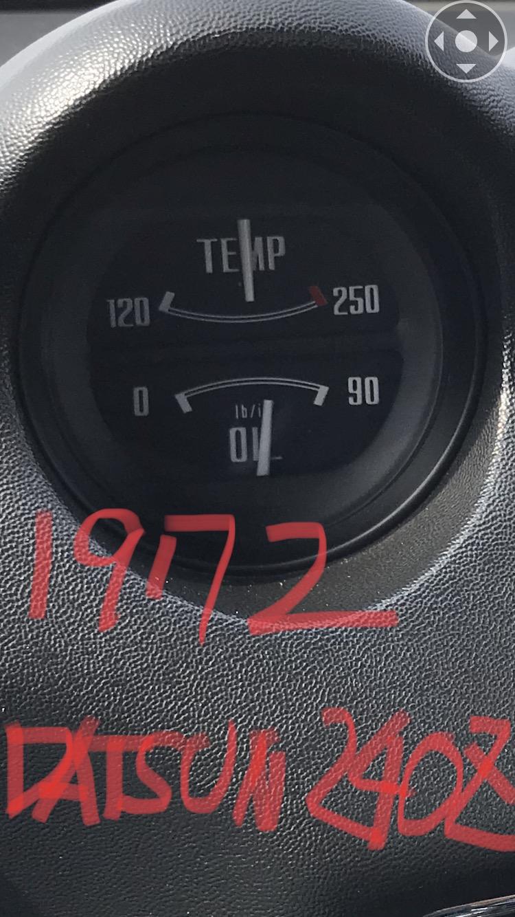

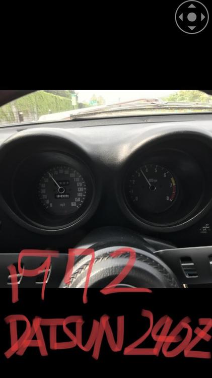

I forgot to put this , my 1972( 12/71 made ) Datsun 240Z . I think a 6kg switch cooperated with a 6kg / 90lb scale work pretty good, it makes me feel happy .
Kats
